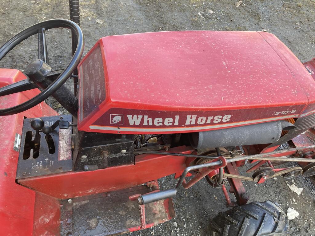

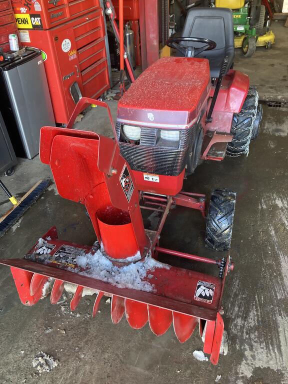

Ifixoldjunk 778 #14953 Posted March 14, 2022 I went over my poor 310 to check it for any winter related damage. Every time it snowed it rained the day before so my driveway was just mush. Ate more gravel this year than it’s ever seen 2 Share this post Link to post Share on other sites
Ifixoldjunk 778 #14954 Posted March 14, 2022 (edited) I don’t think I’ve ever seen my driveway this bad in my life. There’s sections that have absolutely now gravel left. Edited March 14, 2022 by Ifixoldjunk 1 Share this post Link to post Share on other sites

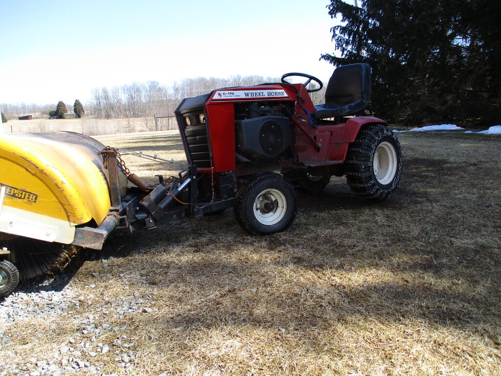

pfrederi 21,204 #14955 Posted March 14, 2022 (edited) Get a sweepster most of the gravel is out in the yard some where.. The ground wasn't frozen befero this last storm and even with the plow skids down I still got a lot of stones in the yard. Sweepster will be working soon... Edited March 14, 2022 by pfrederi 3 5 Share this post Link to post Share on other sites
sjoemie himself 3,232 #14956 Posted March 14, 2022 3 minutes ago, pfrederi said: sweepster I thought I had a decent sweeper on my 512-D until I saw this absolute UNIT of a sweeper. That'll throw some rocks for sure. Steel bristles on it? 2 Share this post Link to post Share on other sites
pfrederi 21,204 #14957 Posted March 14, 2022 Just now, sjoemie himself said: I thought I had a decent sweeper on my 512-D until I saw this absolute UNIT of a sweeper. That'll throw some rocks for sure. Steel bristles on it? Alternating discs of steel and a plastic... 2 Share this post Link to post Share on other sites

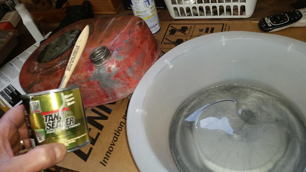

WHX?? 58,254 #14958 Posted March 14, 2022 Sealed a tank for the RE-67. Started two days ago. The instructions said patience and don't rush about 30 times. Might do a product evaluation on the brand I used. So far lookin good. 7 1 Share this post Link to post Share on other sites

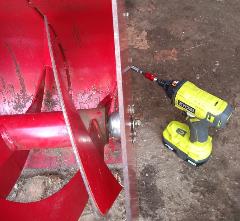

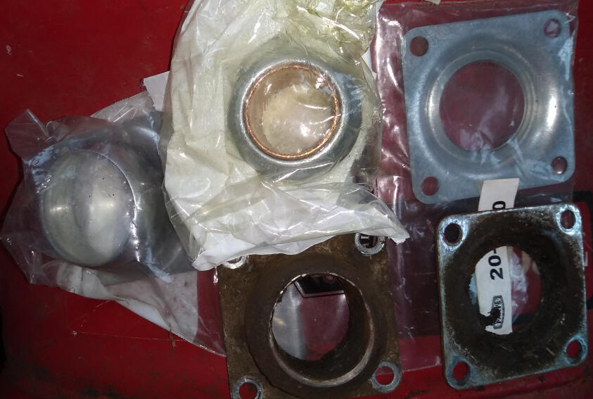

Chestnut 315 #14959 Posted March 14, 2022 Also surveying the winter damage to the snowblower. Knew I had some, so the parts came in this afternoon. Pulled it apart and installed one of the new bearings. Didn't tighten everything down because I had a couple of questions. Do these need lubrication, and if so, what kind. The bearing looks like Oilite, which shouldn't, but interested to hear what others have to say. The old one looks like it was packed with dried, dirty grease. I didn't tackle the other side. It's not as bad. I only ordered one set of housings, so I hope the other one is better. Probably could have cleaned and reused these, but.... Also, I didn't take the plug out of the worm gear housing to check fluid level, but plan to. If it's low, what lube should I use? My other tractor snowblower is another brand, and it came with abad seal and spun bearing in that (out of production) housing that had ruined the housing. I was able to find another assembly on the auction site and it was perfect. I pulled it apart to inspect and put it together. Decided to use the Mfr's recommended lube, Lubriplate GR132 Lithium grease. Seemed like an odd choice to me but I went with it. I would've thought SAE 75-90 gear oil or similar. Anyone know what Toro/Wheelhorse recommends off the top of their head? BTW it's a 79361 two stage. I don't know the year off the top of my head 4 1 Share this post Link to post Share on other sites

lynnmor 9,042 #14965 Posted March 15, 2022 1 hour ago, Chestnut said: Also surveying the winter damage to the snowblower. Knew I had some, so the parts came in this afternoon. Pulled it apart and installed one of the new bearings. Didn't tighten everything down because I had a couple of questions. Do these need lubrication, and if so, what kind. The bearing looks like Oilite, which shouldn't, but interested to hear what others have to say. The old one looks like it was packed with dried, dirty grease. I didn't tackle the other side. It's not as bad. I only ordered one set of housings, so I hope the other one is better. Probably could have cleaned and reused these, but.... Also, I didn't take the plug out of the worm gear housing to check fluid level, but plan to. If it's low, what lube should I use? My other tractor snowblower is another brand, and it came with abad seal and spun bearing in that (out of production) housing that had ruined the housing. I was able to find another assembly on the auction site and it was perfect. I pulled it apart to inspect and put it together. Decided to use the Mfr's recommended lube, Lubriplate GR132 Lithium grease. Seemed like an odd choice to me but I went with it. I would've thought SAE 75-90 gear oil or similar. Anyone know what Toro/Wheelhorse recommends off the top of their head? BTW it's a 79361 two stage. I don't know the year off the top of my head I squirt oil at the shaft where it goes into the bearing in the hope that some gets inside. I use gear oil in the gearbox, this year it leaked quite a bit. I rebuilt it many years ago with new bushings and seals, now I get to do it again. It is my opinion that the gearbox is too cheap for this job. 1 Share this post Link to post Share on other sites

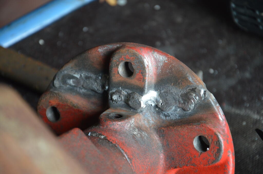

Maxwell-8 4,371 #14969 Posted March 15, 2022 On 3/14/2022 at 1:04 AM, TonyToro said: Noooooo….!! now I have to find another one 😢 I feel you, couldn't find one so I welded it back togeter using welding rods for cast iron 3 1 Share this post Link to post Share on other sites

TonyToro 1,190 #14971 Posted March 15, 2022 3 hours ago, Maxwell-8 said: I feel you, couldn't find one so I welded it back togeter using welding rods for cast iron Perfect fix! A friend is looking at mine tonight. He said there is a good possibility he can weld it. I’ll know more tomorrow but if it doesn’t work out I was at the power equipment shop today and I think we may have a steel replacement, I’ll know for sure in a few days. 1 2 Share this post Link to post Share on other sites

pfrederi 21,204 #14973 Posted March 16, 2022 Think I need to put the weights on I borrowed off her last fall back on??? Think seepsters are heavy??? Just woke her up from her long summer fall winter nap.... 8 1 Share this post Link to post Share on other sites
ebinmaine 80,811 #14974 Posted March 16, 2022 9 minutes ago, pfrederi said: heavy You ever actually weigh that thing Paul? Looks like it would want a fair-sized ballast box hanging off the back of the tractor. 1 Share this post Link to post Share on other sites
pfrederi 21,204 #14975 Posted March 16, 2022 1 minute ago, ebinmaine said: You ever actually weigh that thing Paul? Looks like it would want a fair-sized ballast box hanging off the back of the tractor. ghe Never weighed it.. Wrestled it on many years ago and have never taken it off since. Mounting is a huge PITA. I normally have wheel weights and 50-75 on the rear. Borroed them all last year to fit out a plow tractor for my Brother... 2 Share this post Link to post Share on other sites
