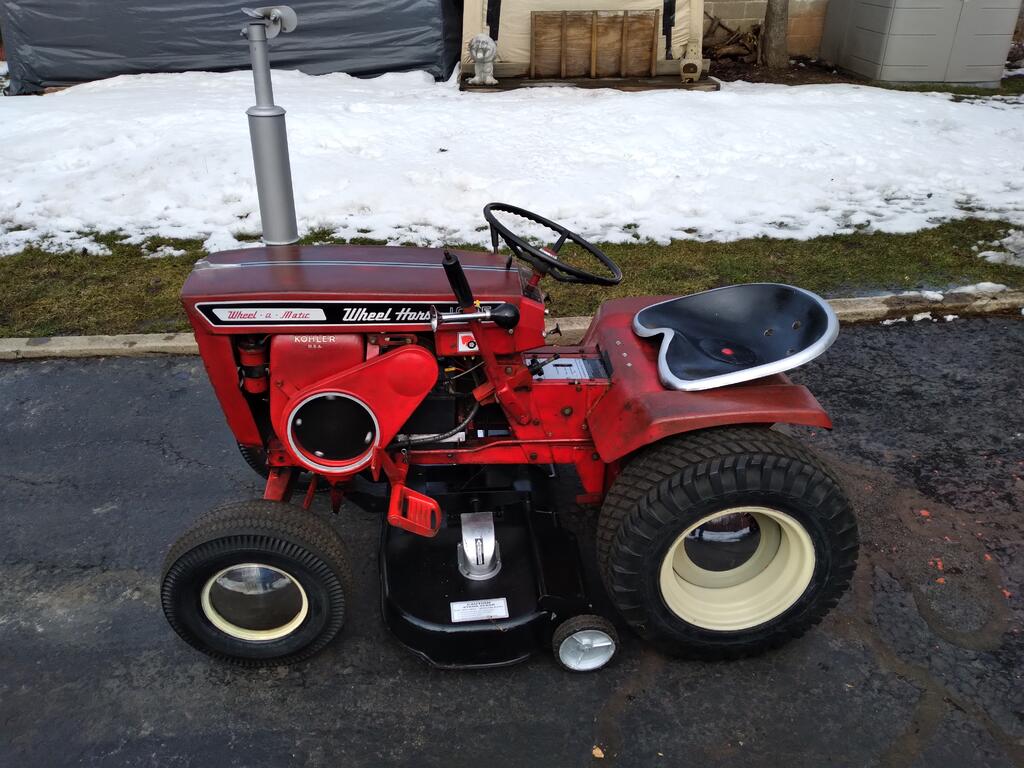

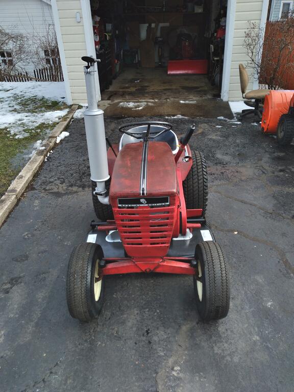

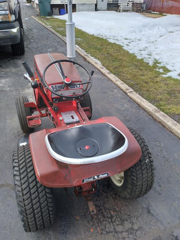

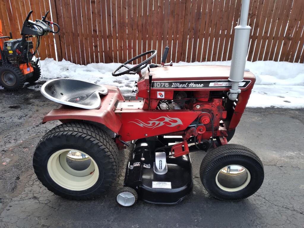

D_Mac 9,339 #14658 Posted February 21, 2022 Was a nice day today. After my doctor's appointment I decided it was a good day to wake up the 1075. It hasn't been startered and driven all winter. Poured some gas in it, primed the fuel pump, choked it, turned the key and it fired right up. Had to put a little air in the front tires, I will look to replace them this spring. Really like this tractor. Short Frame, Big Block, Tall Stack, Custom Decals, Baby Moons, Wheel-A-Matic !!! 2 8 1 Share this post Link to post Share on other sites

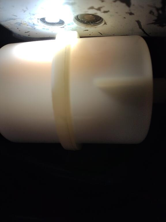

TJ5208 1,841 #14660 Posted February 21, 2022 8 hours ago, Achto said: Those larger filters do not always fill full. If the engine runs good at all RPMs, then I wouldn't worry about it. The filter I have on it now is completely empty when I run it but it runs perfect. 2 Share this post Link to post Share on other sites
Achto 32,816 #14661 Posted February 21, 2022 13 minutes ago, TJ Salyers said: The filter I have on it now is completely empty when I run it but it runs perfect. It probably just looks empty. If gas was not passing through it, it would not run at all. 2 Share this post Link to post Share on other sites

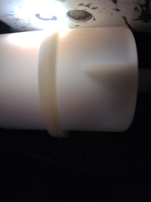

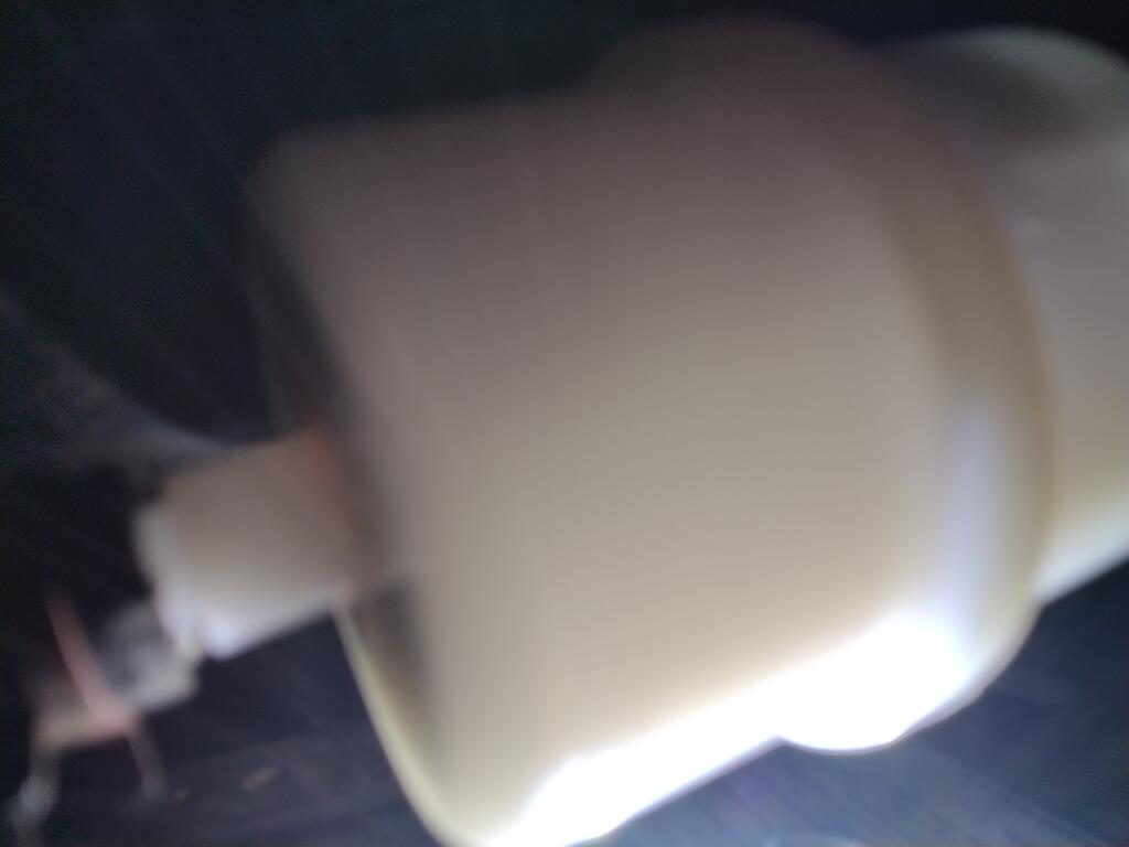

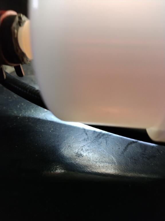

TJ5208 1,841 #14662 Posted February 21, 2022 12 minutes ago, Achto said: It probably just looks empty. If gas was not passing through it, it would not run at all. Here it is not the best pics. Share this post Link to post Share on other sites
TJ5208 1,841 #14663 Posted February 21, 2022 I think I need a smaller fuel filter. 1 Share this post Link to post Share on other sites
Achto 32,816 #14664 Posted February 21, 2022 2 minutes ago, TJ Salyers said: I think I need a smaller fuel filter. If the tractor is running, why worry about it? 4 Share this post Link to post Share on other sites
TJ5208 1,841 #14665 Posted February 21, 2022 Just now, Achto said: If the tractor is running, why worry about it? Well I don't know why I worry about it but it doesn't have anything in it I'm kind of concerned about it. As my dad says if it ain't broke don't fix it. 2 Share this post Link to post Share on other sites
TJ5208 1,841 #14666 Posted February 21, 2022 1 minute ago, Achto said: If the tractor is running, why worry about it? I guess it just kind of aggravates me the tractors pretty much running on fumes. 1 Share this post Link to post Share on other sites
Achto 32,816 #14667 Posted February 21, 2022 1 minute ago, TJ Salyers said: As my dad says if it ain't broke don't fix it. Trust me when I say that your tractor is not running on fumes. 2 4 1 Share this post Link to post Share on other sites
lynnmor 9,042 #14668 Posted February 21, 2022 That fuel filter has gas in it but they usually trap some air because of the horizontal mounting, I like a clear filter so I can see if there is gas and how much dirt is trapped. 5 Share this post Link to post Share on other sites
TJ5208 1,841 #14669 Posted February 21, 2022 (edited) 2 minutes ago, lynnmor said: That fuel filter has gas in it but they usually trap some air because of the horizontal mounting, I like a clear filter so I can see if there is gas and how much dirt is trapped. Okay I understand that but when I hit it against the side of the engine it just sounds really hollow and when it's out in the sunlight you can't see nothing I thought you would be able to. Edited February 21, 2022 by TJ Salyers 1 Share this post Link to post Share on other sites
lynnmor 9,042 #14670 Posted February 21, 2022 1 minute ago, TJ Salyers said: Okay I understand that but when I hit it against the side of the engine it just sounds really hollow and when it's out in the sunlight you can't see nothing I thought you would be able to. Me thinks that you worry too much. 6 Share this post Link to post Share on other sites
TJ5208 1,841 #14671 Posted February 21, 2022 Just now, lynnmor said: Me thinks that you worry too much. Me do to but I guess I don't understand what could happen if it runs low on gas all the time but it still runs. 1 Share this post Link to post Share on other sites
Ed Kennell 47,480 #14672 Posted February 21, 2022 54 minutes ago, TJ Salyers said: The filter I have on it now is completely empty when I run it but it runs perfect. at last......The energy crisis is over. We have a fuel free internal combustion engine. 10 Share this post Link to post Share on other sites
wallfish 20,647 #14673 Posted February 21, 2022 19 hours ago, TJ Salyers said: I think I need a smaller fuel filter. If you need to see fuel in the fuel filter to verify the engine is actually running on fuel then please move it to place where it will be located in a vertical position. Then you can see it full of fuel instead of seeing some air trapped inside of it. It's better located before the fuel pump anyway (like stated in your other thread) to keep the vasilene and crap out of the pump too. This fuel filter thing has already been covered in your other thread 1 Share this post Link to post Share on other sites
