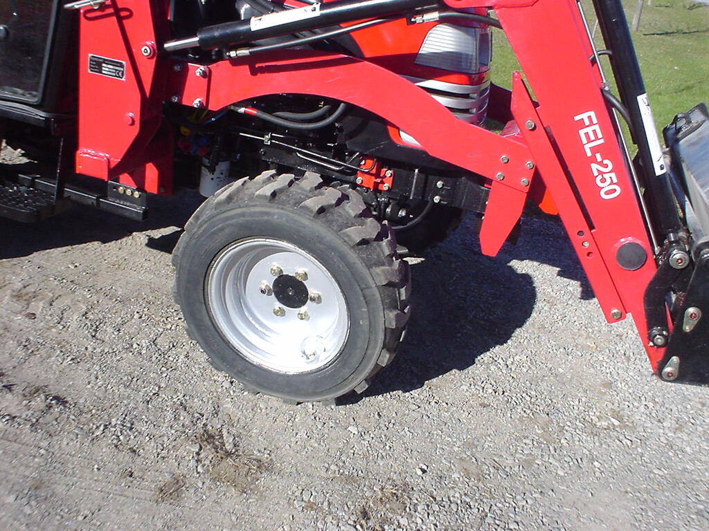

cleat 8,985 #14076 Posted December 27, 2021 Even my larger tractor has that front brace as well as one down low that connects to the rear axle. 4 1 Share this post Link to post Share on other sites

Thor27 890 #14078 Posted December 27, 2021 (edited) There are the original circa 1980 front subframe and struts. Kinda hidden by the angle in that picture. Edited December 27, 2021 by Thor27 Add pics from phone 3 1 Share this post Link to post Share on other sites

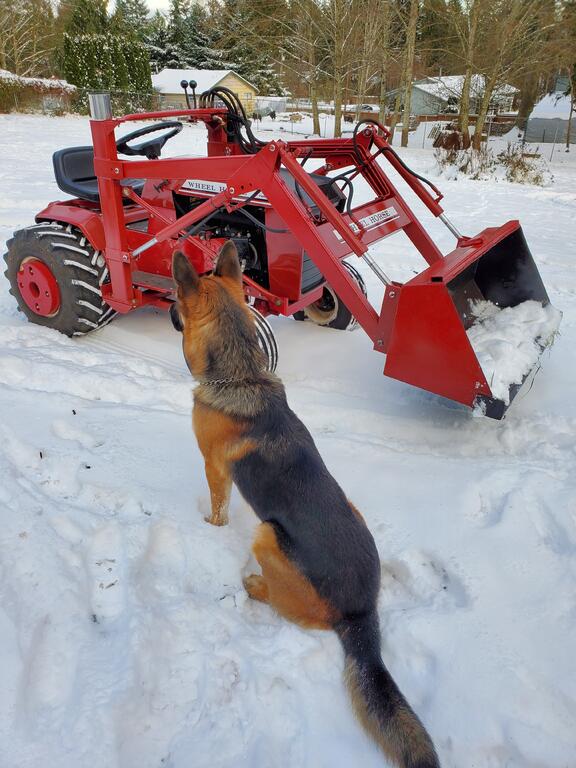

Thor27 890 #14080 Posted December 27, 2021 Win! No leaks, works like it should, and shop dog seems to approve. 4 15 Share this post Link to post Share on other sites
Horse Newbie 7,404 #14081 Posted December 27, 2021 Nice tractor !… great shop dog ! 1 1 1 Share this post Link to post Share on other sites

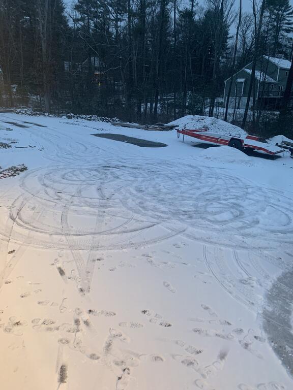

Raposo 532 #14083 Posted December 29, 2021 A couple donuts the other day with my 3 year old son! He loved them. 2 5 1 Share this post Link to post Share on other sites

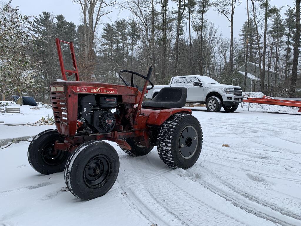

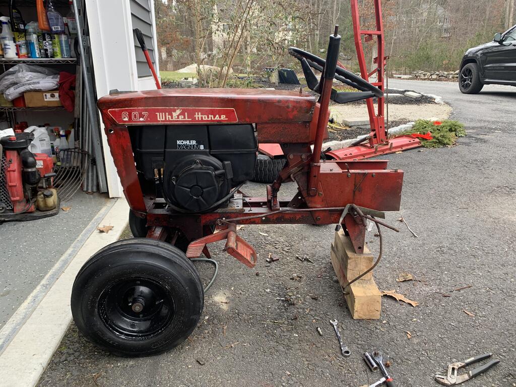

Raposo 532 #14084 Posted December 29, 2021 And then shortly after the donuts.....this happened.... 6 Share this post Link to post Share on other sites
Thor27 890 #14085 Posted December 29, 2021 Looks like you swapped engines? 1 Share this post Link to post Share on other sites
ebinmaine 79,046 #14086 Posted December 29, 2021 23 minutes ago, Thor27 said: Looks like you swapped engines? Yeah that's a neat little upgrade. @Sparky's got one like that too. His is red. Looks factory. 6 hours ago, Raposo said: .....this happened.... What're we up to here? 1 Share this post Link to post Share on other sites

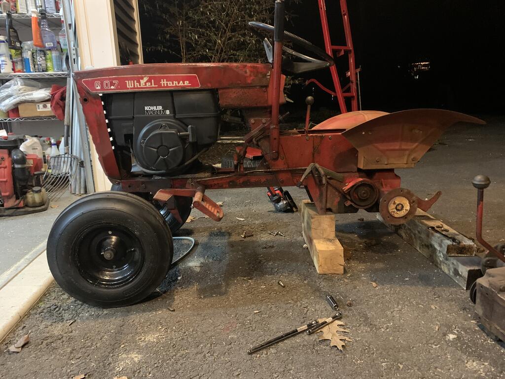

Raposo 532 #14087 Posted December 29, 2021 I did, the predator was short term until I found a magnum 8 recoil for it. Also adding round fenders to it. Here’s a quick mock up picture. The trans tunnel will be cut on a slope to mimic a 1045. 4 5 Share this post Link to post Share on other sites

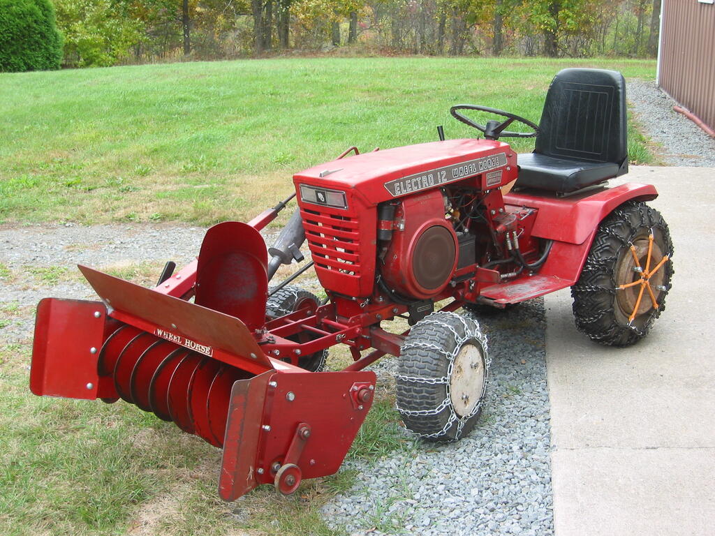

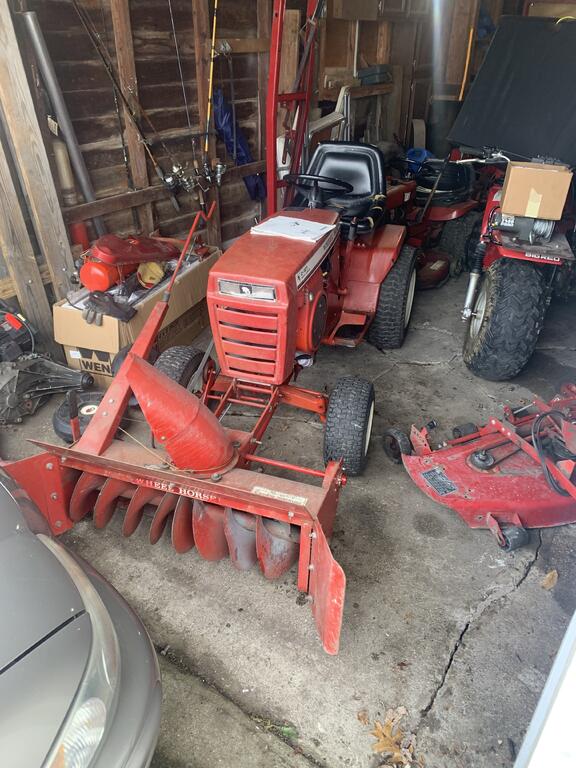

dooley1337 11 #14090 Posted December 31, 2021 Got the C121 ready for some snow, just gotta out the wheel weights on. 2 4 Share this post Link to post Share on other sites
pfrederi 20,622 #14091 Posted December 31, 2021 2 minutes ago, dooley1337 said: Got the C121 ready for some snow, just gotta out the wheel weights on. You should reverse the side plates on the blower it will make it bite in to snow better 3 2 Share this post Link to post Share on other sites
Ifixoldjunk 778 #14092 Posted January 1, 2022 On 12/28/2021 at 10:27 PM, Raposo said: And then shortly after the donuts.....this happened.... Wow that magnum 8 looks amazing in that 607👏 1 Share this post Link to post Share on other sites

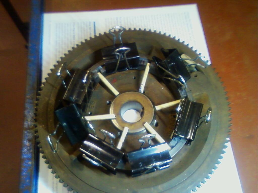

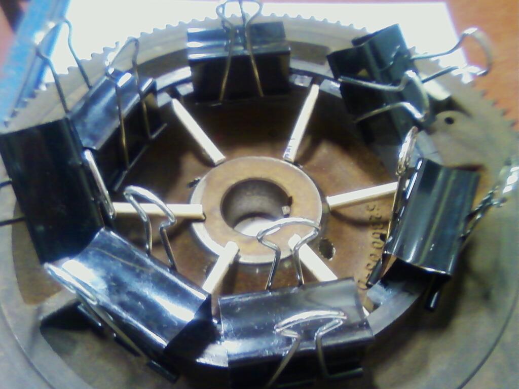

johnnymag3 2,646 #14095 Posted January 1, 2022 Fixed my low AC voltage issue on the M18.....the magnets were broken and missing...and completely unglued...Runs at correct AC current now to the regulator !!!! I have never had this issue before with any of my 50 or so Wheel Horses...But apparently Its a common Kohler thing...Oh well ,,,,easy fix !! Quote 3 3 Share this post Link to post Share on other sites
