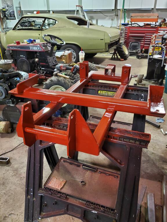

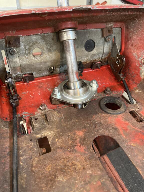

ebinmaine 80,841 #14052 Posted December 24, 2021 14 minutes ago, Crazy_Carl said: Like that bearing install. I saved this post for notes on my Colossus build. 3 Share this post Link to post Share on other sites

Fishroe 261 #14054 Posted December 25, 2021 (edited) Hey Carl that looks like a nice bearing on the steering shaft. Do you have a part # for it my 414-8 probably has 1/4 of play in it thanks Is the 414-8 the same size as yours Edited December 25, 2021 by Fishroe 2 Share this post Link to post Share on other sites
ebinmaine 80,841 #14055 Posted December 25, 2021 5 minutes ago, Fishroe said: Hey Carl that looks like a nice bearing on the steering shaft. Do you have a part # for it my 414-8 probably has 1/4 of play in it thanks Is the 414-8 the same size as yours You can use get em from McMaster Carr. Part itself should work fine. Flanged Bearings, with Two-Bolt Flange, for 3/4" Shaft Diameter, Self Aligning https://www.mcmaster.com/5913K73 2 1 Share this post Link to post Share on other sites
Fishroe 261 #14056 Posted December 25, 2021 Thanks ebinmaine. Going to order right now pretty good price too 2 Share this post Link to post Share on other sites

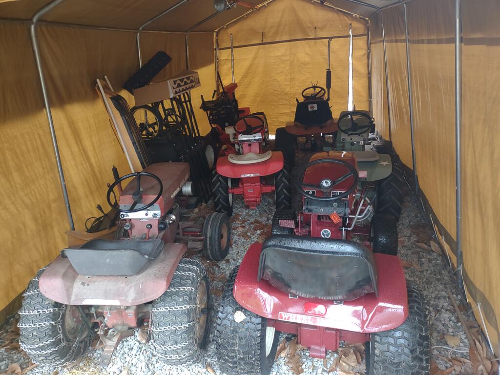

Fishroe 261 #14063 Posted December 25, 2021 Yea I was mia for 8 years ive been back for a week and have bought compression spring, roll pin punch, flange bearing and Santa. This place is getting expensive! I could use another set of chains for the rear tires. All these nice looking horses here I’m ashamed to post a pic of mine. One day I might get it back to new condition 2 Share this post Link to post Share on other sites
ebinmaine 80,841 #14064 Posted December 25, 2021 4 minutes ago, Fishroe said: All these nice looking horses here I’m ashamed to post a pic of mine. One day I might get it back to new condition Ahh nehh nehh. No worries there. The ball n chain and I have 3 restored and her favorite is a good ole rough lookin worker 867. Post em up! We likes the work clothes just as much as the fresh painted ones. 3 Share this post Link to post Share on other sites

Handy Don 17,529 #14067 Posted December 25, 2021 23 hours ago, ebinmaine said: Like that bearing install. I saved this post for notes on my Colossus build. The have these at Surplus Center, sometimes. 2 Share this post Link to post Share on other sites

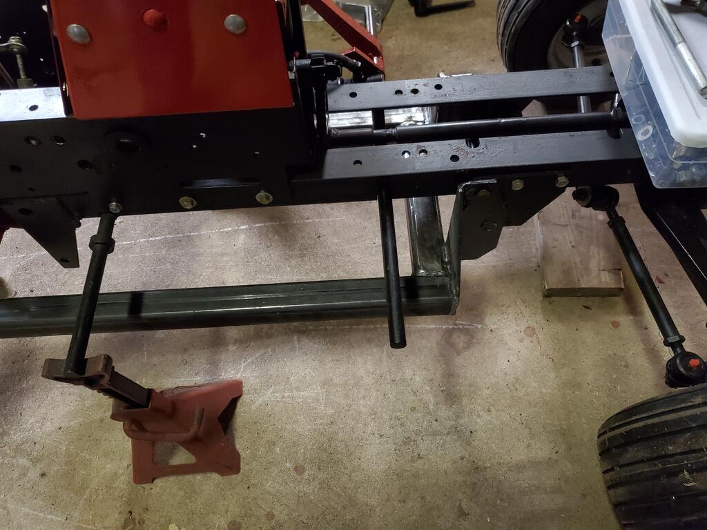

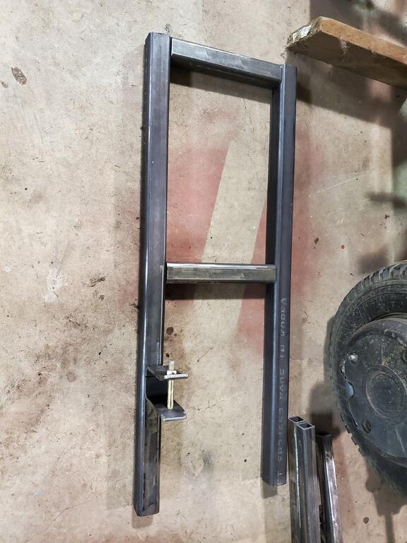

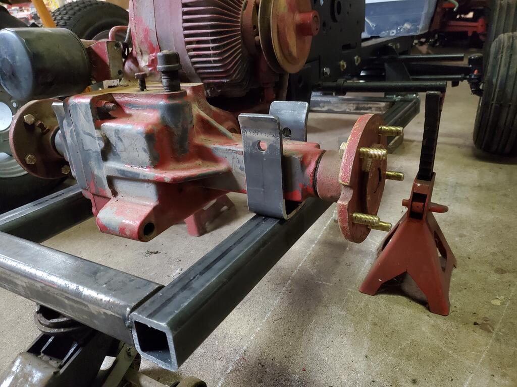

Thor27 892 #14069 Posted December 27, 2021 (edited) On 12/18/2021 at 11:18 PM, Lee1977 said: The hydro axle housings are 1/8" larger then the 8 speed. Wheel Horse added a spacer bracket to their axle hitches. If Eric built his hitch to fit tight on an 8 speed It will not fit a hydro with out elongating the holes. Thank you @Lee1977 . On my weekend project I was using a stripped down 8 speed tractor for mock up. Tossed an eaton on a stalled out project instead. You saved me from a mistake. Melted this Into this. Please excuse the mess. made up a quick filter mount. Edited December 27, 2021 by Thor27 4 8 Share this post Link to post Share on other sites
Handy Don 17,529 #14070 Posted December 27, 2021 @Thor27 that is some very nifty layout and build. Except for the paint overspray on the floor, I can't see any of what you call mess, only projects in progress! 2 1 Share this post Link to post Share on other sites

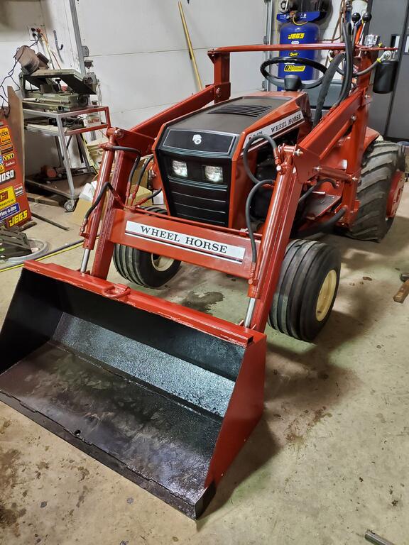

Thor27 892 #14074 Posted December 27, 2021 Left off in a good spot. Check & tighten everything, fill and bleed oil, and I should have an operating loader in the morning. The pins to the bucket are fighting me. Think if I get hydraulics to work I won't have to fight the weight of the bucket and arms. 5 6 Share this post Link to post Share on other sites

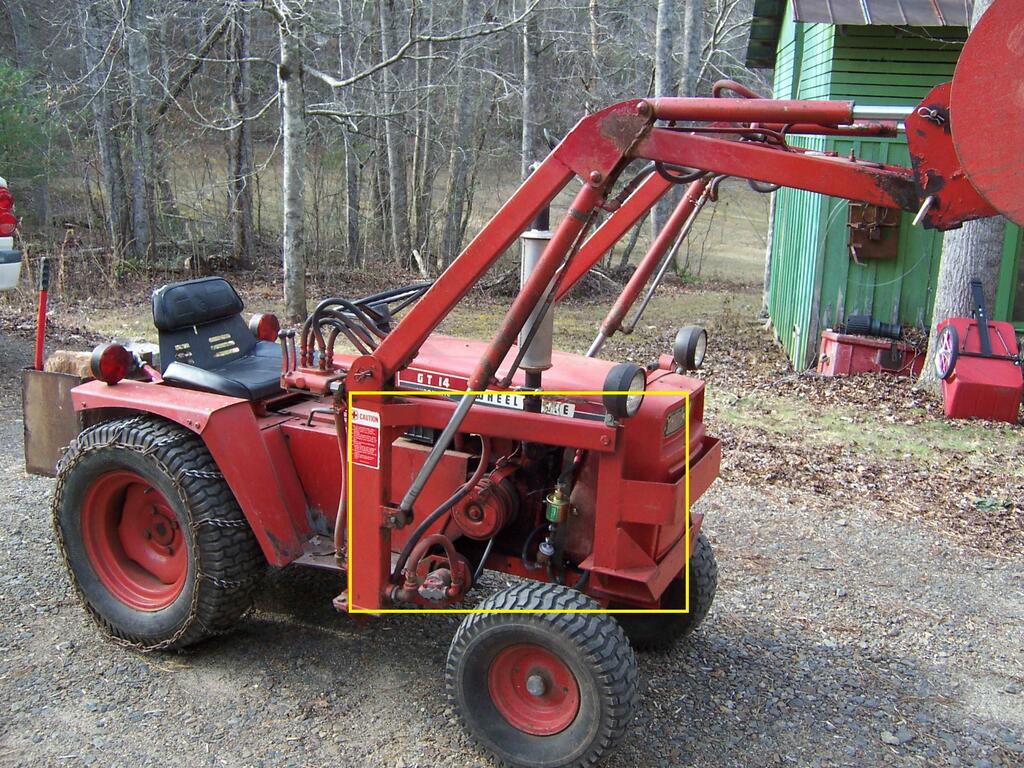

953 nut 69,696 #14075 Posted December 27, 2021 (edited) 7 hours ago, Thor27 said: Left off in a good spot. Check & tighten everything, fill and bleed oil, and I should have an operating loader in the morning. The pins to the bucket are fighting me. Think if I get hydraulics to work I won't have to fight the weight of the bucket and arms. Have you considered a front mounted sub-frame with struts going from the from of your frame to the upright near the operator? Without them all the forces will be acting on your crossmember alone and are likely to twist it. It could be like the one I have pictured or a couple of Schedule 80 one inch pipes running diagonally from below the frame to the pivot point of the upper arms which won't interfere with the hood. This will add a lot of stability yo your FEL. Edited December 27, 2021 by 953 nut 2 1 Share this post Link to post Share on other sites
