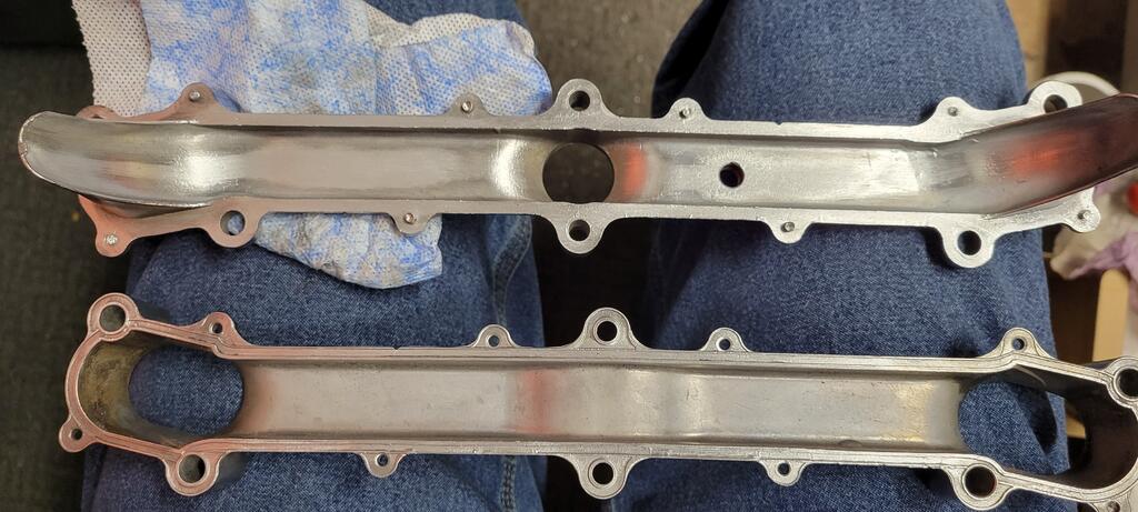

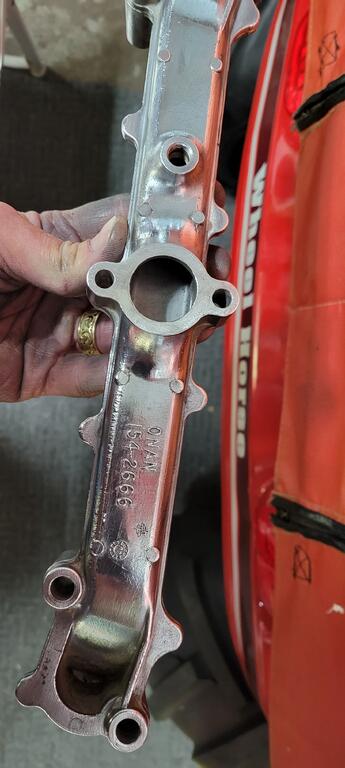

AMC RULES 37,260 #13954 Posted December 14, 2021 Got a little Onan detailing done today. Swore to myself I wasn't gonna do this. The before... and the after. Shame, once in place, it'll never be seen. 6 10 Share this post Link to post Share on other sites

lynnmor 9,047 #13956 Posted December 14, 2021 52 minutes ago, AMC RULES said: See that notch in the side of the intake straight above the S on the fender? That comes from the exhaust heat shield wearing into it. Grind a bit of clearance in the shield so it can't hit. Check other possible interference as well. 3 Share this post Link to post Share on other sites
AMC RULES 37,260 #13957 Posted December 15, 2021 Ty buddy, will do. Share this post Link to post Share on other sites

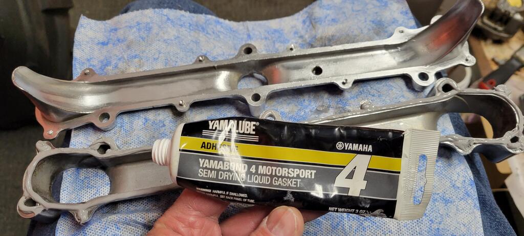

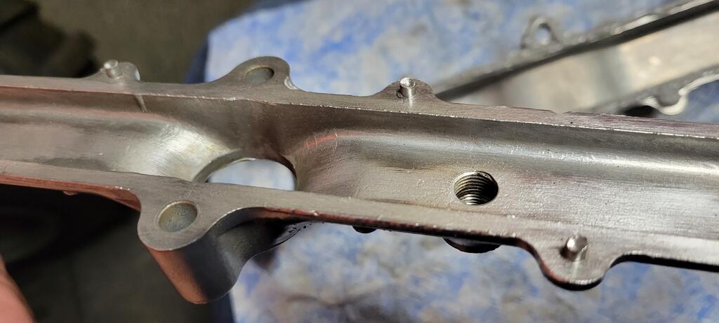

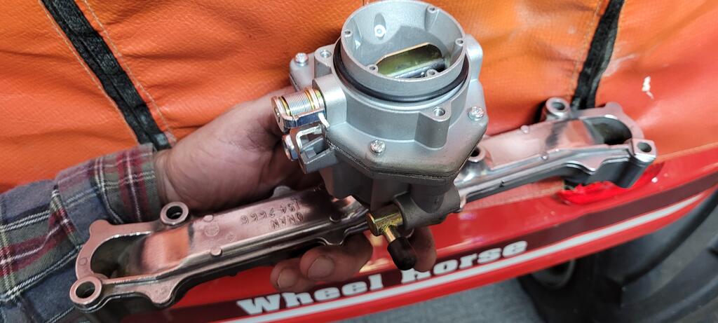

AMC RULES 37,260 #13959 Posted December 15, 2021 Resealed them two intake halfs tonight. 4 4 Share this post Link to post Share on other sites
lynnmor 9,047 #13960 Posted December 15, 2021 40 minutes ago, AMC RULES said: Resealed them two intake halfs tonight. The Yamabond is good stuff, I guess that you will be bolting thru where the rivets were? 3 Share this post Link to post Share on other sites
kpinnc 19,000 #13961 Posted December 15, 2021 Sealing the intake manifold is probably the best thing you can do to stop surging RPMs and negate the need to run with the choke on. ... Obviously you already knew that. I was just typing out loud. 1 1 Share this post Link to post Share on other sites
Snoopy11 5,731 #13962 Posted December 15, 2021 2 minutes ago, kpinnc said: Sealing the intake manifold is probably the best thing you can do to stop surging RPMs and negate the need to run with the choke on That or change carb jets... whatever is easier... Don 1 Share this post Link to post Share on other sites

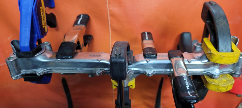

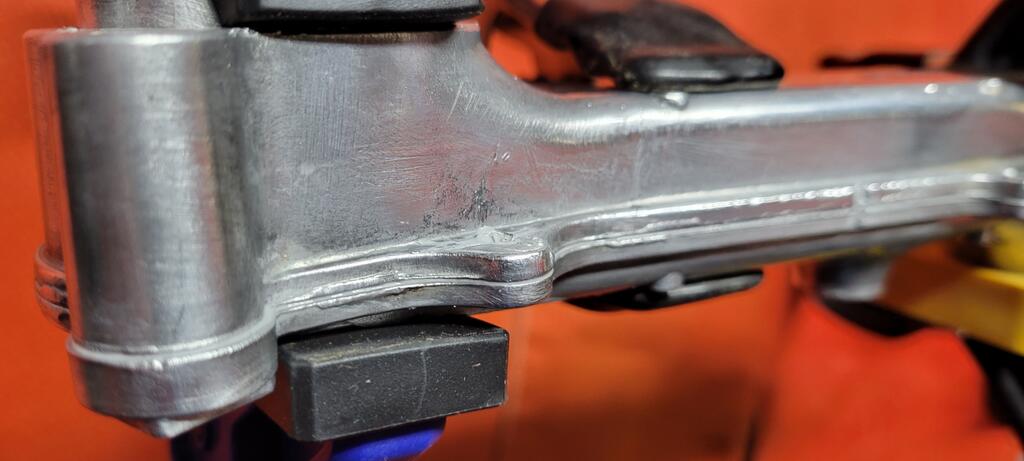

AMC RULES 37,260 #13963 Posted December 15, 2021 Could drill through the rivets and tap for screws but I'm thinking a mechanical fastener may not be necessary. We'll see what it looks like after it comes out of the clamps tomorrow. 3 Share this post Link to post Share on other sites
Snoopy11 5,731 #13964 Posted December 15, 2021 1 minute ago, AMC RULES said: Could drill through the rivets Why not put more rivets? Don 1 Share this post Link to post Share on other sites
Handy Don 17,529 #13965 Posted December 15, 2021 37 minutes ago, AMC RULES said: Could drill through the rivets and tap for screws but I'm thinking a mechanical fastener may not be necessary. We'll see what it looks like after it comes out of the clamps tomorrow. My only thought would be the weight of the carb on top of the manifold as the tractor jounces around. Share this post Link to post Share on other sites
AMC RULES 37,260 #13966 Posted December 15, 2021 Having taken one apart, I think they're overkill. But, like I said, we will see. Share this post Link to post Share on other sites
lynnmor 9,047 #13967 Posted December 15, 2021 6 hours ago, AMC RULES said: Could drill through the rivets and tap for screws but I'm thinking a mechanical fastener may not be necessary. We'll see what it looks like after it comes out of the clamps tomorrow. There is no way that I would release the clamping without the two halves bolted together. If the halves spring open even a little, the sealant will no longer work. I drill thru both halves and use stainless steel screws, washers and locknuts. Tapping the aluminum may be OK, but that cast metal isn't as strong as bolting thru. So everyone knows, those "rivets" are simply protrusions from the one half, not a separate fastener. 3 Share this post Link to post Share on other sites

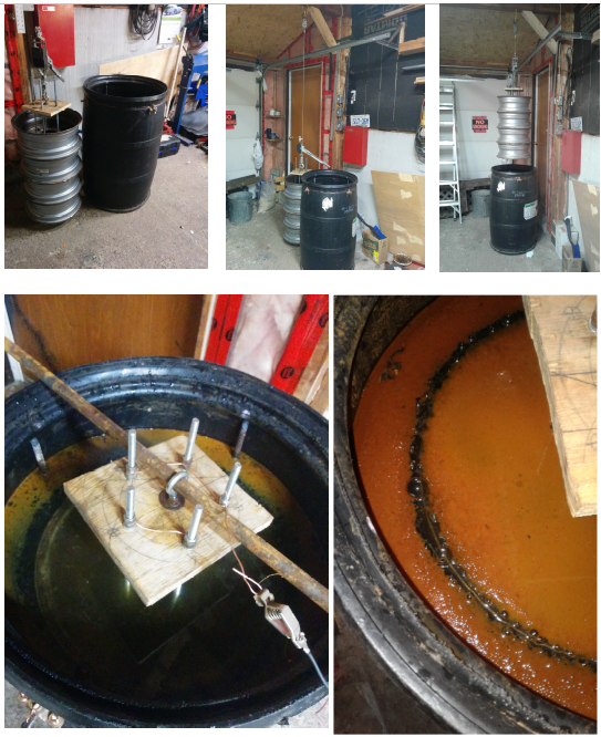

MikMacMike 494 #13968 Posted December 15, 2021 On 12/13/2021 at 11:19 PM, MikMacMike said: Wew...frustrated over sore back and spending mony on wire wheels that cost us 20 plus dollars. Heres a update on a process I did in small ways in the past and was so impressed by the end result I just had to share. Its an electrolisis setup that will eliminate oll that arm power we put into removing rust but with far less base material being removed.....neever mind the costs of all the **** we need to buy that far still way over priced....55 gal plastic drum, 4 36 inch rebar, 1 box of 20 mule team soda, a few feet of copper wire and voala you have the bar nun best rust remover ever that does its job while your using yer arm power on other ****. Dam what a god send and its non toxic too. Ill be finished building it by noon tomorrow. ok here are some pics of it, the last pic you can see Im free to do other work instead of expelling my energy hehehe 3 2 Share this post Link to post Share on other sites

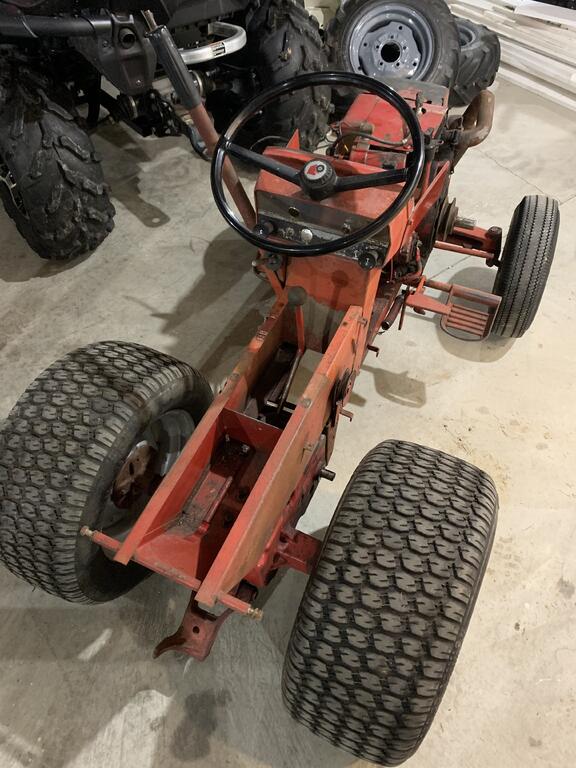

Raposo 532 #13970 Posted December 15, 2021 Started tearing down my 657....this will be getting an 8 horse magnum and will be an “857” 5 1 Share this post Link to post Share on other sites

MikMacMike 494 #13972 Posted December 15, 2021 (edited) On 12/14/2021 at 8:43 AM, Gregor said: I have done what you are doing on a smaller scale. 10 gal plastic tub. You may want to re-think that non toxic part. I used Arm & Hammer Washing Soda. I guess there may be fumes from paint removal, hard to say really, but as long as you use sodium bicarbate...aka arm n hammer or Borax basically the same thing the only real gases youll get are Hydrogen and oxigen. While operating it needs to be well ventalated because of the hydrogen gasses or you could have an explosion if its allowed to pool. The next one will be even larger, so I can do full on engine blocks and larger parts. Edited December 15, 2021 by MikMacMike 1 Share this post Link to post Share on other sites
ebinmaine 80,841 #13973 Posted December 15, 2021 1 hour ago, MikMacMike said: Id love to see some pics of how you built the fork lift for the wheel Horse, dang handy dandy There's a build thread on here somewhere Mike... 1 hour ago, Raposo said: Started tearing down my 657....this will be getting an 8 horse magnum and will be an “857” @Sparky has an old square hood with a Magnum 8 horse. Good little tractor. You'll like that. 1 1 Share this post Link to post Share on other sites
Jeff-C175 7,211 #13974 Posted December 15, 2021 1 hour ago, MikMacMike said: sodium bicarbate...aka arm n hammer or Borax basically the same thing Well... to be clear, Washing soda is sodium carbonate. Baking soda is sodium BIcarbonate. Borax is Sodium tetraborate. Washing soda is preferred. I've used baking soda when I didn't have washing soda and didn't see a difference. Not sure about the borax though, I would research that before I tried it. 2 Share this post Link to post Share on other sites
