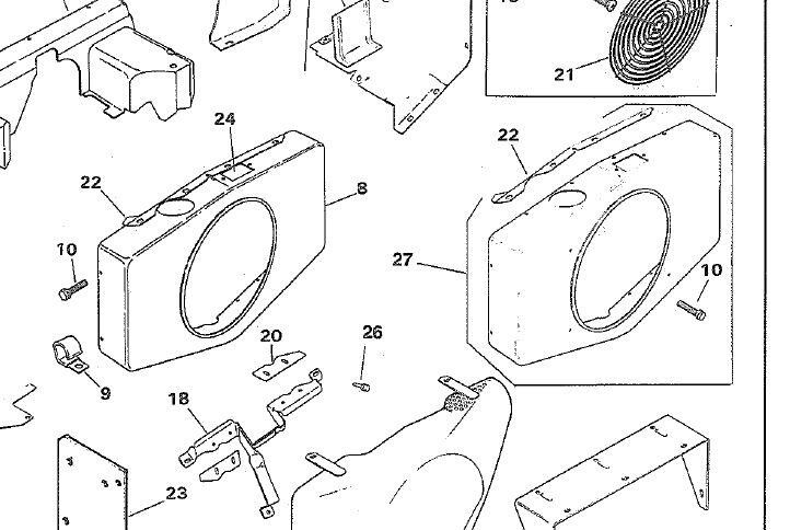

johnnymag3 2,646 #13751 Posted November 28, 2021 2 hours ago, pfrederi said: Did you separate the small top plate?? #22 from the main housing #8 It is all one piece.......they dont seperate....Thats my issue 1 Share this post Link to post Share on other sites
johnnymag3 2,646 #13752 Posted November 28, 2021 It is factory tack welded together.....if it was two it would be perfect!!! my 418 A is the same as Johnnys....and the 417 A is also one piece.... Share this post Link to post Share on other sites
johnnymag3 2,646 #13753 Posted November 28, 2021 2 hours ago, pfrederi said: Did you separate the small top plate?? #22 from the main housing #8 It is all one piece.......they dont seperate....Thats my issue 1 Share this post Link to post Share on other sites
johnnymag3 2,646 #13754 Posted November 28, 2021 (edited) My number 22 piece has only 2 bolt holes on the outboard side..... not the 2 in the middle.......or 4 if you will Edited November 28, 2021 by johnnymag3 1 Share this post Link to post Share on other sites

pfrederi 20,870 #13758 Posted November 28, 2021 (edited) 34 minutes ago, johnnymag3 said: My number 22 piece has only 2 bolt holes on the outboard side..... not the 2 in the middle.......or 4 if you will Don't now what to say. my 418A has the separate piece with four holes only three are used the intake manifold blocks one. Just got mine back together after an overhaul. The one C175 I can see right now has the two piece Edited November 28, 2021 by pfrederi 1 Share this post Link to post Share on other sites
pfrederi 20,870 #13759 Posted November 28, 2021 Looking at parts appears there are several part numbers some might be one piece some 2. What spec number is you engine.. Share this post Link to post Share on other sites

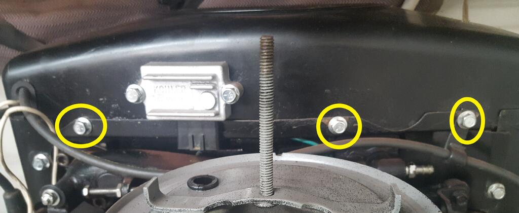

Gregor 4,848 #13760 Posted November 28, 2021 Mine has 3. Could there possibly be a bolt head broken off? Share this post Link to post Share on other sites
Gregor 4,848 #13761 Posted November 28, 2021 10 minutes ago, pfrederi said: Looking at parts appears there are several part numbers some might be one piece some 2. What spec number is you engine.. As per manual, 1987 418-A Might mean something, then again, it might not. Share this post Link to post Share on other sites
pfrederi 20,870 #13762 Posted November 28, 2021 For what it is worth 24510 spec is variation 82 for Grp 2 (baffles/Shrouds) should have 2 pieces... Share this post Link to post Share on other sites

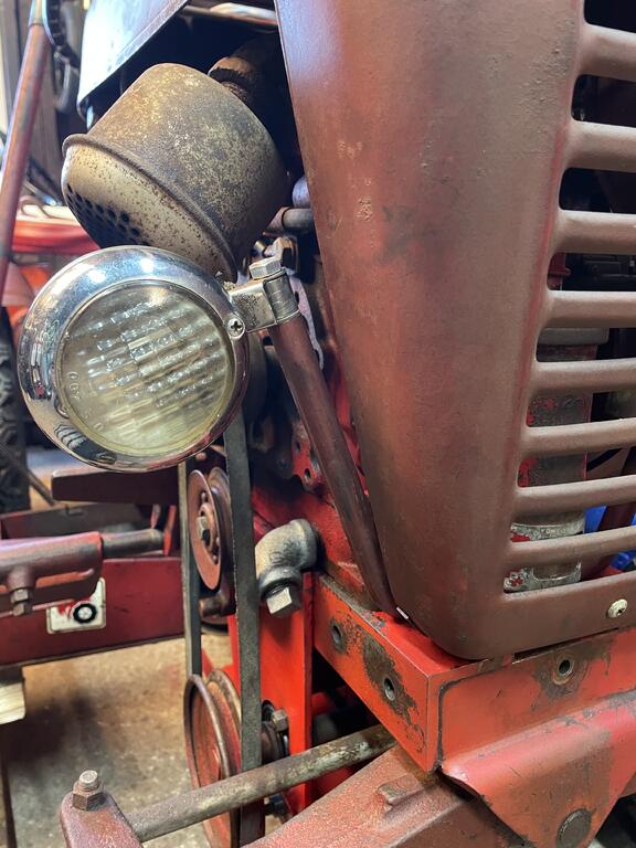

whtractors24 3,560 #13763 Posted November 28, 2021 Put a wheel horse man 1000 light bar on my 753 . Of course had to do some patina matching . 2 4 1 Share this post Link to post Share on other sites

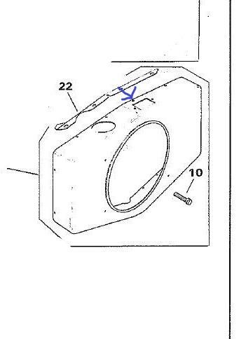

Snoopy11 5,731 #13764 Posted November 28, 2021 Isn't there another behind here (see blue arrow)? Don 1 Share this post Link to post Share on other sites
Snoopy11 5,731 #13765 Posted November 28, 2021 Don 1 Share this post Link to post Share on other sites
