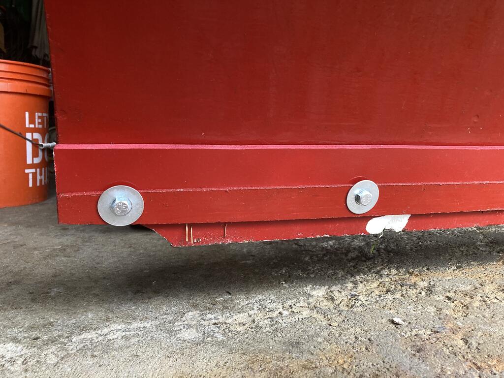

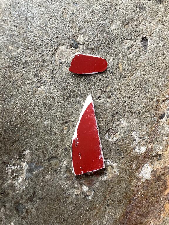

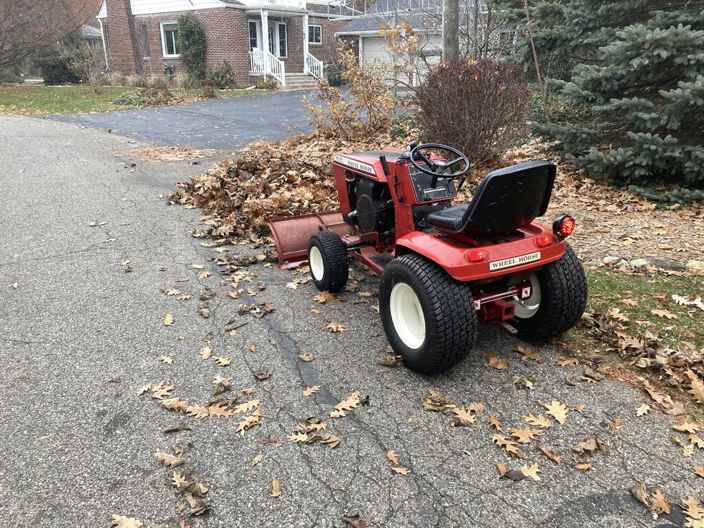

SylvanLakeWH 32,668 #13716 Posted November 27, 2021 Leaves round 10 or so… just before snow hits… And… a fail… my pvc wear bar idea crapped on me… not unexpected, but I was hopeful… I’ll just go back to the metal and set it really lightly to protect the new concrete drives… 3 2 Share this post Link to post Share on other sites
Handy Don 17,533 #13717 Posted November 27, 2021 (edited) 31 minutes ago, SylvanLakeWH said: And… a fail… my pvc wear bar idea crapped on me… not unexpected, but I was hopeful… I’ll just go back to the metal and set it really lightly to protect the new concrete drives… Bummer. I was thinking of giving that a try after you posted the idea. Maybe the heavy rubber belt thing would work better? Edited November 27, 2021 by Handy Don 3 Share this post Link to post Share on other sites
Maxwell-8 4,371 #13718 Posted November 27, 2021 1 hour ago, Handy Don said: Bummer. I was thinking of giving that a try after you posted the idea. Maybe the heavy rubber belt thing would work better? part of an industrial conveyor belt. wears very nicely haven't yet tested it on snow tho. I forgot to tension the rubber before mounting so it is a bit crooked. Will have to do that again. 4 1 1 Share this post Link to post Share on other sites

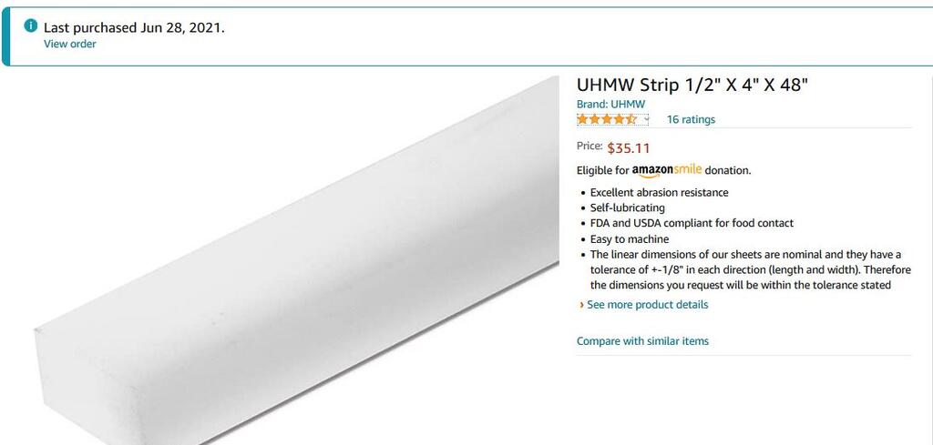

pfrederi 21,214 #13719 Posted November 27, 2021 1 hour ago, SylvanLakeWH said: Leaves round 10 or so… just before snow hits… And… a fail… my pvc wear bar idea crapped on me… not unexpected, but I was hopeful… I’ll just go back to the metal and set it really lightly to protect the new concrete drives… I have used this stuff for a few years now on one plow tractor the one that clears about 60 ' of pavers. Also does other plowing on gravel stuff if i don't feel likes swapping tractors... Hardly any wear. Just mounted new piece on a 48" blade (old one was 42"). 1 1 1 Share this post Link to post Share on other sites

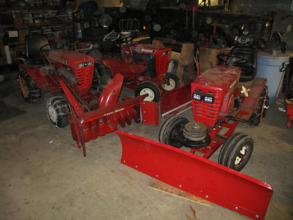

Ed Kennell 47,523 #13720 Posted November 27, 2021 Removed the deck from the 312H. Yes, I cleaned and oiled it Pete. Then installed the tiller and tilled the horse manure into the gardens. Then took the tiller off and installed the 48" blade. The 312H will be used for warm weather snow removal. The 520H with heated cab and 54" blade is ready full time for the cold weather duty. Hauled in some wood. 5 6 Share this post Link to post Share on other sites

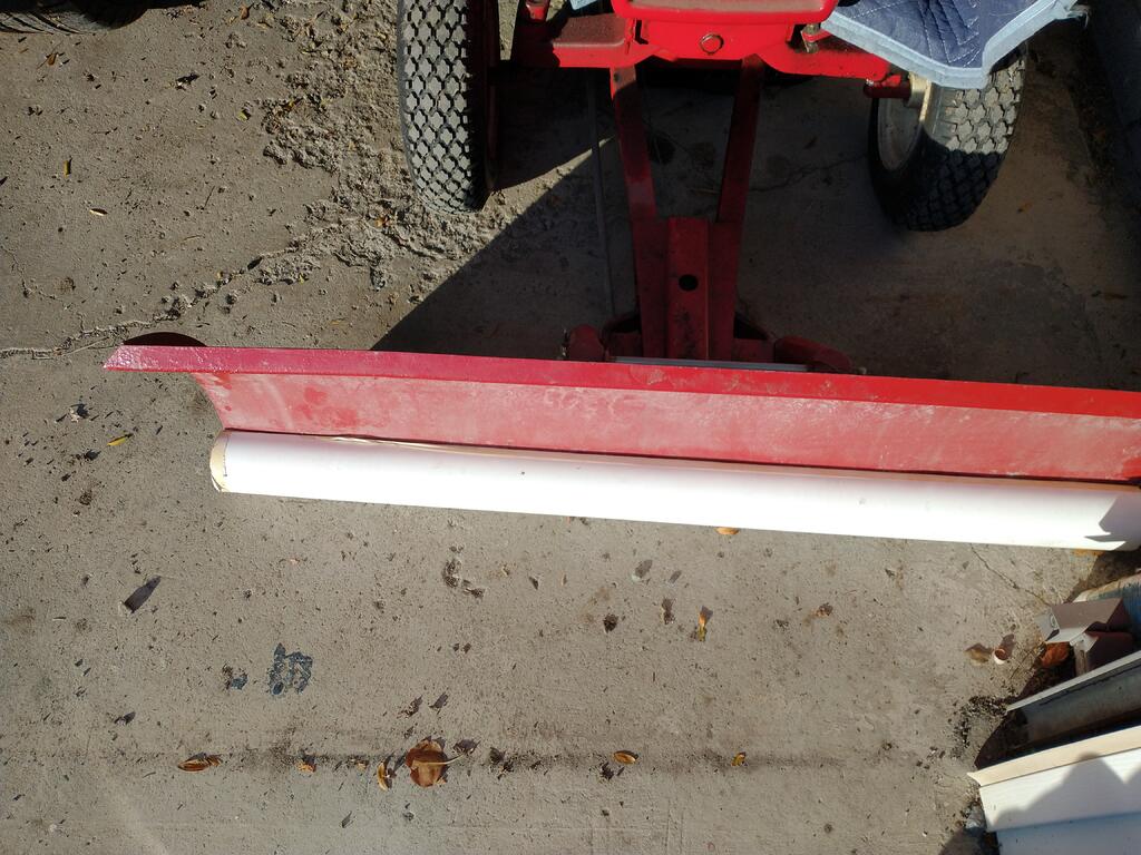

squonk 48,198 #13721 Posted November 27, 2021 2 hours ago, SylvanLakeWH said: Leaves round 10 or so… just before snow hits… And… a fail… my pvc wear bar idea crapped on me… not unexpected, but I was hopeful… I’ll just go back to the metal and set it really lightly to protect the new concrete drives… A friend gave me this idea. We both have gravel drives. He slit a piece of 3" PVC length wise. Took out about an inch wide. It snaps right onto the wear bar. He did this on his Speedex and he says it works great and doesn't dig into the gravel. If it doesn't work no big loss. 6 1 1 Share this post Link to post Share on other sites
wallfish 20,652 #13722 Posted November 27, 2021 9 minutes ago, squonk said: piece of 3" PVC length wise. If you now cut a 1 1/2" - 2" piece off the end of that so you have a C clip, they work great for locking the lids closed on the big trash/recycle bins. Keeps the varmints out! And I have as many 3" PVC pipe pieces anyone wants. 4 1 Share this post Link to post Share on other sites
