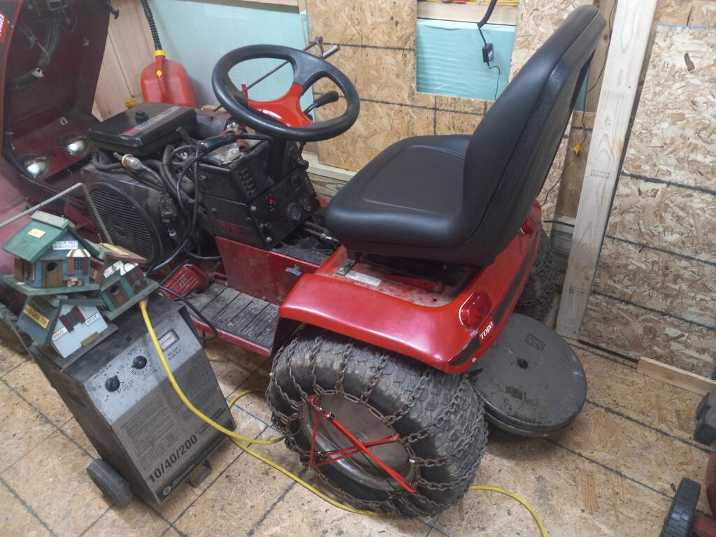

Cee245 861 #13507 Posted November 12, 2021 Got my new seat installed and put chains and weights on the 416h 6 1 Share this post Link to post Share on other sites

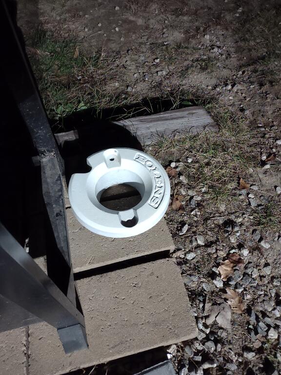

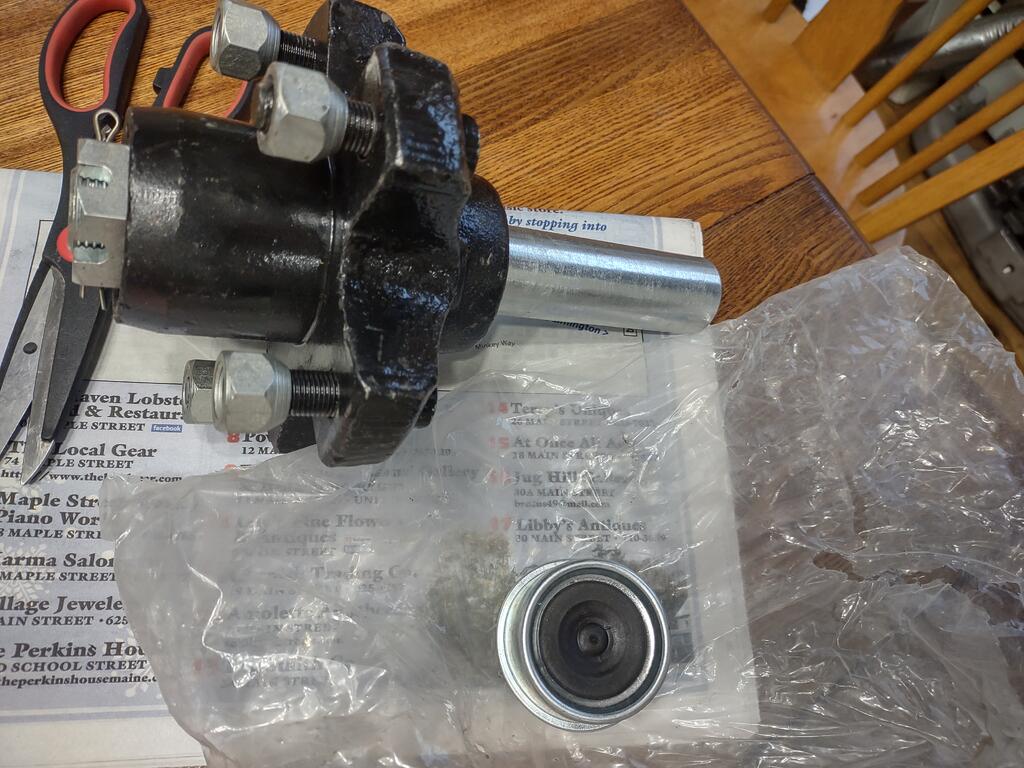

ebinmaine 80,854 #13509 Posted November 12, 2021 The local Bear 🐻 tolerant S/O aka The Paint Department put 2 coats of off white on this weight. She finds the Ace Hardware paint to spray just fine but not cover as well as her preferred Rust-Oleum 2X. If this weight stays white it'll need at least 2 more coats. Likely it'll get changed to IH Red or black. I've been gathering parts to change over (whatever tractor has the fluid filled front tires) to a 5 x 4.5 pattern trailer hub. Those tires are mounted on old crapsmen wheels which actually don't have any bearing of any kind in them. Solid 3/4" hole simply turns on the WH spindle. I've been greasing them once or twice a year for (3?) Years now. As one could imagine there's some wear on the spindles. I have a set of trailer stub axles drilled for 3/4" thanks to the generosity of a Redsquare member. I found these hub/axle kits for a VERY reasonable price. I'll set the axle stubs aside for another project. All I need now is a set of 5 x 4.5 - 8" diameter 6 or 7 wide wheels and I'll be able to have the Rimguard fluid and my own tires swapped over. 3 Share this post Link to post Share on other sites

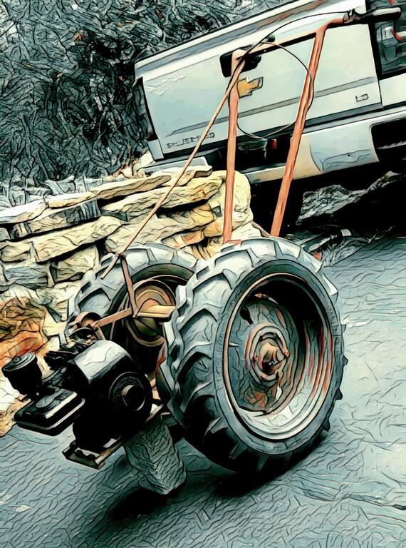

AMC RULES 37,260 #13510 Posted November 12, 2021 (edited) Finally got this old Pond walk behind mocked up with a Briggs model 6s today. Edited November 12, 2021 by AMC RULES 2 8 Share this post Link to post Share on other sites

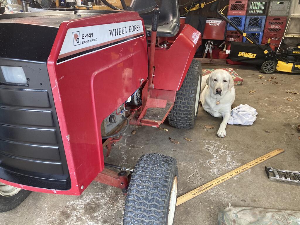

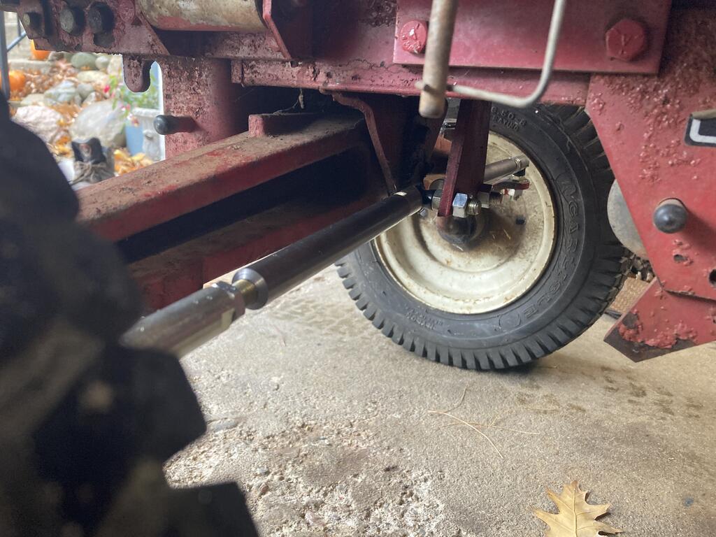

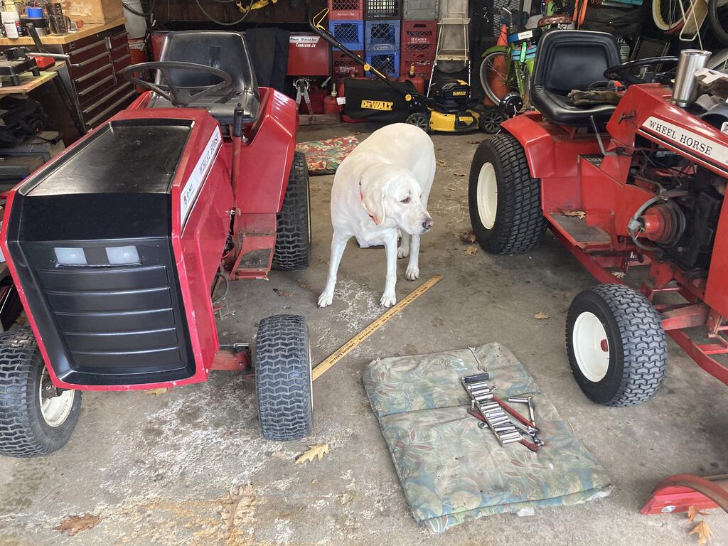

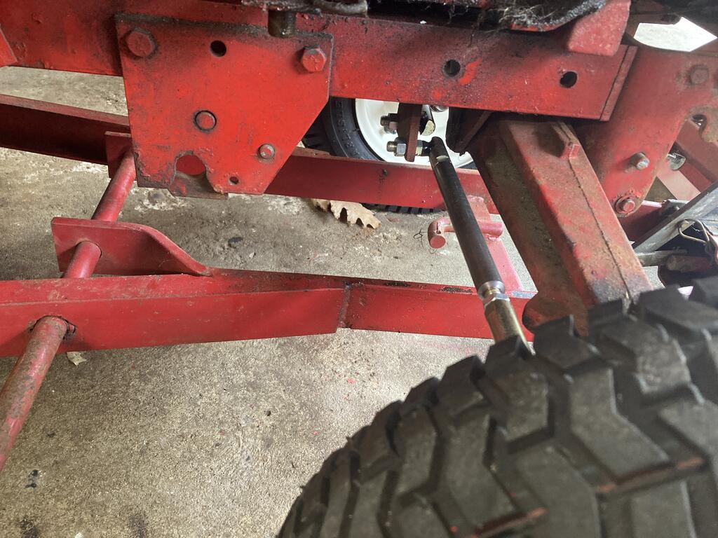

SylvanLakeWH 32,672 #13513 Posted November 13, 2021 Thanks to Lowell Wheelhorsepartsandmore the E 141 and C 105 got new tie rods this morning! Denali the shop dog was more than happy to be in the garage and not out in the rain snow sleet slime coming down at the moment… (he’d be a lot more help if he had opposable thumbs but hey, can’t get good help these days…) 7 4 Share this post Link to post Share on other sites
pfrederi 21,214 #13514 Posted November 13, 2021 You should let the dog have the mat instead of using t for a tool rest 3 Share this post Link to post Share on other sites
SylvanLakeWH 32,672 #13515 Posted November 13, 2021 1 minute ago, pfrederi said: You should let the dog have the mat instead of using t for a tool rest Notice over his right shoulder… there’s a nice flowered pad for him… (don’t show the Boss )… but he’s too tough and rugged to be filmed in the shop laying on a sissy pad… 2 Share this post Link to post Share on other sites

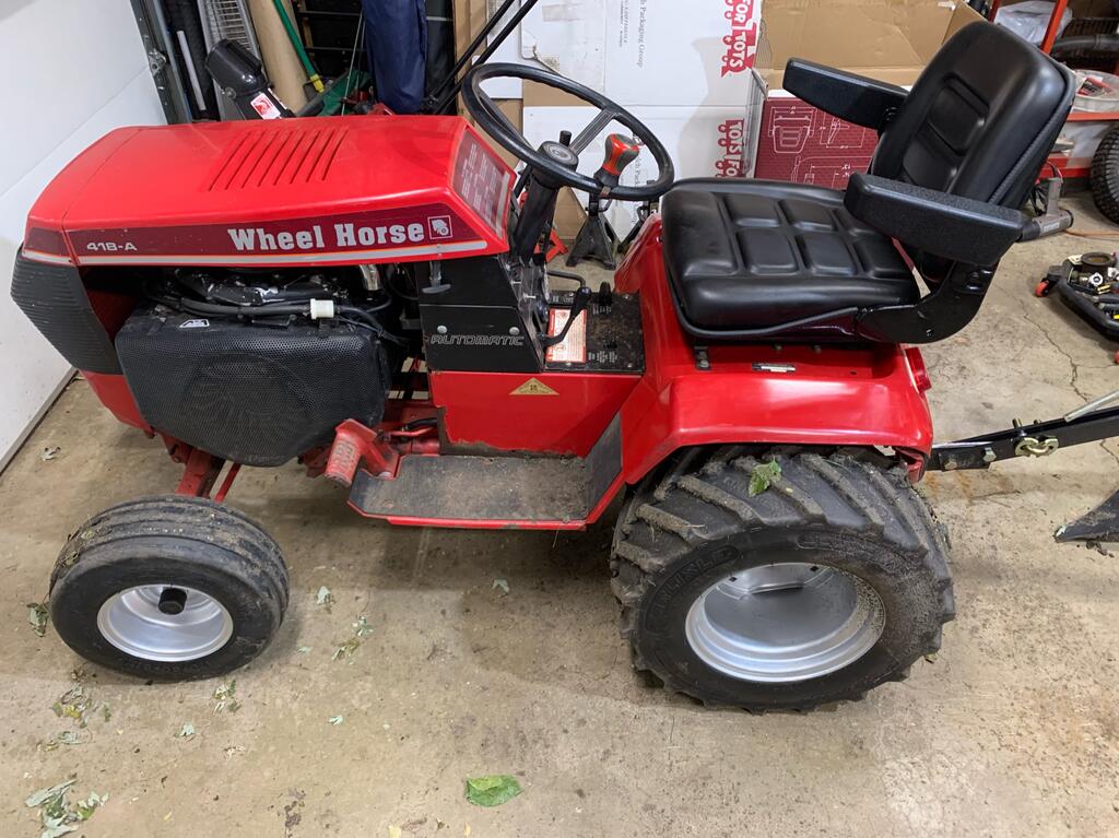

Andy N. 2,845 #13516 Posted November 13, 2021 Got a new seat installed on the 418-A. Just kidding! Here's the new seat. Very nice quality. 3 1 5 Share this post Link to post Share on other sites

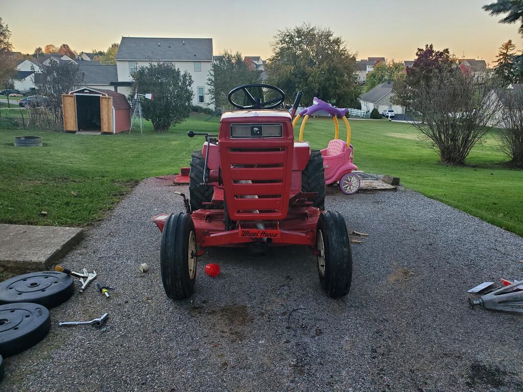

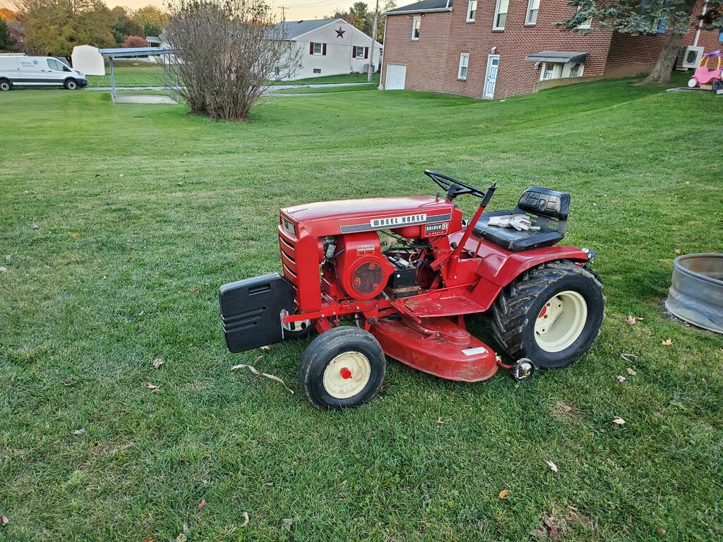

cblessj 88 #13517 Posted November 13, 2021 Fabbed up a front "bumper" to hang some suitcase weights on... 3 5 Share this post Link to post Share on other sites

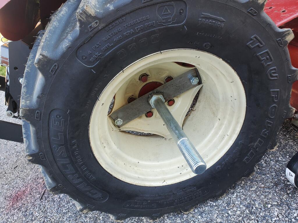

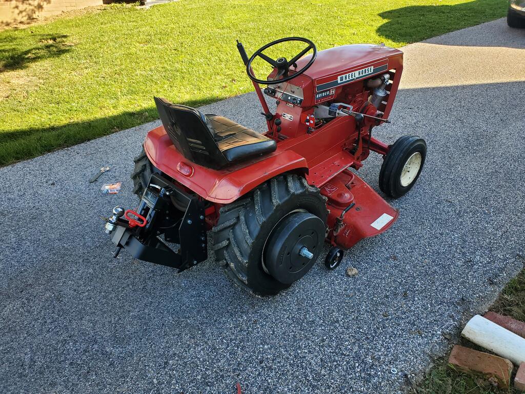

cblessj 88 #13518 Posted November 13, 2021 ...and made my own wheel weights from a $40 walmart free weight setand some steel stock i had in the shop. 50lbs + about 5lbs of hardware per wheel. 5 2 Share this post Link to post Share on other sites
cblessj 88 #13519 Posted November 13, 2021 Heres what they look like without the weights (before i painted them WH red) 8 1 Share this post Link to post Share on other sites
cblessj 88 #13520 Posted November 13, 2021 16 minutes ago, Andy N. said: Got a new seat installed on the 418-A. Just kidding! Here's the new seat. Very nice quality. If i had a seat like that, I would be afraid I would fall asleep while I was cutting the grass. Looks comfy! 3 2 Share this post Link to post Share on other sites
ebinmaine 80,854 #13521 Posted November 14, 2021 1 hour ago, Andy N. said: seat Odd as it sounds I'd be into that. All our seats are flat on the fender with no springs. 1 2 Share this post Link to post Share on other sites

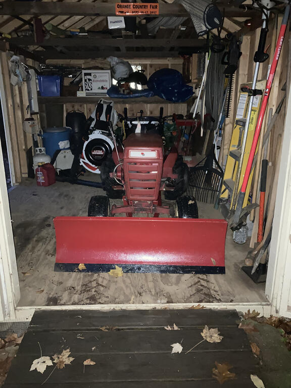

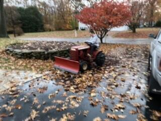

Jacob S 67 #13522 Posted November 14, 2021 I got a new 48 plow. can’t wait to plow!! 2 6 Share this post Link to post Share on other sites
SylvanLakeWH 32,672 #13523 Posted November 14, 2021 21 minutes ago, ebinmaine said: Odd as it sounds I'd be into that. All our seats are flat on the fender with no springs. Odd? No… Frugal? Cheap? Thrifty? Efficient? Yes… Cuts down on future parts costs / repairs… 3 Share this post Link to post Share on other sites
