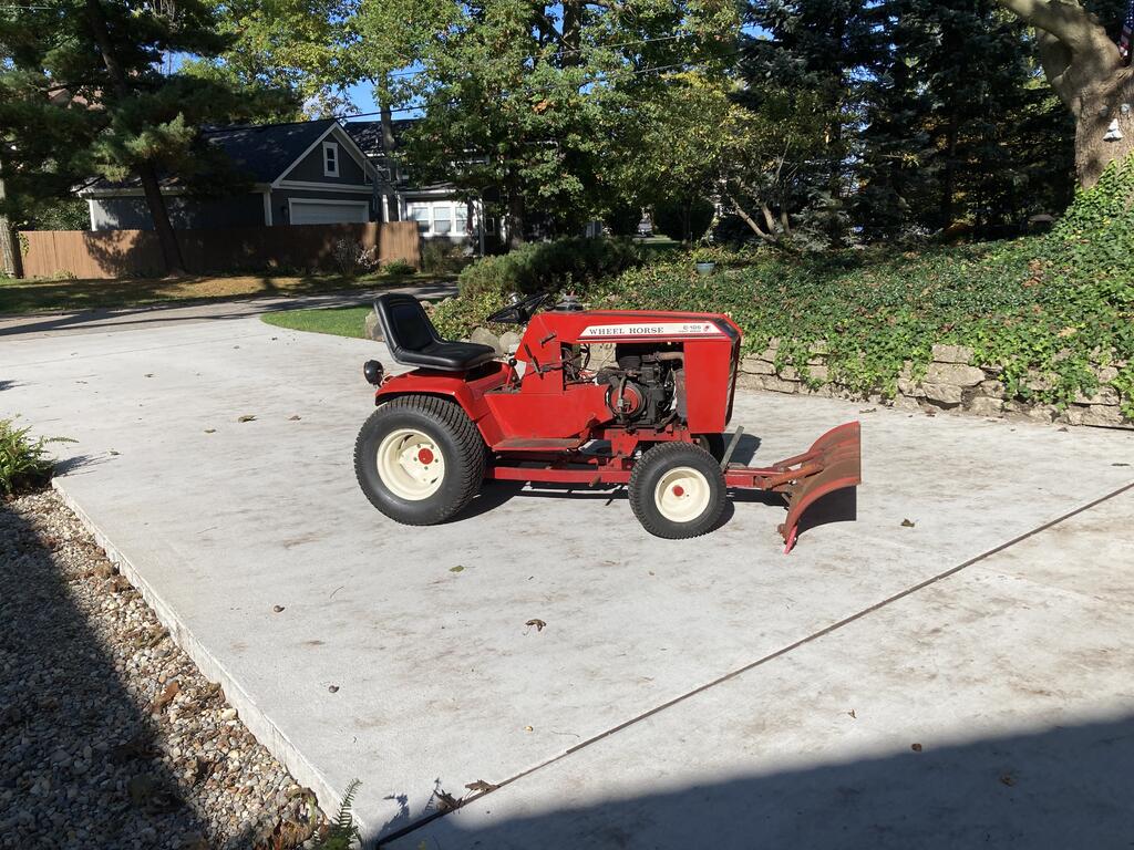

ebinmaine 81,237 #13126 Posted October 12, 2021 29 minutes ago, WheelHorse520H said: I didn’t realize the lettering was hand painted?! That’s impressive. I like it too. Trina's done a couple of ours. Really adds a lot to the look. Share this post Link to post Share on other sites
WheelHorse520H 710 #13127 Posted October 13, 2021 21 minutes ago, ebinmaine said: Really adds a lot to the look. That it does… it’s amazing how something so simple can make the rest of the machine look so nice. 1 Share this post Link to post Share on other sites

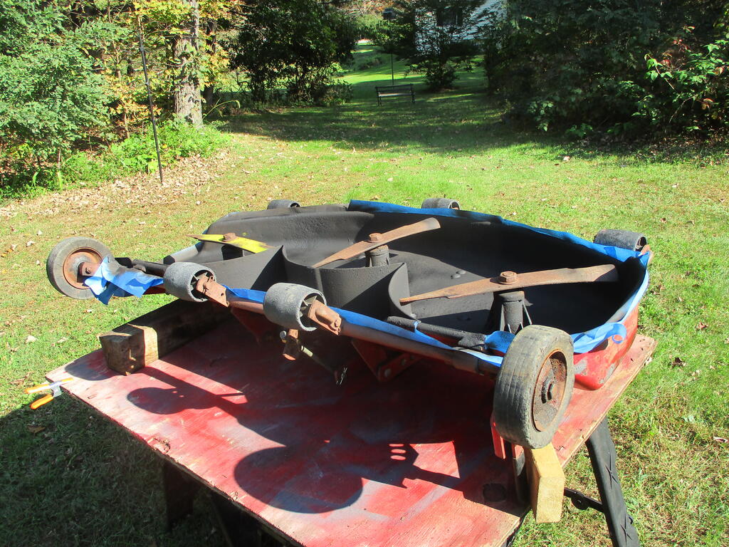

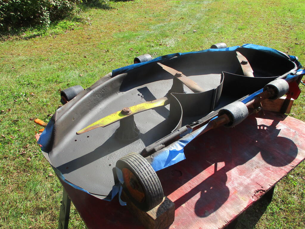

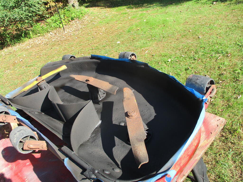

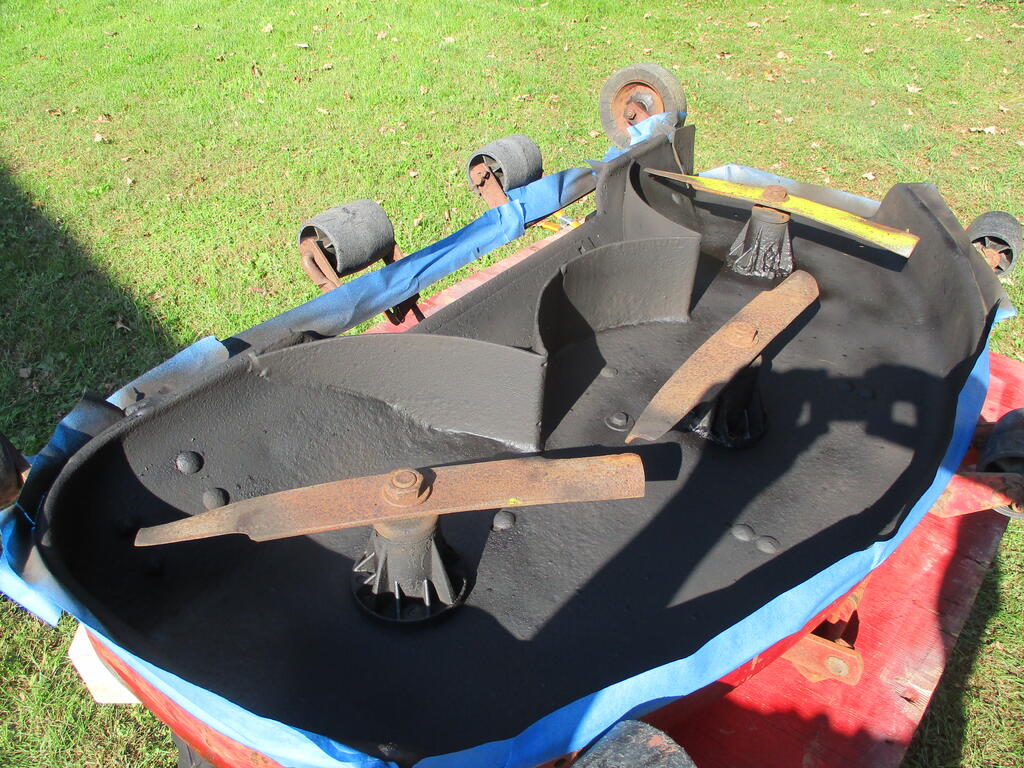

johnnymag3 2,646 #13128 Posted October 13, 2021 Got Busy covering the bottom of one of the 48" SD.....Rubberized truck bed liner, over POR-15.....VERY DURABLE. Have this treatment on a 42" and its been good for 5 years now. The bed liner is very smooth, sheds grass nicely. I do not mow WET grass, so have no info on that 6 4 Share this post Link to post Share on other sites
WheelHorse520H 710 #13129 Posted October 13, 2021 (edited) 10 hours ago, johnnymag3 said: I do not mow WET grass, so have no info on that I am wondering about mowing on wet grass. I have always heard not to because it can rot the deck but if you do under coats and protective measures like that, is it still bad? Are there other reasons to not mow wet grass? I typically mow early in the morning when the dew is still on the ground because it helps with my allergies, then I just put a little effort to clean off some of the grass. Andrew Edited October 13, 2021 by WheelHorse520H Share this post Link to post Share on other sites
johnnymag3 2,646 #13130 Posted October 13, 2021 Andrew...wet grass is sticky....it clumps...and it attaches itself to the underside of the deck. It is also a very ACIDIC . Have you seen the effect on the aluminum spindle housings? Dry grass blows out faster and easier than wet lawn. The only real way to get the deck clean from the wet grass is to take it off the tractor each time and wash the underside. There is just no substitute for LABOR if you want to mow wet grass....Just my 2 cents from 62 years of being on the planet …..Also my experience with those expensive housings !! 4 Share this post Link to post Share on other sites
WheelHorse520H 710 #13131 Posted October 13, 2021 Sorry, I forgot to specify, I usually mow with my Troy-Built push mower because I had no running tractors until this past Sunday. Thanks for the info @johnnymag3. I just never got a real reason even when I went on the Google machine. Thanks again. Now I will probably not mow wet grass because I like my money. Andrew 3 Share this post Link to post Share on other sites
Lee1977 7,813 #13132 Posted October 13, 2021 The aluminum spindle housing need to be cleaned primed and painted to help protect them from the acid. The acid is going to be there if there has been a lot of rain even if the moisture has dried up. I got a 42" deck with my 520 that had pitted housing look like they were almost trough,I painted them and will used them until there is not enough left. 2 Share this post Link to post Share on other sites

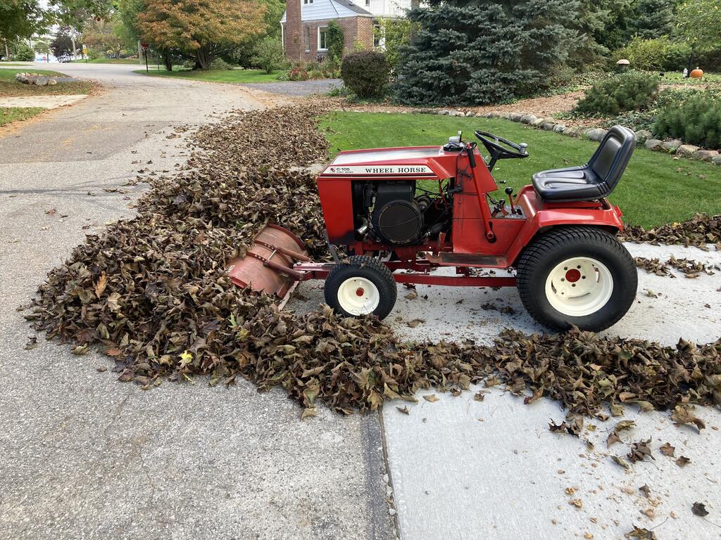

SylvanLakeWH 32,900 #13133 Posted October 13, 2021 Leaves round 1… 6 1 Share this post Link to post Share on other sites
Snoopy11 5,731 #13134 Posted October 13, 2021 32 minutes ago, SylvanLakeWH said: Leaves round 1… Maybe I am missing something... but why is your blade bent down like that? By the way, I just did that with hellhorse yesterday... should have taken pictures... But, don't worry, when the time is right, and hellhorse is digging through 3-4 feet of leaves like a banshee... I will take pictures... Don 1 Share this post Link to post Share on other sites

Gregor 4,848 #13136 Posted October 13, 2021 48 minutes ago, SylvanLakeWH said: Leaves round 1… We haven't had a lot of leaves fall yet, but it seems around here there is very little fall color. Instead of the reds, yellows, and oranges, the leaves go from green to brown, and fall. 1 Share this post Link to post Share on other sites

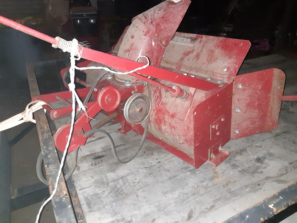

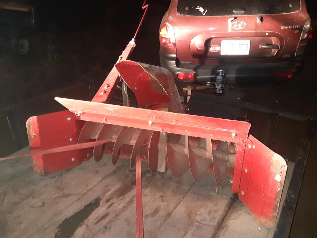

Oldskool 6,679 #13137 Posted October 13, 2021 I found myself a snowblower last night. More work for the horses,and less for me. Although I don't think I have all the pieces yet to install it. Any input from the seasoned users? Do's? Don'ts? 3 Share this post Link to post Share on other sites
SylvanLakeWH 32,900 #13138 Posted October 13, 2021 38 minutes ago, Snoopy11 said: 1 hour ago, SylvanLakeWH said: Maybe I am missing something... but why is your blade bent down like that? Brand new driveway. Put a pvc wear bar on and keeping blade at that angle and very light to reduce impact on drive… works like a charm… 2 Share this post Link to post Share on other sites

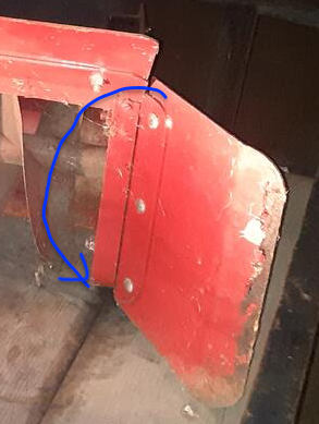

Handy Don 17,729 #13139 Posted October 13, 2021 (edited) @Oldskool Nice find. I don't see the lifting bar or its flag. Needed to connect the tractor lift mechanism to the pin at the bottom rear of the blower cylinder. Dirty for sure, but practically no rust and the auger looks straight and hardly worn. Flip the side panels so the leading edge is forward as a drift cutter and not to the side as they are now. May need to swap sides. Good luck and enjoy! Edited October 13, 2021 by Handy Don 2 1 Share this post Link to post Share on other sites
ebinmaine 81,237 #13140 Posted October 13, 2021 1 hour ago, Snoopy11 said: Maybe I am missing something... but why is your blade bent down like that 21 minutes ago, SylvanLakeWH said: Brand new driveway. Put a pvc wear bar on and keeping blade at that angle and very light to reduce impact on drive… works like a charm… I keep the snow blades bent forward like that on both my machine and Trina's all winter. I find that the snow rolls off to the side better and as stated there is much less aggressive digging on our dirt/stone driveway. 4 Share this post Link to post Share on other sites
Bill D 3,199 #13141 Posted October 13, 2021 18 hours ago, johnnymag3 said: Got Busy covering the bottom of one of the 48" SD.....Rubberized truck bed liner, over POR-15.....VERY DURABLE. Have this treatment on a 42" and its been good for 5 years now. The bed liner is very smooth, sheds grass nicely. I do not mow WET grass, so have no info on that Nice. Is that the spray on bed liner in the can that you can buy at Home Depot? I may have to do this on my Bobcat deck. 1 Share this post Link to post Share on other sites
johnnymag3 2,646 #13142 Posted October 13, 2021 Its a Dupont Spray....Auto Parts store 1 Share this post Link to post Share on other sites
Oldskool 6,679 #13143 Posted October 13, 2021 5 hours ago, Handy Don said: @Oldskool Nice find. I don't see the lifting bar or its flag. Needed to connect the tractor lift mechanism to the pin at the bottom rear of the blower cylinder. Dirty for sure, but practically no rust and the auger looks straight and hardly worn. Flip the side panels so the leading edge is forward as a drift cutter and not to the side as they are now. May need to swap sides. Good luck and enjoy! Lift bar? Flag? Please enlighten me. I will try flipping those side panels. Thanks Don. 1 Share this post Link to post Share on other sites
Wheelhorse#1 1,998 #13144 Posted October 13, 2021 (edited) 23 hours ago, WheelHorse520H said: I didn’t realize the lettering was hand painted?! That’s impressive. Thanks for the compliments on the hand painted lettering.However,I can’t lie.It was done with a black sharpie. Trust me If I had painted with a brush it would looked like a blind person painted it and that would be a complement 😆 Edited October 13, 2021 by Wheelhorse#1 4 Share this post Link to post Share on other sites
ebinmaine 81,237 #13145 Posted October 13, 2021 9 minutes ago, Wheelhorse#1 said: Thanks for the compliments on the hand painted lettering.However,I can’t lie.It was done with a black sharpie. Trust me If I had painted with a brush it would looked like a blind person painted it😆 Paint pens work fairly well for an application like that too. 3 Share this post Link to post Share on other sites

Handy Don 17,729 #13147 Posted October 13, 2021 20 minutes ago, Oldskool said: Lift bar? Flag? Please enlighten me. I will try flipping those side panels. Thanks Don. Snowblowers lift by pushing forward on the bottom of the blower while it pivots around the front Attach-a-Matic to get the it off the ground by a few inches. The lift bar and flag connect the "pushing" rockshaft in the tractor to the blower. This is a thread that discussed making these things for one model (the lengths vary somewhat depending on tractor model and blower model). The thread also has a link to this thread: For a guy with your "parts" pile and skills, making one of these sets will be straightforward. I will call your attention to the idea of making the rod on the flag a bit longer, leaving the lift bar pipe a bit shorter, and then using spacers or washers on that rod to adjust the lifting height. Of course, you might want to just ask the PO if s/he still has them and could you pick them up! The snowblower OMs in the file section show how to do the installs so search there using the model number of your blower! 1 1 Share this post Link to post Share on other sites
WheelHorse520H 710 #13148 Posted October 13, 2021 44 minutes ago, Wheelhorse#1 said: However,I can’t lie.It was done with a black sharpie. Got the job done, didn’t it? I never would have known. 2 Share this post Link to post Share on other sites
Snoopy11 5,731 #13149 Posted October 13, 2021 7 hours ago, SylvanLakeWH said: Brand new driveway. Put a pvc wear bar on and keeping blade at that angle and very light to reduce impact on drive… works like a charm… 6 hours ago, ebinmaine said: I keep the snow blades bent forward like that on both my machine and Trina's all winter. I find that the snow rolls off to the side better and as stated there is much less aggressive digging on our dirt/stone driveway. I wonder how good it would work on gravel? That is what I have... Don 2 Share this post Link to post Share on other sites
Oldskool 6,679 #13150 Posted October 13, 2021 25 minutes ago, Handy Don said: Snowblowers lift by pushing forward on the bottom of the blower while it pivots around the front Attach-a-Matic to get the it off the ground by a few inches. The lift bar and flag connect the "pushing" rockshaft in the tractor to the blower. This is a thread that discussed making these things for one model (the lengths vary somewhat depending on tractor model and blower model). The thread also has a link to this thread: For a guy with your "parts" pile and skills, making one of these sets will be straightforward. I will call your attention to the idea of making the rod on the flag a bit longer, leaving the lift bar pipe a bit shorter, and then using spacers or washers on that rod to adjust the lifting height. Of course, you might want to just ask the PO if s/he still has them and could you pick them up! The snowblower OMs in the file section show how to do the installs so search there using the model number of your blower! Thanks for the info Don. I will look into that thread. The PO doesn't have it. They bought the house with some WH stuff in the barn. They sold all but the blower. I think when they sold the tiller some blower stuff went with it, because I ended up with tiller items with the blower. 1 2 Share this post Link to post Share on other sites
