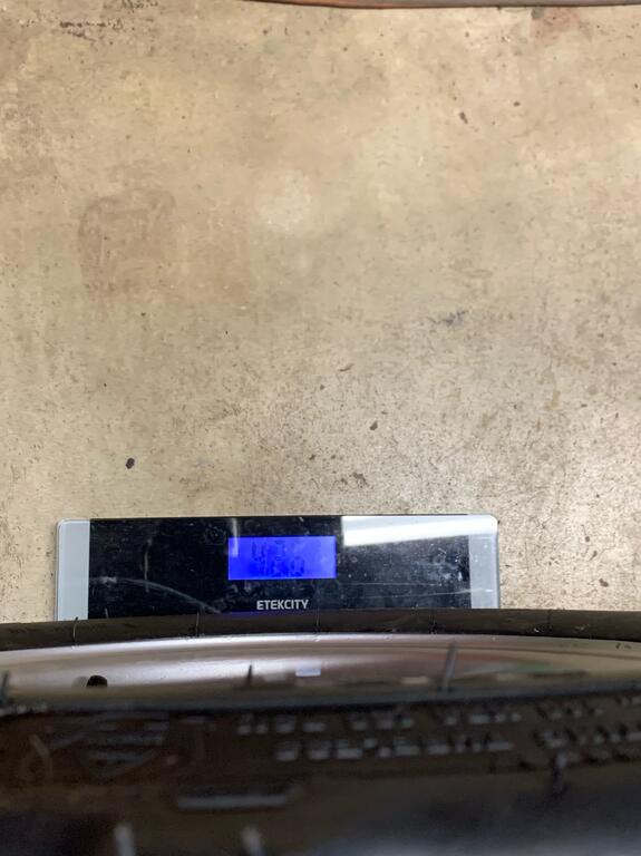

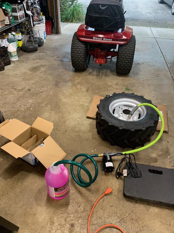

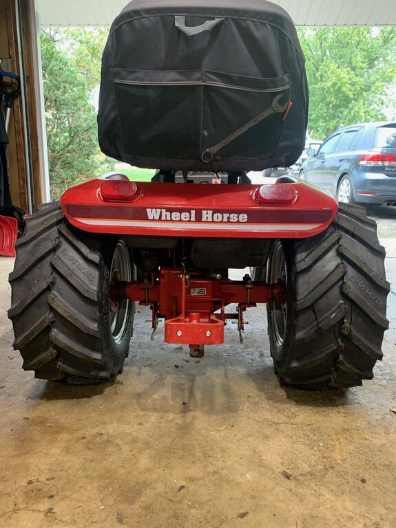

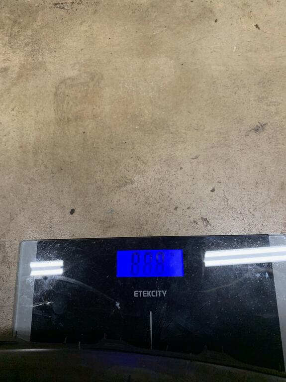

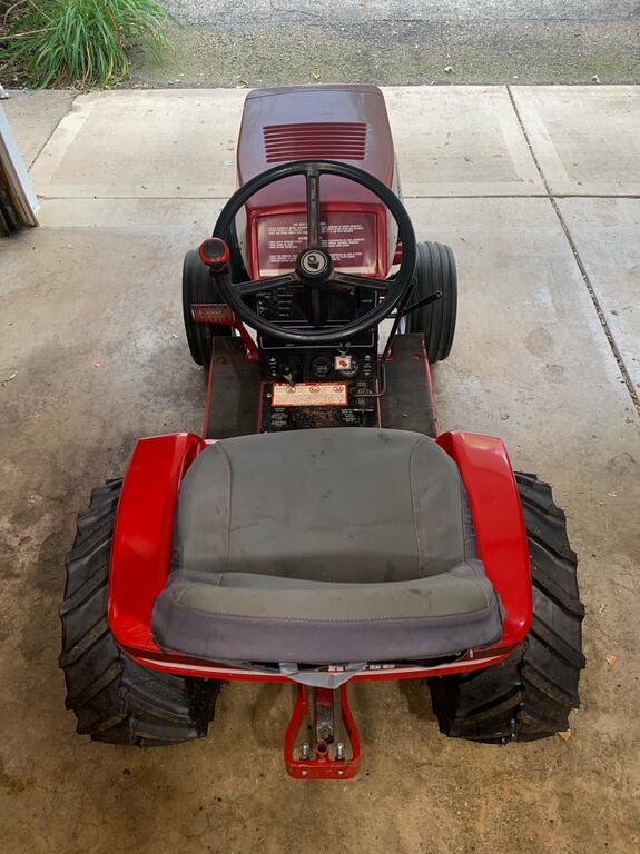

Andy N. 2,812 #13001 Posted October 2, 2021 (edited) I got the 418-A ready for fall (dirt) and winter (snow) plowing. 6 gallons of RV antifreeze fluid in each tire and weight went from 42.6 lbs. to 88.8 lbs. Edited October 2, 2021 by Andy N. 7 7 Share this post Link to post Share on other sites

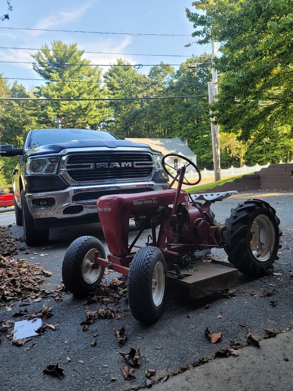

Jhook 849 #13002 Posted October 2, 2021 (edited) Mowed for the first time today with the new rj58 after finally finding a deck for it. The kohler k91 did well in tall grass. Edited October 2, 2021 by Jhook 4 Share this post Link to post Share on other sites

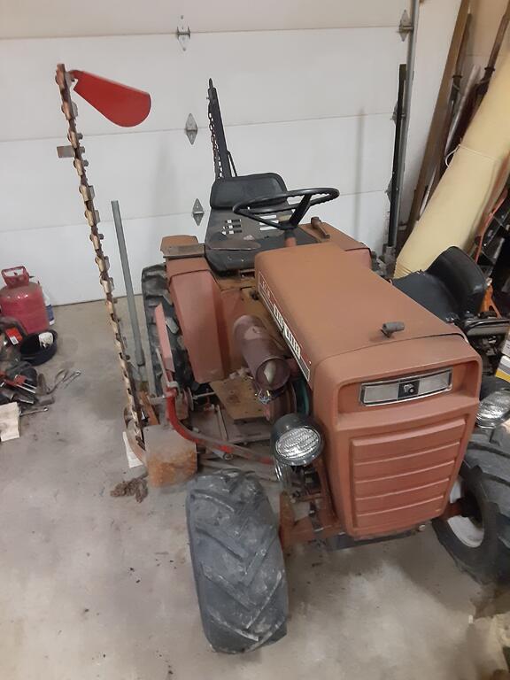

Oldskool 6,678 #13003 Posted October 2, 2021 This afternoon I finally started putting the Haban syckle bar mower on the GT14. 5 2 Share this post Link to post Share on other sites
Jhook 849 #13004 Posted October 2, 2021 Looking good just needs some maintenance on the deck to quiet it down some. 7 7 Share this post Link to post Share on other sites

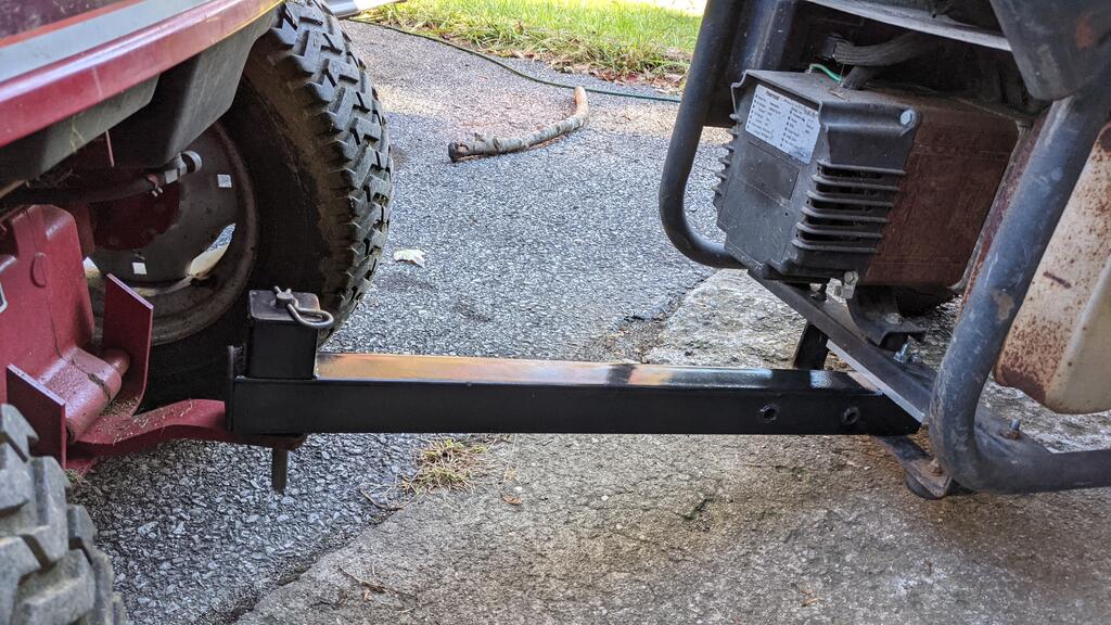

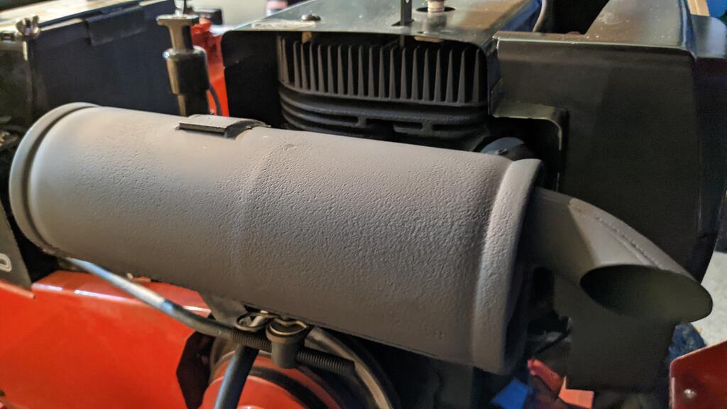

echris 1,426 #13005 Posted October 3, 2021 Hey guys, remember me? Long time since I've been here. Hope everyone is well! The rusted muffler on my '89 310-8 has been bugging me since I got it last year. I don't want to lose it, they're too pricey to replace. Today, I finally removed it, cleaned it up and painted it. I was happy to see no rust on the baffles from both the input and output side. You can see how bad the pitting was, but it still completely solid! Hoping this will give it a few more years of life! And last weekend, I made a 3/4-assed trailer hitch for my generator. She lives in the backyard, and dragging it all the way around the house to the garage, makes me never service it. Some powder coated 2" square tubing hacked off an old piece of exercise equipment, 2 aluminum plates epoxied together and machined to size, a few 5/16" holes, a 3/8" pin cross-drilled for hitch clips and presto! I will now regularly service my generator. (Also an excuse for more seat time!!!) That block on top of the tractor side of the hitch; I was going to grind off the welds and chuck it, but well... no need. It works perfectly. Leaving it. 8 5 Share this post Link to post Share on other sites

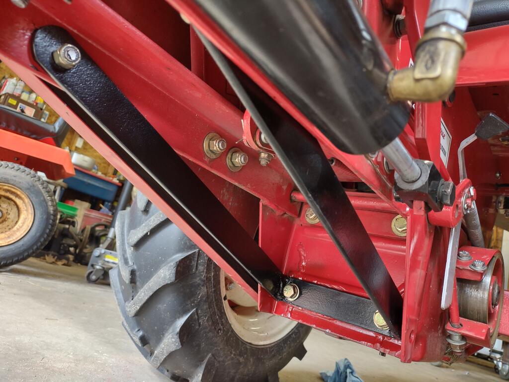

Achto 32,687 #13007 Posted October 3, 2021 Added some traction bars to my Raider 12 plow tractor. Actually I added this to strengthen the F plate tranny mount. 10 16 Share this post Link to post Share on other sites

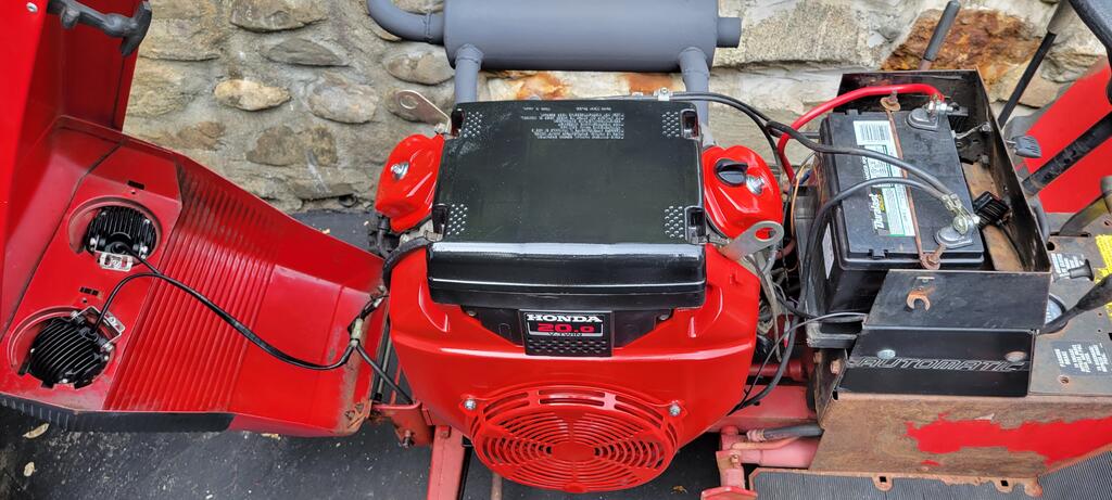

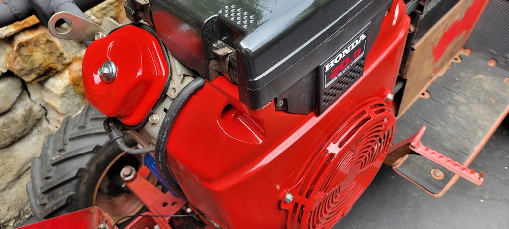

AMC RULES 37,259 #13008 Posted October 3, 2021 Gave the Honda-Horse it's red head conversion today. 12 7 1 Share this post Link to post Share on other sites
19richie66 17,935 #13009 Posted October 3, 2021 2 hours ago, AMC RULES said: Gave the Honda-Horse it's red head conversion today. Looks sweet! 3 Share this post Link to post Share on other sites
19richie66 17,935 #13010 Posted October 3, 2021 3 hours ago, Achto said: Added some traction bars to my Raider 12 plow tractor. Actually I added this to strengthen the F plate tranny mount. Should hold up well👍 3 1 Share this post Link to post Share on other sites

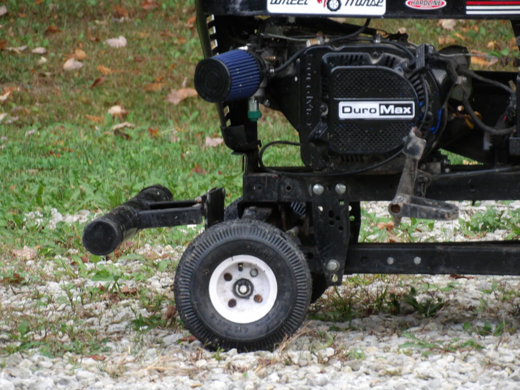

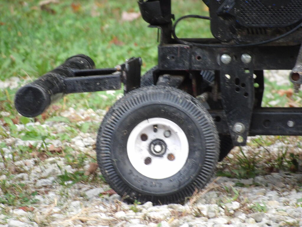

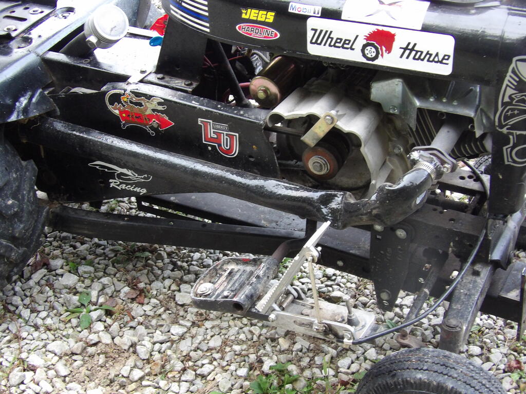

Snoopy11 5,731 #13011 Posted October 3, 2021 Put a new filter on, rejetted, put some new rubbers on the front... (I like these front tires better than the other ones I had on it)... and taught a family member (who is camera shy... refused to be photographed... LOL) how to drive the HellHorse... Oh, and I put an exhaust sleeve on it to keep from burning myself over and over... Don 5 2 Share this post Link to post Share on other sites
echris 1,426 #13012 Posted October 3, 2021 4 hours ago, AMC RULES said: Honda-Horse No, no, no. It should be called a Horse Honda. Because first, it's "A Wheel Horse, Of Course ™." Nice work though. 2 Share this post Link to post Share on other sites
kpinnc 18,960 #13013 Posted October 4, 2021 6 hours ago, AMC RULES said: Gave the Honda-Horse it's red head conversion today. Be careful! Every time I paint a single part, the dang whole tractor gets painted somehow... Looks really nice! 2 3 Share this post Link to post Share on other sites
WHX?? 58,114 #13014 Posted October 4, 2021 Really good idea on the beefing up Dan .... @Andy N. you need that bring that beast upto plow day! 2 Share this post Link to post Share on other sites

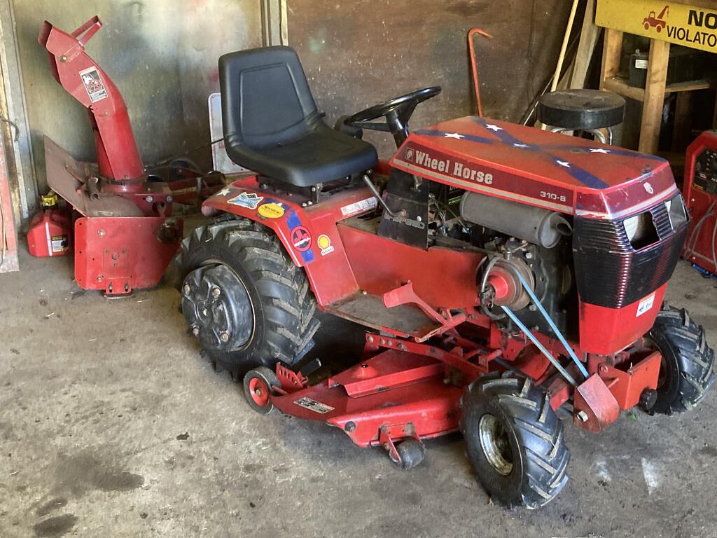

Ifixoldjunk 778 #13020 Posted October 5, 2021 Well, all things have to come to an end, today I’ve started “unrednecking” my Dixie horse 310 4 Share this post Link to post Share on other sites
Ifixoldjunk 778 #13021 Posted October 5, 2021 this is the Dixie horse prior to me swapping the rear fender and paint prepping the hood 4 Share this post Link to post Share on other sites
JoeM 10,267 #13022 Posted October 5, 2021 On 10/2/2021 at 6:39 PM, Andy N. said: 6 gallons of RV antifreeze fluid in each tire Works well with those tires, and if you really want them to bite, use only 5-6 lbs. of air pressure. 3 Share this post Link to post Share on other sites

ebinmaine 80,694 #13024 Posted October 5, 2021 1 minute ago, JoeM said: Works well with those tires, and if you really want them to bite, use only 5-6 lbs. of air pressure. I don't even use any air pressure at all. I have 10.5 x 23 x 12 Carlisle AG tires on the back of my c-160. I had those fluid filled probably 4 years ago? Over 7 gallons per tire. I've never once checked the air pressure because the fluid is above the level of the valve. The tires have a nice squish to them and grab very very well. Share this post Link to post Share on other sites
JoeM 10,267 #13025 Posted October 5, 2021 1 minute ago, ebinmaine said: Over 7 gallons per tire. Yep works well too, but with 6 gallon it is a little too soft. At least for mowing on my hills. On the mine the stem is at 12 and tractor jacked up, I can still add air. If adding the full 10 lbs or so of air, I found tires turn to rock. Something of an experiment 1 Share this post Link to post Share on other sites
