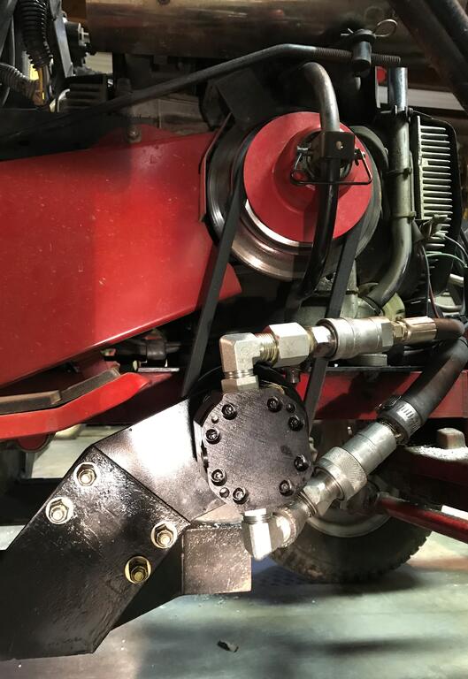

lynnmor 9,019 #12326 Posted July 26, 2021 4 hours ago, Shynon said: The ols Cessna pump on the loader blew out the side the other day. So on my only day off I made a new pump bracket for the new pump. I used the same pump and made a bracket that had a dogleg so the belt would be away from the PTO hoop. 3 2 Share this post Link to post Share on other sites
Dan.gerous 2,696 #12327 Posted July 26, 2021 4 hours ago, lynnmor said: I used the same pump and made a bracket that had a dogleg so the belt would be away from the PTO hoop. That bracket is a thing of beauty! How do you cut the slotted holes? Always keen to improve my below average metal work skills. 1 Share this post Link to post Share on other sites

lynnmor 9,019 #12329 Posted July 26, 2021 6 hours ago, Dan.gerous said: How do you cut the slotted holes? Always keen to improve my below average metal work skills. I have a tool & die shop and did the machining on a Bridgeport vertical milling machine using end mills. The steel is 4140 HT so it should outlast the tractor and loader. I bored the large hole for the pump boss for a perfect fit so that the bolt holes don't take much of a load. I used 4 bolts to mount the bracket to the sub-frame after having too many problems with the original 2 bolt setup. I left a web between each pair of slots to keep the slots from spreading. The sub-frame was supposed to fit a number of Wheelhorse models but, as you can see there would be interference with the PTO hoop and the floor board if the pump were mounted directly in line with the mount. 5 1 Share this post Link to post Share on other sites

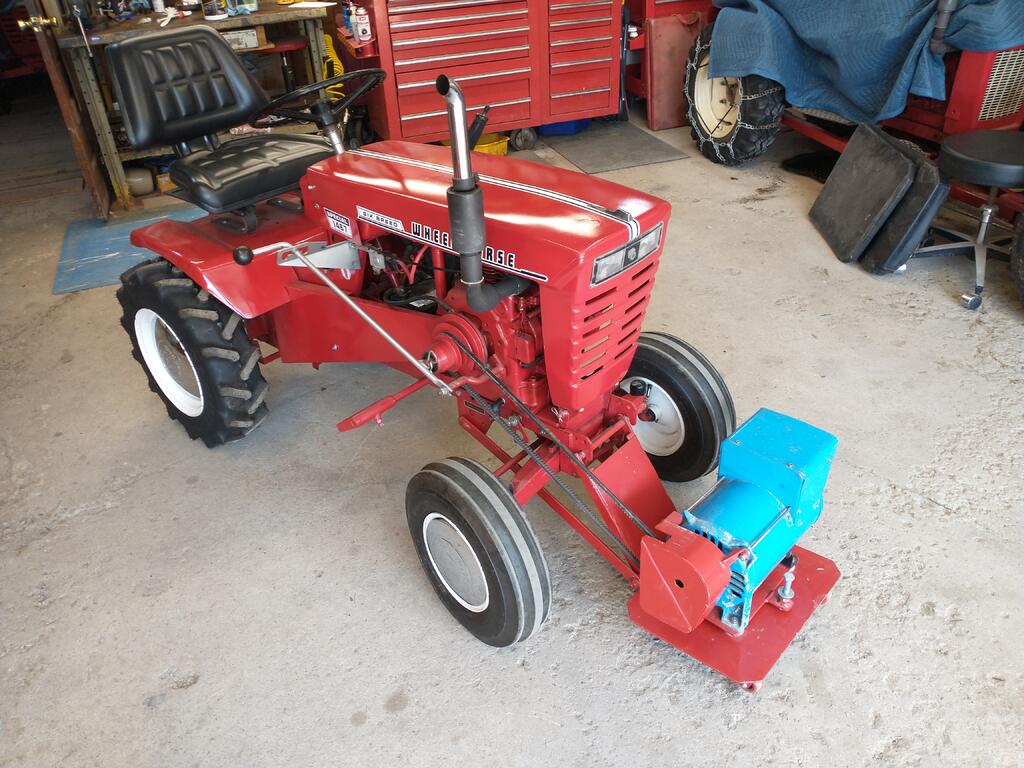

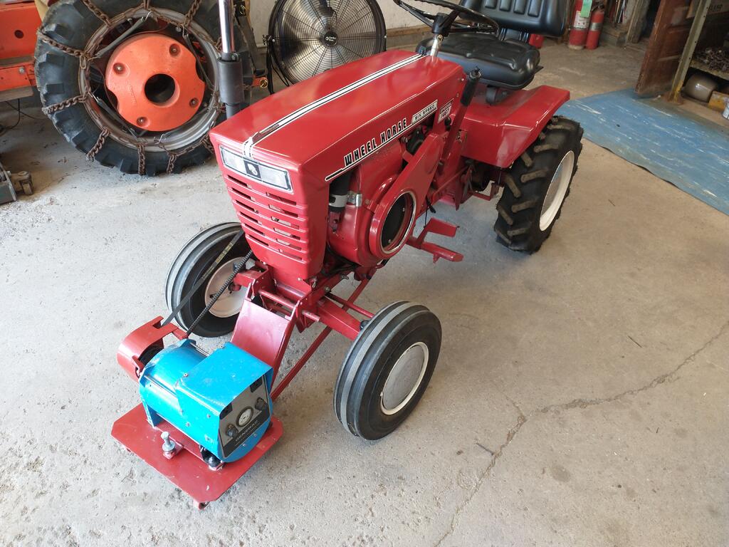

squonk 47,920 #12330 Posted July 26, 2021 (edited) Getting things sorted for the steam pageant in 3 weeks. Cleaned up the 1467 Special and 3000W Generac Genny! Edited July 26, 2021 by squonk 4 5 Share this post Link to post Share on other sites

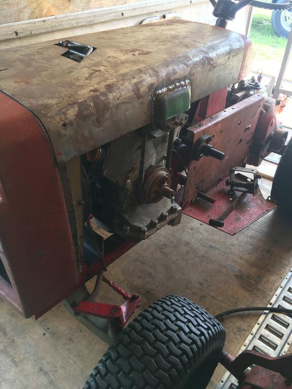

19richie66 17,932 #12332 Posted July 26, 2021 Had to bump out the hood side for the water pump. ✅ 8 Share this post Link to post Share on other sites
Snoopy11 5,731 #12333 Posted July 26, 2021 12 hours ago, Dan.gerous said: That bracket is a thing of beauty! How do you cut the slotted holes? Always keen to improve my below average metal work skills. Die grinder with cobalt bits would do that trick... might take a few minutes though... Don 1 1 Share this post Link to post Share on other sites

Snoopy11 5,731 #12335 Posted July 26, 2021 15 minutes ago, 19richie66 said: Had to bump out the hood side for the water pump. ✅ Do... you plan to cover that hole? Don 1 Share this post Link to post Share on other sites
19richie66 17,932 #12336 Posted July 26, 2021 (edited) 41 minutes ago, Snoopy11 said: Do... you plan to cover that hole? Don Yes but waiting to find the right piece of the puzzle to weld up there. 👍 Edited July 26, 2021 by 19richie66 1 Share this post Link to post Share on other sites

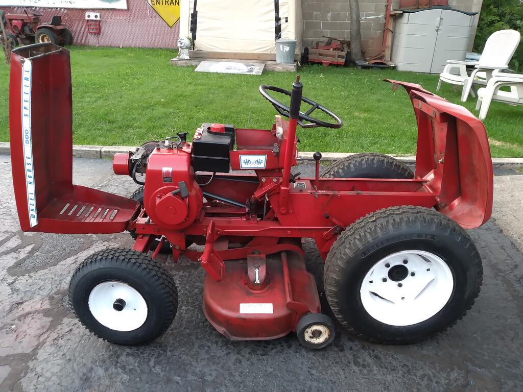

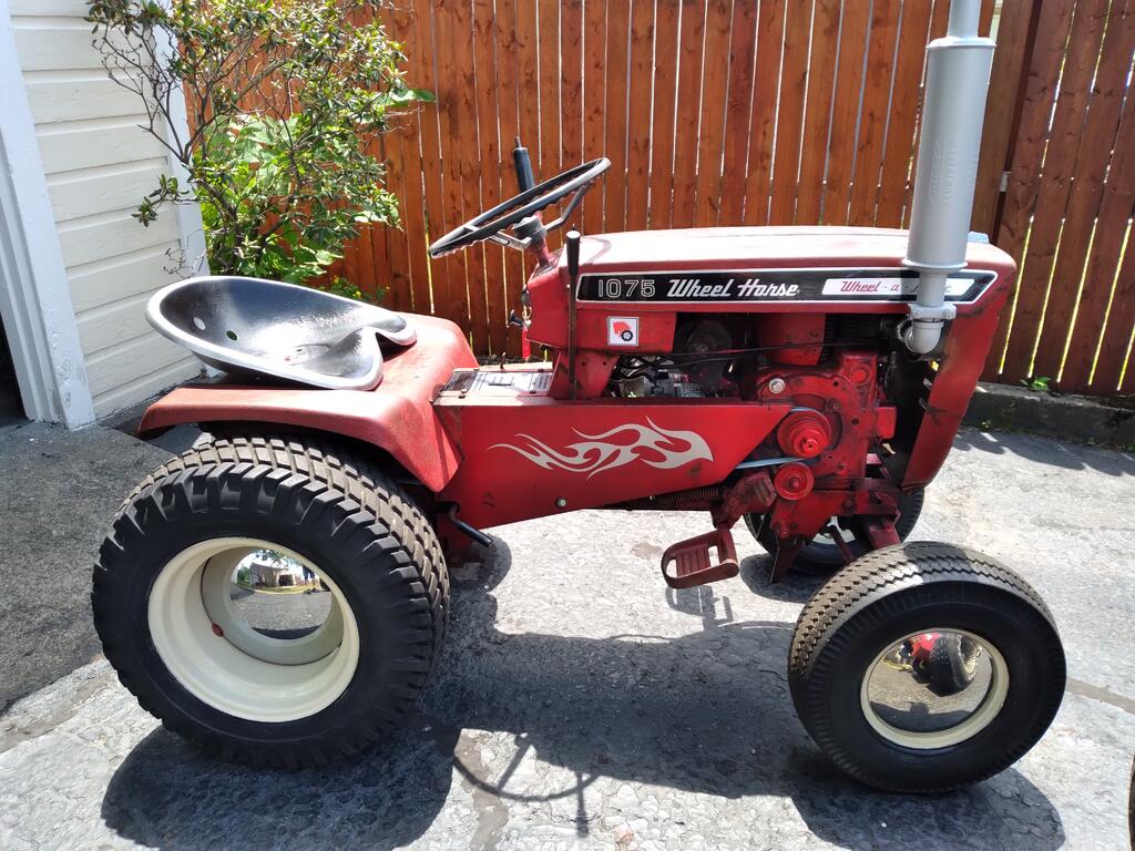

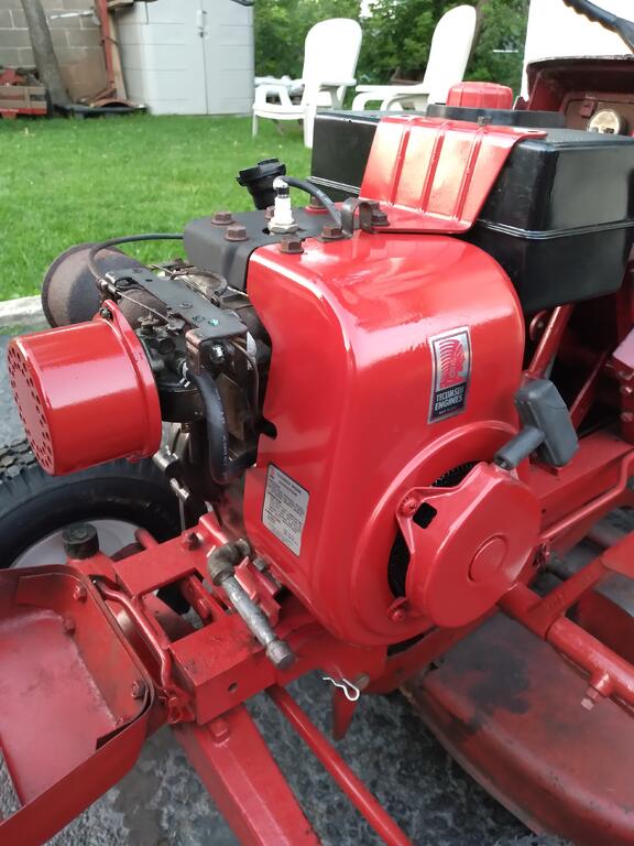

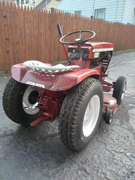

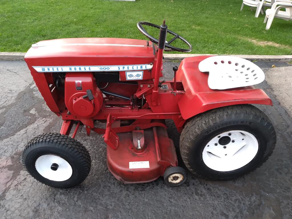

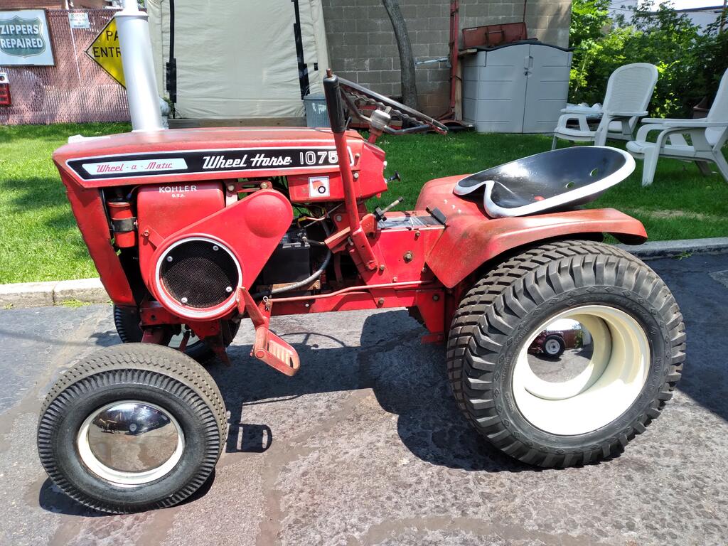

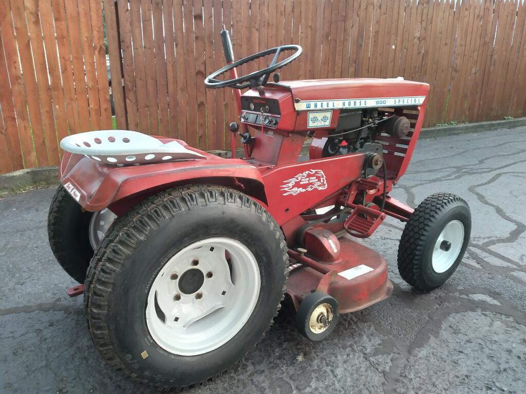

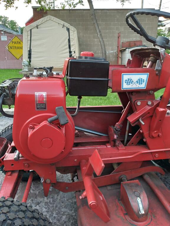

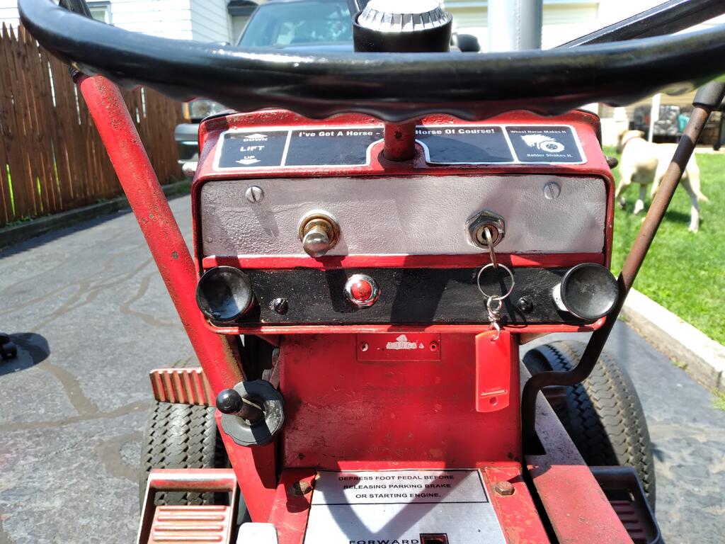

D_Mac 9,339 #12341 Posted July 27, 2021 (edited) Spent the day doing a little detailing on the 1075 and the 500 Special. I think I am finished with them both now. Next is the engine swap on the 875. Edited July 27, 2021 by D_Mac 5 6 Share this post Link to post Share on other sites
AMC RULES 37,259 #12342 Posted July 27, 2021 You do know Terry (Vinylguy)offers both of those dash decals in his inventory. 👍 2 1 Share this post Link to post Share on other sites
squonk 47,920 #12343 Posted July 27, 2021 9 hours ago, D_Mac said: Next is the engine swap on the 875. Don't forget to put oil in it! 2 1 Share this post Link to post Share on other sites
D_Mac 9,339 #12344 Posted July 27, 2021 10 hours ago, AMC RULES said: You do know Terry (Vinylguy)offers both of those dash decals in his inventory. 👍 I do have the dash decals for 1 of them. I already had the paint out so I decided to paint them insted. 1 hour ago, squonk said: Don't forget to put oil in it! Oil will be added. 1 1 Share this post Link to post Share on other sites
cschannuth 3,821 #12345 Posted July 27, 2021 On 7/26/2021 at 12:43 AM, Dan.gerous said: How do you cut the slotted holes? if you don’t have access to a mill I just drilled holes at the end of the slots and then I used my jigsaw with metal cutting blades to cut the material out between the holes to create the slot. If you take your time the slots will be fairly clean and only require a small amount of filing to make them look really nice. 4 1 Share this post Link to post Share on other sites
WHX?? 57,853 #12346 Posted July 27, 2021 17 hours ago, 19richie66 said: Yes but waiting to find the right piece of the puzzle to weld up there. 👍 No brainer Ritchie... one of those covers for a bevel gear deck..... 3 Share this post Link to post Share on other sites
Dan.gerous 2,696 #12347 Posted July 27, 2021 58 minutes ago, cschannuth said: if you don’t have access to a mill I just drilled holes at the end of the slots and then I used my jigsaw with metal cutting blades to cut the material out between the holes to create the slot. If you take your time the slots will be fairly clean and only require a small amount of filing to make them look really nice. That's the level of technology that I have 🙂 Made some brackets up for the pig huts that had elongated holes, but I used the plasma cutter. It was rough but suitable for the job, only going on some rusty angle iron and then buried in mud for most of the year. 1 Share this post Link to post Share on other sites
19richie66 17,932 #12348 Posted July 27, 2021 (edited) 5 hours ago, WHX24 said: No brainer Ritchie... one of those covers for a bevel gear deck..... nope…. Too tall and not wide enough. BUT, a gt14 rear fender top cut just right lays on there nicely. And I had several 😁 Edited July 27, 2021 by 19richie66 3 1 Share this post Link to post Share on other sites

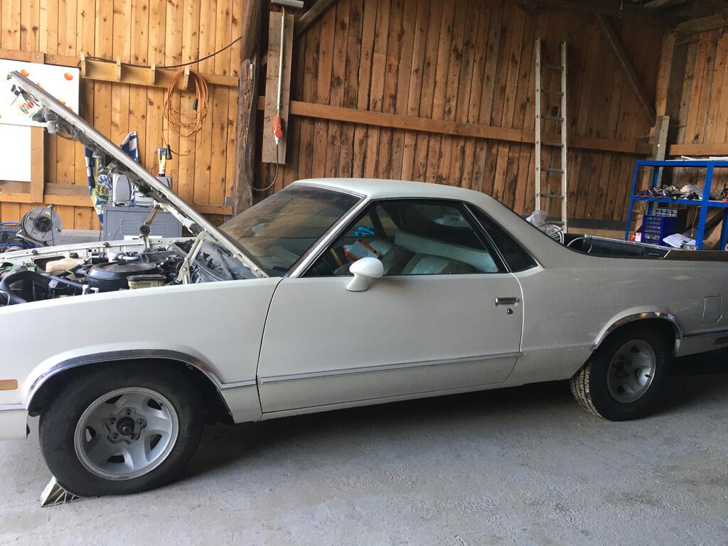

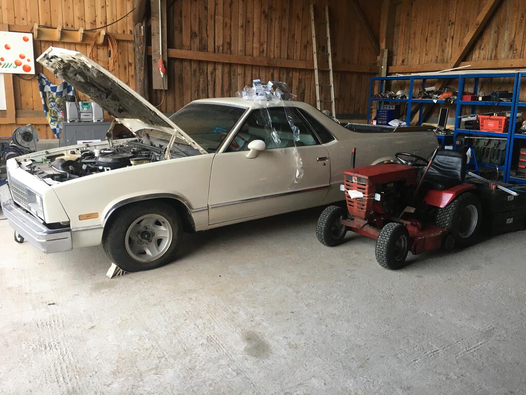

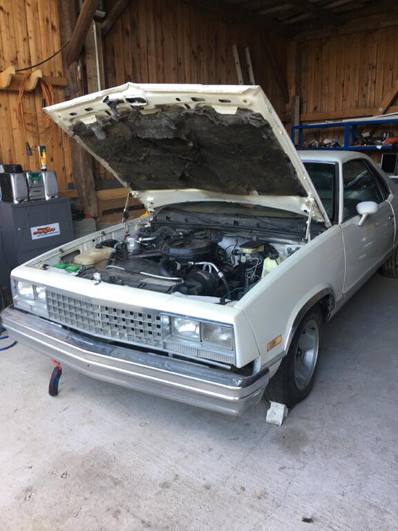

Tractorhead 9,217 #12349 Posted July 27, 2021 Give Karsten - a newbie here in our grown „Shed wrenching group“ a warmly Welcome. Have a first look at his „ crazyness“.. yap, he definitively fits in our Group... First take a closer look to the Engine... yap, nice He will finish his project step by step... great project Even the horse feels fine aside. So let‘s begin to mount some Light in his Area.... 4 1 Share this post Link to post Share on other sites

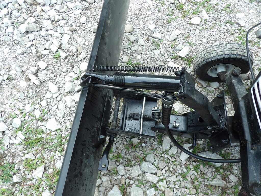

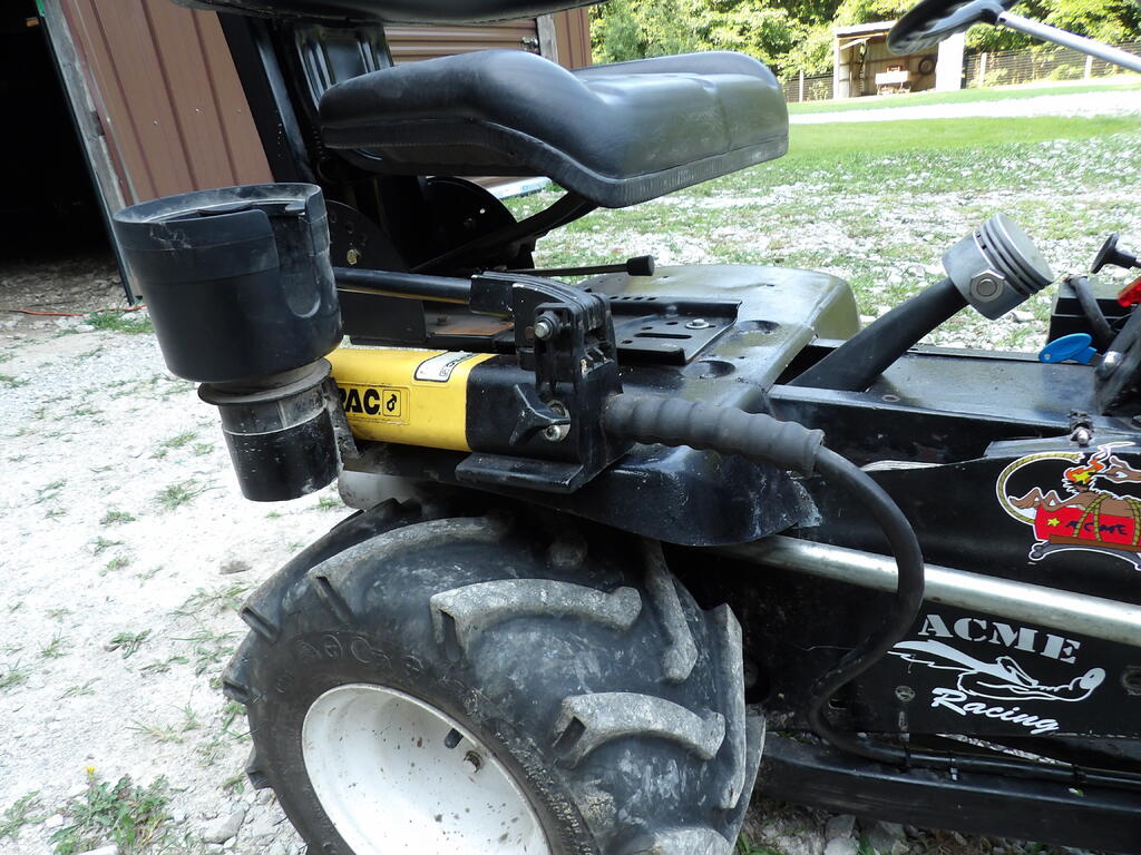

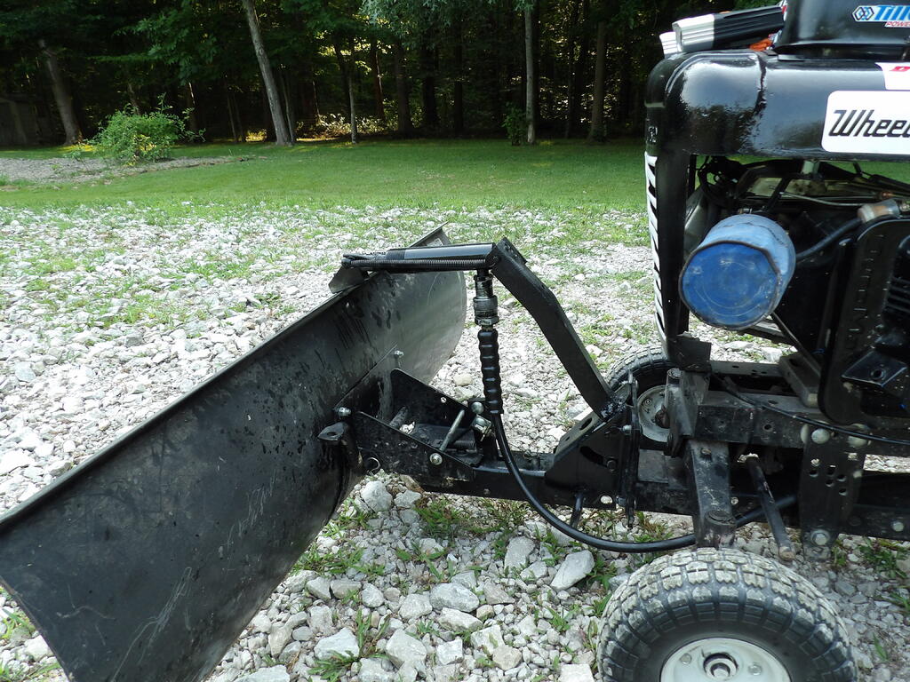

Snoopy11 5,731 #12350 Posted July 28, 2021 (edited) You guys, I have something pretty cool for you today on old Hell Horse... So, I took a manual hydraulic pump, ran hydraulic lines, and fabricated up some brackets and other stuff that took me all day... for my hydraulic cylinder... and BOOM... hydraulic blade... Video coming soon... Don P.S. Guys, I also bought new springs to go on either side of the hydraulic cylinder... as the original springs I used were pretty ugly... as you can see in 1 of the pictures... Edited July 28, 2021 by Snoopy11 2 Share this post Link to post Share on other sites
