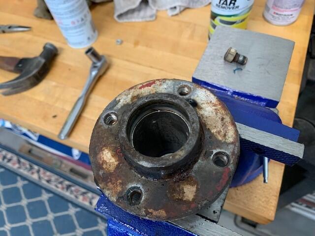

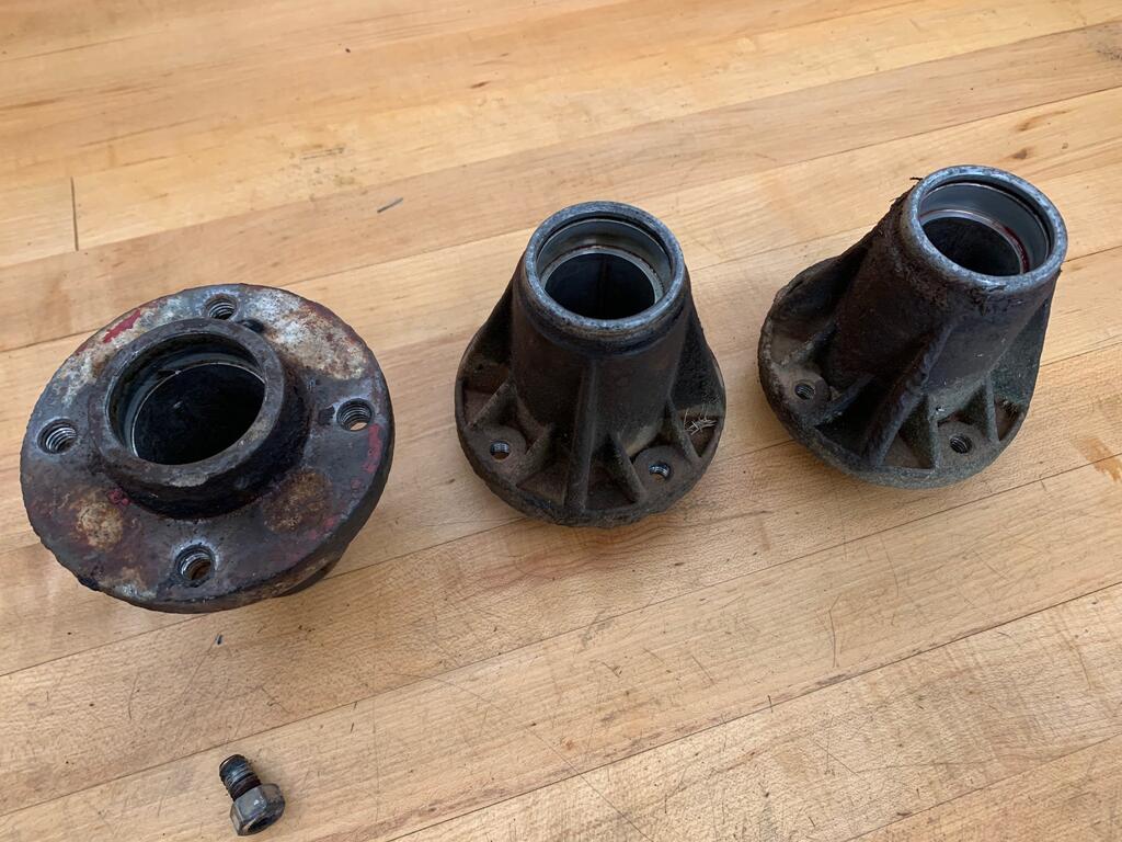

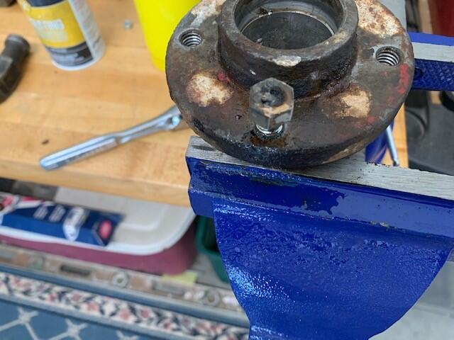

Tuneup 1,459 #12294 Posted July 24, 2021 I do LOVE this topic as you get to crow over successes and ask forgiveness for screw-ups. This is one of the former. So, the 48" deck I bought with a 520H from South Atlanta this past Spring is a longterm project but I wanted to refresh its deck before Summer's out. One of the spindle bolts was broken - the deck running without it. Plenty of shank but clamping it in a vise and giving it love taps wasn't working. I was about to use my 4 drill bit and tap method when I remembered the HF welder in the garage. Hey! I can weld a nut to this thing. It's kid in the candy shop stuff. I was able to hammer a larger nut and put a good weld on it with little effort. Some heat and advice from the South Main Auto Channel on youscrewed (keep adding heat while turning) and it came off with very little effort. I had to stop to make sure it was actually turning - thought it was my imagination. That cheapo welder pays for itself over and over again. Now, if the two stripped-to-the-case exhaust bolts could come out of that P220G...the nut method has become very attractive. 3 1 Share this post Link to post Share on other sites

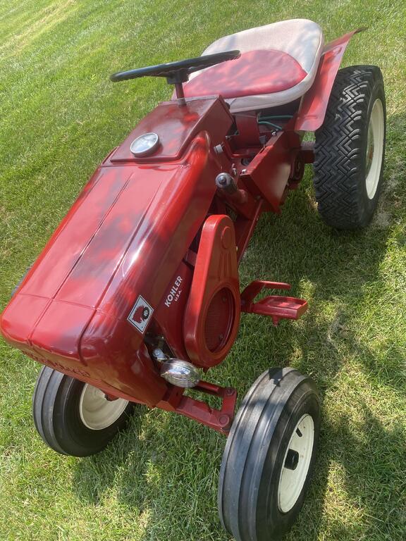

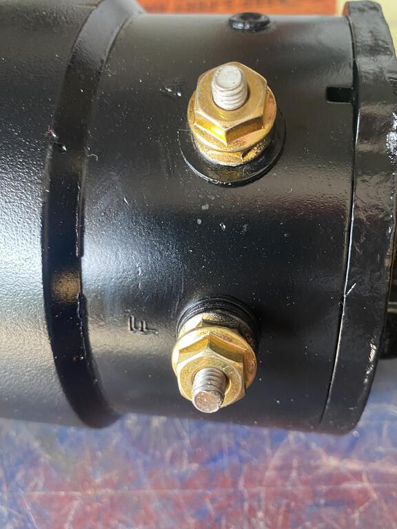

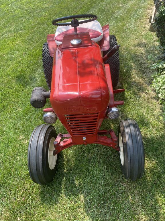

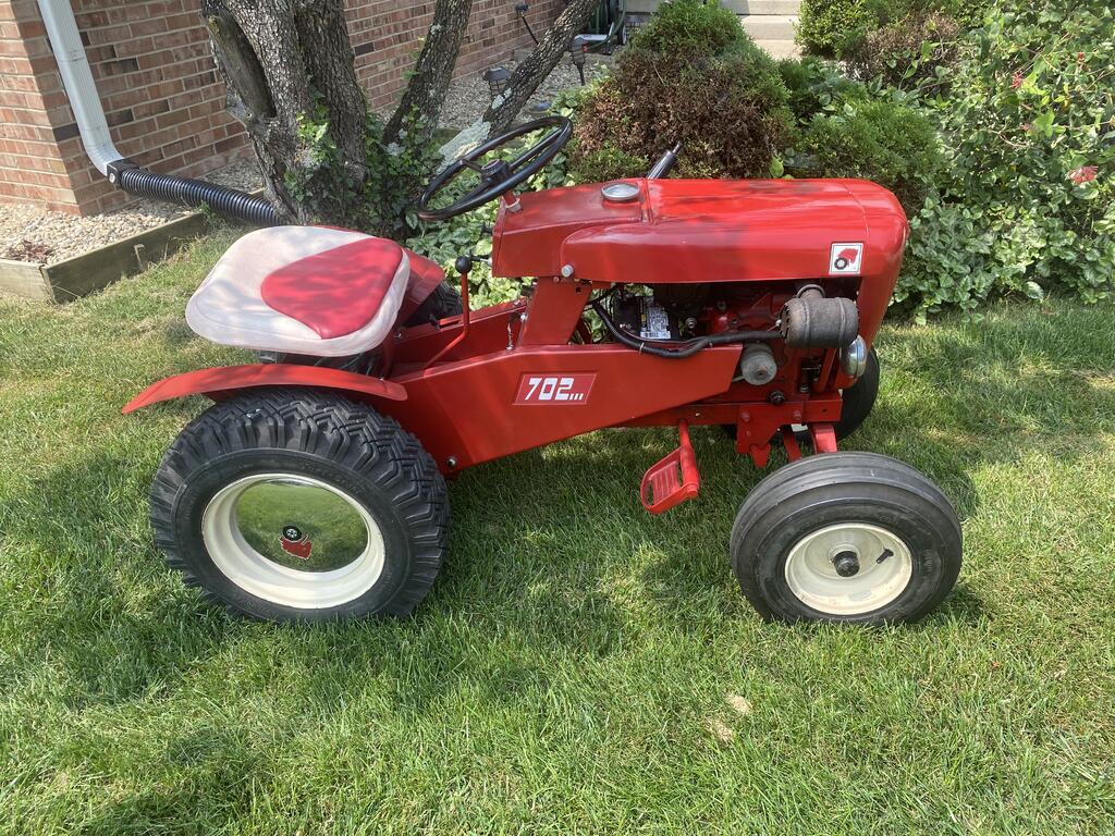

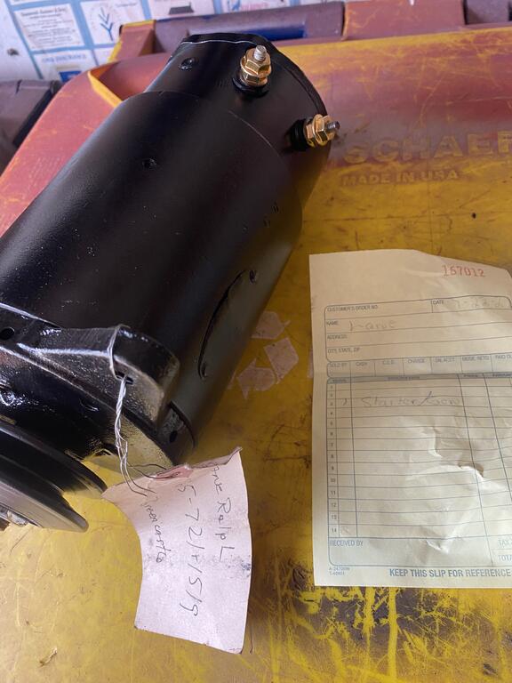

Lane Ranger 12,151 #12297 Posted July 24, 2021 Rebuilt electrical system on my 702 this am. I had a short out at the Big Show with my regulator arcing on the starter/generator. The field was bad after that and I had thes/g rebuilt for $90 with rebuilt field and all new brushes. Ordered a new regulator and two prong key switch which were also replaced today. Wired up according to the 702 diagram (which by the way Garry has updated the 701 and 702 diagrams on Red Square for better rebuilding) . Back in business now starting and charging like it should and no loose wires! IMG_5974.MOV 4 4 Share this post Link to post Share on other sites
Tuneup 1,459 #12298 Posted July 24, 2021 Well, the arbors are now disassembled and the support bracket has been welded. It's been a really good day. If it hits 90° w/ 80% humidity, I'll fire up the 516 to mow the back and get a good sweat going. Why sweat in a steam bath when it's a Georgia Summer and you get it for free? 5 3 Share this post Link to post Share on other sites
