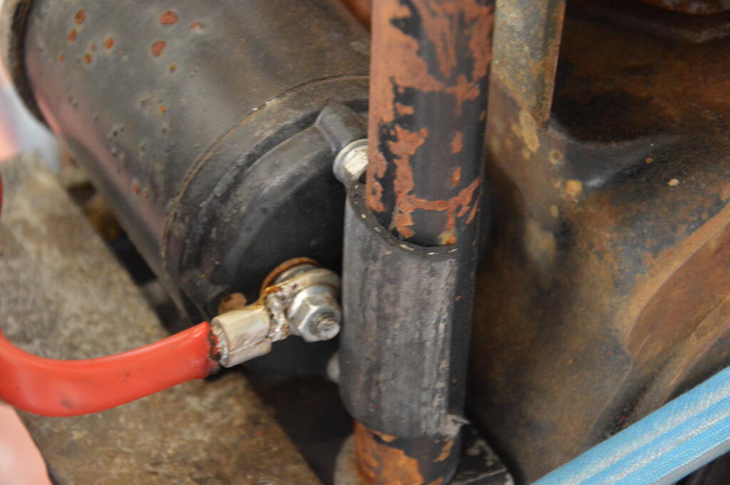

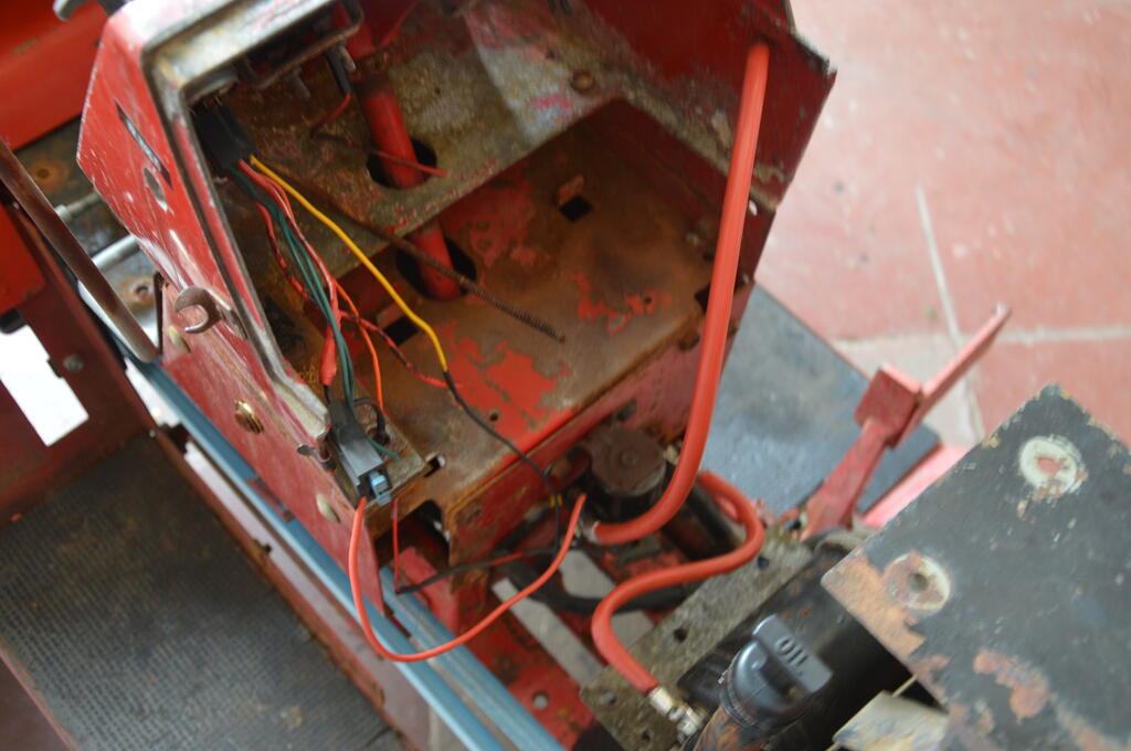

Maxwell-8 4,371 #12152 Posted July 10, 2021 (edited) Did a partial rewire on Amy the C-175, installing new better wires and a stronger solenoide. All conections are crimped and soldered. The previous onwer had put on a new starter. Seems to be a bit to long, as the + contactpoint was a bit to close to the oil-dipstick for my liking. piece of rubberhose fixed that as well. Edited July 10, 2021 by Maxwell-8 10 Share this post Link to post Share on other sites

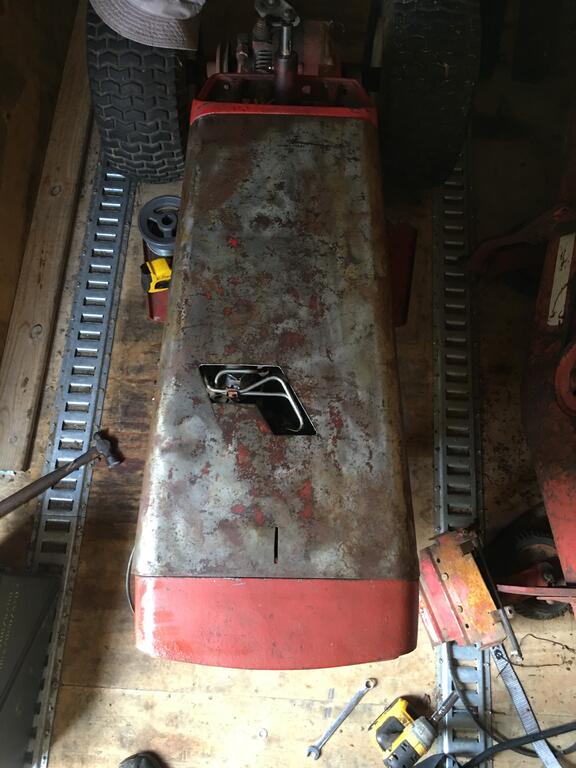

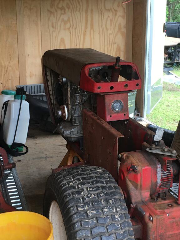

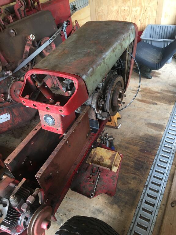

19richie66 17,936 #12153 Posted July 10, 2021 (edited) Test fit 2.0 continues. I have the grille and dash raised approximately 3/8” each and the hood still hits the fuel injector lines. So..... raise it more or cut the top open just enough to let the lines poke out? Small hood bump? Decisions Edited July 10, 2021 by 19richie66 7 2 Share this post Link to post Share on other sites

ebinmaine 80,766 #12155 Posted July 10, 2021 20 minutes ago, 19richie66 said: Small hood bump? That's my vote 1 1 Share this post Link to post Share on other sites

8ntruck 9,310 #12158 Posted July 11, 2021 50 minutes ago, ebinmaine said: That's my vote Yup. Put a 'power buldge' in the hood. 1 Share this post Link to post Share on other sites

19richie66 17,936 #12160 Posted July 11, 2021 16 minutes ago, 8ntruck said: Yup. Put a 'power buldge' in the hood. Not gonna cut it just yet. I want to get it fired up and running again just to be sure I have no issues with the engine. Then I need to make a jackshaft. Once all the mechanical is set, I’ll cut it. Thinking something like a bulge running most of the length of the hood. Thanks👍 2 Share this post Link to post Share on other sites
ebinmaine 80,766 #12161 Posted July 11, 2021 14 minutes ago, 19richie66 said: jackshaft Engine RPM runs low? Share this post Link to post Share on other sites
19richie66 17,936 #12162 Posted July 11, 2021 6 minutes ago, ebinmaine said: Engine RPM runs low? No....... engine sticks out too far to line up transmission pulley with crank pulley. I have the pulleys and shaft somewhere in my massive mess of parts. Search mission tomorrow 😁 3 Share this post Link to post Share on other sites
RandyLittrell 3,946 #12163 Posted July 11, 2021 2 hours ago, 19richie66 said: So..... raise it more or cut the top open just enough to let the lines poke out? Small hood bump? Decisions My vote is to do a hood bump, I know you would make it look right! Randy 2 1 Share this post Link to post Share on other sites

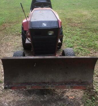

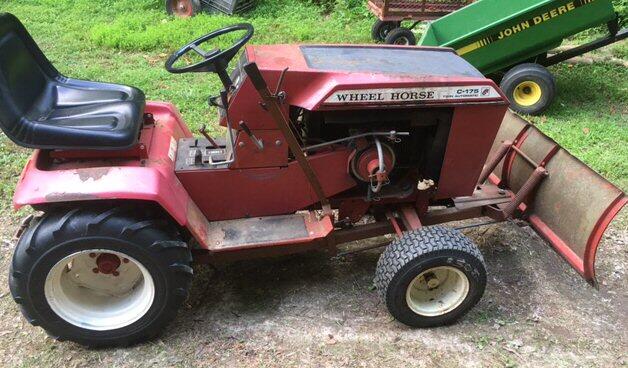

Bill Winn 157 #12164 Posted July 11, 2021 I'm sitting in my office right now and I'm supposed to be putting the finishing touches on my main message for today but I couldn't resist taking a moment to post in this thread. Yesterday, on my list of to-do's, was getting my snow plow rigged up. My C175 did not come with a rear tach-o-matic and the mounting bar on the back of the blade was removed. (so that some home made angle iron brackets with 3/4" diameter pins could be mounted in the holes where the original bar went on the blade frame.) I made up a bar held in place with 1/4" pins, got a tach-o-matic, and repaired the bottom of the blade where it had been worn down. The bottom of the blade was worn half-way into the carriage bolts. I welded an 1/8"x3" extension to the bottom of the plow and then re-mounted the wear bar upside down. It will do for now. I'm not sure what grade of steel that wear bar should be but all I have on the rack is a36 for ornamental work so I reused the stock bar. I had to fabricate a link between the lift bar and the plow but that was a simple 5 minute job. Plow goes up and down and pushes dirt. At some point I will patch up the spots where the plow sat for years in wet leaves and rusted through. The "green" cart in the background looks out of place behind the WH but it was given to me by a church member so free-to-me negates the faux pas of mismatched colors. At some point I'll set up my LPHV paint gun and shoot the whole tractor. When I do that I will buy enough paint to include the cart in the project. Hope you all have a rich day, Bill 6 3 1 Share this post Link to post Share on other sites

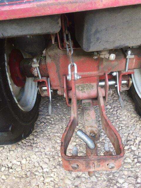

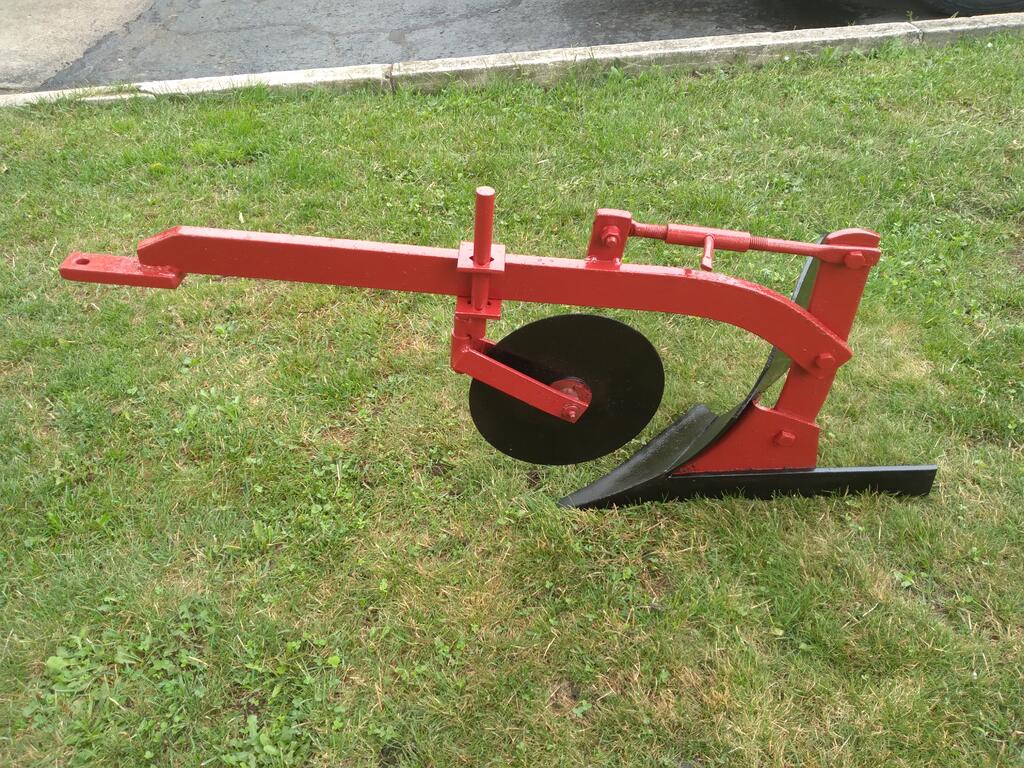

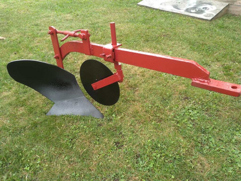

D_Mac 9,339 #12166 Posted July 11, 2021 Nothing too exciting. Painted the bottom plow I got with the 2 tractors I pulled from the weeds. Being that I had never used the slot hitch on any of my Horses before, will the end of the plow only fit WH? 3 1 Share this post Link to post Share on other sites
19richie66 17,936 #12167 Posted July 11, 2021 (edited) 4 hours ago, Lee1977 said: Got room for a jack shaft behind the engine? Raise hood, grill and hood stand enought tto clear and extend the steering shaft up if it's too close too the hood stand. A inch or so higher with every thing won't be noticed. I moved the engine forward an inch. I did some homework and found an inch shorter oil filter so I retain enough room to be able to change the oil. I can’t go any lower or the front cover will hit the electric fan. I put the grille up an inch and it didn’t look bad but still hit the top of the lines. I couldn’t stand it so I nipped it. Hood sits level with 3/8” spacing below grille and dash stand. The jackshaft should be able to be mounted just above the steering fan gear and use the side panels for mounting it. Haven’t got that far yet. I did decide it will be a military theme build. OD green/black with white lettering. Edited July 11, 2021 by 19richie66 5 1 Share this post Link to post Share on other sites

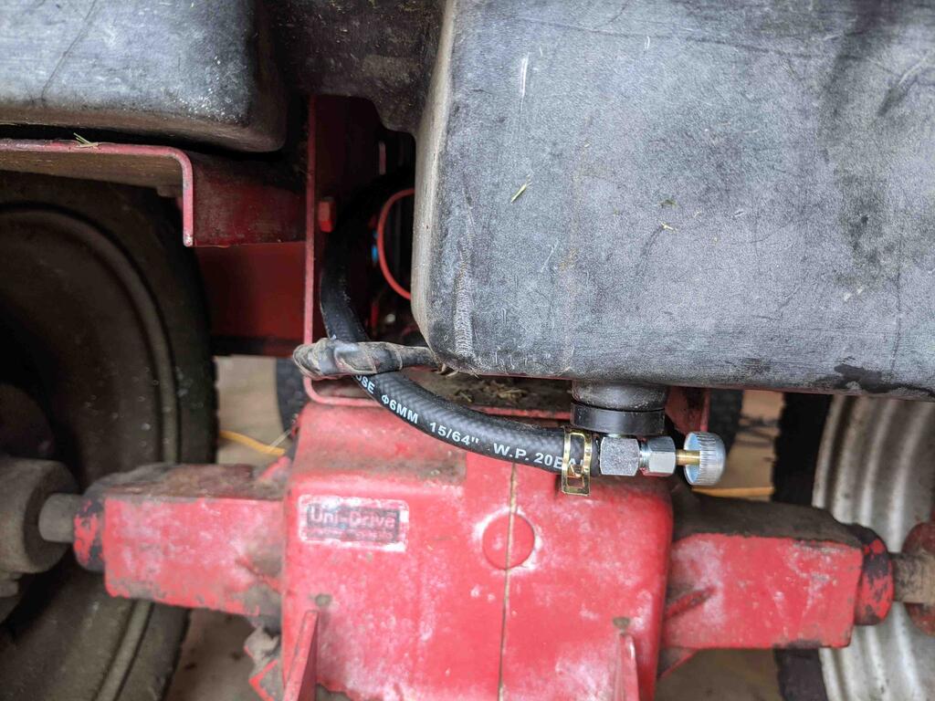

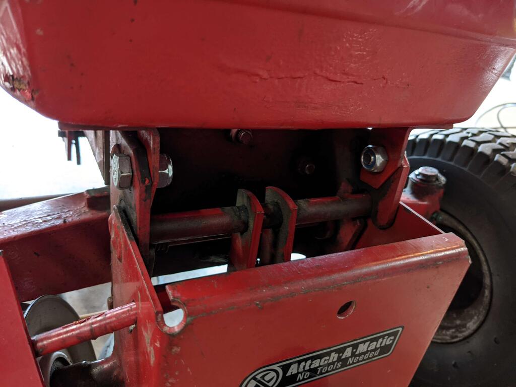

balconio 606 #12175 Posted July 12, 2021 I did a bunch of small fixes to the 312-8 that I use for mowing. She has 1644 hours on the clock. - removed/pressure washed deck and greased spindles - sharpened blades - oil change (I'm commiting to doing it every 25hrs and using quality SAE30) - fixed very loose hood hinge by ditching the factory rod setup, then welding the egged out holes and redrilling them to accept 3/8" bolts with nylock nuts. Hood is completely stable now. - replaced fuel line before and after fuel pump. Also added an inline filter - drained tank and cleaned it out with the old paper towels and compressed air trick. Also replaced fuel petcock and gasket. 8 8 Share this post Link to post Share on other sites
