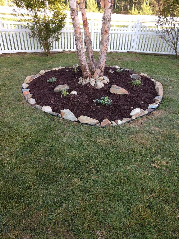

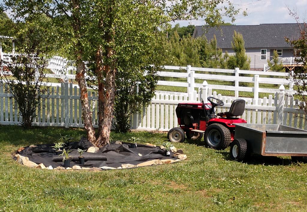

kpinnc 18,480 #11128 Posted May 8, 2021 (edited) Built my wife a new flower bed today. The trusty 310-8 was kind enough to help out. Edited May 8, 2021 by kpinnc 7 3 Share this post Link to post Share on other sites
Tuneup 1,459 #11129 Posted May 8, 2021 18 minutes ago, kpinnc said: Built my wife a new flower bed today. The trusty 310-8 was kind enough to help out. So, steak and potatoes tonight - excellent! 2 Share this post Link to post Share on other sites

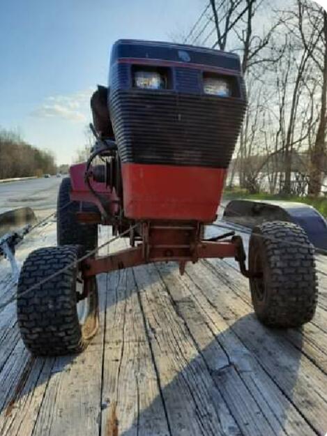

Oldskool 6,678 #11130 Posted May 8, 2021 What have I done to my Wheel Horse today?? Well I made a trade with a guy today to get my little herd another friend to play with. Road trip at 330a.m. to pick up a 310-8. 8 3 Share this post Link to post Share on other sites

Tuneup 1,459 #11132 Posted May 8, 2021 2 minutes ago, Oldskool said: What have I done to my Wheel Horse today?? Well I made a trade with a guy today to get my little herd another friend to play with. Road trip at 330a.m. to pick up a 310-8. Nice save! 4 1 Share this post Link to post Share on other sites

Oldskool 6,678 #11135 Posted May 8, 2021 28 minutes ago, Tuneup said: Nice save! Everything is there but the deck and air filter and cover. 1 Share this post Link to post Share on other sites

kpinnc 18,480 #11140 Posted May 8, 2021 1 hour ago, Tuneup said: So, steak and potatoes tonight - excellent! We shall see. My wife went and ate with her mom at the mexican restaurant. I'm thinking cold burritos are more likely! 1 2 Share this post Link to post Share on other sites
