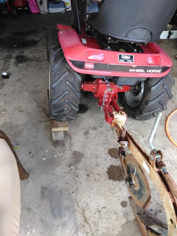

Daron1965 644 #1076 Posted September 2, 2018 (edited) Mounted a moldboard plow on the back of the 312 8. Watched numerous YouTube videos in an attempt to get it correct. Will be trying it out once the sun sets a little. Edited September 2, 2018 by Daron1965 5 2 Share this post Link to post Share on other sites
cleat 9,415 #1077 Posted September 2, 2018 Midnight farmer ? Just kidding, have fun with it. You get to find all the rocks and tree roots you never knew you had. 1 4 Share this post Link to post Share on other sites
PeacemakerJack 11,092 #1078 Posted September 3, 2018 3 hours ago, Daron1965 said: Mounted a moldboard plow on the back of the 312 8. Watched numerous YouTube videos in an attempt to get it correct. Will be trying it out once the sun sets a little. Looking good so far. If the picture was a little farther back I could see how much air space you have under the “heel” of the “landside”. For initial adjustment, I give about 1/2” of “Suck”—or tail up off the concrete and suck point on the plow share down. If you are busting new ground on your first pass down and back, it is a good idea to go two more turns suck point down because your wheels aren’t in the furrow. On your second pass and subsequent passes you’ll want to “flatten” out your plow back those two turns. Then as you begin to plow at the correct depth, given that the soil conditions are right, you should be able to stop mid pass and check that space under The tail. You should have about 1/2”-1”. Too much Suck and your plow will fight all you settings because it wants to keep going deeper. Not enough suck and your plow won’t want to go in the ground. There are many other variables—but these are a few basic pointers. Please tag me if you start a thread on your plowing experience tonight, I’d like to follow along and see how you did! Good ground conditions and a properly set up rig can make for one of the most enjoyable things “that you did with your wheel horse today”! 2 2 Share this post Link to post Share on other sites

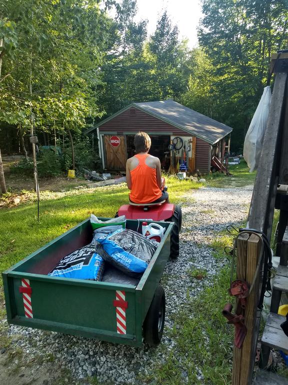

ebinmaine 81,223 #1085 Posted September 3, 2018 My honey used her 657 and the 1976 / 7 Ohio Steel trailer given to her by a dear friend to bring some gardening supplies from the upper driveway down to the garden at the back of the house. 4 5 Share this post Link to post Share on other sites

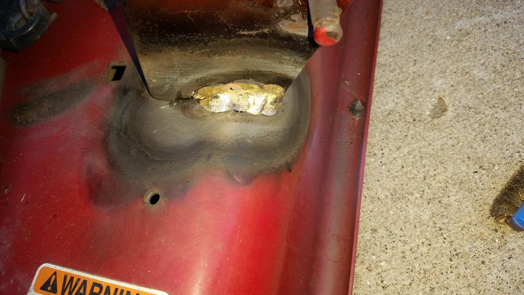

WHX?? 58,378 #1087 Posted September 7, 2018 Welded up a broke deck mount on the Missus's vertical and tried to figure out why an oem belt does not fit as should. Came to the conclusion that manuals need more pictures! 2 Share this post Link to post Share on other sites

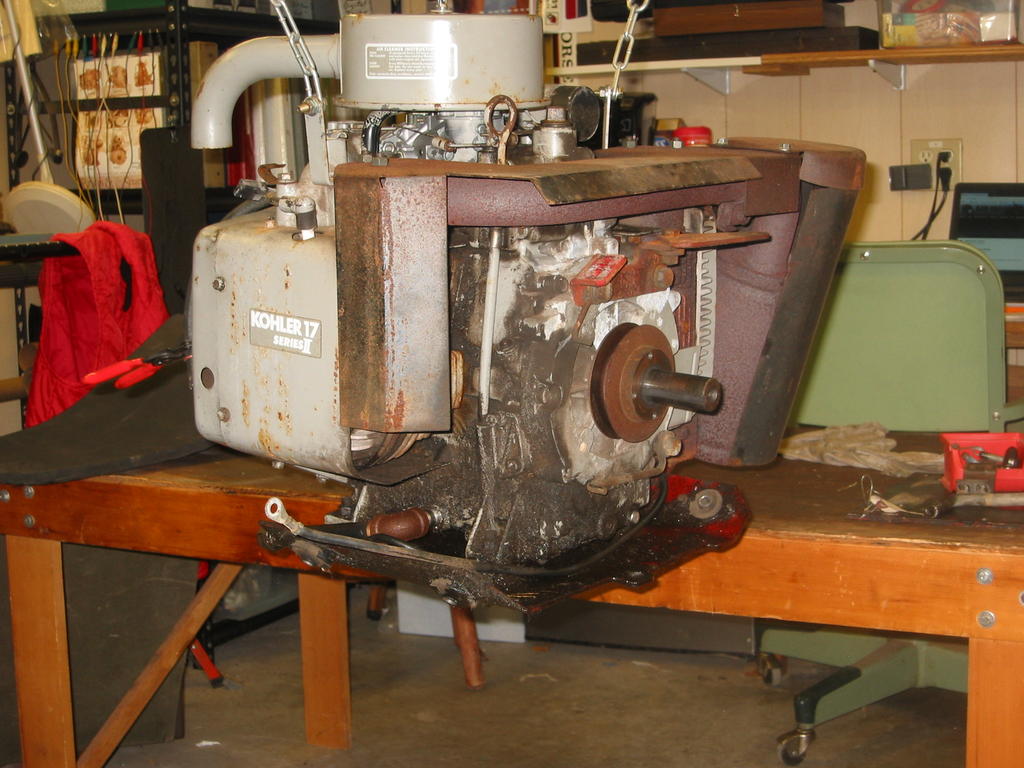

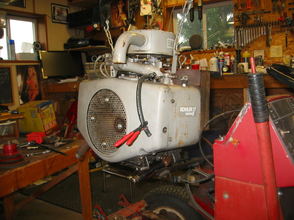

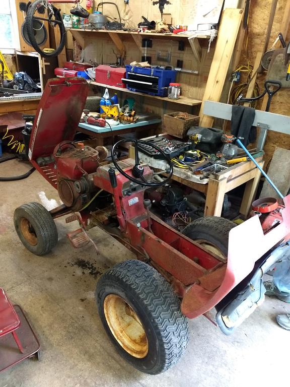

pfrederi 21,336 #1088 Posted September 7, 2018 Too wet to mow still very humid and the mosquitoes are terrible so working in the shop with the AC on. Pulling the engine on a C-175 as she had an oil leak. i do not mind seeps and drips but this one was a bit much and it was the drain. The elbow cannot make a complete turn as the isolation mount is in the way. So will fix that and do away with the shaker mount. Got a 417/8 mojnting plate form AtoZ. Did this to another C175. Cheaper than buying new rubber mounts or coming up with some other substitute. 3 Share this post Link to post Share on other sites
19richie66 17,950 #1089 Posted September 7, 2018 Yeah those shaker plates are a pain. All mine are shaker plate free now. Share this post Link to post Share on other sites
cleat 9,415 #1090 Posted September 7, 2018 Drain looks identical to an Onan. They sometimes leak too. My Ford LGT165 had shaker mounts as well. The problem it had was if you tightened the belt too much on the deck or snowblower then the engine started to tilt on the mounts. Cleat 1 Share this post Link to post Share on other sites

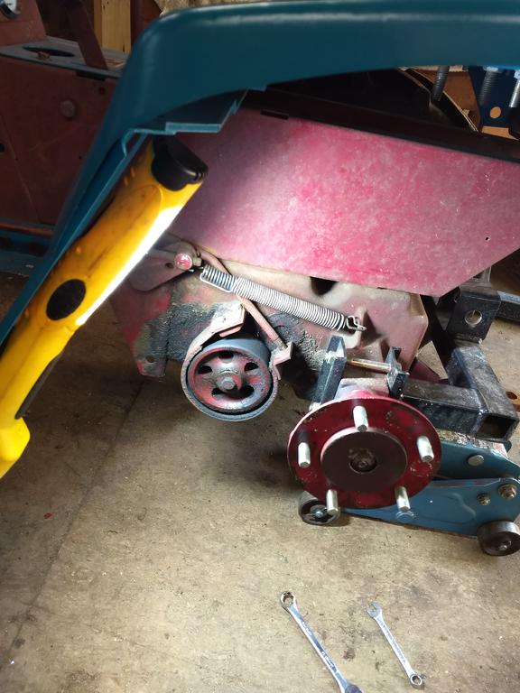

ebinmaine 81,223 #1095 Posted September 9, 2018 Working on changing out the transmission seals on the B80 today. 1 1 Share this post Link to post Share on other sites

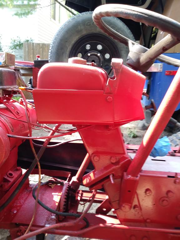

Dadlife520H 195 #1096 Posted September 9, 2018 New voltage regulator, mounted some fresh painted pieces. And mowed. Onan loves the 58 degrees as much as I do. 1 3 Share this post Link to post Share on other sites
