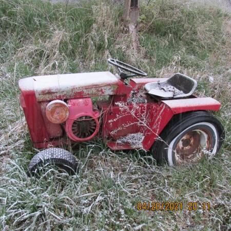

haydendavid380 759 #10677 Posted April 21, 2021 25 minutes ago, Tj salyers said: Here's a plow I'm picking up down the road for free even got to look for brackets and swivel arm Looks big. Nice score 👍 2 Share this post Link to post Share on other sites

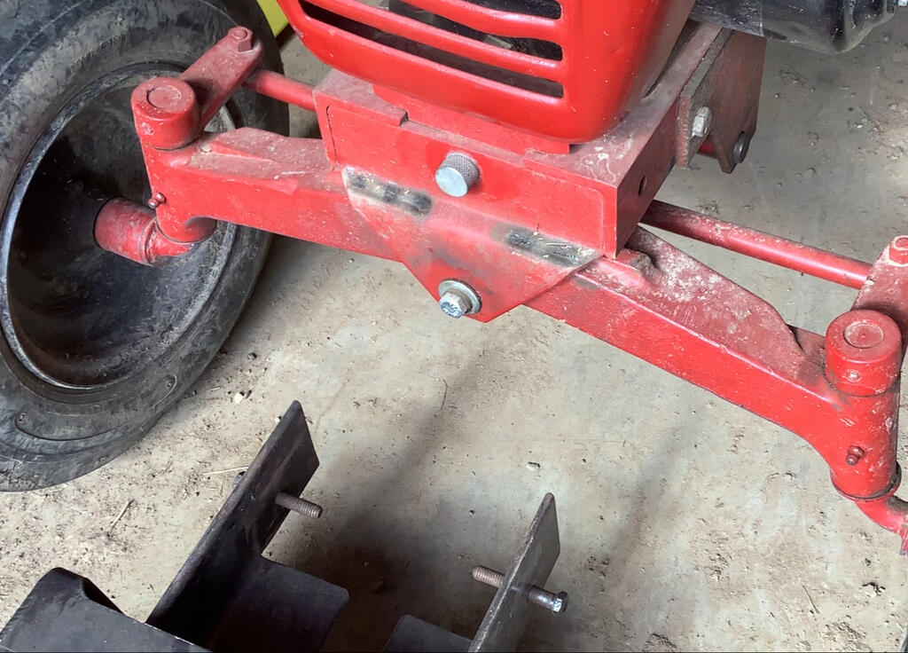

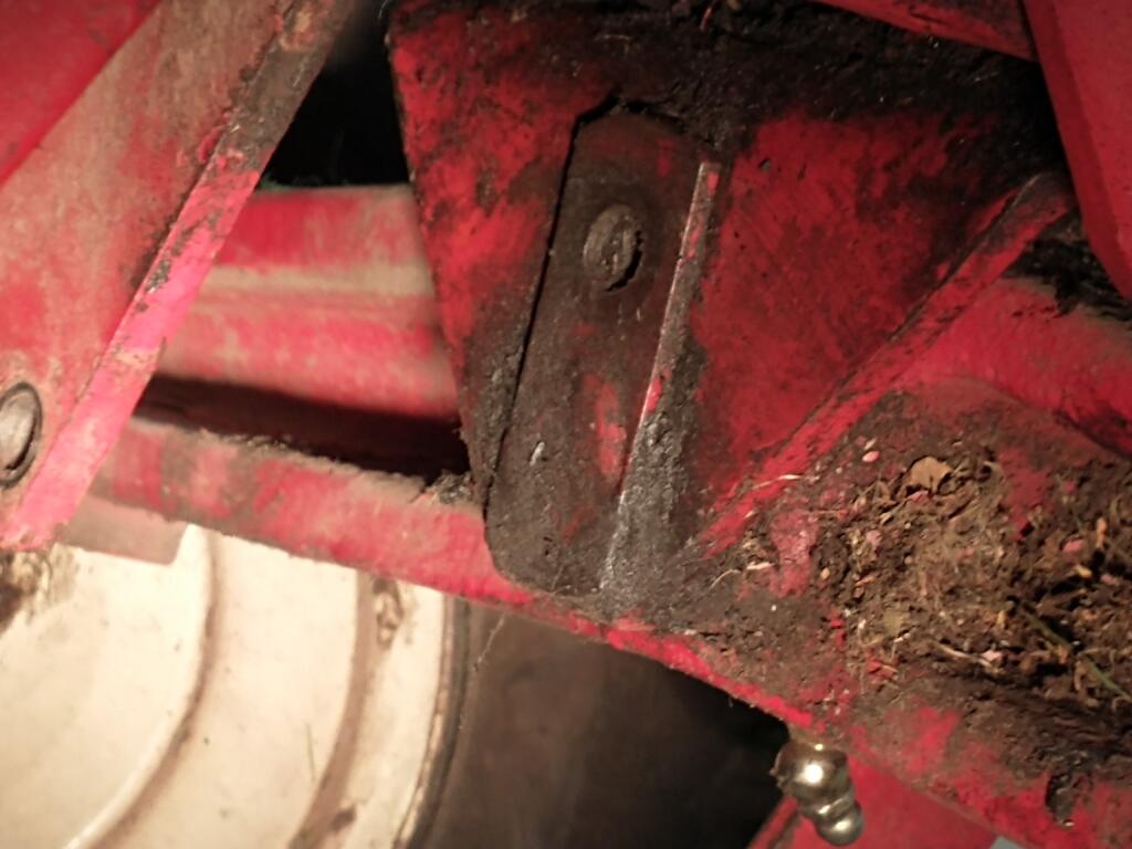

squonk 47,455 #10679 Posted April 21, 2021 I went to change out the front axle pin on my C-160. I have had this tractor for about 12 yrs. and put about 250 hrs. on it imagine my surprise when I found out the retaining bolt was gone! Threads are ok and I put a bolt in. 6 2 Share this post Link to post Share on other sites
ebinmaine 79,754 #10680 Posted April 21, 2021 5 minutes ago, squonk said: I went to change out the front axle pin on my C-160. I have had this tractor for about 12 yrs. and put about 250 hrs. on it imagine my surprise when I found out the retaining bolt was gone! Threads are ok and I put a bolt in. I've had so many that were gone or broken I'm pleasantly surprised when we find one that's actually in there. 1 Share this post Link to post Share on other sites
Pullstart 70,820 #10681 Posted April 21, 2021 That was the reason I drilled and tapped the front of the pin on Putt Putt. It kept dropping the front end at random, but I couldn’t keep a 5/16” bolt in that hole. 5 Share this post Link to post Share on other sites
squonk 47,455 #10682 Posted April 21, 2021 2 minutes ago, pullstart said: That was the reason I drilled and tapped the front of the pin on Putt Putt. It kept dropping the front end at random, but I couldn’t keep a 5/16” bolt in that hole. There is usually an e clip on the front. 2 Share this post Link to post Share on other sites
ebinmaine 79,754 #10683 Posted April 21, 2021 23 minutes ago, squonk said: There is usually an e clip on the front. There has been on all the ones I've seen. That's what was keeping the pin in place. On Colossus I reinforced that 3/4 hole front and rear and put a clevis pin through with a hairpin holding one end. 2 Share this post Link to post Share on other sites

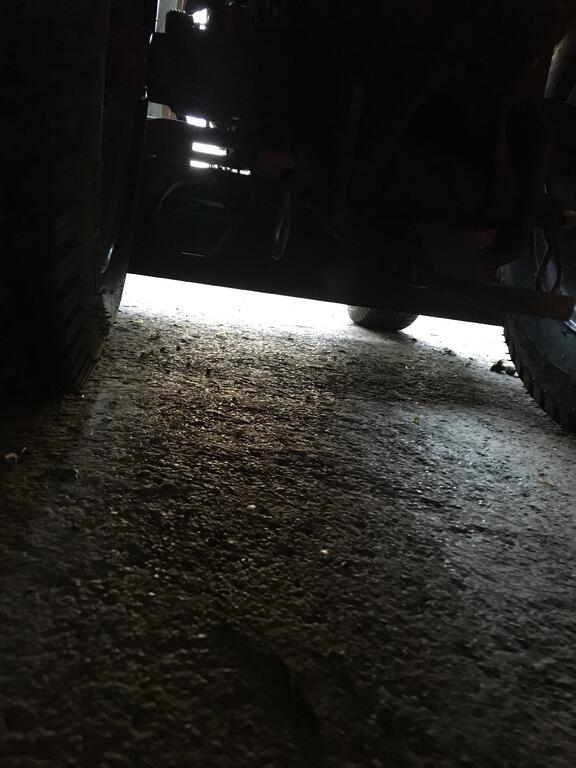

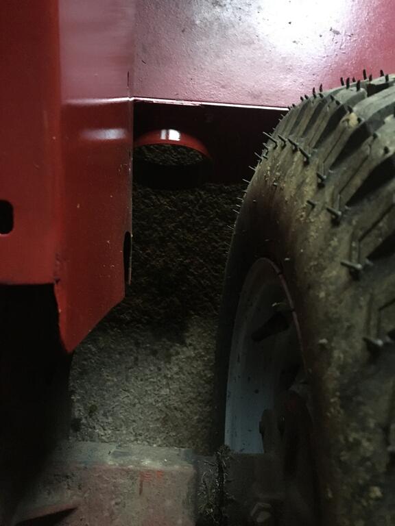

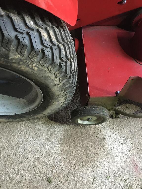

Tractorhead 9,217 #10684 Posted April 21, 2021 Did today the first real Mowing this year. before i checked all things if they will be ok, than i regreased the Gears on the mowerdeck than i started the Horse. Man, i love that Predator Engine with it‘s differently HP value. I believe the 9 HP could be real, because it has a great punch ( torque) above 1800RPM and run like a Boss. If the load on the Engine increases with the Mowerdeck it grunts little louder (92dB A) but it is still a nice mellow Sound. If the throttle will increased, the engine revs quick up and the mowerdeck sounds like a Roots, what a wonderful Music. Than i mowed half of my Areal with 2200RPM what was the same result like the 6HP Tecky. The other half i mowed with 2750RPM - haha, boy that‘s pure Fun. 2. gear and yeeeeeeehaaaaaaw. ok, the pure mowingtime goes down because of the changed bigger Engine Pulley resulting in a higher workspeed, but hey - more time for a Funride after.. 😎 To reducing the mess on the Gearbox with cutted Grass i had last year, i tried a Trick. I built an complete Endcap for the mowerdeck with a two 100mm Air nozzles they blow the grass directed between the rear Tyres out. additionally i opened the right Aircover. My result was absolutely no grasscut in the Gearbox where the Shifterstick is anymore, even the Brakeband and the Axles is completely free of grasscut. After mowing i stopped the Engine to see how many Grass sticks between the nozzles or in the Deck if it is more than before. Not more than before, just a little on the Top and in the edges on the Mowerdeck. Seems my Idea with the two nozzles to direct the grasscut aside the Gearbox works much better than i feared. - Success. 3 6 Share this post Link to post Share on other sites

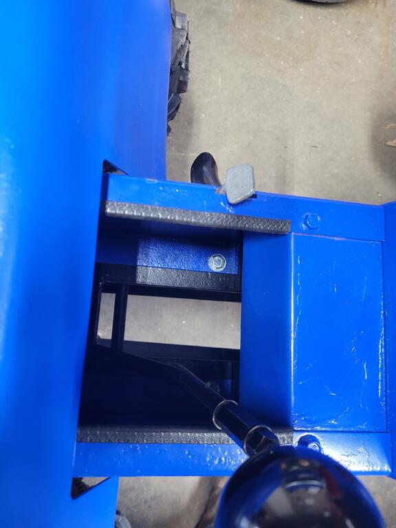

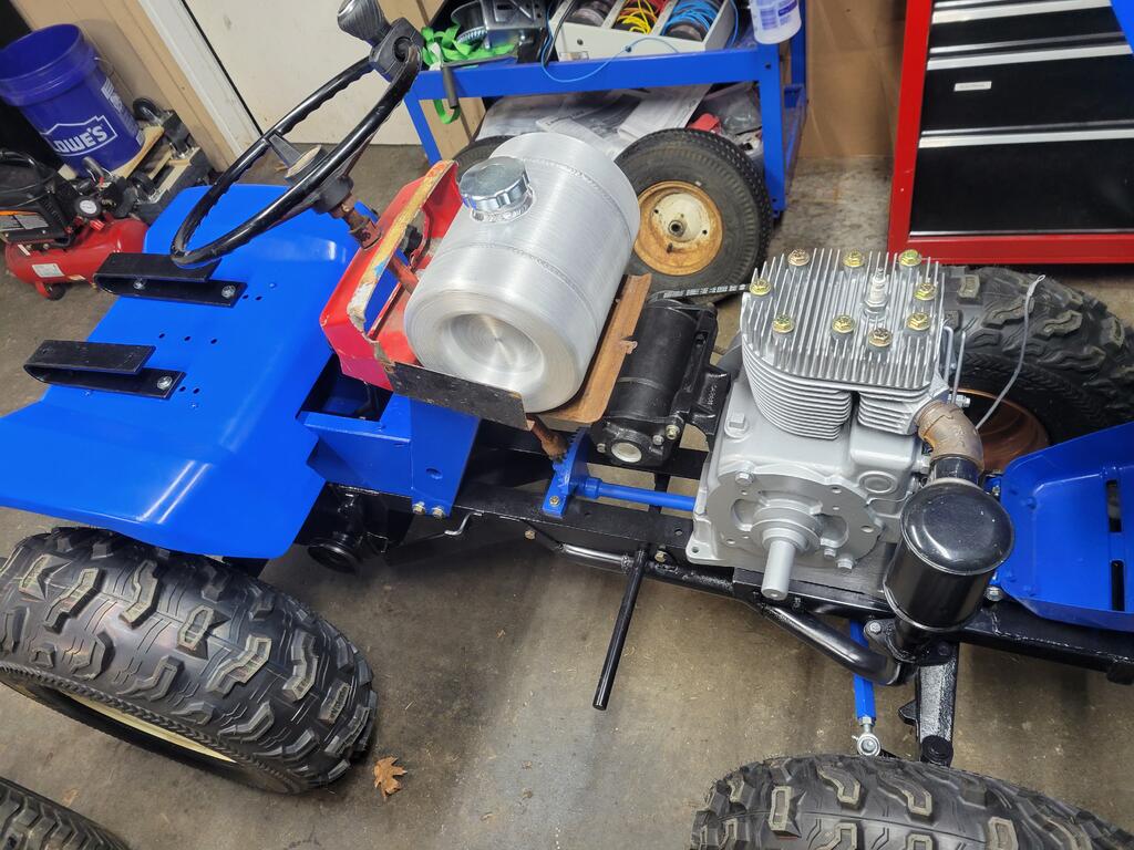

OldWorkHorse 3,156 #10686 Posted April 21, 2021 (edited) Got my fuel tank in started mocking that up, raining outside so no real work can be done, but got some rubber metal trim in so put some of that on, and along the hood where it latches now my shifter doesn't bang off the edges of the console, and my hood clamps down snug! Edited April 22, 2021 by OldWorkHorse 6 4 Share this post Link to post Share on other sites
Tractorhead 9,217 #10687 Posted April 21, 2021 I love that Fueltank. 👍 2 1 Share this post Link to post Share on other sites
Gregor 4,848 #10688 Posted April 21, 2021 That is going to be a BEAUTIFUL tractor. 3 1 Share this post Link to post Share on other sites

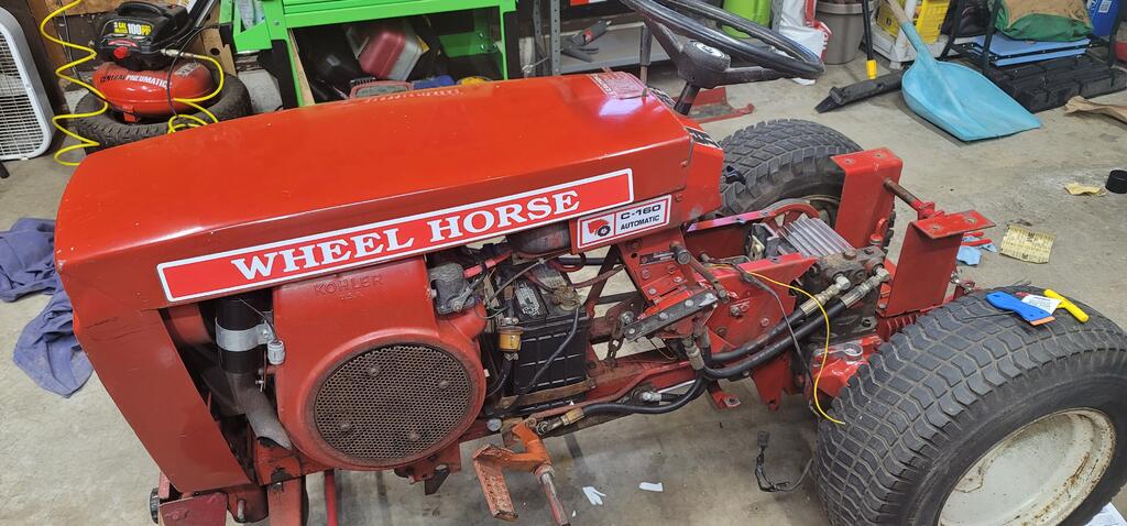

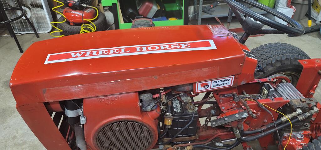

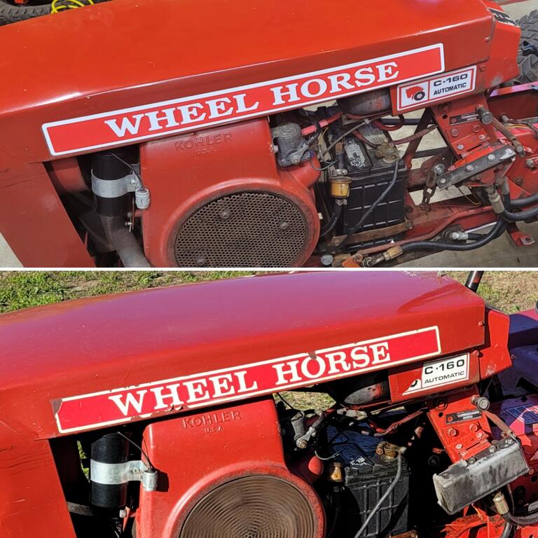

haydendavid380 759 #10690 Posted April 21, 2021 (edited) New decal set came in. Got the left side C-160 badge and WH bar on. All the decals on the right side came off during pressure washing. Should make a big improvement. Edited April 21, 2021 by haydendavid380 5 5 Share this post Link to post Share on other sites

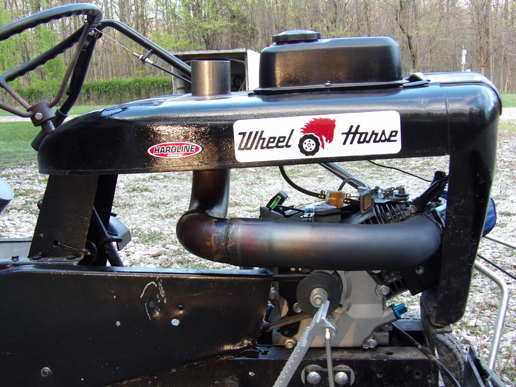

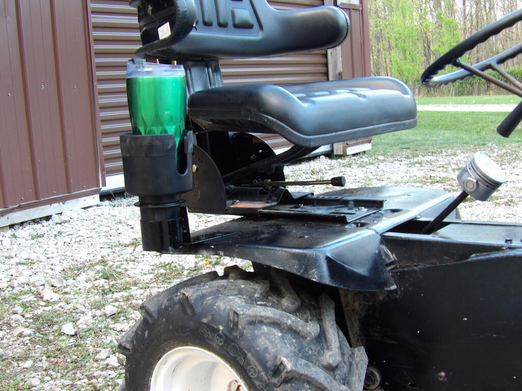

Snoopy11 5,731 #10696 Posted April 22, 2021 Howdy guys! So... this past weekend... it was raining, so I made an exhaust stack for my L-157. I got my Tillotson 212r put in... (runs great), but I do plan to swap back to my Tillotson stage 1 (governor removed) once I get the parts I need to fix it... I ran the exhaust piping through what was the gas filler hole. I did also put a steel flap (10 dollars at a farm store) on the top of the exhaust pipe (not shown in these photos). I fabricated a cupholder and a piston shifter, (the piston came out of my original Tecumseh engine!). I think the black engine with the black tractor looks exceptional! Here are some pics: 10 2 Share this post Link to post Share on other sites

Snoopy11 5,731 #10698 Posted April 22, 2021 (edited) 21 hours ago, OldWorkHorse said: Got my fuel tank in started mocking that up, raining outside so no real work can be done, but got some rubber metal trim in so put some of that on, and along the hood where it latches now my shifter doesn't bang off the edges of the console, and my hood clamps down snug! What engine is that on it? I don't recognize it... Don Edited April 22, 2021 by Snoopy11 Typo... Share this post Link to post Share on other sites
ebinmaine 79,754 #10699 Posted April 22, 2021 26 minutes ago, Snoopy11 said: What engine is that on it? I don't recognize it... Don That's a '67 Kohler 12. 1 Share this post Link to post Share on other sites
