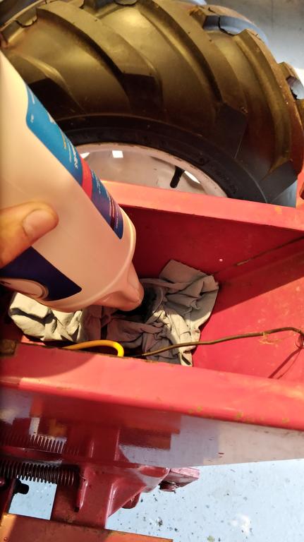

AlexR 3,139 #1028 Posted August 20, 2018 The slow process of adding diff oil, maybe I am doing it wrong? Share this post Link to post Share on other sites
953 nut 70,542 #1029 Posted August 20, 2018 3 minutes ago, AlexC120 said: slow process of adding diff oil If you remove one of the bolts that hold the tool box to the transaxle it will give you a vent. 2 1 Share this post Link to post Share on other sites

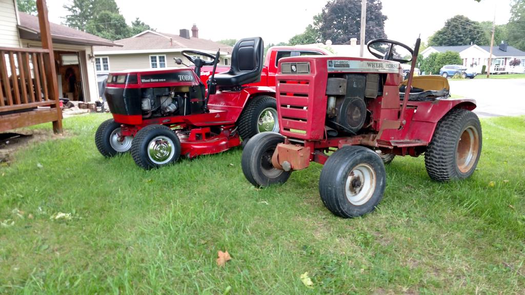

ebinmaine 81,223 #1031 Posted August 22, 2018 We used the B80 Patriot horse to unload and bring our auction purchases down to the workshop for future sorting. 7 Share this post Link to post Share on other sites

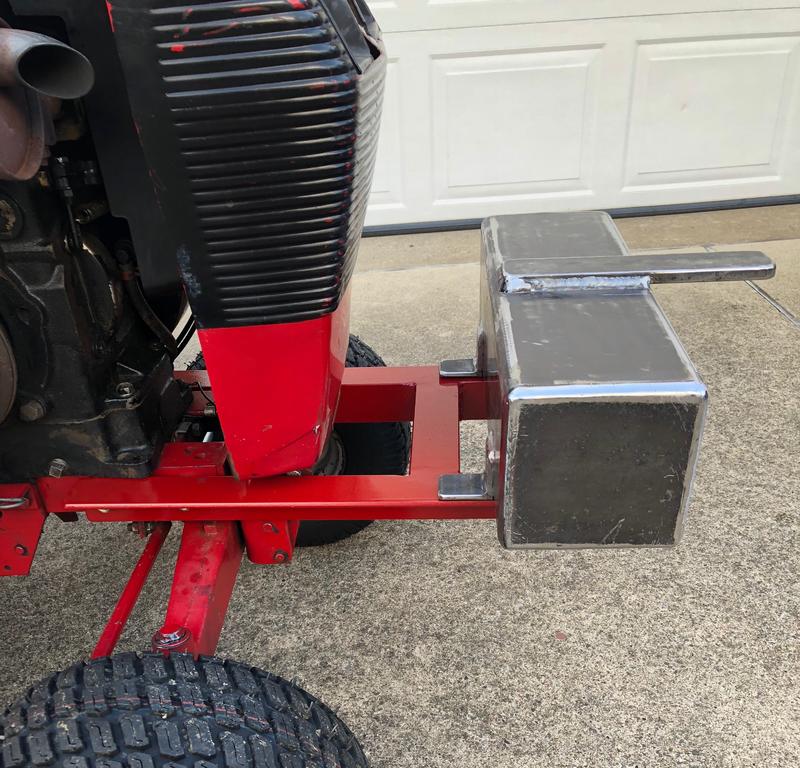

Mows4three 833 #1032 Posted August 23, 2018 Hello everyone. I'm pretty new to the forum but have been mighty inspired by what I've seen. After smoking (literally smoking) an old Craftsman friction drive lawn tractor pulling a firewood cart around at my camp I found this forum and have been learning something from it almost every day. My research lead me to a 312-8 on Craig's List that I picked up from a nice fellow at an affordable price and I've been getting it set up to go to hunting camp as my prime mover hauling a log splitter and firewood cart. I have done several things to it like get a new seat, paint the wheels and foot plates, added non-slip tape strips, changed the air filter, engine and gear oil, and put new tires in all four corners. I also found a matching set on inside and outside rear weights on Craig's List. A few weeks ago I built a 2" receiver hitch for it and then realized it might be too heavy in the rear when hauling the log splitter and a full firewood cart at camp. To counterbalance the rear weight loading I fabricated a 2" x 2" x 1/4" rack for the front of the tractor using the existing holes in the frame to mount it. Had to make 1/2" spacers to gain clearance for the bolts that the hood pivots on. Found a friend with an 18" piece of 6" x 6" x 1/4" (29 lbs) square tube stock that he let me have (he's a great friend). Welded caps on either end after filling with about 60 pounds of lead picked up from a local shooting range. Also welded clips to hold the box to the weight rack and welded two clips to bolt it solidly to the rack. Estimated total weight is around 90 pounds. I still need to drill holes in the rear clips to hold it in place. Also plan to paint it black and will mount it on 2" strips of rubber inner tube. Not being able to leave well enough alone (honestly, it runs in my family) I also welded a 12" length of 1/2" x 2" rectangular stock to the top of the weight box to serve as a tongue for a trailer ball (still need to drill the tongue out for a shackle or a ball hitch). Could be useful for spotting trailers or getting towed out of a tough spot in the mountains. I haven't run any critical welds in 35 years so be kind as you look at my photos. I'm older now, not as steady of hand as I once was, and my eyesight isn't as good as when I was working as a steelworker. Anyway, thought someone else might take my idea and run with it for their own tractor. Thanks for all of your great posts. This is a super place to pick up information and shared knowledge. A pretty cool forum..... Cheers! Dave 4 6 1 Share this post Link to post Share on other sites
ebinmaine 81,223 #1033 Posted August 23, 2018 10 minutes ago, Mows4three said: Not being able to leave well enough alone (honestly, it runs in my family) Ssuuure it does Dave. Also, you're a guy. We are not good at leave well enough alone. Love that front weight box man... 2 Share this post Link to post Share on other sites

AlexR 3,139 #1035 Posted August 23, 2018 (edited) 1 hour ago, Mows4three said: I haven't run any critical welds in 35 years so be kind as you look at my photos. I'm older now, not as steady of hand as I once was, and my eyesight isn't as good as when I was working as a steelworker. I don't think anybody can come close to criticizing those welds. They are great welds!! Edited August 23, 2018 by AlexC120 2 Share this post Link to post Share on other sites

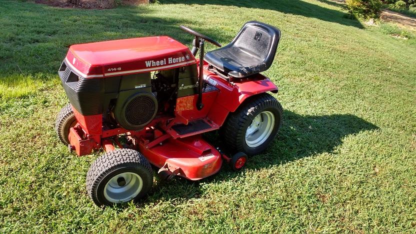

Skwerl58 843 #1040 Posted August 23, 2018 I picked up a 48" Disc harrow yesterday and got all the blades freed up and turning today. Installed a new deck drive belt and cleaned the brake lining and adjusted them on my 1986 414-8. After mowing I washed the mower and took some pictures. I now have a tiller, cultivator, plow, disc harrow and push blade for the tractor. 3 Share this post Link to post Share on other sites

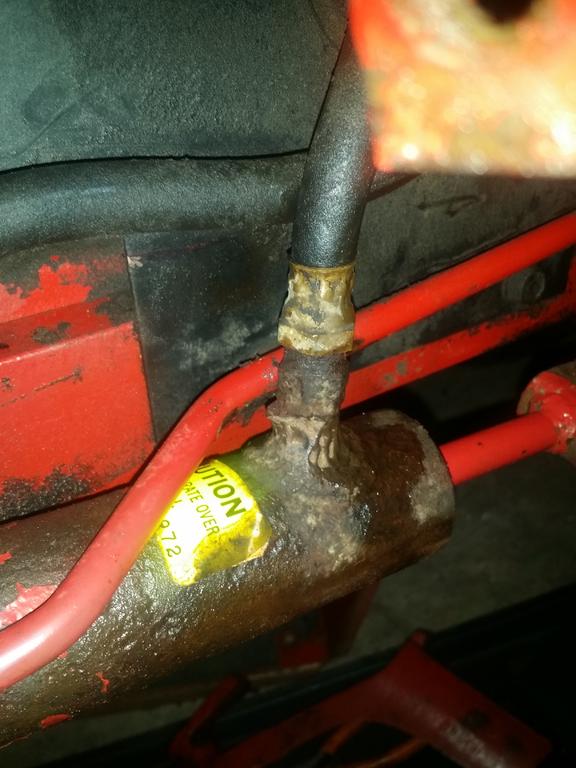

oneroadkingman 53 #1044 Posted August 24, 2018 I found a leak on this hydraulic lift Ram does this look like it was welded or something once before is this normal looking because it looks like it's leaking either from the weld or where the fitting screws into it is there an O-ring inside there maybe that I can replace thanks Share this post Link to post Share on other sites
pfrederi 21,336 #1045 Posted August 25, 2018 19 hours ago, oneroadkingman said: I found a leak on this hydraulic lift Ram does this look like it was welded or something once before is this normal looking because it looks like it's leaking either from the weld or where the fitting screws into it is there an O-ring inside there maybe that I can replace thanks These fittings were originally ORB (O ring Boss) so yes there should be an O ring in there. Hard to tell from the photos what exactly they may have change in the "repair" job 1 Share this post Link to post Share on other sites
19richie66 17,950 #1046 Posted August 25, 2018 (edited) Not a whole lot left of the fitting either. Edited August 26, 2018 by 19richie66 Share this post Link to post Share on other sites

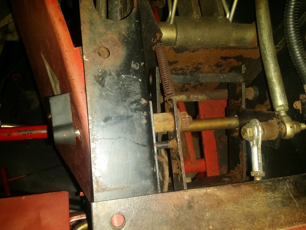

cschannuth 3,821 #1049 Posted August 26, 2018 I finally installed one of Matt’s pedal kits that I bought a while back on the 520. I still need to tweak it a bit but I really like it. The hardest part was getting the roll pin out of the parking brake lever, believe it not. A couple months of soaking with Kroil and a pin punch and it finally came out. 1 Share this post Link to post Share on other sites
