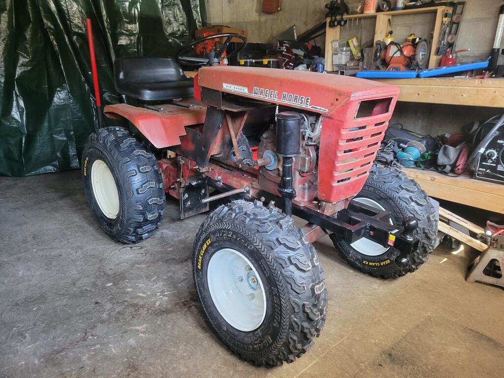

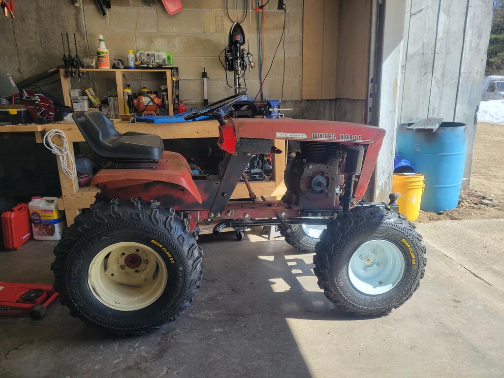

OldWorkHorse 3,156 #9883 Posted March 22, 2021 Temporarily tossed the tranny and hubs on the 1257H project to make it a roller to finally get to see it with 4 wheels on and rolling! It's coming along slowly but she will get there soon! 6 7 1 Share this post Link to post Share on other sites

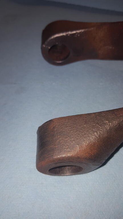

Gregor 4,848 #9884 Posted March 22, 2021 57 minutes ago, OldWorkHorse said: Temporarily tossed the tranny and hubs on the 1257H project to make it a roller to finally get to see it with 4 wheels on and rolling! It's coming along slowly but she will get there soon! That thing looks like very little will stop it, once it gets going. I also have a build in mind, A bit crazy maybe, and too many $$$, but if I can find the right roller, and some materials, it should be fun. I have won half the battle, but I fear it's the easy half, and it wasn't all THAT easy. I figured once I had the hitch off, and a hole through it, piece of cake. It wasn't, as many of you probably already know. I did use 2 propane torches with MAPP gas, and I think it did help. With a series of bolts nut, washers, and sockets, I got them out. Here's a tip. Before heating with your torch, REMOVE WRENCHES! But not to worry, if you forget, you will be reminded in a nano second, and you can rest easy knowing you won't do THAT again. If you do do THAT again, you have a much bigger problem. We might be cousins. That thought should keep you awake nights. 2 6 Share this post Link to post Share on other sites
OldWorkHorse 3,156 #9885 Posted March 22, 2021 8 minutes ago, Gregor said: That thing looks like very little will stop it, once it gets going. I also have a build in mind, A bit crazy maybe, and too many $$$, but if I can find the right roller, and some materials, it should be fun. She's turning out to be pretty beefy! I'm just hoping the brakes will stop her lol! She started as a frame and a idea coming along nicly! Fun making ideas happen! 2 1 Share this post Link to post Share on other sites

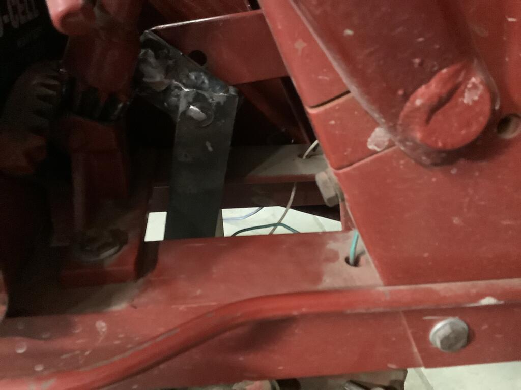

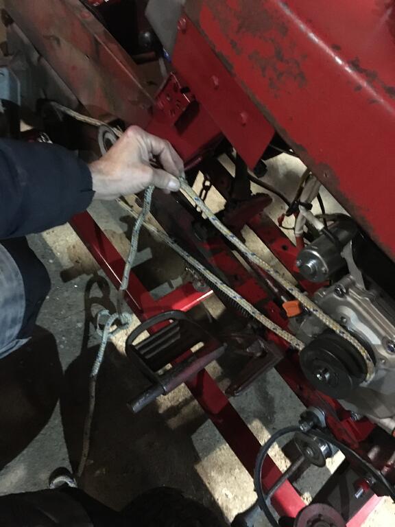

Tractorhead 9,217 #9886 Posted March 22, 2021 checking out the new needed belt lenght, because of changed Pulley diameter and moved Engine i result finally in 67“. Belt is ordered. 7 Share this post Link to post Share on other sites

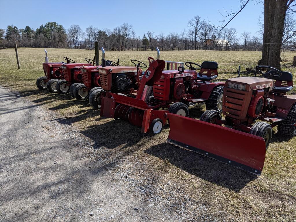

rjg854 13,271 #9887 Posted March 22, 2021 Let the horses out for some sun and fresh air. 6 7 1 Share this post Link to post Share on other sites

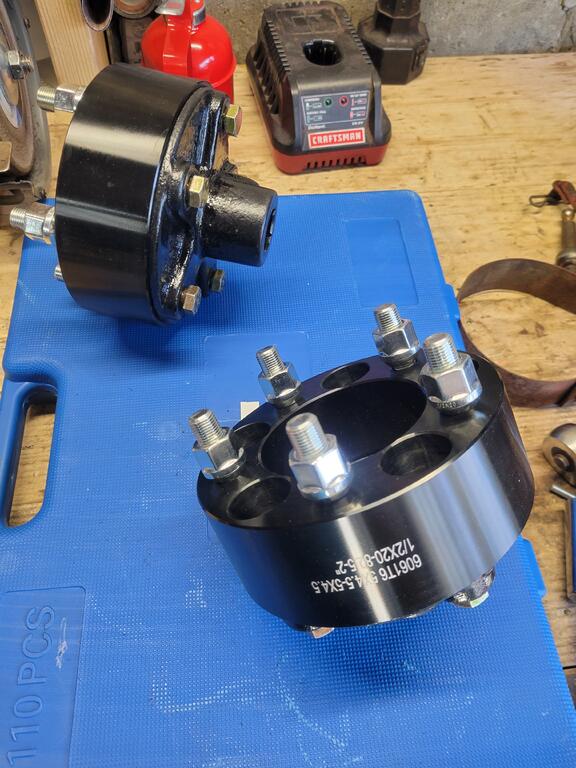

OldWorkHorse 3,156 #9888 Posted March 22, 2021 Got the hubs cleaned up and put together.... just seem to have lost the keys... 5 2 Share this post Link to post Share on other sites
Oldskool 6,678 #9889 Posted March 22, 2021 11 minutes ago, OldWorkHorse said: Got the hubs cleaned up and put together.... just seem to have lost the keys... Where did you get your spacers? Aluminum? 3 Share this post Link to post Share on other sites
OldWorkHorse 3,156 #9890 Posted March 22, 2021 9 minutes ago, Oldskool said: Where did you get your spacers? Aluminum? Yes they are from the jungle site. About 80$ for 4 of them. They are ford ranger spacers. 2 1 Share this post Link to post Share on other sites
8ntruck 9,176 #9891 Posted March 22, 2021 3 hours ago, Gregor said: That thing looks like very little will stop it, once it gets going. I also have a build in mind, A bit crazy maybe, and too many $$$, but if I can find the right roller, and some materials, it should be fun. I have won half the battle, but I fear it's the easy half, and it wasn't all THAT easy. I figured once I had the hitch off, and a hole through it, piece of cake. It wasn't, as many of you probably already know. I did use 2 propane torches with MAPP gas, and I think it did help. With a series of bolts nut, washers, and sockets, I got them out. Here's a tip. Before heating with your torch, REMOVE WRENCHES! But not to worry, if you forget, you will be reminded in a nano second, and you can rest easy knowing you won't do THAT again. If you do do THAT again, you have a much bigger problem. We might be cousins. That thought should keep you awake nights. Thank you for providing that tidbit of wisdom for the rest of us. 3 Share this post Link to post Share on other sites

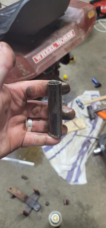

haydendavid380 759 #9892 Posted March 22, 2021 8 hours ago, Gregor said: When you say heat, do you mean a propane torch, or something more substantial? I am attempting to drill a hole through what is left of the pin, after sawing it off on both sides. I seem to have hit something. near the center. No bit, big or small, will go any farther, and it pretty much ruins the bit, and these are NOT cheap bits. I used just the blue bottle propane. Drilled a 1/2" hole about 2/3 the way through (if you're halfway that should be enough) and I put a big 1/2" punch in the hole. Heat it up, soak it with oil, beat it, oil it again. Go watch an episode of something. Repeat. I repeated that for 12 hours before mine broke loose. You are better off beating right to left so the tranny is supported more. There's a fine line between effective beating and cracking the cast iron. I used a 3lb sledge, but if you have access to an air hammer I feel like that might work better. 1 Share this post Link to post Share on other sites

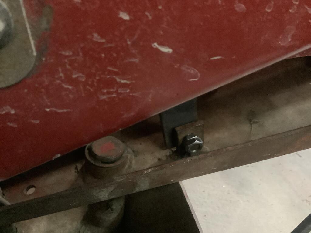

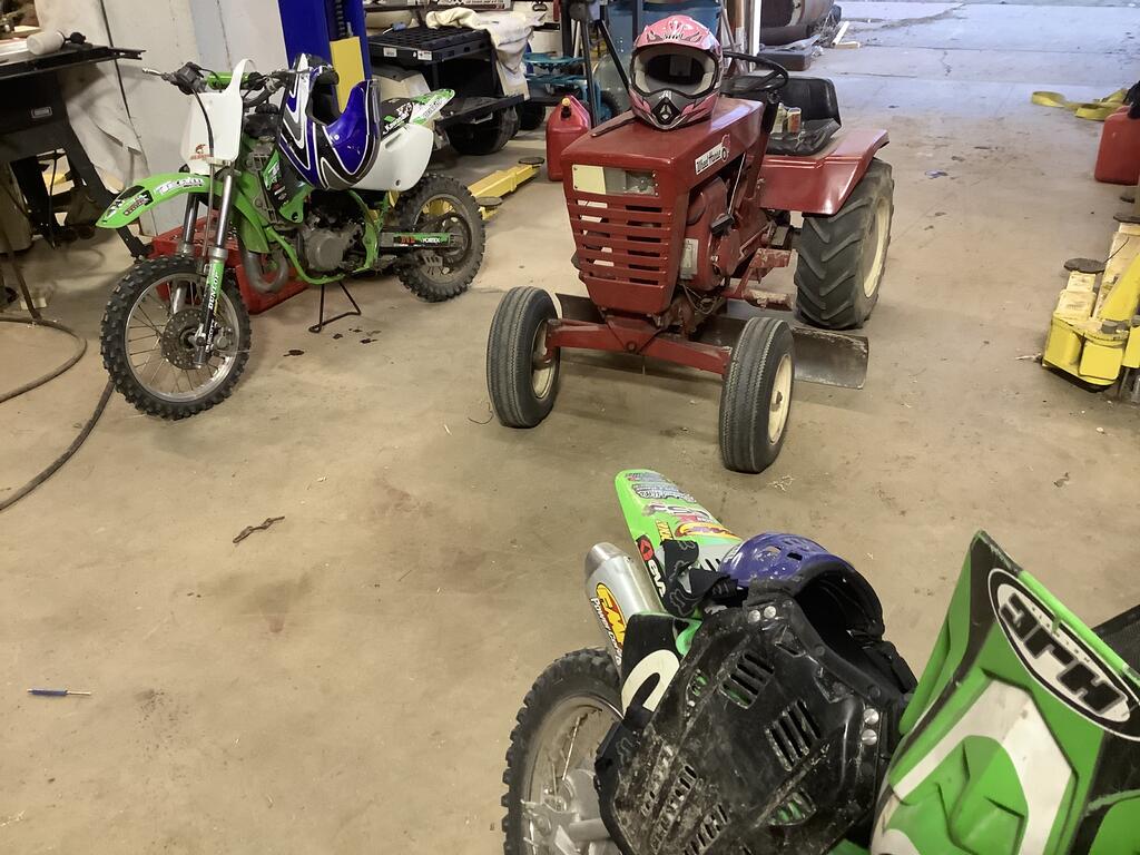

Pullstart 71,009 #9895 Posted March 22, 2021 I built a solid link for the grader blade on Jane the Commando 6 and cleared a bit more path in the side brush area that used to be a dirt bike track. Then Rylee and I broke it in a bit. Green never looked so good in the shop! 7 Share this post Link to post Share on other sites

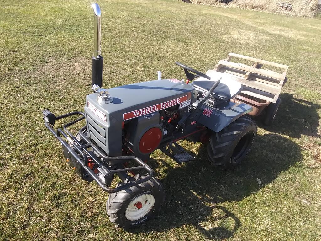

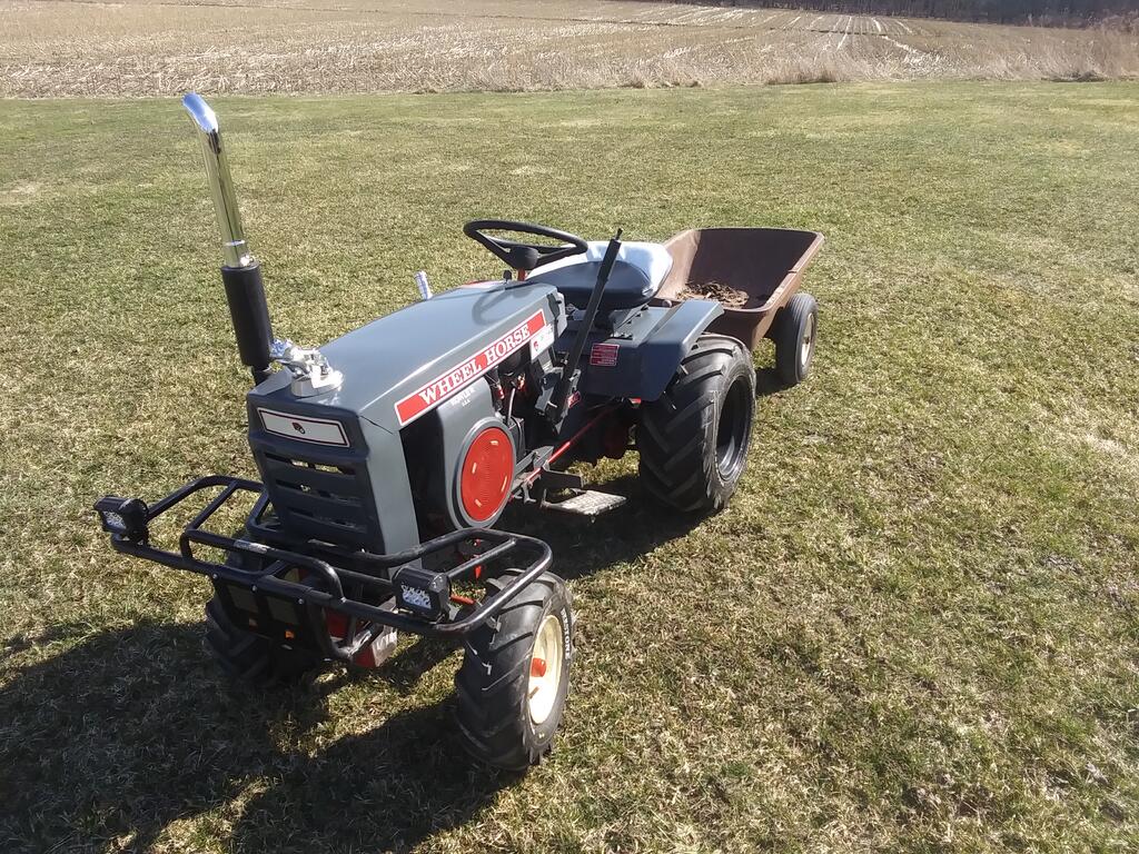

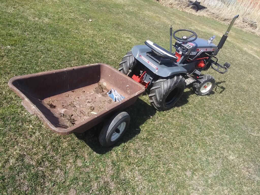

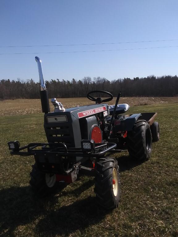

Chris G 3,385 #9897 Posted March 23, 2021 Got my B-140 out and did some yard cleanup today! 6 6 1 Share this post Link to post Share on other sites

DennisThornton 4,773 #9899 Posted March 23, 2021 39 minutes ago, Chris G said: Got my B-140 out and did some yard cleanup today! Impressive front rack! Never seen that done on any GT before. 1 Share this post Link to post Share on other sites
Chris G 3,385 #9900 Posted March 23, 2021 13 minutes ago, DennisThornton said: Impressive front rack! Never seen that done on any GT before. Thanks and it is very useful to me. It is strong enough to stand on and it all mounts with the front attachamatic bracket. I put a weather sealed quick disconnect on the wiring. So it can go on and off in just a minute. 3 2 Share this post Link to post Share on other sites
