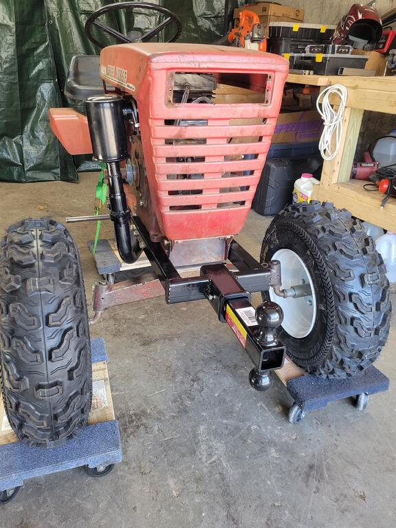

OldWorkHorse 3,156 #9827 Posted March 20, 2021 Got the front bumper/hitch done on the 1257H today but still need to weld sum reinforcements to the corners but need thicker sheet steel for that. So another day. 5 3 1 Share this post Link to post Share on other sites

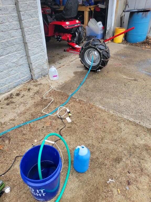

OldWorkHorse 3,156 #9829 Posted March 20, 2021 1 minute ago, Tuneup said: Lined up my 20 gallons of washer fluid. 11 are pinkish and 9 purple. Both Wally World and both -25. Whatever. Right rear got pink. Gravity feed from a 4" PVC end cap and tap. Hooked mine to a pump. She's heavy now! 4 Share this post Link to post Share on other sites

Tuneup 1,459 #9831 Posted March 20, 2021 10 minutes ago, OldWorkHorse said: Hooked mine to a pump. She's heavy now! How do you displace the air in the tire? Share this post Link to post Share on other sites
OldWorkHorse 3,156 #9832 Posted March 20, 2021 9 minutes ago, Tuneup said: How do you displace the air in the tire? Pump the fluid in after gallon or 2 hit the release button vents the air out then keep pumping do it like thst till fluid starts coming back out the tire valve then screw the pin valve back in. About 10min a tires. 4 Share this post Link to post Share on other sites
Tuneup 1,459 #9833 Posted March 20, 2021 4 minutes ago, OldWorkHorse said: Pump the fluid in after gallon or 2 hit the release button vents the air out then keep pumping do it like thst till fluid starts coming back out the tire valve then screw the pin valve back in. About 10min a tires. Gracias! A pump might be added to the list, after the welder and lathe. Welder for that deck repair. I haven't played with welding since freshman year in high school - 1977...moving the puddle along. Practice first. 3 Share this post Link to post Share on other sites
OldWorkHorse 3,156 #9834 Posted March 20, 2021 (edited) 2 minutes ago, Tuneup said: Gracias! A pump might be added to the list, after the welder and lathe. Welder for that deck repair. I haven't played with welding since freshman year in high school - 1977...moving the puddle along. Practice first. Harbor freight garden hose transfer pump and a air to water valve stem addapter kit at tractor supply. I'm new to welding to! I trust my welds for me 😆 there getting better all in good time. Oh yeah shut pump off b4 hitting the vent button! Edited March 20, 2021 by OldWorkHorse 3 Share this post Link to post Share on other sites

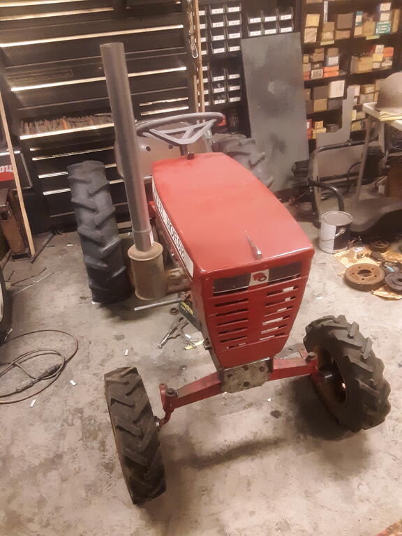

Oldskool 6,679 #9837 Posted March 20, 2021 Ended the day by mocking up some exhaust. Bits and pieces laying around the shop. I think it will do just fine. 8 3 Share this post Link to post Share on other sites

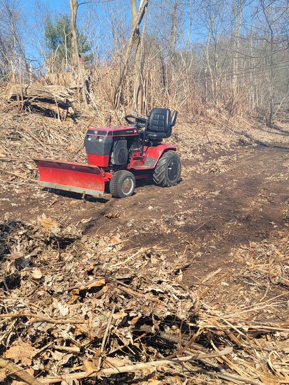

Jhook 849 #9838 Posted March 21, 2021 Threw the plow back on for a little bit of spring cleanup in the yard today 8 1 Share this post Link to post Share on other sites
Tuneup 1,459 #9839 Posted March 21, 2021 1 minute ago, Jhook said: Threw the plow back on for a little bit of spring cleanup in the yard today Nice. That has burn pile written all over it! Share this post Link to post Share on other sites

Jhook 849 #9847 Posted March 21, 2021 27 minutes ago, Tuneup said: Nice. That has burn pile written all over it! Ive had the burn barrel going for 4 days straight. Hopefully tomorrow is a good day to light the whole pile up 2 Share this post Link to post Share on other sites

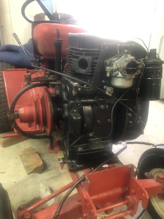

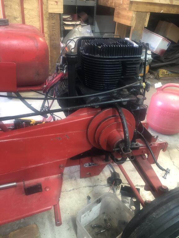

The Tuul Crib 7,354 #9849 Posted March 21, 2021 Spent the day finishing up hook ups on the 12 horse. Should have it running tomorrow 8 1 Share this post Link to post Share on other sites
ashtonosborne2019 18 #9850 Posted March 21, 2021 is that the same motor as a sears suburban 12? Share this post Link to post Share on other sites
