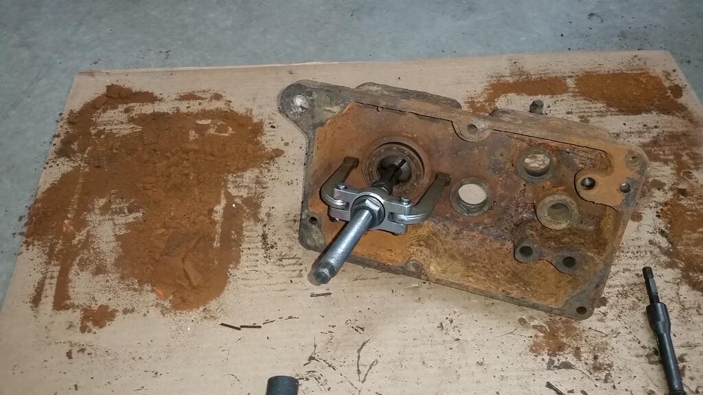

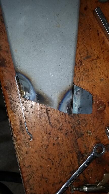

WHX?? 58,225 #9604 Posted March 8, 2021 Fabbed some dodad's for a 701 belt guard. Waiting to weld them on till mock up. 'Side's my new to me welder is not set up yet. Ordered the 40 dollar cart and 50 buck helmet from HF over a week ago and no show yet. Started sorting tranny cases to get the best ones.... why do I always get the nasty ones. No wonder @Achto threw this project in my lap! 3 3 1 Share this post Link to post Share on other sites
Achto 32,795 #9605 Posted March 8, 2021 30 minutes ago, WHX24 said: No wonder @Achto threw this project in my lap! That tranny don't look that bad. Just needs some high speed media thrown at it and a few new bearings. Any of the gears beyond reusing?? Share this post Link to post Share on other sites
953 nut 69,556 #9606 Posted March 8, 2021 I see you will be using a lightweight transmission. With all that metal that turned to rust it is bound to be a couple pounds less. 7 Share this post Link to post Share on other sites

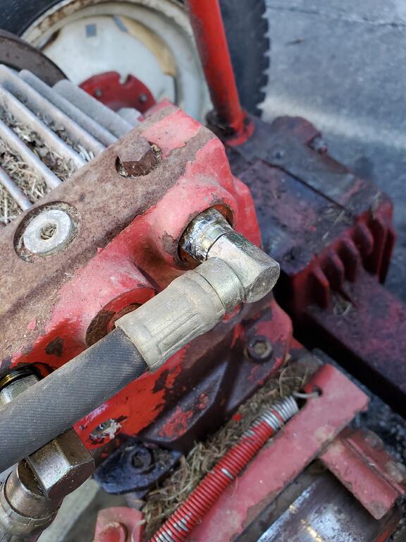

chip61 666 #9607 Posted March 8, 2021 What should have been a quick and easy transmission swap turned into several trips looking for something to loosen this fitting. It's recessed and I'm not sure what was used to tighten it but I haven't found anything that will work. The other end of the line that was on the valve has a thicker fitting and would be no problem. I may just cut the fitting off and have a new one made. The more I work on this C141 the more I appreciate the simplicity of the CXX0 tractors. What I had to pull apart to get to the valve to remove the line was ridiculous! 1 Share this post Link to post Share on other sites
squonk 48,158 #9608 Posted March 8, 2021 4 minutes ago, chip61 said: What should have been a quick and easy transmission swap turned into several trips looking for something to loosen this fitting. It's recessed and I'm not sure what was used to tighten it but I haven't found anything that will work. The other end of the line that was on the valve has a thicker fitting and would be no problem. I may just cut the fitting off and have a new one made. The more I work on this C141 the more I appreciate the simplicity of the CXX0 tractors. What I had to pull apart to get to the valve to remove the line was ridiculous! Weatherhead socket 3 1 Share this post Link to post Share on other sites
Oldskool 6,678 #9609 Posted March 8, 2021 1 minute ago, chip61 said: What should have been a quick and easy transmission swap turned into several trips looking for something to loosen this fitting. It's recessed and I'm not sure what was used to tighten it but I haven't found anything that will work. The other end of the line that was on the valve has a thicker fitting and would be no problem. I may just cut the fitting off and have a new one made. The more I work on this C141 the more I appreciate the simplicity of the CXX0 tractors. What I had to pull apart to get to the valve to remove the line was ridiculous! Why would they build something like that? Have you tried turning the hex piece of the 90* to loosen it a bit? Share this post Link to post Share on other sites
WHX?? 58,225 #9610 Posted March 8, 2021 12 hours ago, Achto said: Any of the gears beyond reusing?? Not sure yet ...haven't got the nerve to tackle them yet. Some might be but like Dick said with all that metal turned to rust.... 1 Share this post Link to post Share on other sites
lynnmor 9,042 #9611 Posted March 8, 2021 36 minutes ago, chip61 said: What should have been a quick and easy transmission swap turned into several trips looking for something to loosen this fitting. It's recessed and I'm not sure what was used to tighten it but I haven't found anything that will work. The other end of the line that was on the valve has a thicker fitting and would be no problem. I may just cut the fitting off and have a new one made. The more I work on this C141 the more I appreciate the simplicity of the CXX0 tractors. What I had to pull apart to get to the valve to remove the line was ridiculous! Maybe a parallel clamp plus an adjustable wrench might work. 1 Share this post Link to post Share on other sites
Pullstart 71,325 #9612 Posted March 8, 2021 1 hour ago, Oldskool said: Why would they build something like that? Have you tried turning the hex piece of the 90* to loosen it a bit? It looks like that’s a swivel end to me. I don’t think that would help unfortunately. 1 1 Share this post Link to post Share on other sites
chip61 666 #9613 Posted March 8, 2021 Yea, it's a swivel. I think I've found an offset thinwall crowsfoot that will work. I should have it tomorrow. 4 Share this post Link to post Share on other sites
squonk 48,158 #9614 Posted March 8, 2021 (edited) 32 minutes ago, chip61 said: Yea, it's a swivel. I think I've found an offset thinwall crowsfoot that will work. I should have it tomorrow. Pretty much the same concept of the Wetherhead socket I posted. That looks like a Weatherhead fitting 9:33 into the video explains them. Edited March 8, 2021 by squonk 2 1 Share this post Link to post Share on other sites

Ed Kennell 47,403 #9616 Posted March 8, 2021 5 hours ago, Oldskool said: Why would they build something like that? Have you tried turning the hex piece of the 90* to loosen it a bit? I would cut the raised boss away enough to get a tubing wrench on the hex. 5 Share this post Link to post Share on other sites

chip61 666 #9618 Posted March 8, 2021 1 hour ago, squonk said: Pretty much the same concept of the Wetherhead socket I posted. That looks like a Weatherhead fitting 9:33 into the video explains them. Thanks!! That would work. Finding something like that local on a Saturday just wasn't going to happen. Good video, maybe that would've helped the people at NAPA understand what I wanted Share this post Link to post Share on other sites

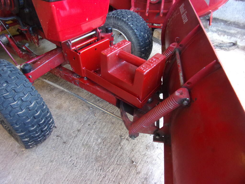

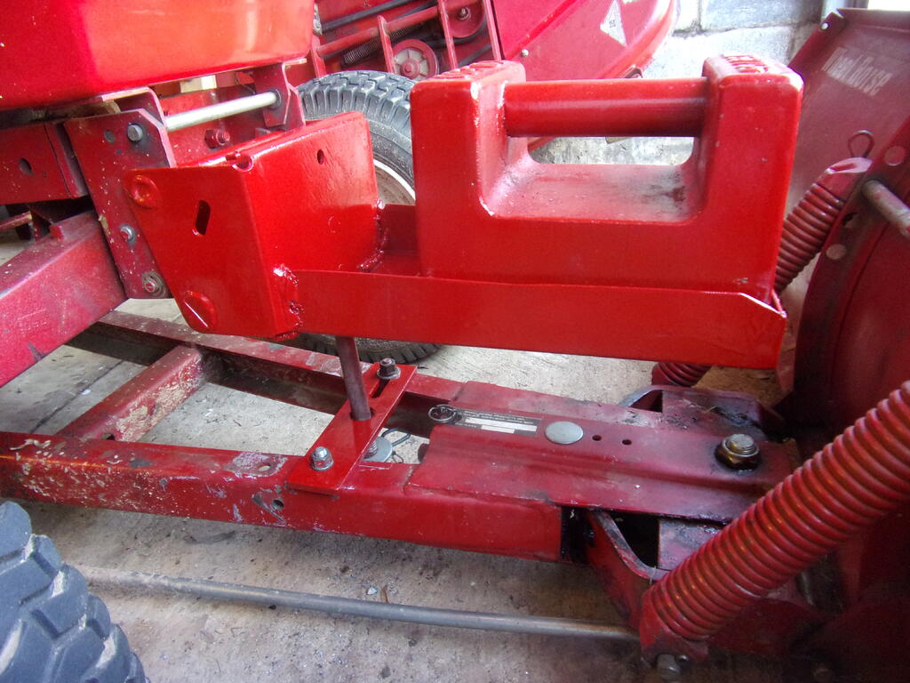

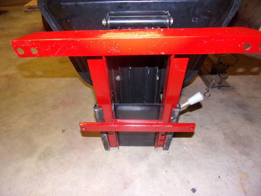

Ed Kennell 47,403 #9621 Posted March 8, 2021 Had some parts on the paint drier. Used an old mule drive to make a front weight rack and plow stabilizer for the 312H. And a sliding seat mount for the new seat going on the 417H. 2 11 Share this post Link to post Share on other sites
