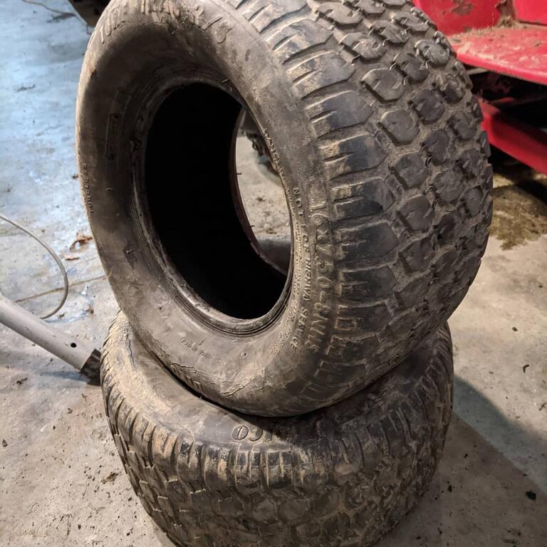

Flat Thunder Channel 178 #8857 Posted January 24, 2021 Last night I went to war with my new 520 front tires. Carrying nothing but a set of tire spoons I was ill prepared for what I thought would be a simple task. I may have won one of the battles, but the new tires won the war. I will be replacing one of the new tires with another new unit soon. I damaged the bead fighting it on the rim. I never imagined it would be so difficult. Not messing around on the next one. I am taking to Dad's garage to use the tire changing tool. 2 4 Share this post Link to post Share on other sites

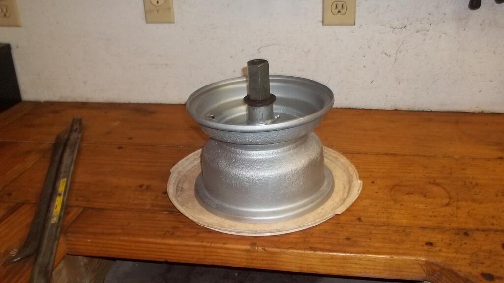

953 nut 69,696 #8862 Posted January 25, 2021 3 hours ago, Flat Thunder Channel said: I damaged the bead fighting it on the rim. I never imagined it would be so difficult. Not messing around on the next one. I have a 3/4" all thread like EB was talking about but mine is bolted through the work bench. Holds the wheel while tires go on or off. plasdtic lid under the rim and some fingers cut from an old leather glove help save the paint. 5 4 Share this post Link to post Share on other sites

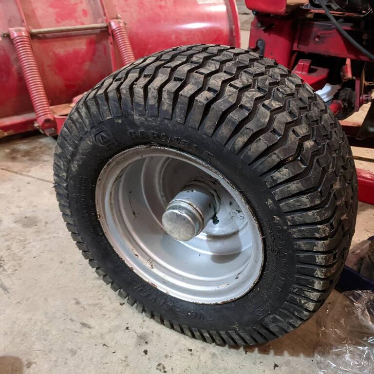

Flat Thunder Channel 178 #8872 Posted January 25, 2021 Thanks for all the responses everyone. You have some great ideas and solutions for these tiny tire changing problems. I talked with Dad yesterday and found out his tire changing tool does not fit tiny wheels. At that point in time I decided to purchase the mini tire changing tool from harbor freight. It's not my most glamorous moment, but hopefully it will keep me from damaging another tire. It was $45 and the tire I ended up scraping was $35. An expensive lesson in changing little tires. If the tool doesn't work well I think I will give up and take them in next time! At one point in time I had the wheel supported on 1 inch shaft in the bench vice. It still fought me to no end and back. Temperature had to help play a role in my struggles. Chinese tires 1 / Me 0 1 Share this post Link to post Share on other sites
