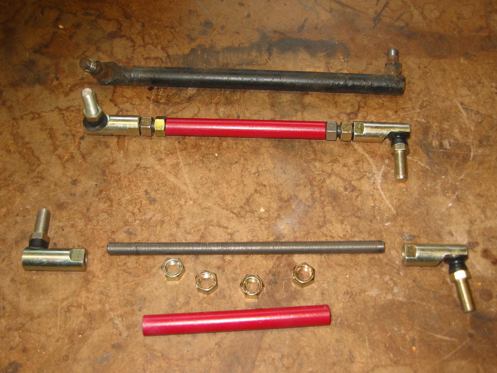

pfrederi 21,336 #861 Posted July 3, 2018 Front end of my new Charger 12 was loosey goosey. Made a new axle pivot pin added some shims to it and teh steering shaft. Tie rods had bee welded in the past and were ready to fall off, so I made up some new adjustable ones. 3 8 Share this post Link to post Share on other sites
BHunter 1,702 #862 Posted July 3, 2018 1 hour ago, pfrederi said: Front end of my new Charger 12 was loosey goosey. Made a new axle pivot pin added some shims to it and teh steering shaft. Tie rods had bee welded in the past and were ready to fall off, so I made up some new adjustable ones. They look great. Where did you find the tubes? Share this post Link to post Share on other sites
pfrederi 21,336 #863 Posted July 3, 2018 6" long 1/4" iron pipe nipples. You have to run a 3/8" drill through the to clean them out and get right size for the 3/8 all thread. (1/4 Inch pipe is actually .364 inches ID) 2 2 Share this post Link to post Share on other sites

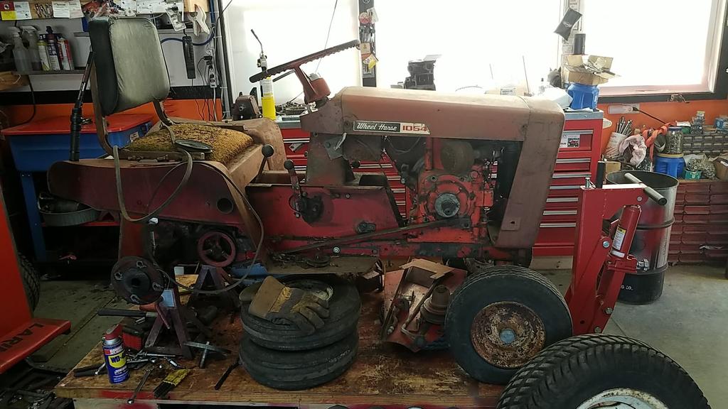

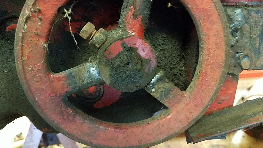

Shynon 7,729 #864 Posted July 4, 2018 1054 is back on the table. Started pulling one of the hubs till my puller bolts broke. Found my drive pulley had been welded, got a new one coming. 1 3 Share this post Link to post Share on other sites

Shynon 7,729 #866 Posted July 4, 2018 3 minutes ago, PeacemakerJack said: Tom...Is this a possible plow rig in the making? Gonna set it up to plow, gonna put an 8 pinion differential in it with the old plow tractor motor 12hp. Hope to have it ready by fall. 1 6 Share this post Link to post Share on other sites

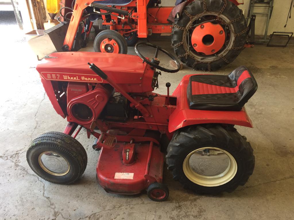

Sparky-(Admin) 26,793 #871 Posted July 4, 2018 Woke up kinda motivated....so out came the 8 speed in my C-165 that was leaking from everywhere! It’s was a hot one in the garage, about 94 degrees, but in went a nice dry tight 8 speed. Took it for a spin around the yard and all seems good 7 Share this post Link to post Share on other sites

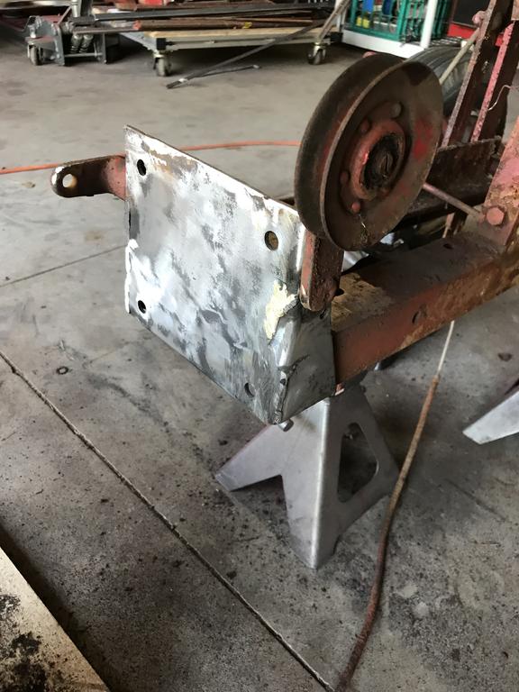

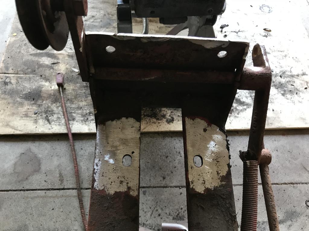

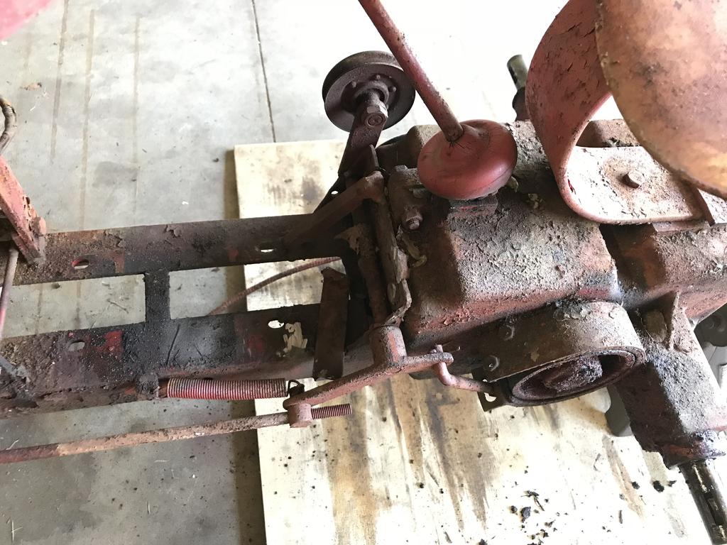

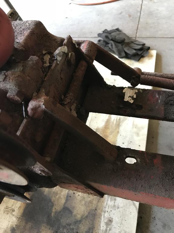

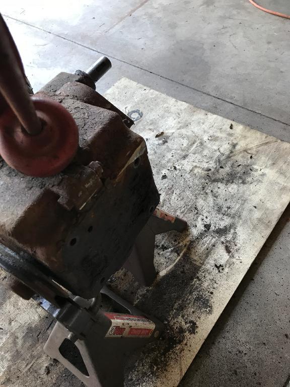

Aldon 4,834 #872 Posted July 4, 2018 Almost too hot to work in the garage. Mid 90’s. But like @Sparky, I managed a few hours with the granddaughters working at repairing the hack job frame repair some prior owner did to the 551 I picked up at the show. Managed to get the welds removed. Will work in an appropriate repair while we wait on axle seals to arrive. 6 1 Share this post Link to post Share on other sites

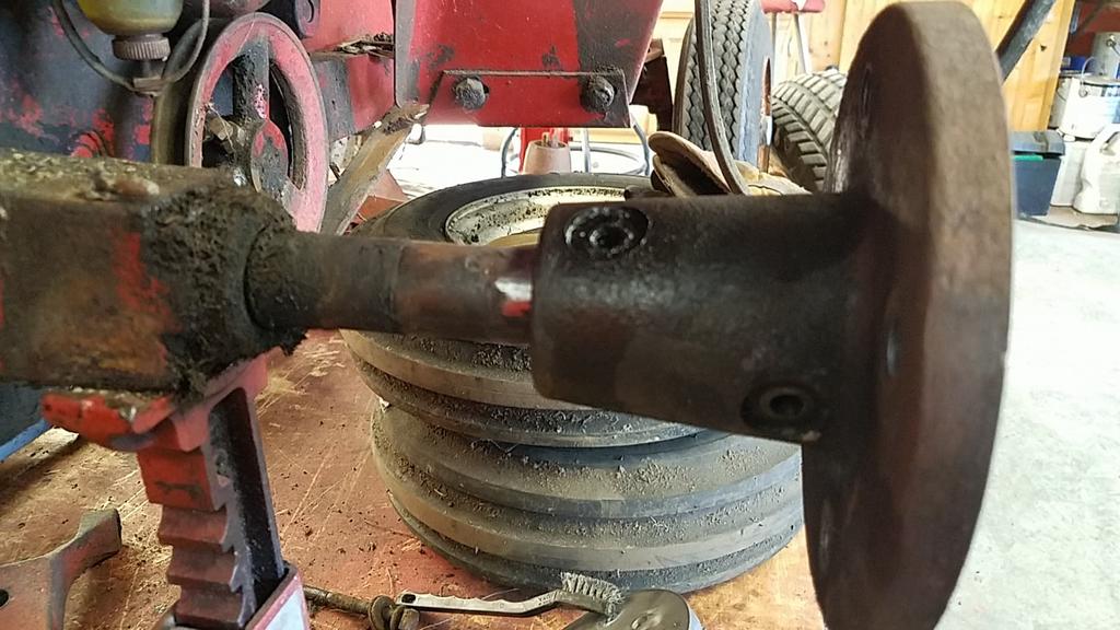

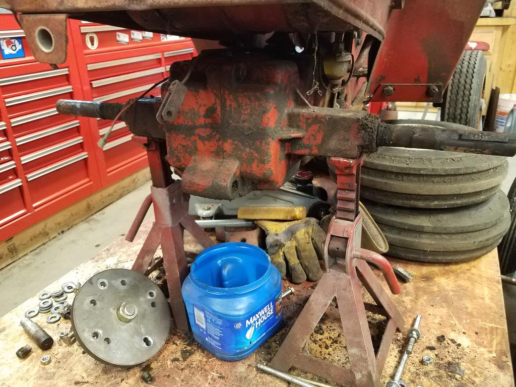

Shynon 7,729 #873 Posted July 4, 2018 Got the hubs off without breaking them. 5 Share this post Link to post Share on other sites
gwest_ca-(File Mod) 12,552 #874 Posted July 4, 2018 32 minutes ago, Aldon said: Almost too hot to work in the garage. Mid 90’s. But like @Sparky, I managed a few hours with the granddaughters working at repairing the hack job frame repair some prior owner did to the 551 I picked up at the show. Managed to get the welds removed. Will work in an appropriate repair while we wait on axle seals to arrive. Any chance of getting some measurements from you? I have a 551 here that is missing the complete rear plate so have nothing to go by. PO gave up on the project after removing what was left of it. Transmission hole spacing not a problem but don't know how far above the frame they are. Are they centered on the frame width? Is the plate even with the bottom of the frame? Also how far above the frame is the center of the clutch shaft? How far from the plate to the center of the shaft? Garry Share this post Link to post Share on other sites
ztnoo 2,302 #875 Posted July 4, 2018 10 minutes ago, Shynon said: Got the hubs off without breaking them. Given my experience with GT 14 hubs (removing them without breaking them, that is) a big July 4th Congratulations! I'm celebrating with you with a little super high proof rum, right now!!! 151 Proof, to be exact. Some of my local friends call it "Jet Fuel". Since you are on a run......might as well try a few more hubs! It's hot today, so cast iron is about as expanded naturally as is likely to be without a torch...... 1 2 Share this post Link to post Share on other sites
