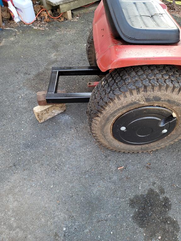

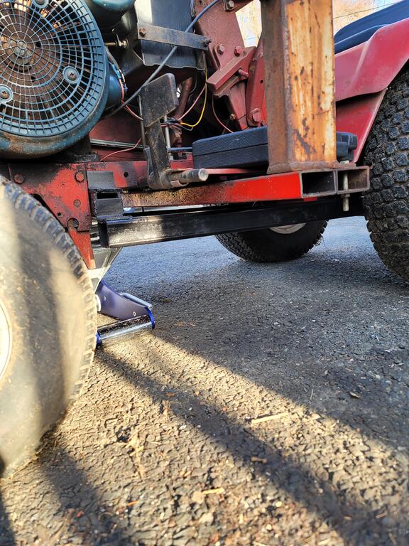

Jhook 849 #8328 Posted December 27, 2020 New spark plug and she started right up. Got a champion h10c and a autolite 216 if anyone is wondering for the k301s. Also just test fit the loader subframe/weight bracket. I think it looks pretty good. Just need to bolt it to the rear end, bolt it to the frame, and bolt it to the loader cross member. 4 Share this post Link to post Share on other sites

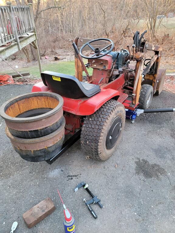

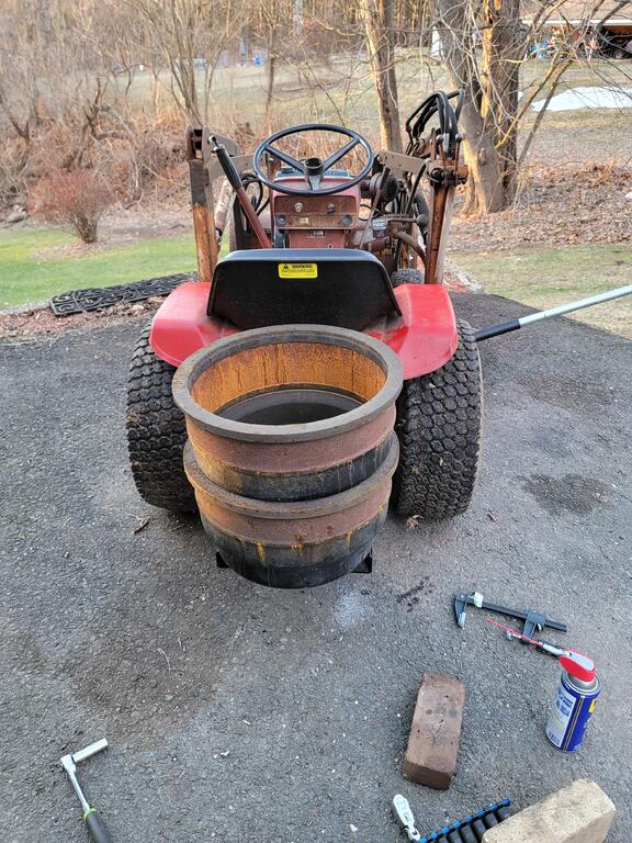

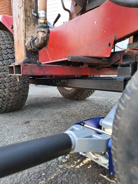

Jhook 849 #8329 Posted December 27, 2020 More progress. 2 110 lb drums on there just resting there for now. Need to weld on some studs to bolt them down to. Looking good. Think i may have a small trans leak again but could be residual. Luckily i still have the trans pullstart sent me sitting in its crate waiting to be used 6 2 Share this post Link to post Share on other sites

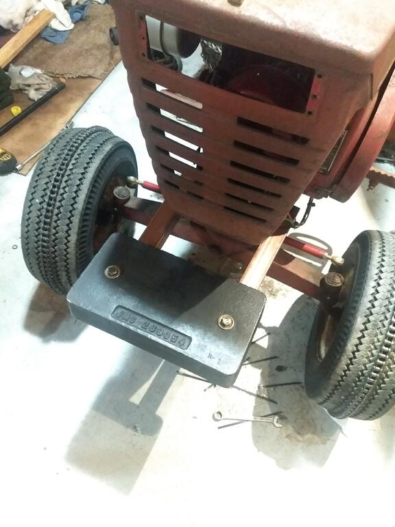

ebinmaine 80,846 #8342 Posted December 28, 2020 Trina and I did some more work to her 867 Pigpen today. I got the switch for the lights in the dash along the forward part of the harness. We removed the headlamp bucket and Trina cleaned it up and painted it bright copper. Looks awesome. I fabbed up the brackets for the front weight. She painted them and we put the weight on. The weight is either 40 or 45 pounds. After installing that and chains on the front tires it made a HUGE difference in steering. 6 5 Share this post Link to post Share on other sites
Tractorhead 9,217 #8343 Posted December 28, 2020 6 hours ago, ebinmaine said: Trina and I did some more work to her 867 Pigpen today. I got the switch for the lights in the dash along the forward part of the harness. We removed the headlamp bucket and Trina cleaned it up and painted it bright copper. Looks awesome. I fabbed up the brackets for the front weight. She painted them and we put the weight on. The weight is either 40 or 45 pounds. After installing that and chains on the front tires it made a HUGE difference in steering. Do i see it right, you have mounted a Bicycle or Motocycle chain onto front wheels? seems they should improve the steering - or? Funny idea Buddy Bear. 1 Share this post Link to post Share on other sites
rjg854 13,396 #8344 Posted December 28, 2020 Actually Roller chain helps a lot with steering when you get snow loaded up on the plow and it tries to push you sideways. It's kinda like riding on rails. I use the old chain from the snow thrower. #40 roller chain 1 Share this post Link to post Share on other sites
ebinmaine 80,846 #8345 Posted December 28, 2020 6 minutes ago, Tractorhead said: Do i see it right, you have mounted a Bicycle or Motocycle chain onto front wheels? seems they should improve the steering - or? Funny idea Buddy Bear. Got it from Redsquare. Works great but I need to tighten it. 1 1 Share this post Link to post Share on other sites

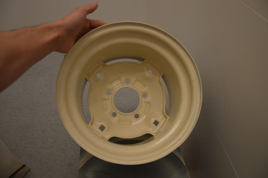

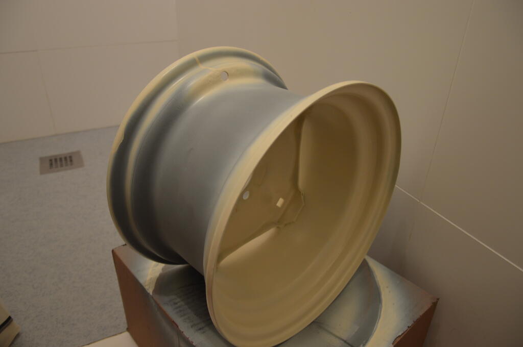

Maxwell-8 4,371 #8349 Posted December 28, 2020 (edited) A late christmas gift? Nope hahahaha , I restored these rims the past week, Looks good. No? no? Edited December 28, 2020 by Maxwell-8 6 4 Share this post Link to post Share on other sites

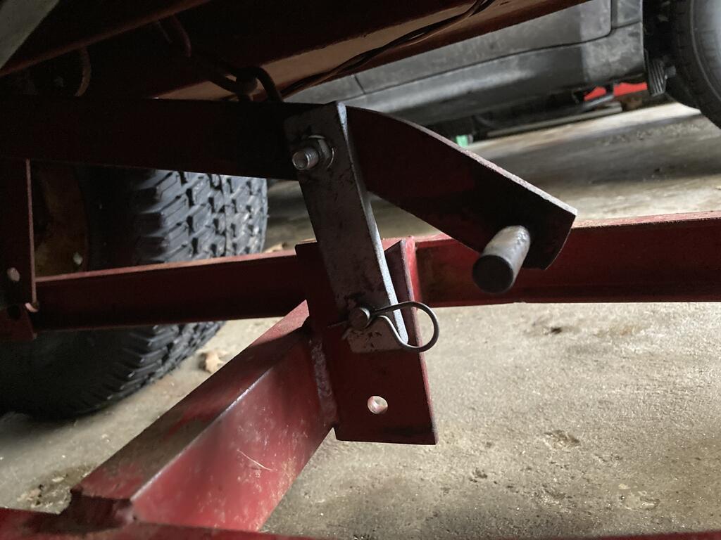

SylvanLakeWH 32,668 #8350 Posted December 28, 2020 Adjusted the front blade linkage to accommodate higher blade height when blade is up. When I installed Lowell’s new hitch with the rear bracket it changed the height of the rear of the blade. So I needed to change the middle connection. I used left overs from the new hitch! The blade is not correct for my tractor, but PO did good job fabricating it and it works great!!! 4 3 Share this post Link to post Share on other sites
