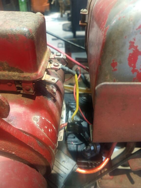

ebinmaine 80,764 #8305 Posted December 26, 2020 Been working on Trina's Pigpen 867 a little the last month or so. The starter/generator has needed a bearing replaced for a looong time so I got that done. Replaced both bearings and cleaned it up some inside. Brushes were fine. Changed the engine oil. Last night I started adding a light circuit to it. Had headlights originally. I've ordered replacement sockets for the stock headlamp setup. I'll be adding some 3/4" white LEDs at the back and a small set off 2" round black LEDs at the front on magnetic bases that'll point out at forward left and right angles. 6 1 1 Share this post Link to post Share on other sites

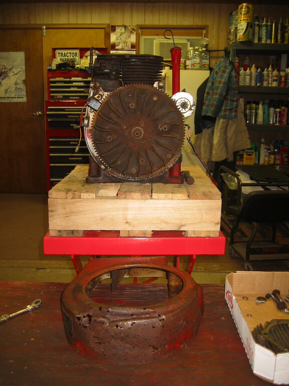

pfrederi 21,172 #8308 Posted December 26, 2020 Pulled the head on a non-running K301 I picked up a couple years ago. Big reveal always wonder what the piston will be stamped. STD .010 OK .030 parts pile...Had to clean off some carbon for the big reveal .003 cylinder wall looks good. This one will get stripped down and off to the machine shop for bore and grind... 11 Share this post Link to post Share on other sites
ebinmaine 80,764 #8309 Posted December 26, 2020 52 minutes ago, pfrederi said: Pulled the head on a non-running K301 I picked up a couple years ago. Big reveal always wonder what the piston will be stamped. STD .010 OK .030 parts pile...Had to clean off some carbon for the big reveal .003 cylinder wall looks good. This one will get stripped down and off to the machine shop for bore and grind... Got that rare extra ventilated engine shroud Paul? 1 Share this post Link to post Share on other sites
rjg854 13,374 #8310 Posted December 26, 2020 Shroud is looking mighty rough, you gonna replace it or can you fix it? 1 Share this post Link to post Share on other sites
pfrederi 21,172 #8311 Posted December 26, 2020 6 minutes ago, rjg854 said: Shroud is looking mighty rough, you gonna replace it or can you fix it? Replace...Painting and body work are not my hobbies.... I only do things I enjoy 2 3 1 Share this post Link to post Share on other sites
pfrederi 21,172 #8312 Posted December 26, 2020 24 minutes ago, ebinmaine said: Got that rare extra ventilated engine shroud Paul? As I said no body work...maybe some duct tape??? 1 3 Share this post Link to post Share on other sites

Maxwell-8 4,371 #8317 Posted December 27, 2020 (edited) 14 hours ago, ebinmaine said: Been working on Trina's Pigpen 867 a little the last month or so. The starter/generator has needed a bearing replaced for a looong time so I got that done. Replaced both bearings and cleaned it up some inside. Brushes were fine. Changed the engine oil. Last night I started adding a light circuit to it. Had headlights originally. I've ordered replacement sockets for the stock headlamp setup. I'll be adding some 3/4" white LEDs at the back and a small set off 2" round black LEDs at the front on magnetic bases that'll point out at forward left and right angles. That's how clamp-connections shoud be made! Edited December 27, 2020 by Maxwell-8 Correcting autocorrection 1 1 Share this post Link to post Share on other sites

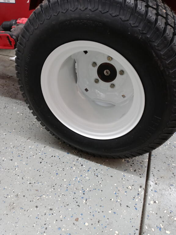

Horse Newbie 7,405 #8320 Posted December 27, 2020 Got my freshly powder coated wheels put on the 520 H today...new bearings and seals on front, two new front tires. 3 3 Share this post Link to post Share on other sites
