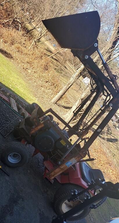

Jhook 849 #8282 Posted December 23, 2020 Ordered a ton of hydraulic parts to overhaul the current pump system on the charger 12 loader. Hydraulic parts are NOT cheap. On the way is a new: 0.36 ci pump 2.9gpm/5.7gpm, an aluminum foot mount, suction hose, fittings for inlet amd outlet port, and some other small things. With the new hydro system and transmission i got from pullstart i should have a nice reliable loader in the spring time. Gotta try and get it up the hill thru the snow so i can work on building a subframe. 3 1 Share this post Link to post Share on other sites

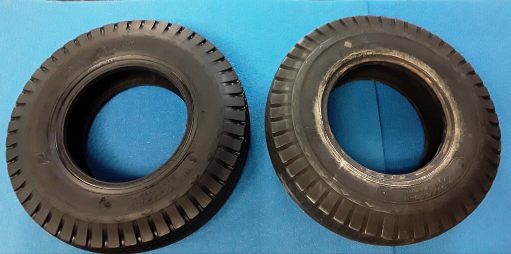

sparkie333 265 #8286 Posted December 23, 2020 On 12/21/2020 at 9:49 AM, Lane Ranger said: Old tires always look better with M. E. Miller Tire paint. One or two coats on 60 year old tires will surprise even the most particular restorer to the quality look achieved ! The attached ag tire photo is of an original 1958 RJ tractor tire! I have used it for years and highly recommend its use. Are there still some of the old post where they were doing a tractor of the month post or pictures? 1 Share this post Link to post Share on other sites

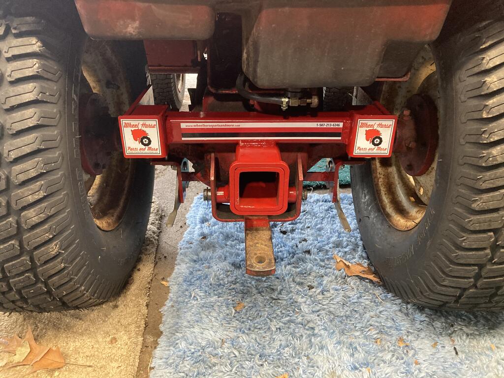

SylvanLakeWH 32,668 #8287 Posted December 24, 2020 Installed new hitch from Wheel Horse Parts and More...! Love it! 7 2 2 Share this post Link to post Share on other sites

RandyLittrell 3,946 #8289 Posted December 24, 2020 26 minutes ago, SylvanLakeWH said: Installed new hitch from Wheel Horse Parts and More...! Love it! I bought the same thing, but in black. Can't wait to get it on! Randy 5 Share this post Link to post Share on other sites
SylvanLakeWH 32,668 #8290 Posted December 24, 2020 40 minutes ago, RandyLittrell said: I bought the same thing, but in black. Can't wait to get it on! Randy Good choice! Suggested install tips: take the rear tires off for easy access to the hitch bolts... 3 Share this post Link to post Share on other sites
RandyLittrell 3,946 #8291 Posted December 24, 2020 17 minutes ago, SylvanLakeWH said: Good choice! Suggested install tips: take the rear tires off for easy access to the hitch bolts... Yup, gonna install cub weights on the inside! Randy 1 2 Share this post Link to post Share on other sites

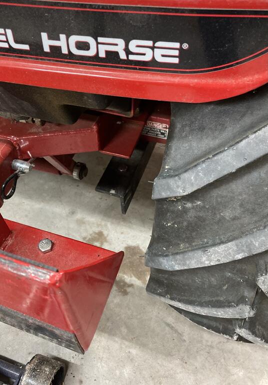

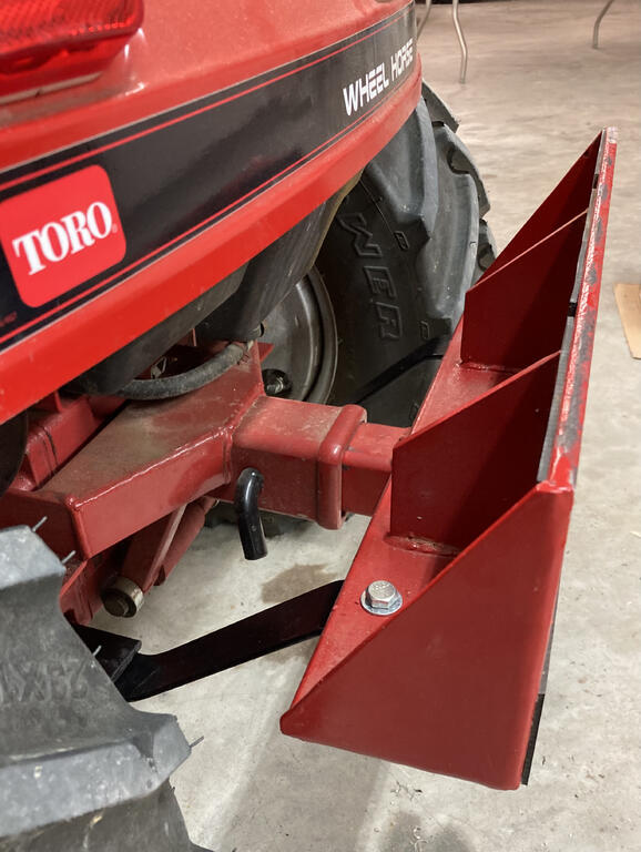

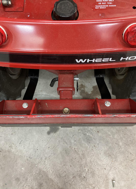

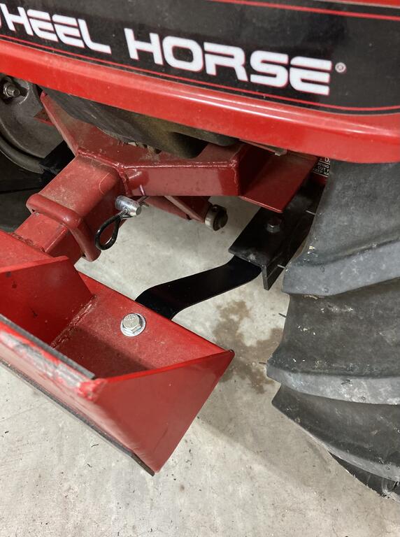

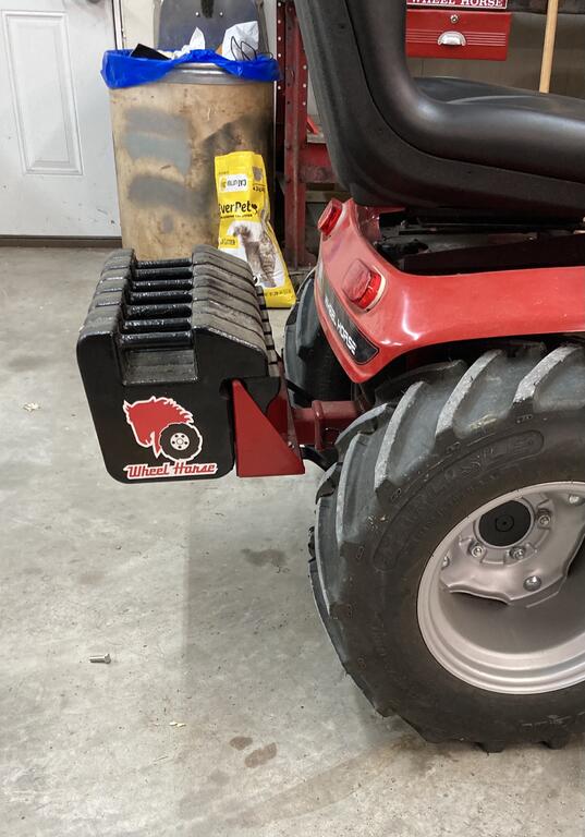

cschannuth 3,821 #8293 Posted December 24, 2020 I added some supports to my rear suitcase weight bracket today. Until now all the weight was hanging from the receiver hitch. When I built the subframe I drilled a pair of holes at the rear in prep for this and just never got around to it. I bent up some 3/16 x 1 1/2” flat bar. I put a jack under the weight rack to lift it up when drilling the holes in the braces and the rack. In my mind that would maximize the amount of weight the braces/subframe would support and minimize the amount of weight on the hitch. It seemed to work. When everything was reassembled the rack was no longer resting in the bottom of the 2” receiver. 7 7 Share this post Link to post Share on other sites
Jhook 849 #8294 Posted December 24, 2020 23 minutes ago, cschannuth said: I added some supports to my rear suitcase weight bracket today. Until now all the weight was hanging from the receiver hitch. When I built the subframe I drilled a pair of holes at the rear in prep for this and just never got around to it. I bent up some 3/16 x 1 1/2” flat bar. I put a jack under the weight rack to lift it up when drilling the holes in the braces and the rack. In my mind that would maximize the amount of weight the braces/subframe would support and minimize the amount of weight on the hitch. It seemed to work. When everything was reassembled the rack was no longer resting in the bottom of the 2” receiver. How much total weight is on that rear bracket? Looks nice i need to build my weight setup soon 1 Share this post Link to post Share on other sites

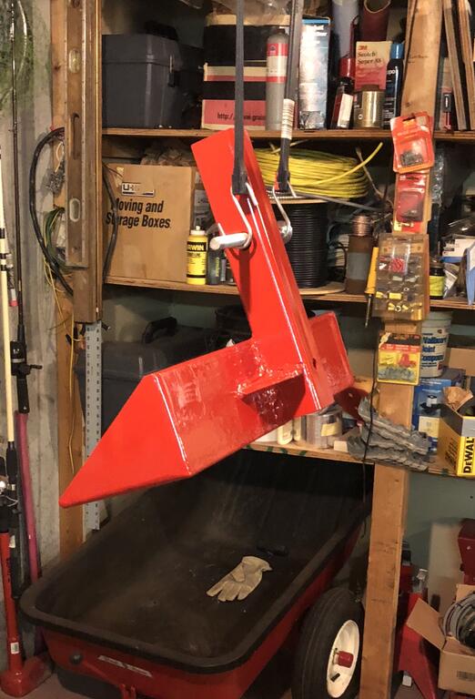

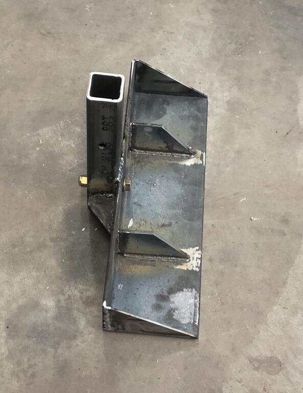

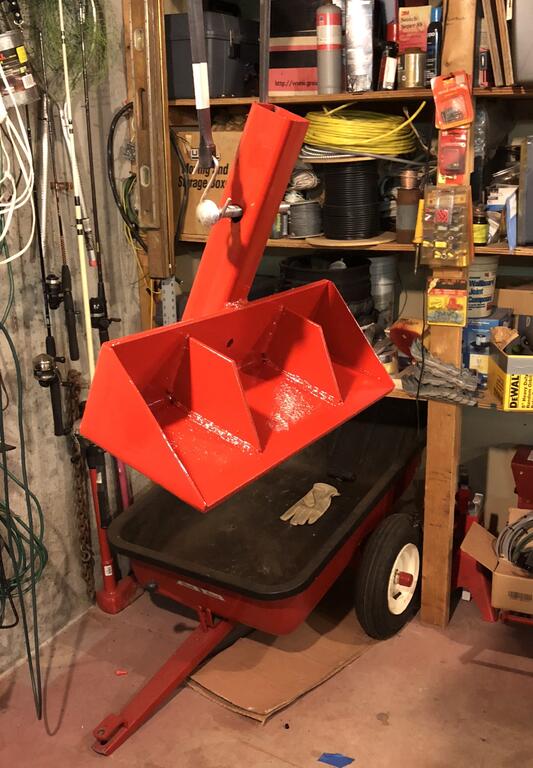

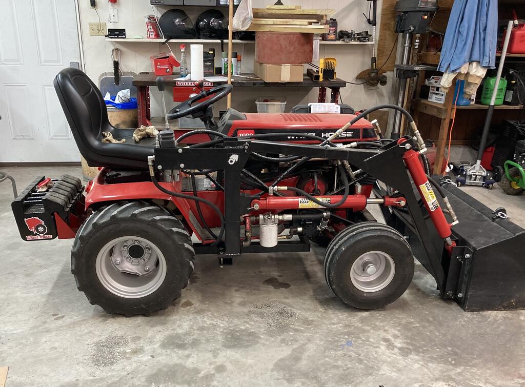

cschannuth 3,821 #8295 Posted December 24, 2020 9 minutes ago, Jhook said: How much total weight is on that rear bracket? Looks nice i need to build my weight setup soon About 300 pounds. My buddy works at a JD dealership and found the 7 - 42 lb weights in their used weight pile that I cleaned up and painted black(yes there’s some green paint under there). The weight holder itself weighs about 20 lbs. Here are some pics when I built it a couple years ago. 4 3 Share this post Link to post Share on other sites

Jhook 849 #8297 Posted December 24, 2020 10 hours ago, cschannuth said: About 300 pounds. My buddy works at a JD dealership and found the 7 - 42 lb weights in their used weight pile that I cleaned up and painted black(yes there’s some green paint under there). The weight holder itself weighs about 20 lbs. Here are some pics when I built it a couple years ago. Nice looks great. I think ill add between 2 and 3 hundred to my loader and see how it does. Works ok now with 50 pound wheel weights and loaded tires but not a lot of pushing traction 1 Share this post Link to post Share on other sites
ebinmaine 80,846 #8298 Posted December 24, 2020 38 minutes ago, Jhook said: Nice looks great. I think ill add between 2 and 3 hundred to my loader and see how it does. Works ok now with 50 pound wheel weights and loaded tires but not a lot of pushing traction One of the other things to remember that I just recently learned about is when you have a loader tractor it's important to put weight BEHIND the rear axle. That gives you the double benefit of increasing traction and decreasing the load on the steering axle. 1 Share this post Link to post Share on other sites
cschannuth 3,821 #8299 Posted December 24, 2020 1 hour ago, Jhook said: Nice looks great. I think ill add between 2 and 3 hundred to my loader and see how it does. Works ok now with 50 pound wheel weights and loaded tires but not a lot of pushing traction I have loaded tires, inside wheel weights, the 300, and my 230 and it works well. 1 1 Share this post Link to post Share on other sites
