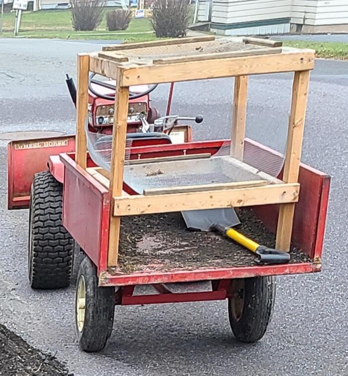

8ntruck 9,328 #8127 Posted December 14, 2020 2 hours ago, ArturHawk said: @8ntruck - A buddy game me some frames he made for tables. I added 1/2" screen on the top and 1/4" screen on the bottom. Three scoops of dirt...shake...remove big gravel ...shake again...remove pea gravel from bottom...when dirt gets too high, empty cart. Having the whole assembly on the trailer makes it easier to shake. Sorry for the bad pic. I was lucky to have it in the background of the few pics I took. Thanks. I figured it was a setup that had multiple screens. By the way, the picture is fine. Share this post Link to post Share on other sites
8ntruck 9,328 #8128 Posted December 14, 2020 (edited) 2 hours ago, ArturHawk said: @8ntruck - A buddy game me some frames he made for tables. I added 1/2" screen on the top and 1/4" screen on the bottom. Three scoops of dirt...shake...remove big gravel ...shake again...remove pea gravel from bottom...when dirt gets too high, empty cart. Having the whole assembly on the trailer makes it easier to shake. Sorry for the bad pic. I was lucky to have it in the background of the few pics I took. Thanks. I figured it was a setup that had multiple screens. By the way, the picture is fine. Sorry about the double post. Had some sort of glitch that made it look like my first reply didn't post. Edited December 14, 2020 by 8ntruck Share this post Link to post Share on other sites

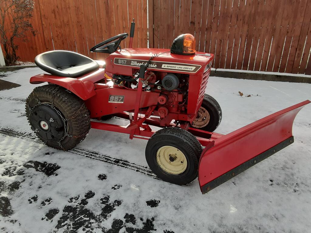

D_Mac 9,339 #8143 Posted December 15, 2020 I was like a kid when I woke up this morning. I heard we were going to get a little snow last night. I been dying to try the plow on my 857. I woke up got dressed and couldnt wait to get to the garage. Well we didnt get hardly any snow. Pushed it out into the driveway..... took some pictures of it . You guys tired of it yet ? lol . Then I rolled it back into the garage. I figure these tractors are like a pretty woman.... never get tired of looking at a pretty woman. Soon... soon there will be enough snow to push. I only want to try it once, then I will be happy if it didnt snow again all season. 3 2 Share this post Link to post Share on other sites
Tractorhead 9,217 #8144 Posted December 15, 2020 26 minutes ago, D_Mac said: I was like a kid when I woke up this morning. I heard we were going to get a little snow last night. I been dying to try the plow on my 857. I woke up got dressed and couldnt wait to get to the garage. Well we didnt get hardly any snow. Pushed it out into the driveway..... took some pictures of it . You guys tired of it yet ? lol . Then I rolled it back into the garage. I figure these tractors are like a pretty woman.... never get tired of looking at a pretty woman. Soon... soon there will be enough snow to push. I only want to try it once, then I will be happy if it didnt snow again all season. Don‘t be afraid, that‘s totally normal. greet‘s over the Big Pond from Stefan, who‘s still waiting for the first Snow to Play....👍 2 1 Share this post Link to post Share on other sites

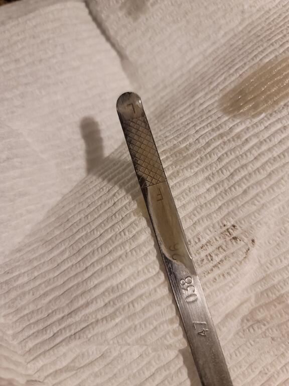

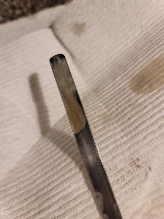

Jhook 849 #8146 Posted December 15, 2020 Does this oil look a little odd to any of you? Its from the ch15s engine in my 315. It has 10 full throttle hours on it and it almost looks too clean maybe even a little bit of a streak in it? Idk i could be paranoid for nothing. Just checked it cause ill be pushing snow the next 2 days in MA also its not overfilled, the stick was out for a minute while i ran inside to take a pic so the oil spread out Share this post Link to post Share on other sites
953 nut 69,698 #8147 Posted December 15, 2020 That milkshake look could be due to some moisture (condensation or water) in the oil. 2 2 Share this post Link to post Share on other sites
