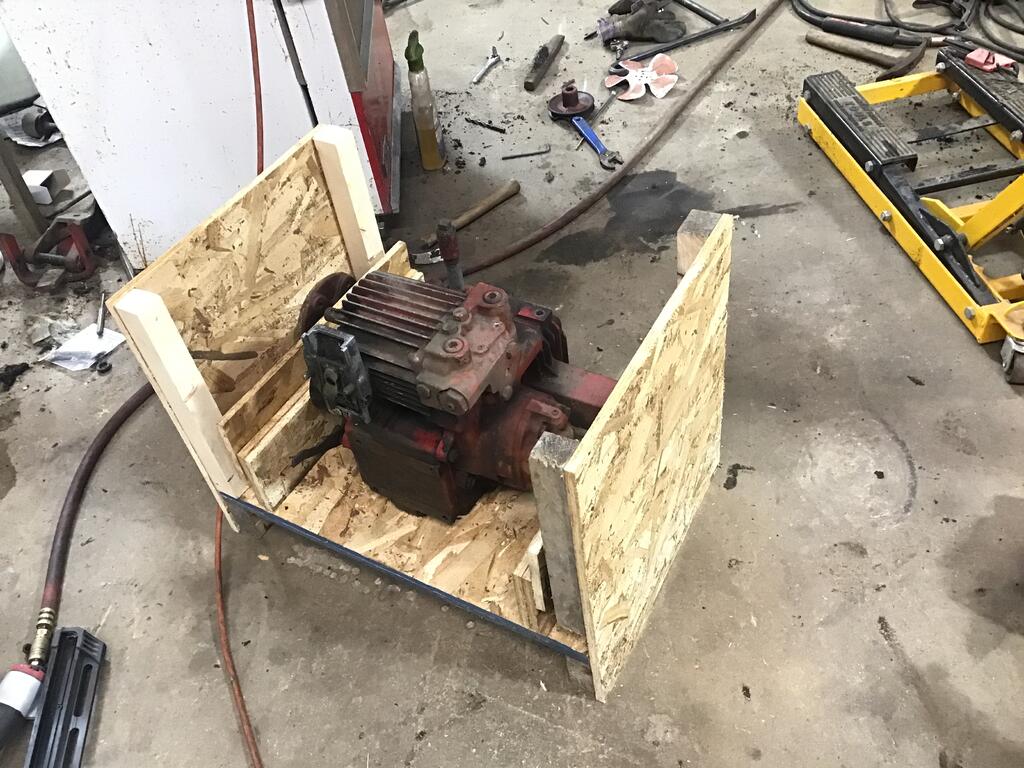

Pullstart 71,350 #8009 Posted November 30, 2020 Got some shop time to finish crating a transmission. @Jhook I got that pulley off 2 Share this post Link to post Share on other sites
Jhook 849 #8010 Posted November 30, 2020 (edited) 13 minutes ago, pullstart said: Got some shop time to finish crating a transmission. @Jhook I got that pulley off Nice. I like the assortment of multiple hammers/crowbars and other large prying objects you used😂 i had 3 different hammers 2 bars and a 4x4 out earlier pounding the old pins out of the loader. Axle seals are already shipped on the way to me for that unit. Going to try and get the subframe built while i swap the transmissions all in 1 shot. Edited November 30, 2020 by Jhook 1 1 Share this post Link to post Share on other sites

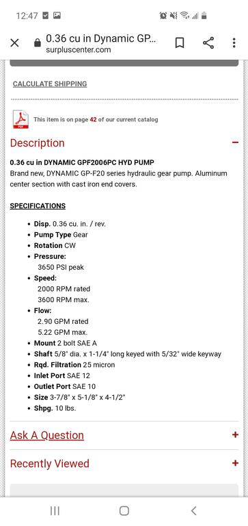

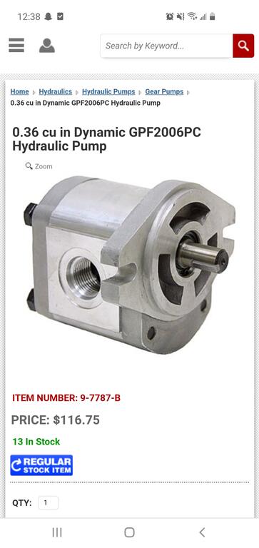

Tractorhead 9,217 #8011 Posted November 30, 2020 6 hours ago, Jhook said: The pump leaked a few ounces of fluid on a short drive down the hill. The tire was completely covered and pump was dripping. Stopped and check fluid level, its over half full so that's fine. Didnt leak any more after that at all. Not sure why. Also the pump bracket is welded in crooked putting stress on the shaft. It is all wet around the shaft. Thoughts on this one? Yap, You can use different Sets of Pumps, important is, that you take care it is able to work with side load. Most pumps needs intent bearings, that will handle a sideway force to destress the pumpspindle itself. depending on rotation direction on the Pump and PTO also a Car powersteering pump can be used. They typically delivers 90-160 Bar of Pressure what is more than enough. the fluidconsumpt is with about 2.9gpm similar to that pump you showed Powesteering pumps have 3 Advantages Cheap (because of Mass production) usable for sideway Load. (Belt drive) Standart Connectors and flanges for easy mount. 3 1 Share this post Link to post Share on other sites

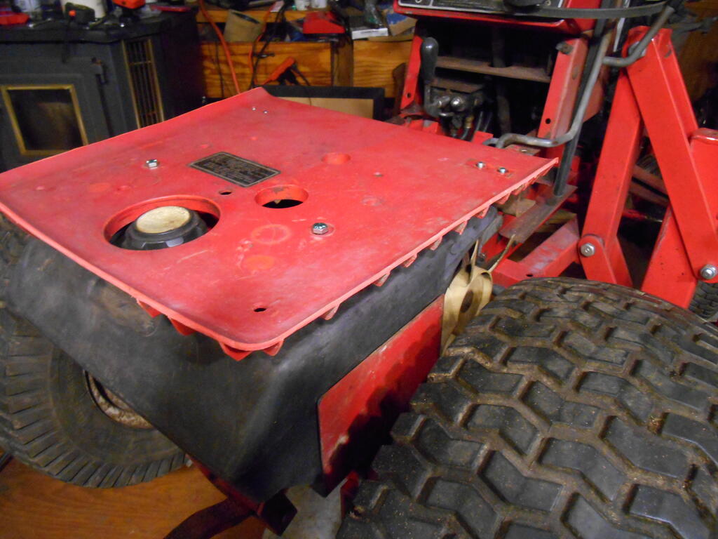

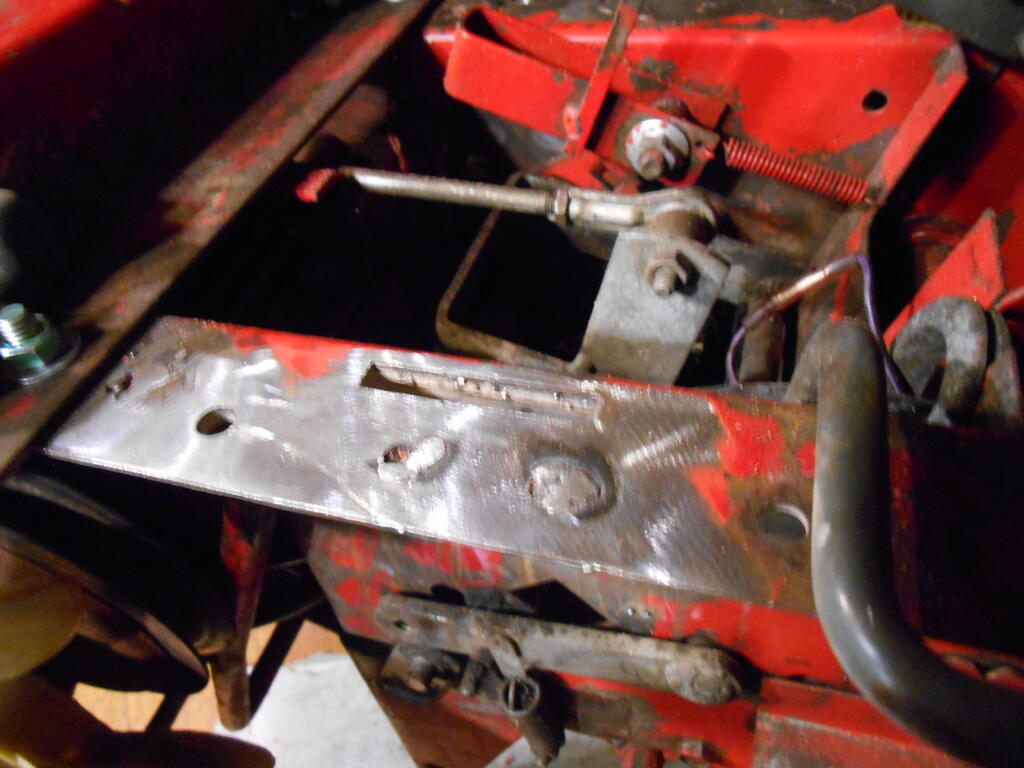

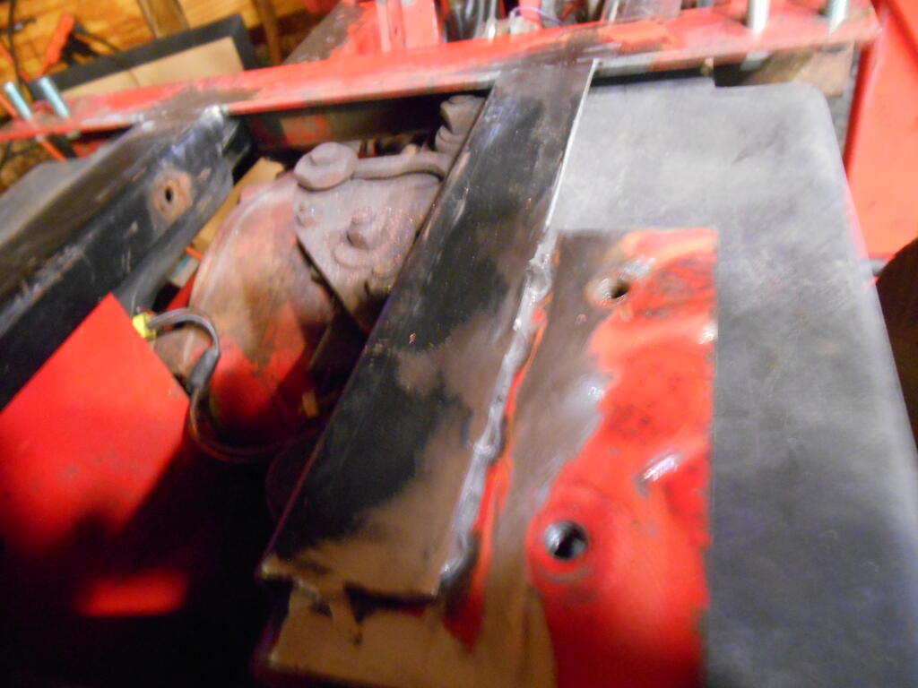

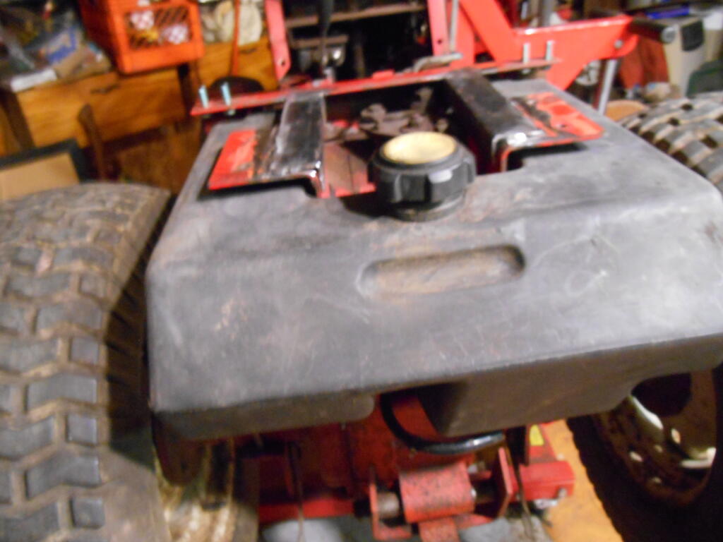

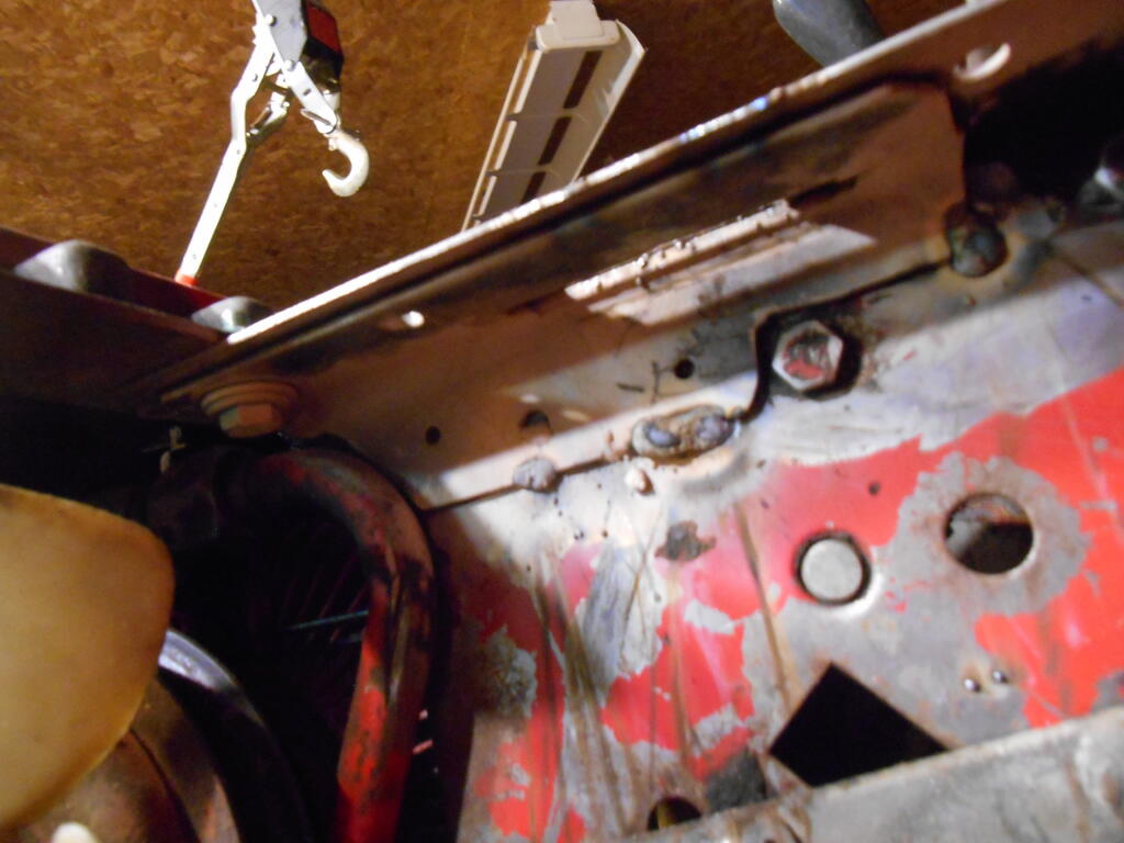

ohiofarmer 3,504 #8012 Posted November 30, 2020 (edited) I re- inforced the trans tunnel with broken out bolt holes, using a bed frame. Bed frames are the best angle iron to use for this repair--thin and tough, but hard to drill.Tried to use a very expensive cobalt Milwaukee drill bit and it was not effective at all. I finally took a harbor Freight step drill ( the pointy one) and i'll be dipped if it didn't work. gotta keep the RPM slow to make it cut. Sooner or later, if you have a later c-series or a 300,400, or 500 series, those rear holes are gonna bust out. So the first pic shows what is left of the fender pan. I threaded the bolts from the bottom as studs to line everything up to the fender pan.. The second and third pics show the angle added to tie the gas tank mount to the front seat Z frame support. Check it carefully before you weld the back to the front as the holes must align with the seat pan. I notched the angle to support the Z frame and then butt welded the top. The fourth and fifth pic shows the plug welds from the top holding the bed frame support under the tunnel flange and the view from underneath You can see the new rear bolt to the left that was broken away before, Everything is now solid and there is no twisting load on the seat pan any longer. I can still remove everything from the tractor, but in a much larger assembly that includes the gas tank support. Edited December 1, 2020 by ohiofarmer 3 Share this post Link to post Share on other sites
SylvanLakeWH 32,674 #8013 Posted November 30, 2020 24 minutes ago, ohiofarmer said: Tried to use a very expensive cobalt Milwaukee drill bit and it was not effective at all. I finally took a harbor Freight step drill ( the pointy one) and i'll be dipped if it didn't work. Same experience here...! Been using the HF 3 step drill pack for about a year and they work great!!! Way better then a standard drill bit to start / bite on steel and quick!!! 3 Share this post Link to post Share on other sites

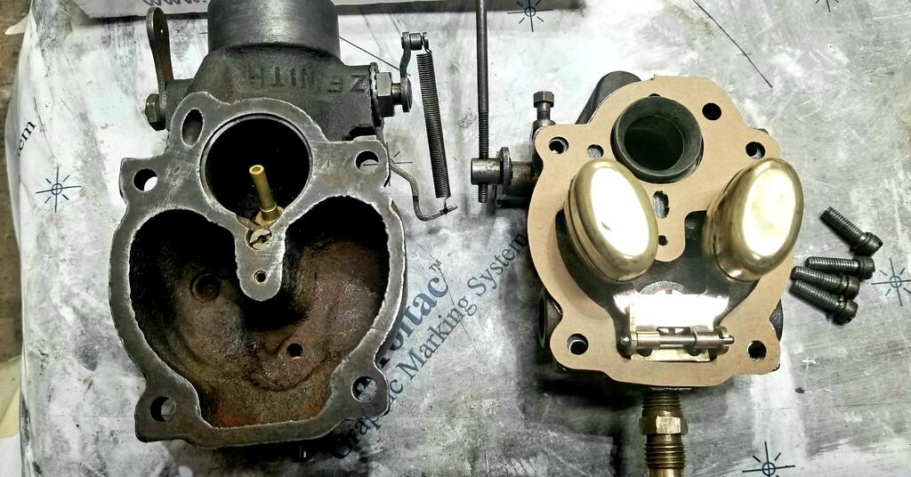

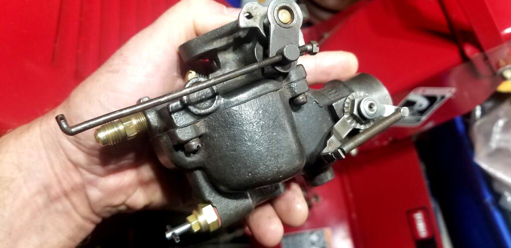

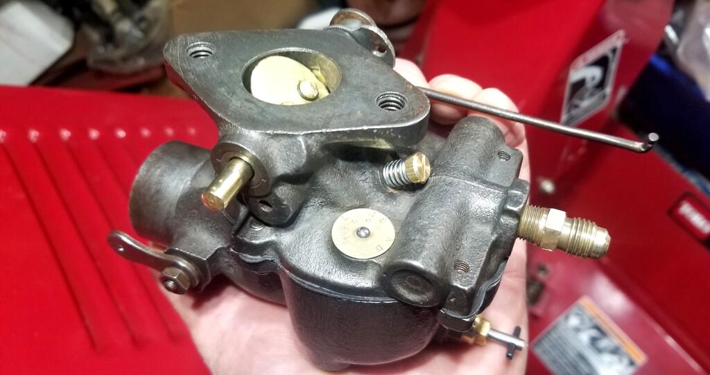

AMC RULES 37,260 #8014 Posted November 30, 2020 5 2 Share this post Link to post Share on other sites
ebinmaine 80,855 #8015 Posted November 30, 2020 28 minutes ago, AMC RULES said: Is that ford, ferguson,.... ? Share this post Link to post Share on other sites
ebinmaine 80,855 #8016 Posted November 30, 2020 Looks an awful lot like the one on the Ferguson outside. Share this post Link to post Share on other sites
AMC RULES 37,260 #8017 Posted November 30, 2020 It's a Zenith off of a Pond here Eric. 1 1 Share this post Link to post Share on other sites
ebinmaine 80,855 #8018 Posted November 30, 2020 14 minutes ago, AMC RULES said: It's a Zenith off of a Pond here Eric. Figured it must have been something off of a Horse but not something I've run into yet.... One of those early Wisconsin engines? 1 Share this post Link to post Share on other sites

953 nut 69,699 #8022 Posted November 30, 2020 4 hours ago, ohiofarmer said: Bed frames are the best angle iron to use for this repair--thin and tough, but hard to drill.Tried to use a very expensive cobalt Milwaukee drill bit and it was not effective at all. I have found that the metal is easy to drill if heat the spot to be drilled until red hot first and let it cool. Takes the temper out. 1 2 Share this post Link to post Share on other sites

WHX?? 58,279 #8025 Posted December 1, 2020 6 minutes ago, 953 nut said: I have found that my rear is easy to drill if heat the spot to be drilled until red hot first and let it cool. Takes the temper out. Sounds like my wife when I bring a new to me home! 1 hour ago, AMC RULES said: It's a Zenith off of a Pond here Eric. Its official now Madge has got the new title of "RS Carb Cleaner" I got his address if you fellas want to start sending them over. Heard tell he works for peanuts too! 7 minutes ago, Greentored said: Something is wonky with those foot rests- they both rotate together WITH the shaft they’re attached to, like something loose/broken, not keeping that shaft solid? Welds on that bar broke loose Green ... they were welded by hand so the assembler was prolly hung over the day that one was made. Tack it back up rom the inside and if some burn marks just hit it with some rusty primer or let it rust over again naturally to keep the patina. 2 1 Share this post Link to post Share on other sites
