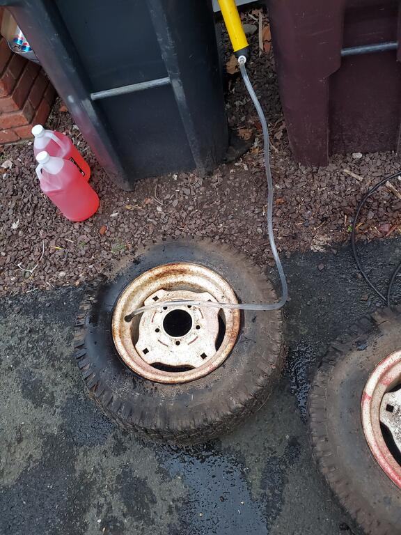

Jhook 849 #7979 Posted November 28, 2020 Loading the rear tires now for the charger👍 1 1 Share this post Link to post Share on other sites

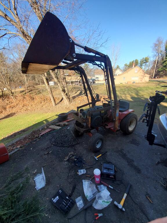

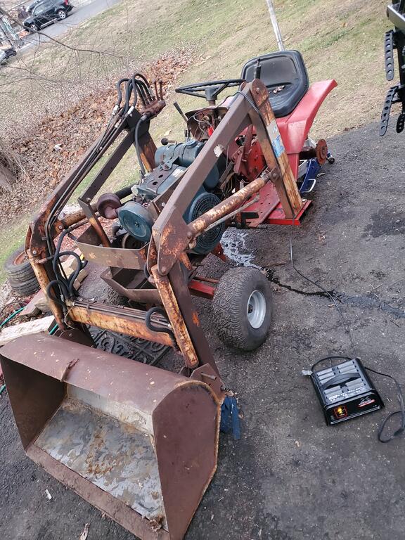

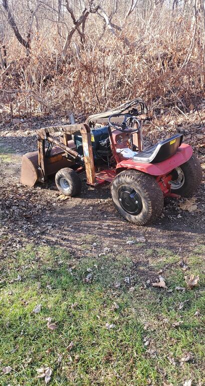

Jhook 849 #7989 Posted November 29, 2020 Trans passes the test i believe, pulled it up against a tree after warm up and it spun the tire with me on it, liquid ballast, and a 50 pound wheel weight. The parking brake shaft is ziptied in the down position until i get the opportunity to split the trans. But i cant have this thing in the driveway and just let it sit. I had to have some fun with it so played around for about 30 mins today in the yard, mainly testing the loader out. It has all new pins now which are nice and tight but it appears that im going to need a new hydraulic pump. I have been looking at a "2.9gpm/2000 rpm(rated)-5.2gpm/3600 rpm(max)" pump. Other than that i see some lines blowing in the near future and the subframe is on the to do list as well. Happy with the machine and still should be under 1700 bucks all said and done. The kohler k301s seems to run good and has nice clean oil in it. I like the old engine just as much as the CH15S in my 2007! 20201129_162336.mp4 2 2 Share this post Link to post Share on other sites

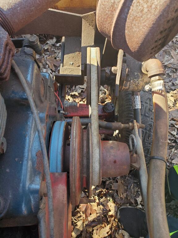

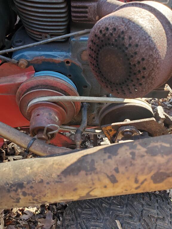

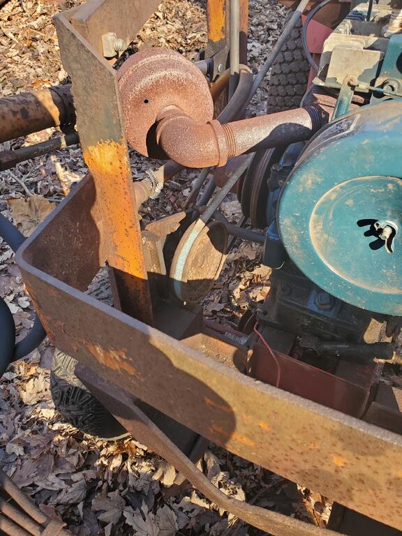

ebinmaine 80,855 #7990 Posted November 29, 2020 4 minutes ago, Jhook said: new hydraulic pump Where is the pump? Separate from the transmission? Share this post Link to post Share on other sites
Jhook 849 #7991 Posted November 29, 2020 1 minute ago, ebinmaine said: Where is the pump? Separate from the transmission? The hydraulic pump for the loader. Its mounted to the loader frame amd driven by the engines pto 2 Share this post Link to post Share on other sites
ebinmaine 80,855 #7992 Posted November 29, 2020 1 minute ago, Jhook said: The hydraulic pump for the loader. Its mounted to the loader frame amd driven by the engines pto Ahh. Never seen one up close so I figured it was powered by the transmission fluid pump. Share this post Link to post Share on other sites

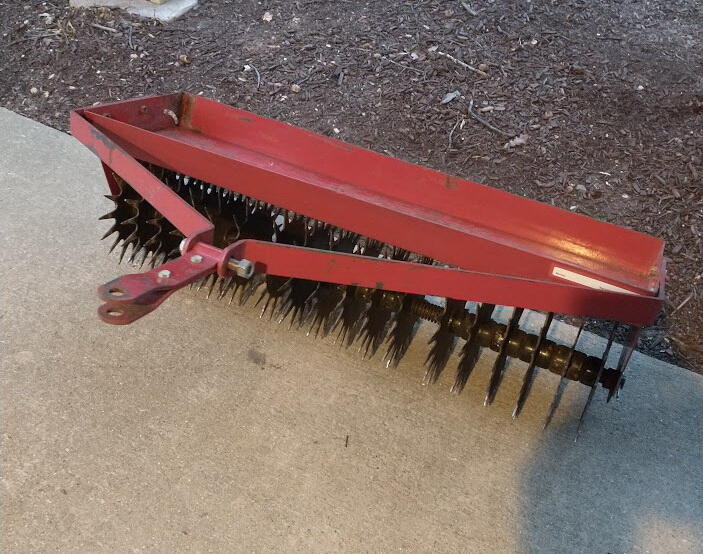

rmaynard 17,611 #7993 Posted November 29, 2020 I got a little attachment to pull around in the spring. 4 Share this post Link to post Share on other sites
Jhook 849 #7994 Posted November 29, 2020 7 minutes ago, ebinmaine said: Ahh. Never seen one up close so I figured it was powered by the transmission fluid pump. Heres the setup, note the welds are not mine and the fab work is not mine. Mine would look professional compared to this and im not too great honestly 1 Share this post Link to post Share on other sites

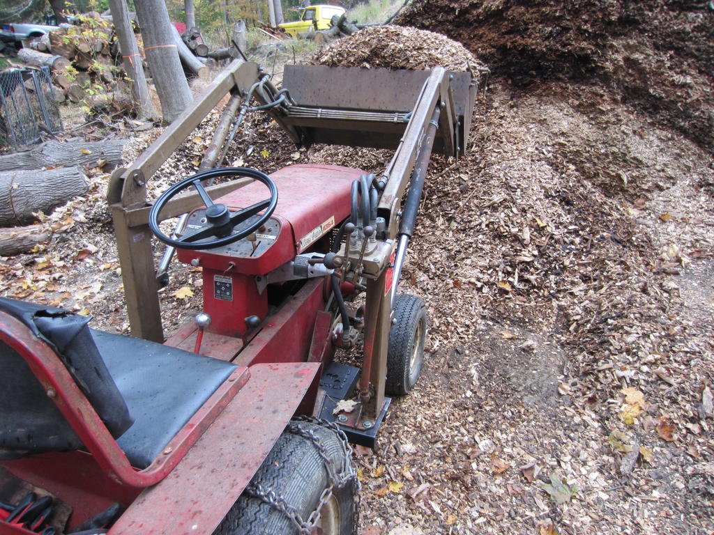

Herder 2,356 #7995 Posted November 29, 2020 6 minutes ago, ebinmaine said: Ahh. Never seen one up close so I figured it was powered by the transmission fluid pump. The pump on the 1054 is mounted in front of the right foot rest and is run off the PTO 2 Share this post Link to post Share on other sites
Jhook 849 #7996 Posted November 29, 2020 1 minute ago, Herder said: The pump on the 1054 is mounted in front of the right foot rest and is run off the PTO That looks wicked nice. I like the loader and the machine. Looks like the same johnson that i have? Just not nearly as used 2 1 Share this post Link to post Share on other sites
Tractorhead 9,217 #7997 Posted November 29, 2020 If it‘s not leaking, what is the reason for a new Pump? do you know the Lift Force how much it can lift? Normally on a Hydraulics is somewhere a filter in, mostly in return or the suction line. if that filter clogged, your hydraulic pump wasn‘t able to suck enough oil to lift the Load, if it‘s able to lift 200 pounds i see no need for a new Pump. To see what happen on the hydraulic Side, you can add an T with an Hydraulic pressure gauge on the intake line on the Valves. the oilflow just give you an indicator how fast your hydraulic can work, but not really how strong it is. Therefore lot‘s of hydraulic Valveblocks have a additional adjustable pressure restriction valve in parallel. If the hydraulic pressure exceeds the preinstalled value, a bypass opened and reduces the hydraulic pressure to the adjusted limit. 1 Share this post Link to post Share on other sites
Jhook 849 #7998 Posted November 29, 2020 4 minutes ago, Tractorhead said: If it‘s not leaking, what is the reason for a new Pump? do you know the Lift Force how much it can lift? Normally on a Hydraulics is somewhere a filter in, mostly in return or the suction line. if that filter clogged, your hydraulic pump wasn‘t able to suck enough oil to lift the Load, if it‘s able to lift 200 pounds i see no need for a new Pump. To see what happen on the hydraulic Side, you can add an T with an Hydraulic pressure gauge on the intake line on the Valves. the oilflow just give you an indicator how fast your hydraulic can work, but not really how strong it is. Therefore lot‘s of hydraulic Valveblocks have a additional adjustable pressure restriction valve in parallel. If the hydraulic pressure exceeds the preinstalled value, a bypass opened and reduces the hydraulic pressure to the adjusted limit. The pump leaked a few ounces of fluid on a short drive down the hill. The tire was completely covered and pump was dripping. Stopped and check fluid level, its over half full so that's fine. Didnt leak any more after that at all. Not sure why. Also the pump bracket is welded in crooked putting stress on the shaft. It is all wet around the shaft. Thoughts on this one? Share this post Link to post Share on other sites
ebinmaine 80,855 #7999 Posted November 29, 2020 7 minutes ago, Jhook said: Didnt leak any more after that at all. Not sure why Before you spend good money after bad, figure out where the actual problem is. If you remove the pump and garbage bracket you may be able to put a seal kit in it and remount the whole assembly. 2 Share this post Link to post Share on other sites
Jhook 849 #8000 Posted November 29, 2020 2 minutes ago, ebinmaine said: Before you spend good money after bad, figure out where the actual problem is. If you remove the pump and garbage bracket you may be able to put a seal kit in it and remount the whole assembly. The pump in it has a shaft smaller than 1/2 inch which is not up to par for the application. 1/2 inch or smaller shaft needs to be direct driven. It doesnt have the strength to handle the side-load that gets put on it when it's run by a belt. So even if i did re seal it, id have to take it off in a few hours anyways cause its not designed to be used this way. The pulley is welded crooked to the shaft also😂 i wish i got the machine as a basket case i could have assembled it much nicer 1 Share this post Link to post Share on other sites
