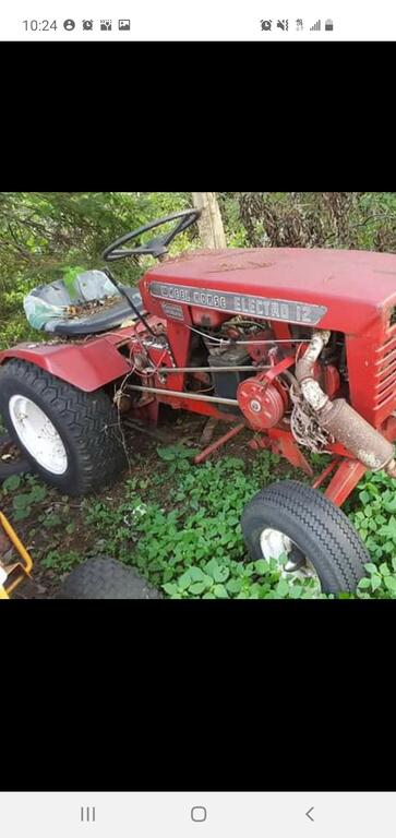

Jhook 849 #7936 Posted November 25, 2020 Found a "1970s electro 12" in my area. Same trans? Hes asking 400 for the whole machine, id pay 300 for it. Thatll get me spare rims and tires to run duals, spare front end parts for when i break mine from using the loader, and someone else will enjoy the engine and remaining parts for cheap money once i take what i need. Hopefully one of you knows if its the same as a 68 charger 12. 1 Share this post Link to post Share on other sites
pfrederi 21,214 #7937 Posted November 25, 2020 Yes it the electro tranny will fit. Do not use RTV the little bits that squeeze out inside get trapped in acceleration valve holes and other bad places. Wheel horse parts and more has the case gasket. You can get the hydro unit to transaxle case gasket from Toro. Share this post Link to post Share on other sites
pfrederi 21,214 #7938 Posted November 25, 2020 (edited) This thing you are looking at run??? Before you buy it start it drive it around let it get fully warmed up run it up against a tree/wall or something and she if she will dig holes with the rear wheels... I know you want to get moving but I would recommend you slow down take your time. Fixing 50 yr old machines is not an overnight project especially if the hydro needs work. Edited November 25, 2020 by pfrederi 1 1 Share this post Link to post Share on other sites
ebinmaine 80,855 #7939 Posted November 25, 2020 9 minutes ago, Jhook said: Found a "1970s electro 12" in my area. Same trans? Hes asking 400 for the whole machine, id pay 300 for it. Thatll get me spare rims and tires to run duals, spare front end parts for when i break mine from using the loader, and someone else will enjoy the engine and remaining parts for cheap money once i take what i need. Hopefully one of you knows if its the same as a 68 charger 12. That's either a 68 or 69 Electro. Not a 70 anything. I'd have to agree with Paul on both slowing down and taking your time and also, I would not buy that Electro for any more than about $200 if you can't run and drive it for a MINIMUM of 15 or 20 minutes. It takes a bit to get up to temperature and the transmission MUST BE TESTED HOT, NOT COLD. Share this post Link to post Share on other sites
Pullstart 71,350 #7940 Posted November 25, 2020 That electric clutch is worth some good coin though, FYI. Share this post Link to post Share on other sites
Jhook 849 #7941 Posted November 25, 2020 2 minutes ago, pfrederi said: This thing you are looking at run??? Before you buy it start it drive it around let it get fully warmed up run it up against a tree/wall or something and she if she will dig holes with the rear wheels... I know you want to get moving but I would recommend you slow drown take your time. Fixing 50 yr old machines is not an overnight project especially if eh hydro needs work. Said it needs a coil and will fire right up, i dont even know if these use regular coils or points system or whatever, im not that experienced with older engines. But i would jack it up and listen for noises. Im thinking it would be very nice to have 2 trannys since i will be keeping the machine for a long time. In the case i open mine up and its grenaded inside and full of metal i will have the chance at better trans. I would plan to open both of them up and fix them properly and keep as extra. I would also have a full set of wheel and tires, a spare front axle with spindles and be able to help someone else out that needs a engine, hood, frame, steering wheel, seat, fenders etc. 300 bucks wont set me back on anything that is not a huge financial setback at all right now. What do you think of it? Share this post Link to post Share on other sites
pfrederi 21,214 #7942 Posted November 25, 2020 (edited) If it is a battery ignition and all it needs is a coil that isn't a pricey fix. (Which makes me wonder why he didn't do it woudl get a lot more money for a running tractor) However many Electros came with breakerless ignition system their coil (and related trigger) are much pricier. (But can be converted with some cost and effort to a battery type.) Not running $200 ... Edited November 25, 2020 by pfrederi Share this post Link to post Share on other sites
ebinmaine 80,855 #7943 Posted November 25, 2020 Just now, pfrederi said: Not running $200 . IIFF <<<<<. The transmission is good that's worth some.. IIFF <<<<<. The electric clutch is good that's worth some. IIFF <<<<<. The engine is good that's worth some. If NONE of those are any good then it would be tough to recapture $300. These are tough old machines and it is PROBABLY worth the Gamble.... But it is just that. 1 Share this post Link to post Share on other sites

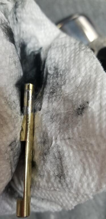

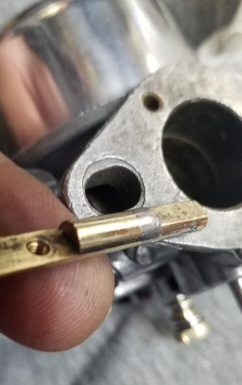

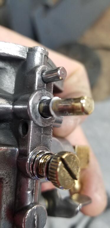

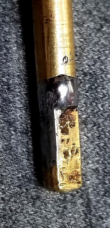

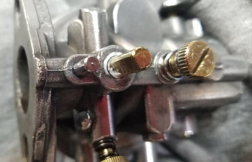

AMC RULES 37,260 #7944 Posted November 25, 2020 Kohler K90's leaky throttle valve was soldered, then filed to fit it's bore here today. 6 2 Share this post Link to post Share on other sites

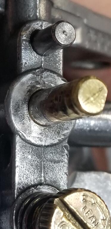

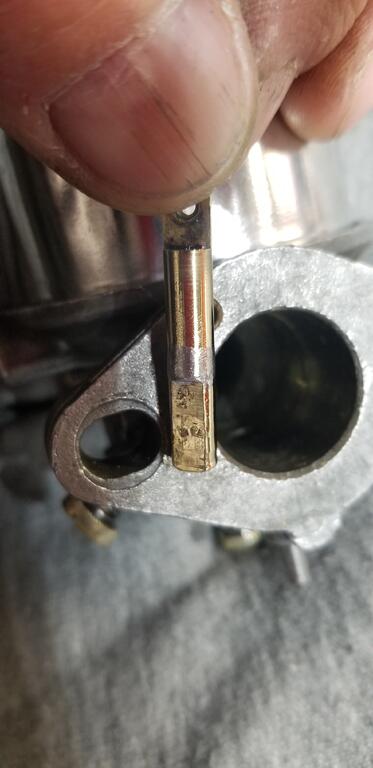

AMC RULES 37,260 #7945 Posted November 25, 2020 To smooth it's operation, finished by polishing in the bore. 2 Share this post Link to post Share on other sites

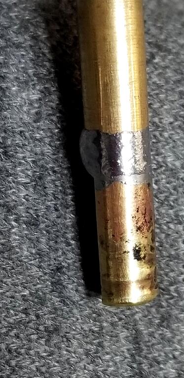

AMC RULES 37,260 #7946 Posted November 25, 2020 No slop in it's operation now! 3 Share this post Link to post Share on other sites
cafoose 3,876 #7947 Posted November 25, 2020 13 minutes ago, AMC RULES said: No slop in it's operation now! Wouldn't the solder wear rather quickly and be right back to where you started from? 2 Share this post Link to post Share on other sites
AMC RULES 37,260 #7948 Posted November 25, 2020 I don't have the means here to ream this carb body out for a new bushing successfully, so it appears we are going to find out. 1 Share this post Link to post Share on other sites
Shynon 7,722 #7949 Posted November 25, 2020 Just now, AMC RULES said: I don't have the means here to ream this carb body out for a new bushing successfully, so it appears we are going to find out. Send it to me if it doesn't work out. I can fix that. 2 Share this post Link to post Share on other sites
8ntruck 9,328 #7950 Posted November 25, 2020 2 hours ago, cafoose said: Wouldn't the solder wear rather quickly and be right back to where you started from? Depends on the kind of solder used. 60/40, will probably wear quickly. A higher temperature silver solder would be more durable. 2 1 Share this post Link to post Share on other sites
