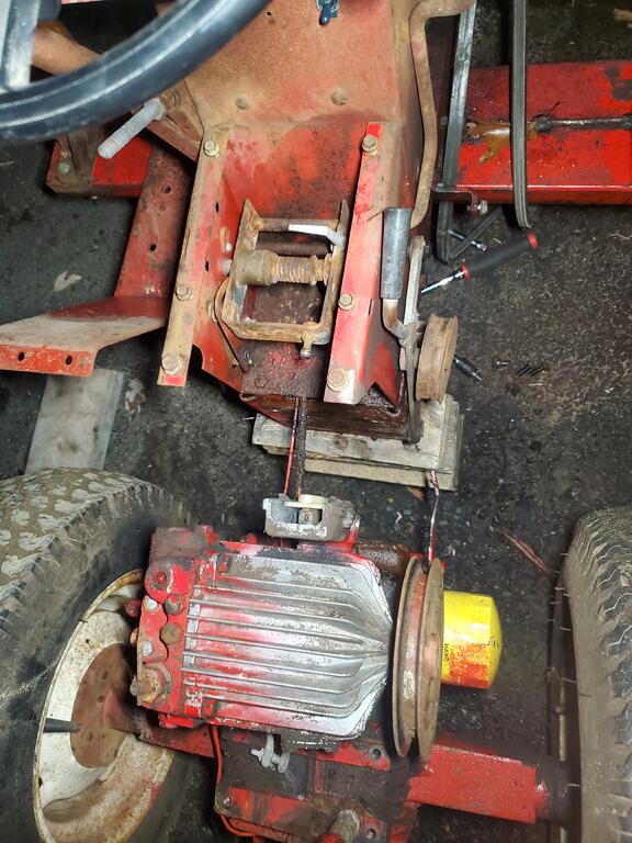

Jhook 849 #7876 Posted November 24, 2020 Update. Belt engagement lever removed and out of the way. Trans is unbolted and ready to be rolled out. Just debating now whether i want to go back outside and spend another 15 mins in the cold and dark and get it completely removed tonight, or wait til another day. Also the 1969 trailblazer 5 snow blower is sold and being picked up tomorrow evening. And the snow cab i think is being sold friday. I stop in the middle of a few projects to buy this loader and am thinking i can live without a cab on the 315 this winter. The 500 bucks from the sale of those 2 items will go half to the bank and half towards steel and hydraulic hoses to get loader subframe built and functioning properly. Share this post Link to post Share on other sites

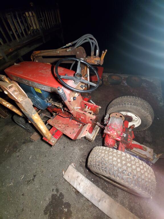

Jhook 849 #7881 Posted November 24, 2020 Its been a productive night. I pulled the fenders/seatpan/toolbox off the charger. Jacked it up and set it on blocks, then unbolted the trans and rolled it right out. Looks like the motion control seal is the only leak!! Easy first tranny pull on a horse. Not as bad as i thought👍 is there anything else you guys would recommend doing while the trans is out? Keep in mind i can not move the tractor at all til its re installed. Its in my driveway(shop) til i finish this seal. 1 2 Share this post Link to post Share on other sites
Pullstart 71,350 #7882 Posted November 24, 2020 @Jhook Something else to do? WIX 51410 filter and fluid change 1 Share this post Link to post Share on other sites
Jhook 849 #7883 Posted November 24, 2020 13 minutes ago, pullstart said: @Jhook Something else to do? WIX 51410 filter and fluid change Good thinking, i honestly was going to do that before operating it, but if you hadnt reminded me i wouldn't have remembered til after it was reinstalled. Might be a little easier while it's spaced away from the tractor. Will pick up a filter tomorrow. I have 3 gallons of red atf fluid from tractorsupply. What store sells a wix 51410 filter? Share this post Link to post Share on other sites
Pullstart 71,350 #7884 Posted November 24, 2020 My local parts plus does. NAPA might as well. 1 Share this post Link to post Share on other sites

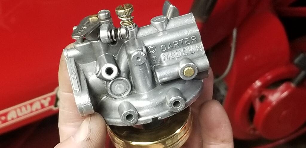

Horse Newbie 7,405 #7885 Posted November 24, 2020 10 hours ago, AMC RULES said: Carter model N resto... ...except for the seals, used most of the original hardware, didn't put a kit in it. How did you get it so clean...ultrasonic cleaner ? Share this post Link to post Share on other sites

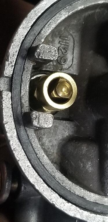

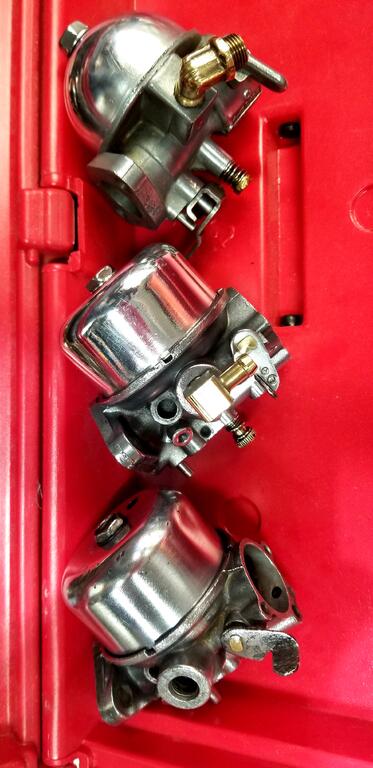

AMC RULES 37,260 #7890 Posted November 24, 2020 Another from the pile. 3 Share this post Link to post Share on other sites
pfrederi 21,214 #7891 Posted November 24, 2020 14 hours ago, Jhook said: Its been a productive night. I pulled the fenders/seatpan/toolbox off the charger. Jacked it up and set it on blocks, then unbolted the trans and rolled it right out. Looks like the motion control seal is the only leak!! Easy first tranny pull on a horse. Not as bad as i thought👍 is there anything else you guys would recommend doing while the trans is out? Keep in mind i can not move the tractor at all til its re installed. Its in my driveway(shop) til i finish this seal. You will want to make up a coiple aligning pins, makes reinstall much less stressful 2 Share this post Link to post Share on other sites

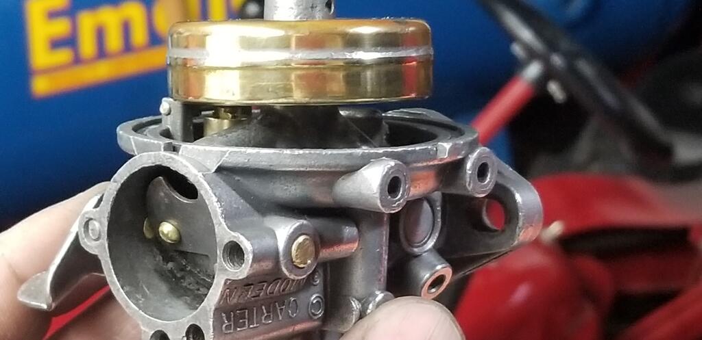

AMC RULES 37,260 #7893 Posted November 24, 2020 1 1 Share this post Link to post Share on other sites
WHNJ701 4,173 #7894 Posted November 24, 2020 7 hours ago, AMC RULES said: Another from the pile. That's the way to do it. A little effort on an original carb beats a 9 dollar ebay one. Any chance I see original carbs cheap I buy them. Needless to say I have a pile too that needs rebuilding, makes good winter projects 1 1 Share this post Link to post Share on other sites
Jhook 849 #7895 Posted November 24, 2020 6 hours ago, pfrederi said: You will want to make up a coiple aligning pins, makes reinstall much less stressful Oh man i meant to grab a couple from work today and forgot. Oh well at least i can get the seals done tonight Share this post Link to post Share on other sites

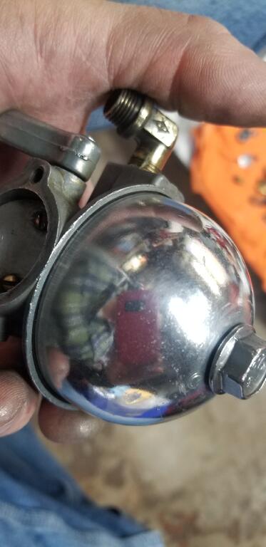

AMC RULES 37,260 #7897 Posted November 24, 2020 Had a productive day here today. 4 Share this post Link to post Share on other sites

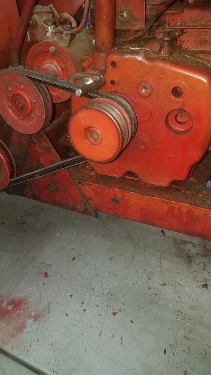

ccs002 81 #7898 Posted November 24, 2020 Made a couple belt guides for my suburban so I can shift without shutting the motor off. 1 3 1 Share this post Link to post Share on other sites
WHNJ701 4,173 #7899 Posted November 24, 2020 Thought that carb looked familiar 1 Share this post Link to post Share on other sites
