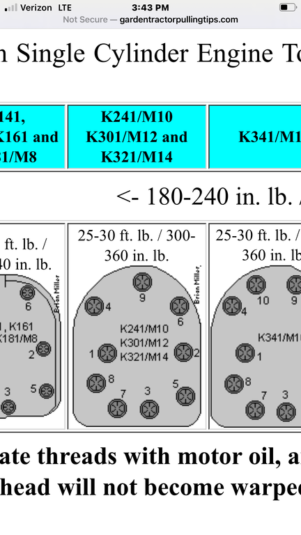

pfrederi 21,314 #7502 Posted November 7, 2020 2 hours ago, KrazeyOlDave said: What is the torque specs for the head bolts? I have to do mine soon. Download the K series manual from the manual section here. There is a specific tightening pattern. 2 1 Share this post Link to post Share on other sites

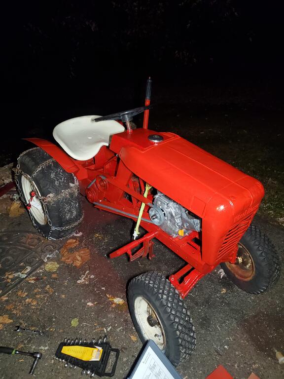

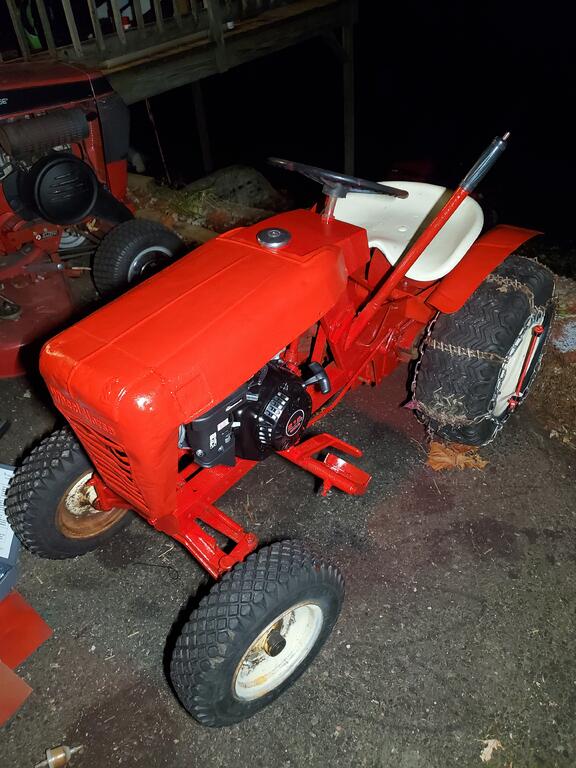

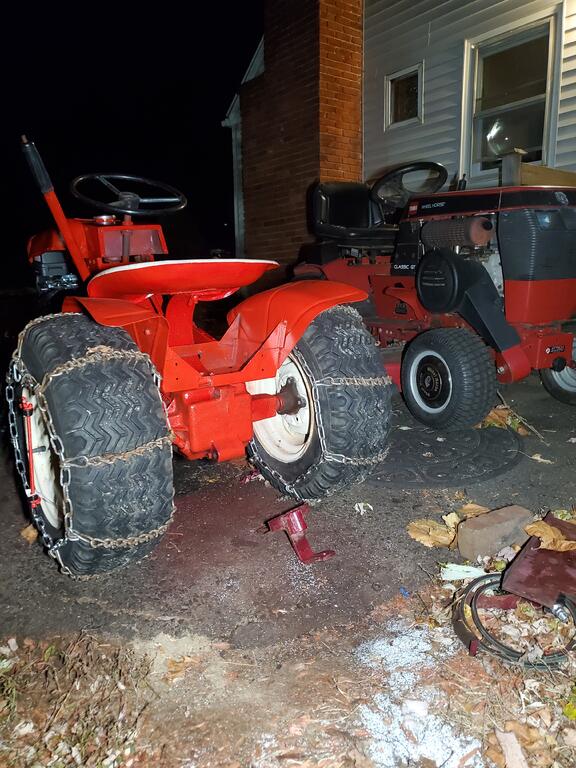

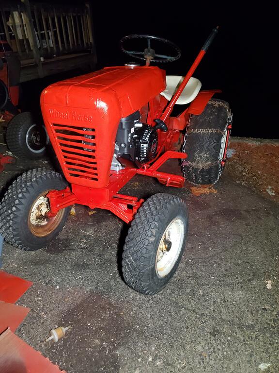

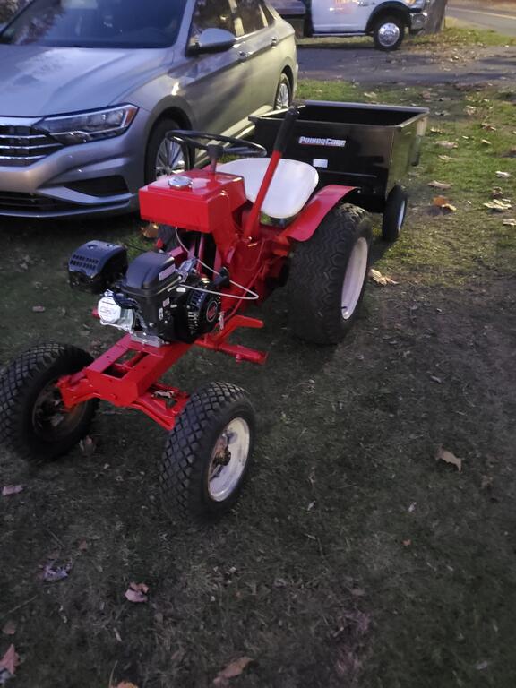

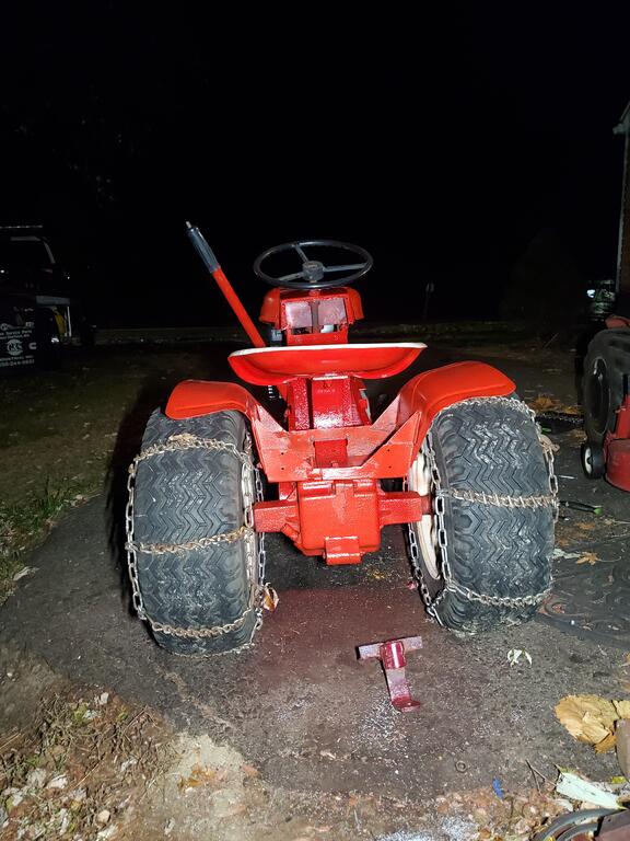

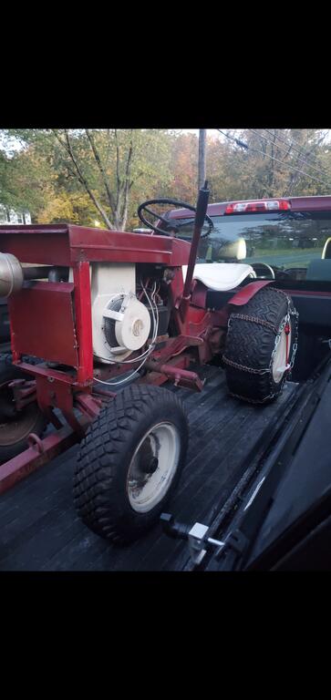

Jhook 849 #7503 Posted November 8, 2020 Well this project is coming to an end. I got this tractor just 20 days ago, its came a long ways from the day i got it. Is now fully functional and will be used as a cruiser/tow rig for the yard cart. Got some sweet hood decals coming from redoyourhorse along with a big 12x12 horse logo for my tow truck. This has a been a fun little project, and will last a number of years amd eventually be given a full proper restoration. But for now with only my driveway available as a workshop, this will have to do. Im happy with horse #2 8 4 Share this post Link to post Share on other sites

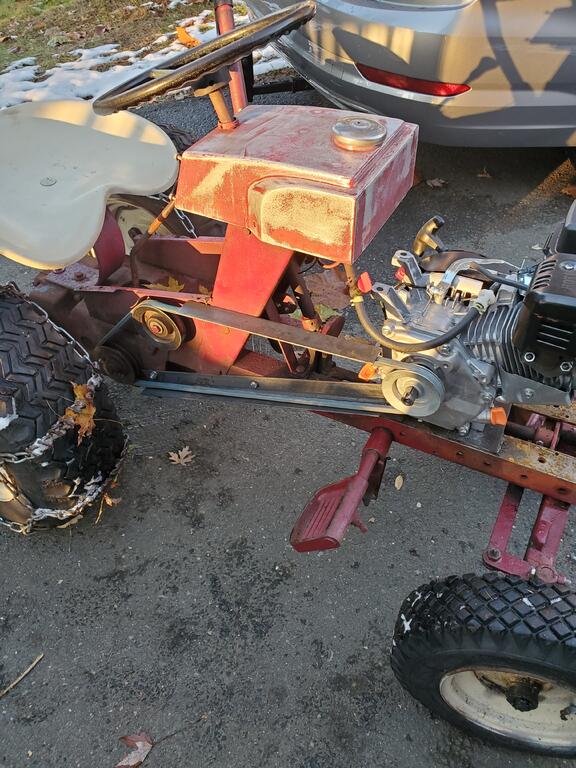

WHNJ701 4,173 #7504 Posted November 8, 2020 Looks nice, just curious no issues with belt? Not having the guard on it? Share this post Link to post Share on other sites
Tractorhead 9,218 #7505 Posted November 8, 2020 1 minute ago, jabelman said: Looks nice, just curious no issues with belt? Not having the guard on it? I see a upper and lower Rail instead of the Guard on the Picts, so i think he wouldn‘t have a problem. Share this post Link to post Share on other sites
Jhook 849 #7506 Posted November 8, 2020 (edited) 55 minutes ago, jabelman said: Looks nice, just curious no issues with belt? Not having the guard on it? Thanks, and The guard is not necessary with the 2 pieces of angle i added. With a completely different engine and pulley size a factory belt guard wont work, nor did it come with one. I am going to get one or put the one it came with over the belt as a cover to hide everything. Edited November 8, 2020 by Jhook 1 1 Share this post Link to post Share on other sites

ebinmaine 81,171 #7509 Posted November 8, 2020 8 hours ago, Jhook said: Thanks, and The guard is not necessary with the 2 pieces of angle i added. With a completely different engine and pulley size a factory belt guard wont work, nor did it come with one. I am going to get one or put the one it came with over the belt as a cover to hide everything. Nice work on that tractor. Quite a transformation. For a belt guard you could use a hunk of sheet metal cut to fit. Share this post Link to post Share on other sites
Herder 2,356 #7510 Posted November 8, 2020 15 hours ago, KrazeyOlDave said: What is the torque specs for the head bolts? I have to do mine soon. 25 to 30 ft. pounds. There's manuals here for k and mag series engines, the torque sequence is one of the most important steps. When completed, run the engine up to temp and let it completely cool down and retorque the head bolts, finish reassembly. 1 Share this post Link to post Share on other sites

KrazeyOlDave 860 #7512 Posted November 8, 2020 4 hours ago, Herder said: 25 to 30 ft. pounds. There's manuals here for k and mag series engines, the torque sequence is one of the most important steps. When completed, run the engine up to temp and let it completely cool down and retorque the head bolts, finish reassembly. Thank you, late last night as I was getting crossed eyed from searching, I found this. Share this post Link to post Share on other sites

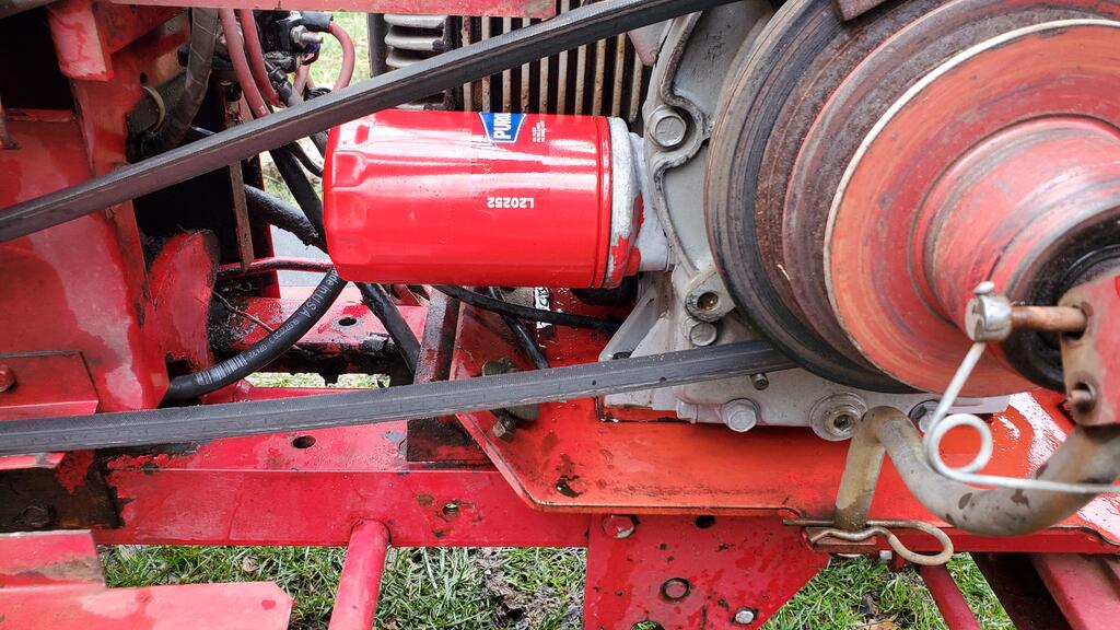

bds1984 1,519 #7514 Posted November 8, 2020 Today's job was installing an oil filter plate from an M18 onto my C175. I'm loving the Series II on it. Now if only the oak trees will stop dropping leaves... 6 Share this post Link to post Share on other sites
pfrederi 21,314 #7515 Posted November 8, 2020 8 minutes ago, bds1984 said: Today's job was installing an oil filter plate from an M18 onto my C175. I'm loving the Series II on it. Now if only the oak trees will stop dropping leaves... Did you have to replace the engine end plate?? How did the filter base mount? 1 Share this post Link to post Share on other sites
19richie66 17,950 #7516 Posted November 8, 2020 (edited) 25 minutes ago, pfrederi said: Did you have to replace the engine end plate?? How did the filter base mount? The oil filter adapter just replaces the flat block off plate that is there. Picture is from magnum service manual. Series 2 17 horse supposedly has the plates although I have read where some don’t. I would also get rid of the shaker plate and install the engine to a regular plate like on a 418 or 417. Give you a little more area below the filter for removal. Edited November 8, 2020 by 19richie66 3 1 Share this post Link to post Share on other sites
Jhook 849 #7517 Posted November 8, 2020 11 hours ago, ebinmaine said: Nice work on that tractor. Quite a transformation. For a belt guard you could use a hunk of sheet metal cut to fit. Thank you, i have the home made cover that came with it. Might fit that to it. Used it all day today and worked great 1 Share this post Link to post Share on other sites

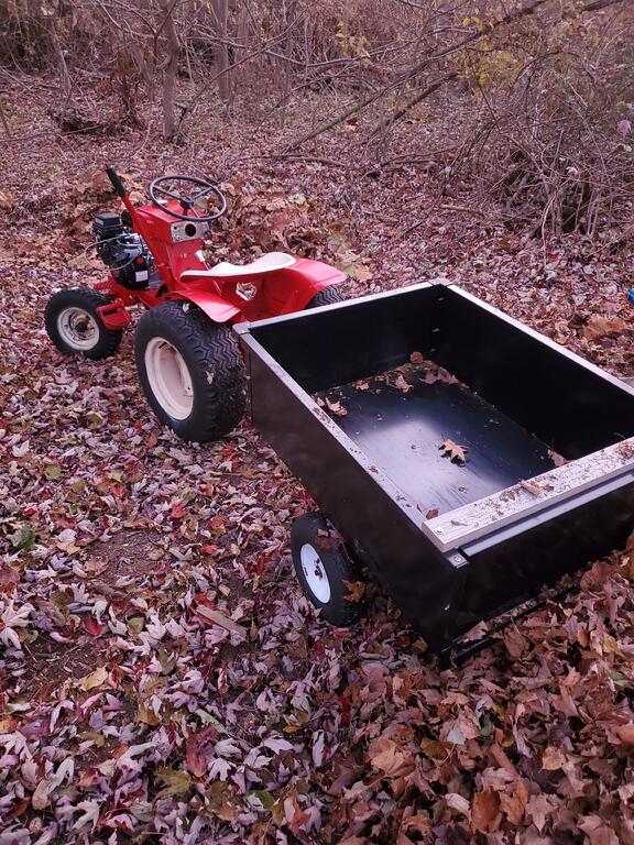

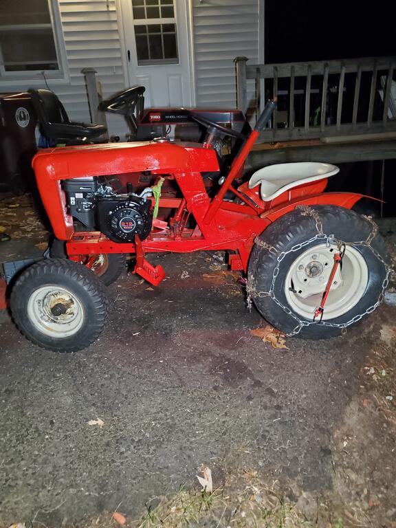

Jhook 849 #7518 Posted November 8, 2020 Let the paint cure overnight then straight to work with this one. Working great so far for towing leaves up and down the hill. Plenty of power from this little 100 dollar 212cc engine. I love it. Very happy but no hood yet cause i need hardware and only stock metric bolts, havent tried to see what size the threads are yet. 7 Share this post Link to post Share on other sites

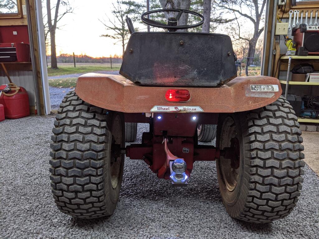

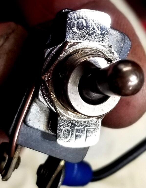

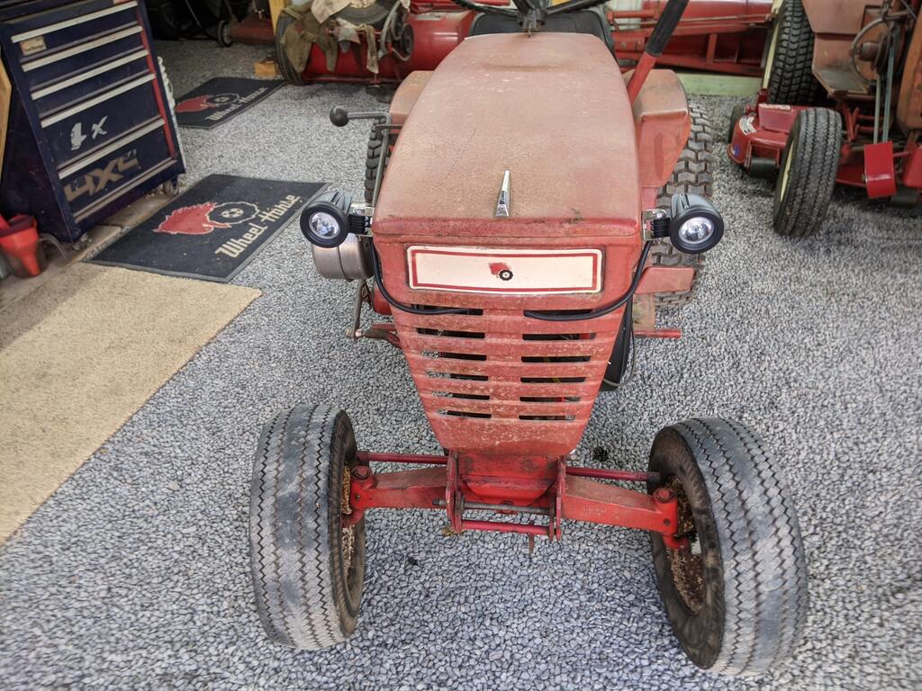

rjg854 13,423 #7521 Posted November 8, 2020 Worked on 2 of the tractors today. 16 Auto Had to swap out the fuel pump because it was leaking gas. Pretty simple job, checked it over, because it won't be long before I hook up the tall chute blower. Raider 12 Time to get lights working. Installed eye ball lights on the front end Then added a set of back up lights and got the taillight working, still need to get a bulb, but it all works nicely 2 3 1 Share this post Link to post Share on other sites

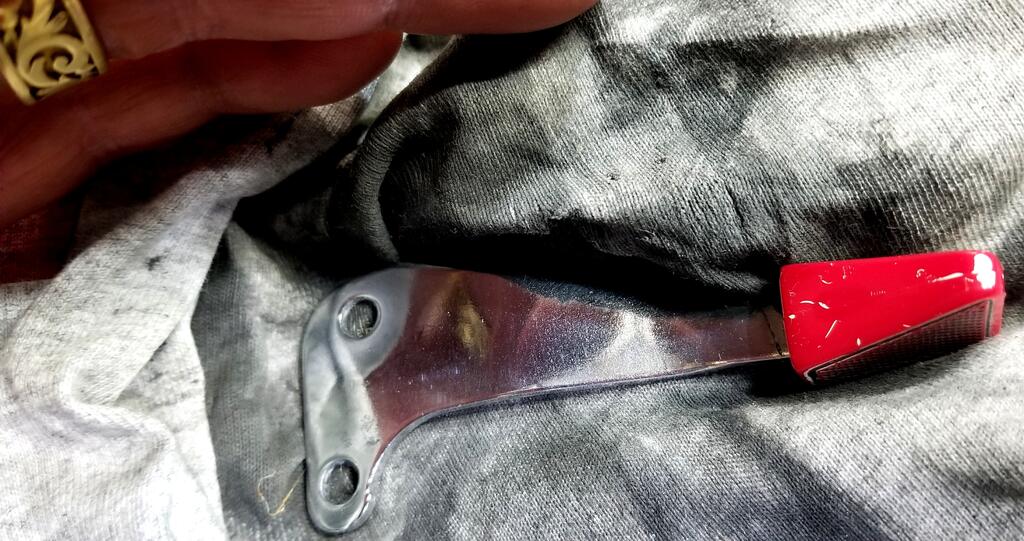

AMC RULES 37,260 #7522 Posted November 9, 2020 More tedious original equipment restoration work today. 3 Share this post Link to post Share on other sites
c-series don 12,657 #7523 Posted November 9, 2020 It’s all in the details Craig! 3 Share this post Link to post Share on other sites
