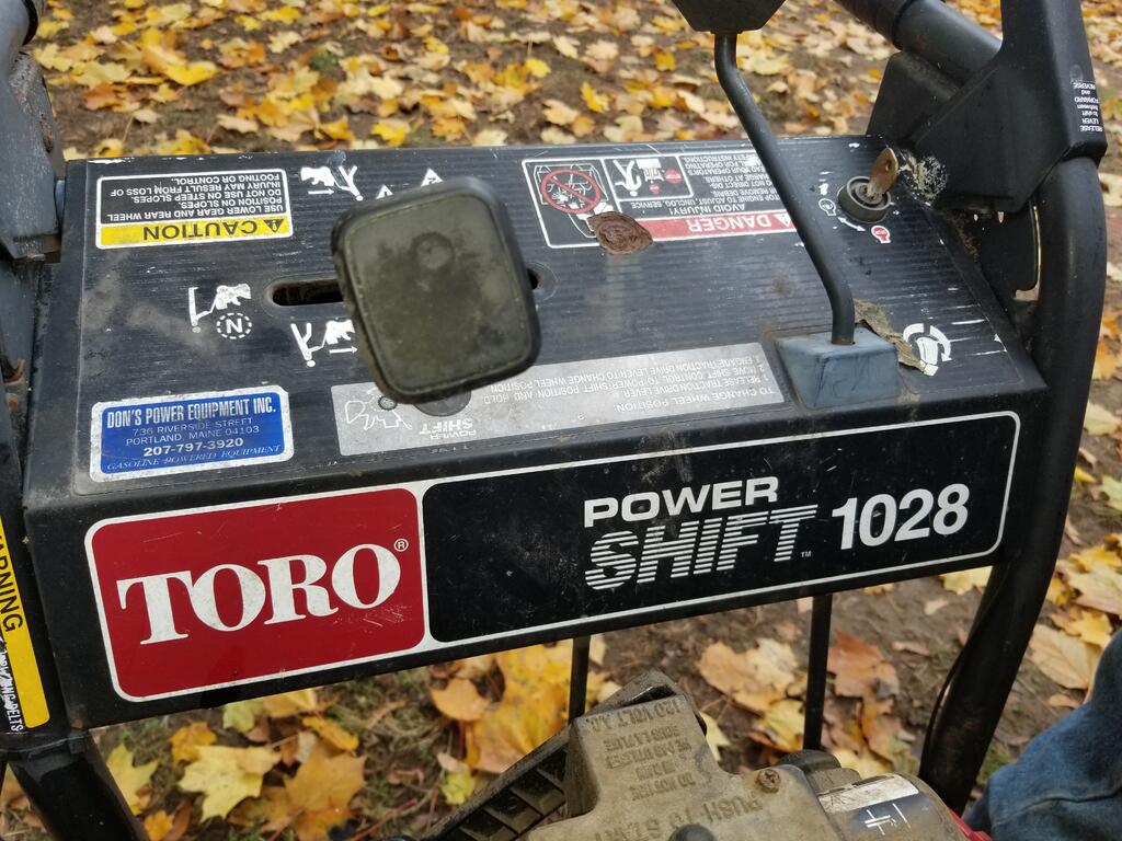

OldWorkHorse 3,156 #7380 Posted October 29, 2020 Picked up a small in between projects project... 4 Share this post Link to post Share on other sites
ebinmaine 79,792 #7381 Posted October 29, 2020 20 minutes ago, OldWorkHorse said: Picked up a small in between projects project... That's the perfect size right there. 1 Share this post Link to post Share on other sites

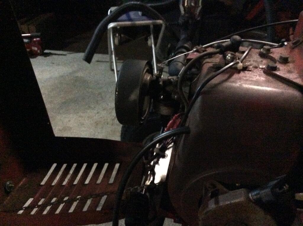

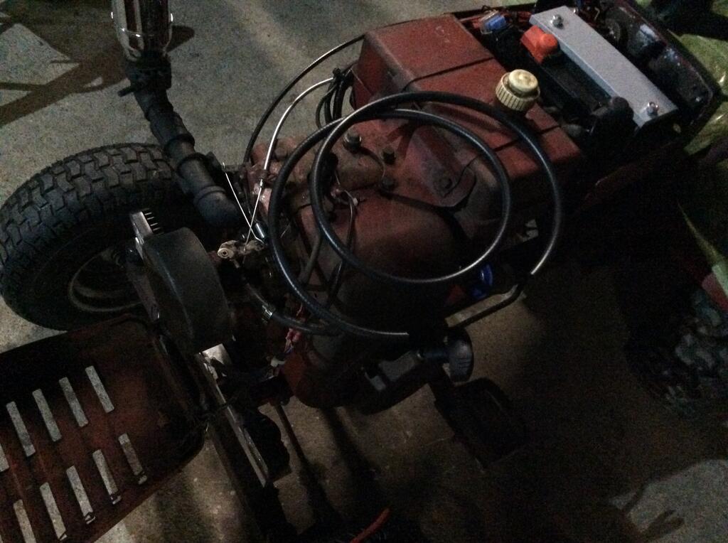

Tractorhead 9,217 #7382 Posted October 29, 2020 (edited) Fistly i smelled Fuel in the Shed and see while inspect few dribbs below the Horse. Know allready, that will happen, and after Today i was prepared. So i ordered allready a new Fuelline, but wait for changing because here is no longer plain Fuel available, so it was clear for me it is just a question of time, that i must change it, but i was prepared and change the Fuelline completely to a Bioethanol usable one.. Edited October 29, 2020 by Tractorhead 5 Share this post Link to post Share on other sites

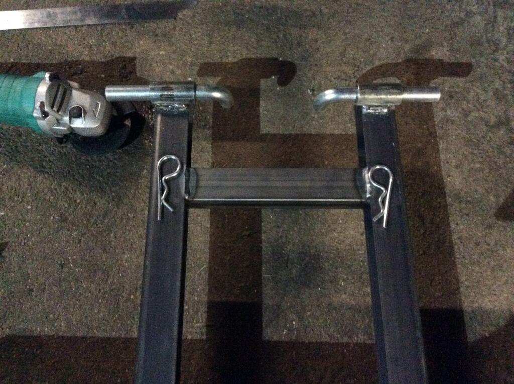

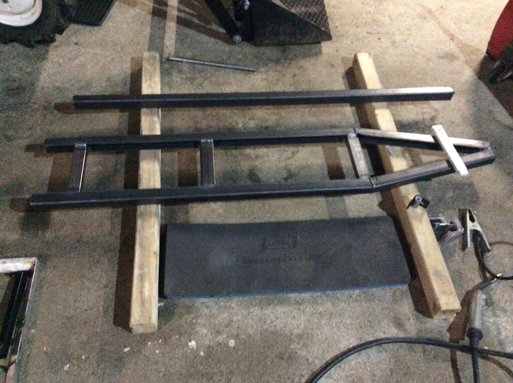

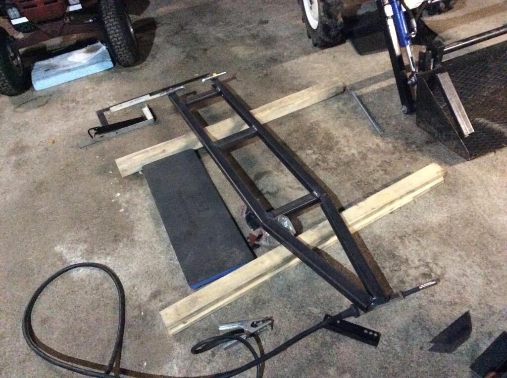

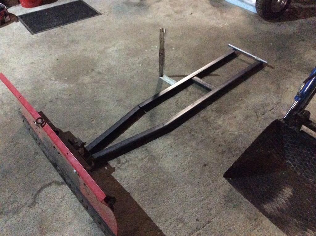

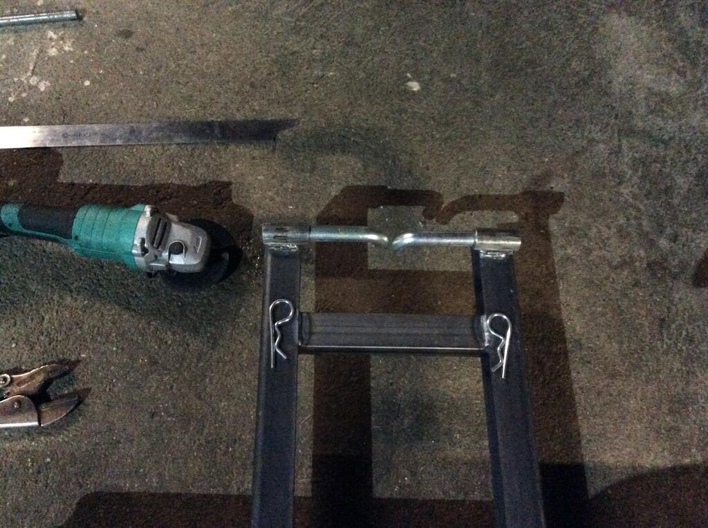

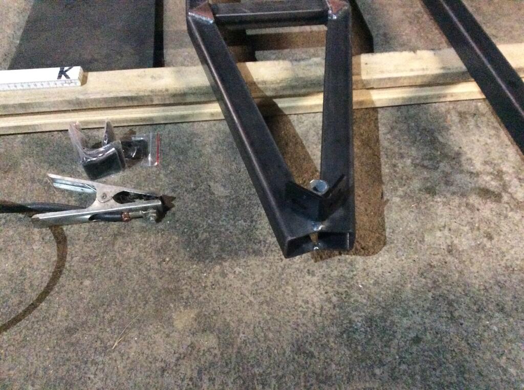

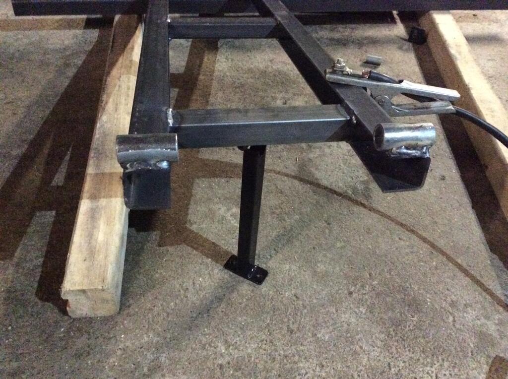

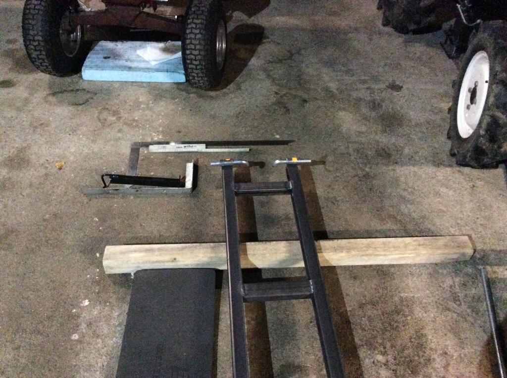

Tractorhead 9,217 #7383 Posted October 29, 2020 (edited) Dang, i‘m today the idiot quick klicker...😎 The scratch Plow Frame... after i changed the Fuelline, i start continoue with the new Plow Frame i built. The idea was clear, the prep was parently done, so i cutted today the rungs. after checking double if all seems to fit i started the Welder. while Welding things together, i have an idea, wow to solve a Quickmount. The Baseframe Welded and rechecked, if all aligning Well. Thinkering on the front swing, test if it will work. While i testing, i get finally the idea how i like to solve the „quickmount“ what was on the „open todo“ list. The solution is as simple as nice. 2x 3/4“ Bolts will be set in 2 pipes, that they can be quick slided in for mount or slide out to remove. A Clamp will fix them when mounted. The pipes welded on... how the system works... on the Axles two mounts will be screwed on they get two holes (one on the left and one on the right) Mount position Release position.. Edited October 29, 2020 by Tractorhead 9 1 Share this post Link to post Share on other sites

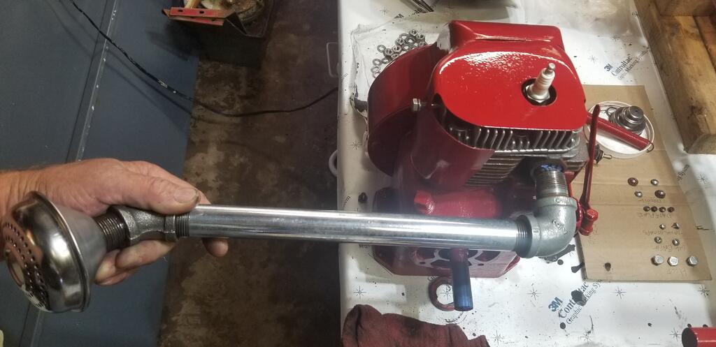

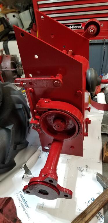

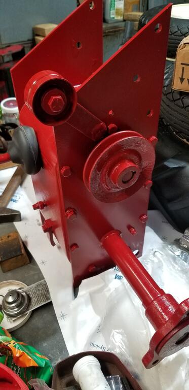

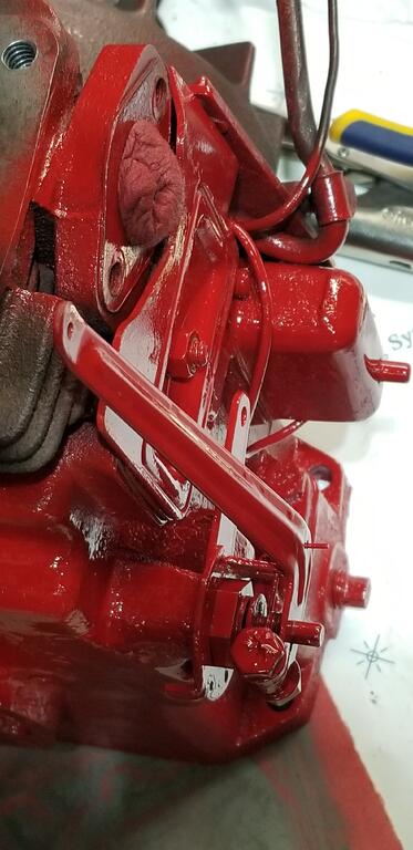

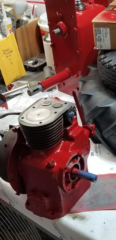

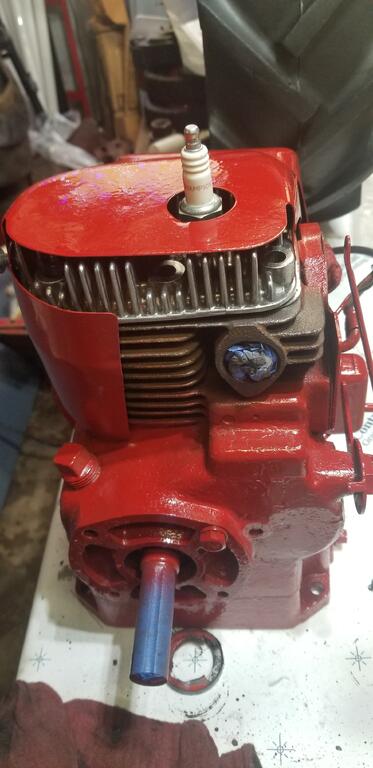

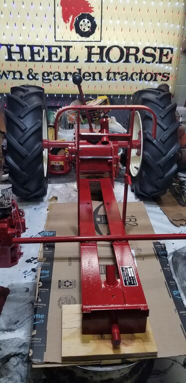

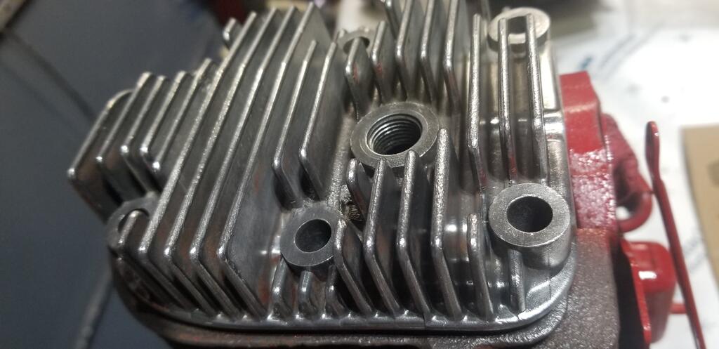

AMC RULES 37,259 #7393 Posted October 30, 2020 Certainly not perfect yet, but well on it's way here today. 2 1 Share this post Link to post Share on other sites
AMC RULES 37,259 #7394 Posted October 30, 2020 Yes it's far from finished, but I just had to see it now 5 3 Share this post Link to post Share on other sites
johnnymag3 2,647 #7395 Posted October 30, 2020 I heard through the grapevine you were going to do that exhaust in STAINLESS !!! Share this post Link to post Share on other sites
AMC RULES 37,259 #7396 Posted October 30, 2020 Madge doesn't call the shots here. 4 Share this post Link to post Share on other sites
johnnymag3 2,647 #7397 Posted October 30, 2020 It would be nice, dontcha think??? What a few extra bucks ? Share this post Link to post Share on other sites
lynnmor 8,930 #7398 Posted October 30, 2020 CHINA!!! Get that thing fired up to kill the viruses. 1 Share this post Link to post Share on other sites
AMC RULES 37,259 #7399 Posted October 30, 2020 The owner is cheap, and is happy with what I'm giving him... but, now if you guys want to chip in a full custom stainless exhaust for this thing, I'm sure he would greatly appreciate it! 3 1 2 Share this post Link to post Share on other sites
Ed Kennell 46,649 #7400 Posted October 30, 2020 2 hours ago, AMC RULES said: A real nut roaster with the muffler tween your legs. 1 1 2 Share this post Link to post Share on other sites
