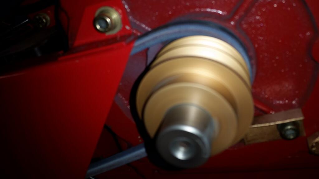

Pullstart 71,527 #7326 Posted October 28, 2020 Yeah we should be blue to get the belt to stop before moving to a clutch pulley 1 Share this post Link to post Share on other sites
ebinmaine 81,171 #7327 Posted October 28, 2020 23 minutes ago, Jhook said: top support was underneath the top loop of the belt Yepp. I did a pulley swap on a tractor that I'm not sure had the right belt guard in the first place. I riveted a "shelf" just under where the belt rode with the clutch OUT. When the pedal was pushed in the belt would sink to the lower lip of the guard as it should and also the shelf I put in. Worked slick. 2 1 Share this post Link to post Share on other sites
ebinmaine 81,171 #7328 Posted October 28, 2020 26 minutes ago, Jhook said: less than 1/2 throttle Notwithstanding start stop times an air-cooled engine Should be run at 3/4 or more especially when under load. Share this post Link to post Share on other sites

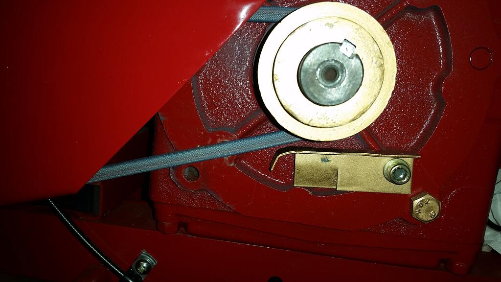

Jhook 849 #7329 Posted October 28, 2020 23 minutes ago, WHX24 said: Looks like you may have somewhat of a belt stop there now?? That is the little guard attached to the clutch pulley yes. Not sure its function other than keeping the belt in line. I sure doesnt stop the belt at all. Share this post Link to post Share on other sites
WHX?? 58,347 #7330 Posted October 28, 2020 (edited) The belt brake on a 1055, this is factory. Just throwing ideas at ya. Edited October 28, 2020 by WHX24 3 Share this post Link to post Share on other sites
WHX?? 58,347 #7331 Posted October 28, 2020 1 minute ago, Jhook said: I sure doesnt stop the belt at all. It does if positioned right ...it is supposed to shove the belt forward. 2 Share this post Link to post Share on other sites
Jhook 849 #7332 Posted October 28, 2020 3 minutes ago, ebinmaine said: Notwithstanding start stop times an air-cooled engine Should be run at 3/4 or more especially when under load. Yes i agree but a lot of times im just moving a machine a few feet. Pulling it in or out of the shed. No need to rev it up to 3,000 rpms for a short trip like that. When i am working them they stay at full throttle all the time no less. Regardless a centrifugal clutch is not for me. You guys have been a huge help im confident i can have it driving by the weekend! 2 2 Share this post Link to post Share on other sites
Jhook 849 #7333 Posted October 28, 2020 7 minutes ago, WHX24 said: It does if positioned right ...it is supposed to shove the belt forward. Ok. I had looked at that last night and couldnt figure out how itnwas supposed work, or if im even able to change the angle of it. Will look into tilting that forward as well Share this post Link to post Share on other sites
Ed Kennell 47,828 #7334 Posted October 28, 2020 29 minutes ago, WHX24 said: Looks like you may have somewhat of a belt stop there now?? Oh, to have good young eyes like Jimbo. Yes, that belt retainer/,stop should be rotated CW so it just clears the belt when the clutch is engaged. Then when it is disengaged, it will pinch the belt. The bottom loop must be supported especially close to the engine drive pulley. 5 Share this post Link to post Share on other sites
WHX?? 58,347 #7335 Posted October 28, 2020 Some of them were welded on to the clutch arm in a certain position some were just pinched under the bolt. 1 1 Share this post Link to post Share on other sites
Jhook 849 #7336 Posted October 28, 2020 9 minutes ago, Ed Kennell said: Oh, to have good young eyes like Jimbo. Yes, that belt retainer/,stop should be rotated CW so it just clears the belt when the clutch is engaged. Then when it is disengaged, it will pinch the belt. The bottom loop must be supported especially close to the engine drive pulley. Great thank you that helps a ton 1 Share this post Link to post Share on other sites

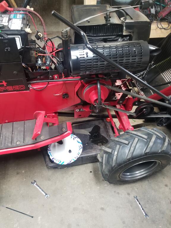

Greentored 3,221 #7337 Posted October 28, 2020 (edited) @Jhook I've played the belt and pulley game with two machines, invented my own vocabulary and threw half my tools across the shop before figuring it out. A small tab near the engine pulley and below the trans pulley can work, but belt length is EXTREMELY critical, and then when you're done you have a machine with no belt guard and although it looks cool, just aint the safest. These guys hit the nail on the head- something running along the outer edges of the belt, mainly the bottom half, and you should be good. While I'm here, as for 'what have you done to your Wheel Horse today?' Not as much as i'd like to, that dang thing called responsibility getting in the way lately. Its overrated I did, however, FINALLY get the little emulsion tube/rod freed up in the 655 carb so it idles and performs correctly. Cut the grass again yesterday. Still cant get over just how capable that puny little 6hp is. The more I run it, the more I love it. Dont think this one will be leaving the stables anytime soon. Is it a Kohler? Heck no, but really starting to believe the only thing that truly sucks about a Tekky is that stupid carb design. We battled that issue back in the day when racing karts- very few engine issues, tons of carb issues. Edited October 29, 2020 by Greentored 3 1 Share this post Link to post Share on other sites

peter lena 10,113 #7340 Posted October 28, 2020 you also obviously have the " v " side of the belt on the flat / side of the center pulley , think of a snow blower set up . pete Share this post Link to post Share on other sites
Jhook 849 #7341 Posted October 28, 2020 12 minutes ago, peter lena said: you also obviously have the " v " side of the belt on the flat / side of the center pulley , think of a snow blower set up . pete Yes i had just thrown the belt on. Played with it on both sides of the pulley. Another member suggested removing the idler all together which im going to do next. I wasn't sure that was the proper way to use that pulley but omly ran it for a few minutes like that 1 Share this post Link to post Share on other sites

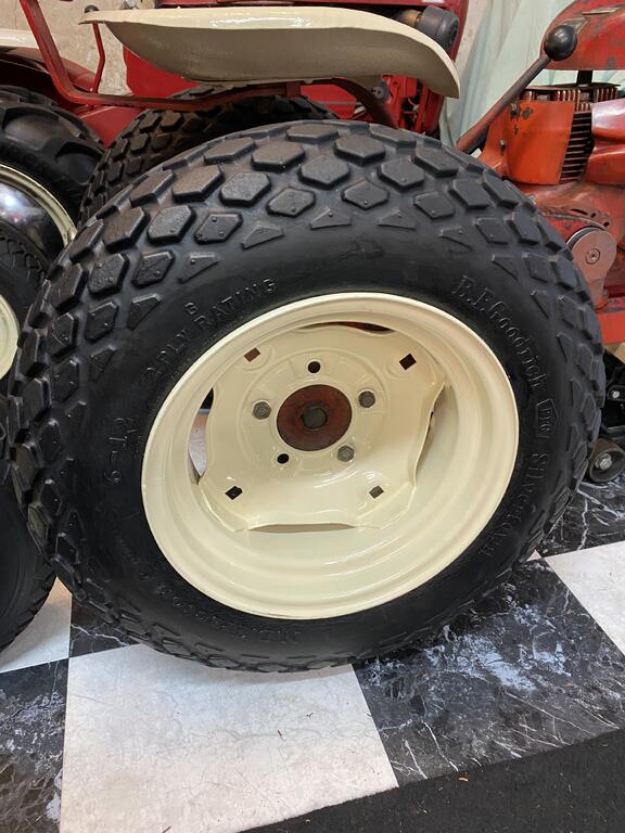

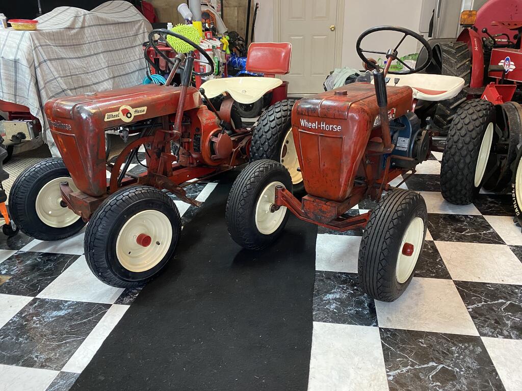

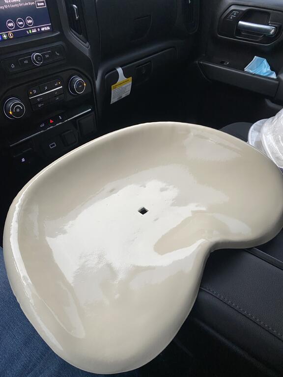

whtractors24 3,572 #7345 Posted October 28, 2020 Got the original silvertowns I cleaned up on my 400 , also put repop Firestones on the front .with some fresh powder coating on wheels and seat too ! Now they are closer to matching brothers . 3 1 Share this post Link to post Share on other sites

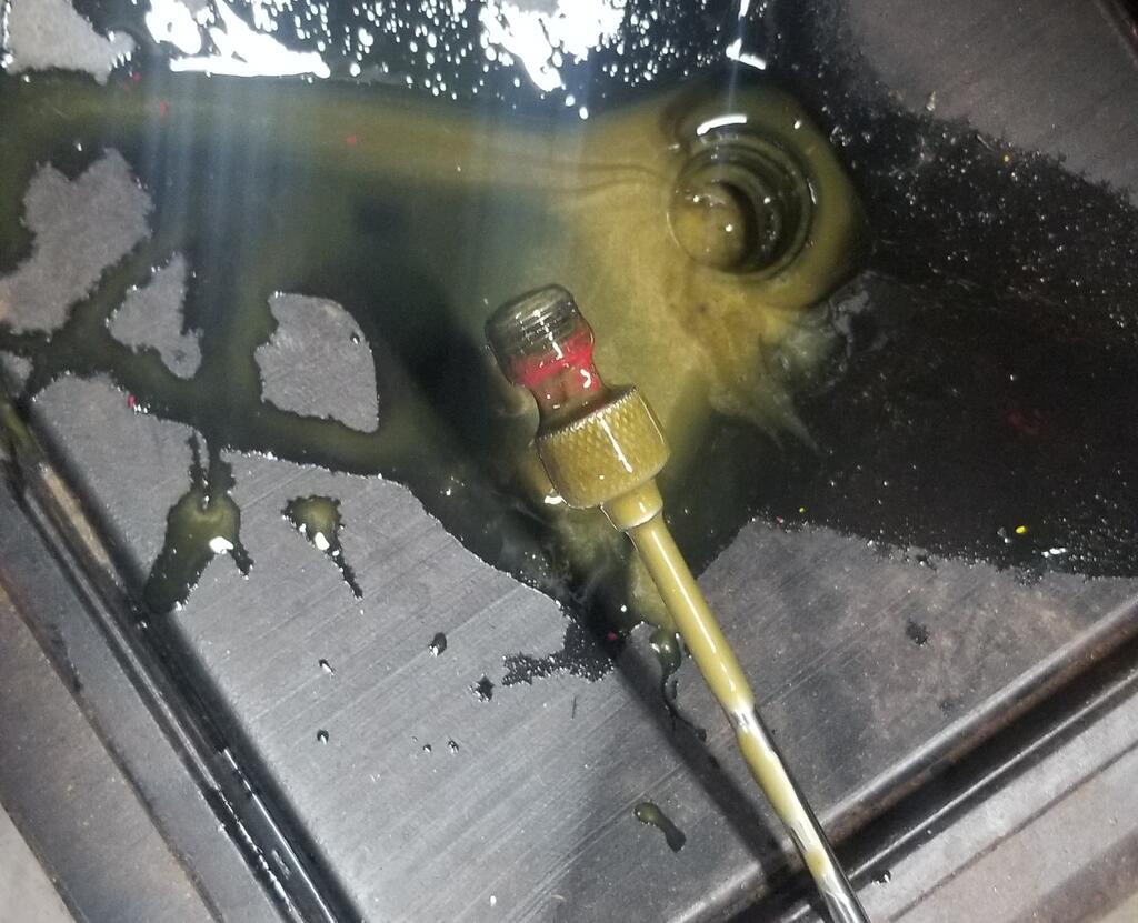

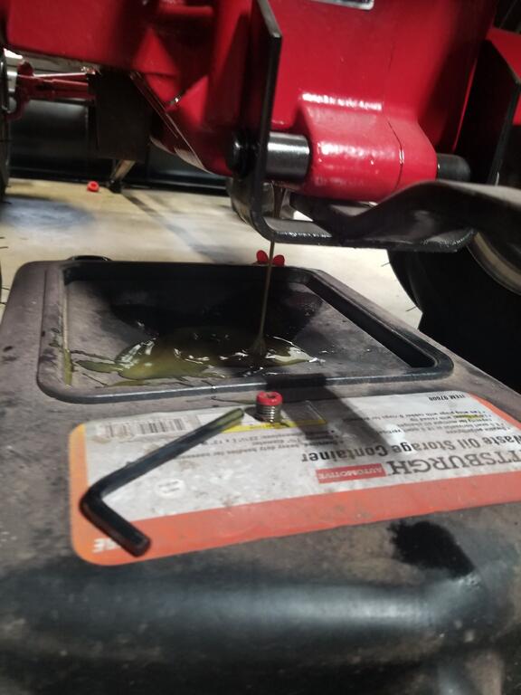

OldWorkHorse 3,156 #7350 Posted October 28, 2020 Changed the engine oil and the rear gear oil! (Also retrieved the rear end plug from the bottom of old engine, old gear oil, and who knows what....) and also finished running new wiring. 5 Share this post Link to post Share on other sites
