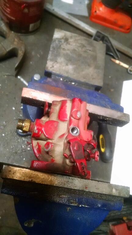

echris 1,426 #7201 Posted October 20, 2020 12 minutes ago, Achto said: The last time that I used my 701 it was acting up on me. It was acting like it was not getting enough gas. Tonight I removed the fuel line from the pump & turned the engine over, it shot gas about a foot to the side. This ruled out the pump, so on to carb. After dissembling the carb I noticed that I could not see through the hole in the main jet. First things first, I can not stand having paint on a carburetor. Pet peeve? OCD? Call it what you want, I don't like it. This carb had so much paint on it that I think a PO just dumped a can over the top of it and let it drip off of the bottom. To solve this issue & make my self happy, I grabbed some aircraft stripper to get rid of the paint. Please take note - Wear heavy rubber gloves and safety glasses when using this product. I left it soak for about 10 min and then gave it a light scrub with a steel brush. Rinsed it off with brake cleaner and repeated the process one more time. After 45min this is my end result. Clock ran out on me tonight so assembly will have to wait until tomorrow. When I saw your first pic in this post I said to myself, "Don't paint your carbs." And then I read the rest of your post. Nice! 2 1 2 Share this post Link to post Share on other sites

Pullstart 71,160 #7204 Posted October 20, 2020 9 hours ago, Achto said: The last time that I used my 701 it was acting up on me. It was acting like it was not getting enough gas. Tonight I removed the fuel line from the pump & turned the engine over, it shot gas about a foot to the side. This ruled out the pump, so on to carb. After dissembling the carb I noticed that I could not see through the hole in the main jet. First things first, I can not stand having paint on a carburetor. Pet peeve? OCD? Call it what you want, I don't like it. This carb had so much paint on it that I think a PO just dumped a can over the top of it and let it drip off of the bottom. To solve this issue & make my self happy, I grabbed some aircraft stripper to get rid of the paint. Please take note - Wear heavy rubber gloves and safety glasses when using this product. I left it soak for about 10 min and then gave it a light scrub with a steel brush. Rinsed it off with brake cleaner and repeated the process one more time. After 45min this is my end result. Clock ran out on me tonight so assembly will have to wait until tomorrow. looks great, but where does it put the aircraft when it removes it? 2 4 1 Share this post Link to post Share on other sites
Achto 32,513 #7205 Posted October 20, 2020 (edited) 36 minutes ago, pullstart said: but where does it put the aircraft when it removes it? I asked Mr. Owl and he was about as much help with this question as he was with the last one. I guess the world will never know. Edited October 20, 2020 by Achto 8 1 Share this post Link to post Share on other sites

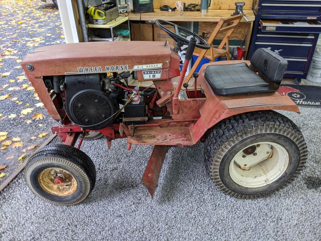

rjg854 13,330 #7209 Posted October 20, 2020 Finally finished going through the Raider 12 that I put the engine in. Flushed and filled the transmission Rebuilt the carb Rewired the tractor New fuel lines Transmission drive pulley and key Rear hub and key Repaired hood hinges Tightened the tie rods Battery I'll be using it this year as my plow tractor, I feel like it will work out well. I want to see if the transmission will make a difference in how it plows. 1 3 1 3 Share this post Link to post Share on other sites
ebinmaine 80,464 #7210 Posted October 20, 2020 17 minutes ago, rjg854 said: I want to see if the transmission will make a difference in how it plows. I can tell you from real world experience that it does. Trina's tractor is several hundred pounds lighter than mine and hers has less tendency to get stuck along with a very good ability to push snow given the size. Comparing apples to apples of equal weight and power the LSD transmission is clearly an advantage. 2 1 Share this post Link to post Share on other sites
rjg854 13,330 #7211 Posted October 20, 2020 Thanks Eric, that's good to know. Other than lights, I want to redneck some lift assist springs to make lifting that 48" plow easier on the arm 3 1 Share this post Link to post Share on other sites

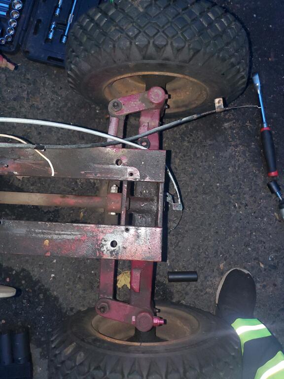

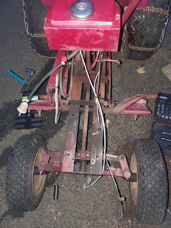

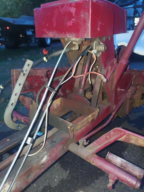

Jhook 849 #7212 Posted October 20, 2020 Had about 30 mins of daylight after work. Removed the home made plow off the frankenhorse. Removed the battery as i wont need at anymore, but its a December 2019 battery that came in the tractor so thats a score. Pulled the rear end fill cap and water poured out, no big deal i planned to flush it anyways. Will add a new shift boot as well. Working overnights the next 2 days along with my regular 8 hours during the day. So the tractor will sit soaking in simple green for the next 3 days til Saturday then i will pressure wash the whole machine and start sanding to prep for new paint. Not a terrible looking machine underneath all the hack work. Let me know what you guys think of it! 5 1 Share this post Link to post Share on other sites
953 nut 68,824 #7213 Posted October 20, 2020 1 hour ago, rjg854 said: I'll be using it this year as my plow tractor, I feel like it will work out well. I want to see if the transmission will make a difference in how it plows. Randy, I grew up in Central NY and unless the meteorological conditions have changed radically you won't get by with that blade! 1 1 5 Share this post Link to post Share on other sites
ebinmaine 80,464 #7214 Posted October 21, 2020 2 hours ago, rjg854 said: Thanks Eric, that's good to know. Other than lights, I want to redneck some lift assist springs to make lifting that 48" plow easier on the arm Lemme know how you do that. Methinks Trina would be interested and appreciative of lifting ease. Share this post Link to post Share on other sites

Achto 32,513 #7217 Posted October 21, 2020 I'm happy to report that my 701 runs much better after rebuilding the carb. I also discovered that the sediment bowl was plugged tighter than ( add your own analogy here ). Some may have decided to get rid of it but I decided to keep it for sedimental reasons. That and I had a kit laying around to rebuild it. New screen, bowl gasket & packing for the valve. I also added an in line filter for good measure. Engine now purrs like a kitten. 5 5 Share this post Link to post Share on other sites
ebinmaine 80,464 #7218 Posted October 21, 2020 6 hours ago, Achto said: sediment bowl was plugged ******. Some may have decided to get rid of it but I decided to keep it for sedimental reasons Glad to hear you got that "settled".... 1 Share this post Link to post Share on other sites

squonk 47,991 #7220 Posted October 21, 2020 (edited) 10 hours ago, rjg854 said: Thanks Eric, that's good to know. Other than lights, I want to redneck some lift assist springs to make lifting that 48" plow easier on the arm Me thinks I would get that dash tower (hood stand ) welded up before the snow flies! Edited October 21, 2020 by squonk 3 Share this post Link to post Share on other sites

Tractorhead 9,217 #7223 Posted October 21, 2020 20 hours ago, rjg854 said: Finally finished going through the Raider 12 that I put the engine in. Flushed and filled the transmission Rebuilt the carb Rewired the tractor New fuel lines Transmission drive pulley and key Rear hub and key Repaired hood hinges Tightened the tie rods Battery I'll be using it this year as my plow tractor, I feel like it will work out well. I want to see if the transmission will make a difference in how it plows. I see a hole in the middle of the Tower, what can maybe missused as an anchor point for a woolen tensioner. added a single light bended chainlink with two bigger washers, to destress the mountingpoint. in that chainlink You hooked the woolen tensioner, what will be attatched directly to a spring with about 15-20 Kilo springrate. the spring end is mounted to one free hole in the Lever. So the Springforce and length can be adjusted, how strong it supports the liftforce. That shall help you from bottom to a better lifting Angle and reduced the pulling force. i hope you understand my chaotical description.. 🤪😎 1 Share this post Link to post Share on other sites
