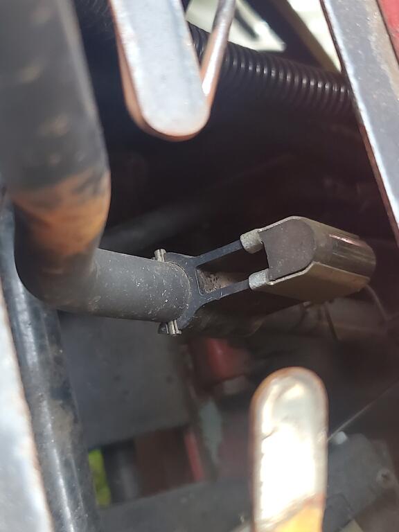

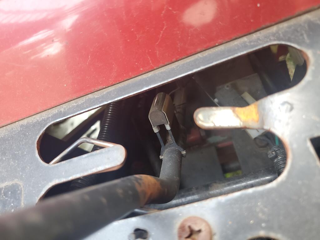

8ntruck 9,398 #6803 Posted September 28, 2020 3 hours ago, Jhook said: Ive been needing to replace my shift boot. Have the parts. But has anyone done it on this machine 07 315-8? Theres a safety switch of some sort and im not sure how to remove it, ive never worked with this type of fastener before That looks like a spring pin or a roll pin. It should drive through the hole that it is in with the proper size punch. Looks like access to do that might be a pain, though. Share this post Link to post Share on other sites
Jhook 849 #6804 Posted September 28, 2020 1 minute ago, 8ntruck said: That looks like a spring pin or a roll pin. It should drive through the hole that it is in with the proper size punch. Looks like access to do that might be a pain, though. Yes thats what i was thinking could be a pain. But my boots cracked and i need to get it done before winter, otherwise snow will get inside. Im sure some rain gets in as well Share this post Link to post Share on other sites

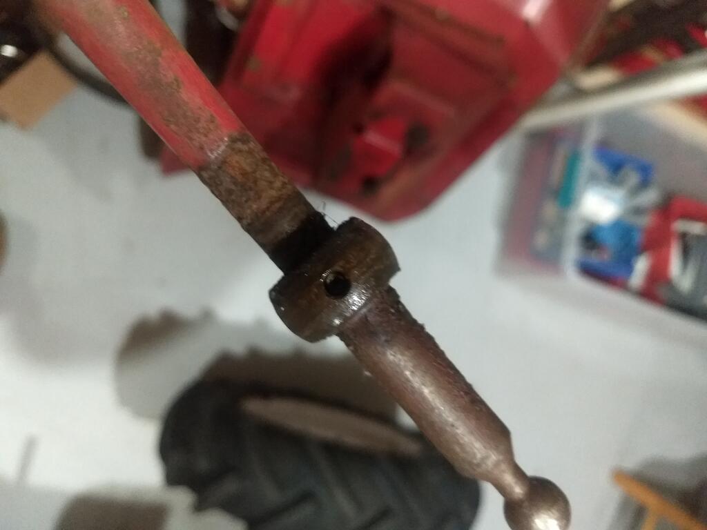

Lee1977 7,810 #6811 Posted September 28, 2020 22 hours ago, Jhook said: Yes thats what i was thinking could be a pain. But my boots cracked and i need to get it done before winter, otherwise snow will get inside. Im sure some rain gets in as well Pull the shifter, loosen the dog point set screw and the shifter comes out. 1 Share this post Link to post Share on other sites
Jhook 849 #6812 Posted September 28, 2020 39 minutes ago, Lee1977 said: Pull the shifter, loosen the dog point set screw and the shifter comes out. Where exactly is the set screw located? Under the boot? 1 Share this post Link to post Share on other sites
ebinmaine 81,169 #6813 Posted September 28, 2020 1 minute ago, Jhook said: Where exactly is the set screw located? Under the boot? Yepp 1 Share this post Link to post Share on other sites
ebinmaine 81,169 #6814 Posted September 28, 2020 1 minute ago, Jhook said: Where exactly is the set screw located? Under the boot? There will be a screw at the base of the shifter that has a jam nut on it. Loosen the jam nut then back the screw out. The hole in the picture is where that screw goes into when it is installed in the transmission. 1 Share this post Link to post Share on other sites
johnnymag3 2,646 #6815 Posted September 29, 2020 21 minutes ago, ebinmaine said: There will be a screw at the base of the shifter that has a jam nut on it. Loosen the jam nut then back the screw out. The hole in the picture is where that screw goes into when it is installed in the transmission. NICE PICTURE ERIC !!!!! 1 Share this post Link to post Share on other sites
ebinmaine 81,169 #6816 Posted September 29, 2020 6 minutes ago, johnnymag3 said: NICE PICTURE ERIC !!!!! Happened to be good timing. Trina and I are in the basement workshop... Share this post Link to post Share on other sites
Jhook 849 #6817 Posted September 29, 2020 31 minutes ago, ebinmaine said: There will be a screw at the base of the shifter that has a jam nut on it. Loosen the jam nut then back the screw out. The hole in the picture is where that screw goes into when it is installed in the transmission. Awesome thanks. Is reinstalling the shifter as simple as placing it back in? Nothing hard to line up inside the trans? Share this post Link to post Share on other sites
ebinmaine 81,169 #6818 Posted September 29, 2020 5 minutes ago, Jhook said: Awesome thanks. Is reinstalling the shifter as simple as placing it back in? Nothing hard to line up inside the trans? That's all it is but sometimes it's a bit of a pita to line up that hole with the screw. Share this post Link to post Share on other sites
Jhook 849 #6819 Posted September 29, 2020 12 minutes ago, ebinmaine said: That's all it is but sometimes it's a bit of a pita to line up that hole with the screw. Awesome will try to tackle that tomorrow. Still gotta finish sewing the windows on my cab which is no fun when the windows are 1mm thick vinyl😂 thanks for the help though 1 Share this post Link to post Share on other sites
