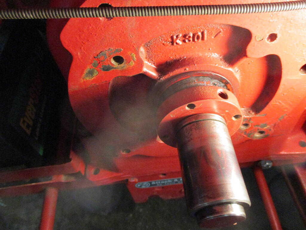

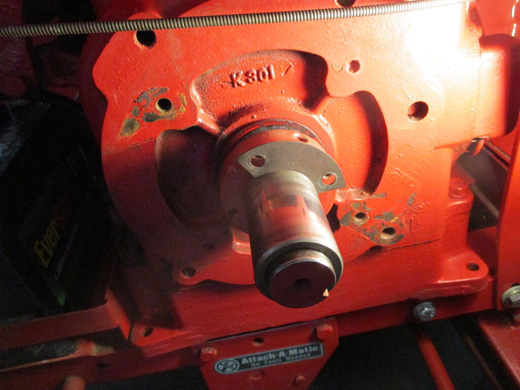

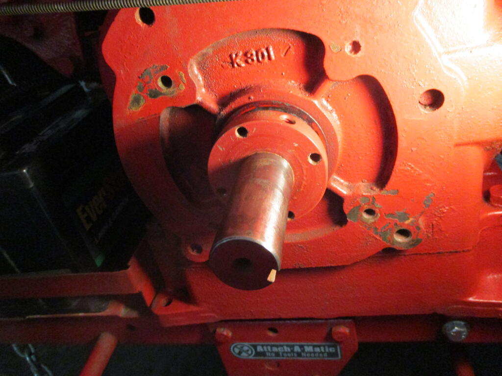

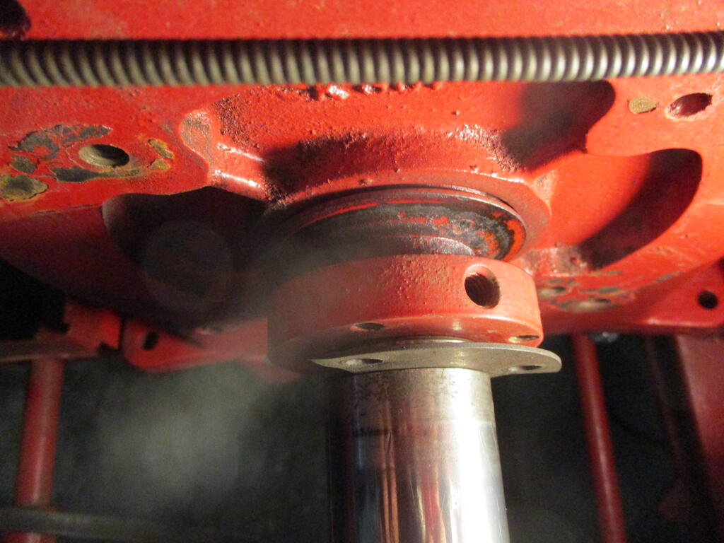

johnnymag3 2,646 #6480 Posted September 7, 2020 Ok so I need help.....as always.,,,,, I tried to install a sleeve and a pulley on the 1257 Tractor. Otherwise known as 19. The other half of Covid, the 310-8. You may remember, I got both tractors in the 3rd week of March from the original owners.... anyways........Covid 19 Each one has a name. What am I missing??? There is a space of about 3/8 of an inch between the clips,and the clutch disc. I put the PTO bearing sleeve on, and the clips are not even close....What gives? What am I missing, or what do I need...Seems awful weird....HELP WH scientists Share this post Link to post Share on other sites
Pullstart 71,156 #6482 Posted September 7, 2020 Johnny, it goes sleeve, Disc, then those tabs and bolts to hold it to the tapped ring. Will that take up the extra room? Share this post Link to post Share on other sites
johnnymag3 2,646 #6483 Posted September 7, 2020 Im going to give it a re assemble tomorrow....things were just out of sorts with this 301K...It plowed all its life, and never had a PTO on it.....Just a blade...since 1967....one guy one driveway oneowner Quote Share this post Link to post Share on other sites

johnnymag3 2,646 #6485 Posted September 7, 2020 Thanks PULLSTART................ My mind is not as sharp as it was 40 years ago 1 Share this post Link to post Share on other sites

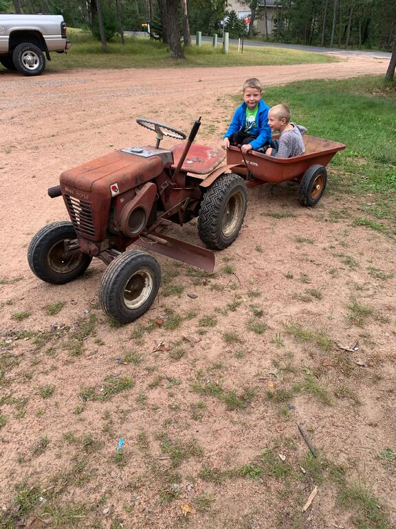

Rp.wh 1,104 #6488 Posted September 7, 2020 Today I had to replace a carb on the old 702 and decided to put on the grader blade even though it isn’t finished and had to try it out and of course when I was done the kids wanted to go for a tub ride 9 3 1 1 Share this post Link to post Share on other sites
