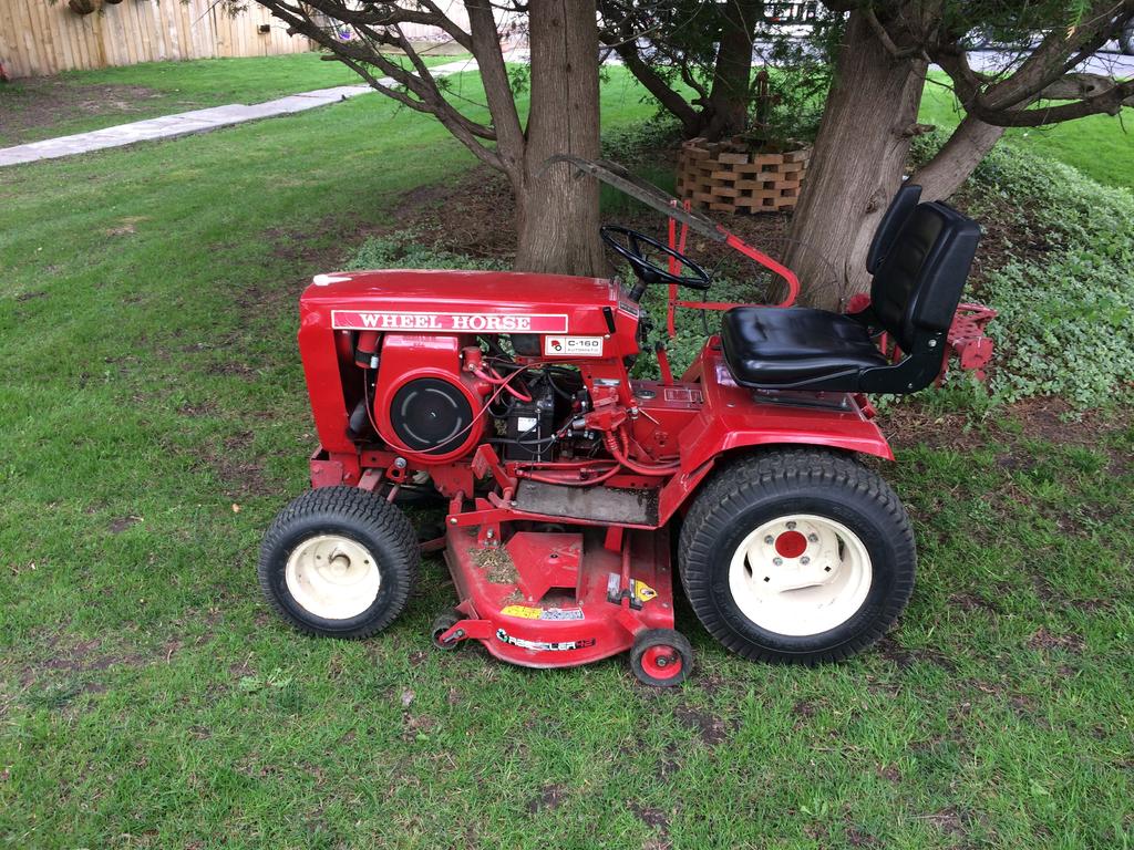

Aldon 4,834 #607 Posted May 5, 2018 4 minutes ago, squonk said: Mowed the yard today with the 16 HORSE THUMPER!!!!!!!! I did as well. I really like the c160 for mowing. 5 Share this post Link to post Share on other sites

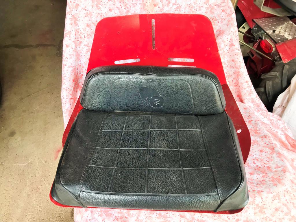

Lane Ranger 12,167 #608 Posted May 5, 2018 (edited) Rebuilt a Wheel Horse seat my sister helped save w ith new black upholstry vinyl, repainted a bunch of RJ and Suburban Wheel Horse clutch parts, wanted to get my RJ transmssion on the RJ frame today but found a problem with the brake shaft not tur ning and had to contact Stevesaurus for some advice. I was gettting ready to put the new oil seals in the brake and drive sfates (the big oiil seals) and then fill with fluid. But I did a check on axles, drive sfat and brake first. Good thin I did. Steve says I need to take a look at teh way the muchroom gear at teh bottom of the brake sfat goes into the bearing and how high the bearing sits in the bearing race. It is bound up tight and needs to move freely . Will get to that tomorrow! I have anoterh RJ transmssion that is unpainted but operates well. However, I have not taken a look inside it yet. Two other ones I have need major work and may not have 100% surviial ! Edited May 5, 2018 by Lane Ranger 11 Share this post Link to post Share on other sites

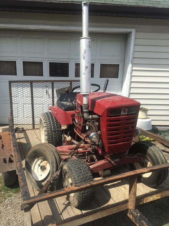

Aldon 4,834 #619 Posted May 6, 2018 Decided to blow the dust and grass clippings off my K341 thumper. I like this beast almost as much as my GT14’s. 4 6 Share this post Link to post Share on other sites

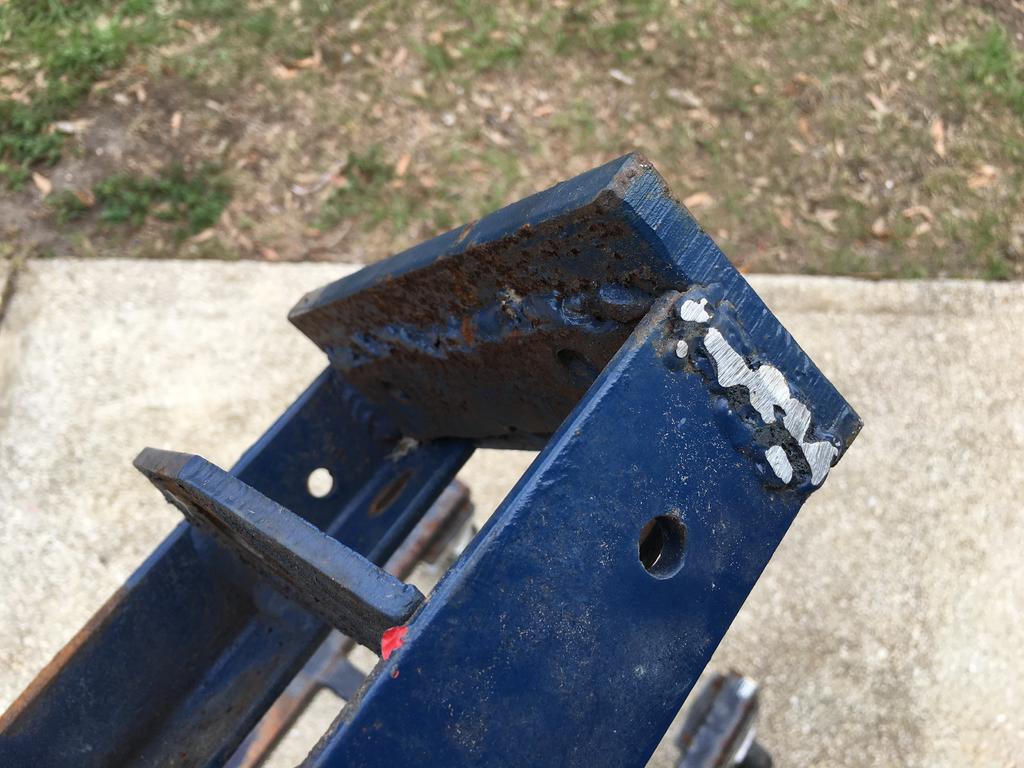

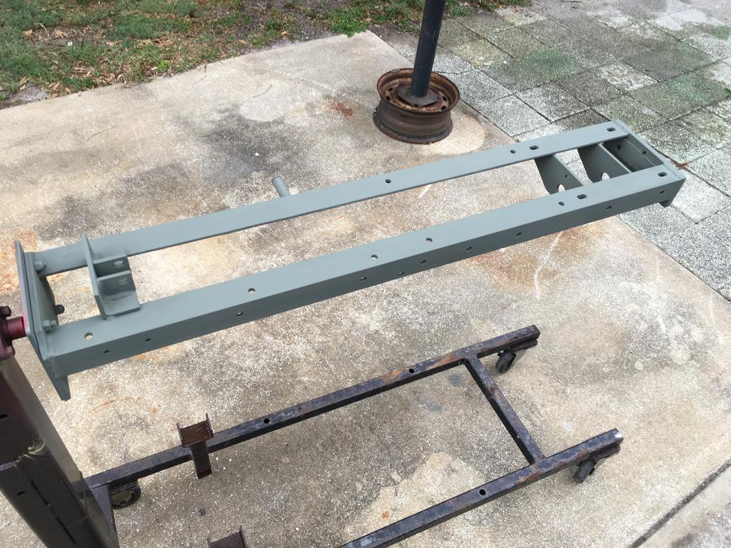

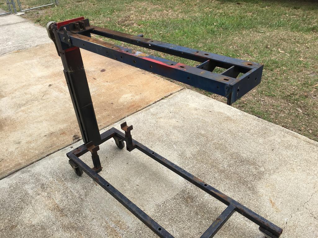

19richie66 17,950 #620 Posted May 6, 2018 (edited) Took Skittles down to the bare bones. Put the frame on the rotisserie and got it all stripped, wire wheeled and primed today. Also fixed the crappy weld job on the front. Someone popcorn welded a thick piece of steel on the front to the real thin factory piece. Scuff it and paint it tomorrow and let it bake a couple days. Front axle and side panels are next. Edited May 6, 2018 by 19richie66 Forgot the pictures and you know if there are no photos, it didn’t happen. 7 2 Share this post Link to post Share on other sites
