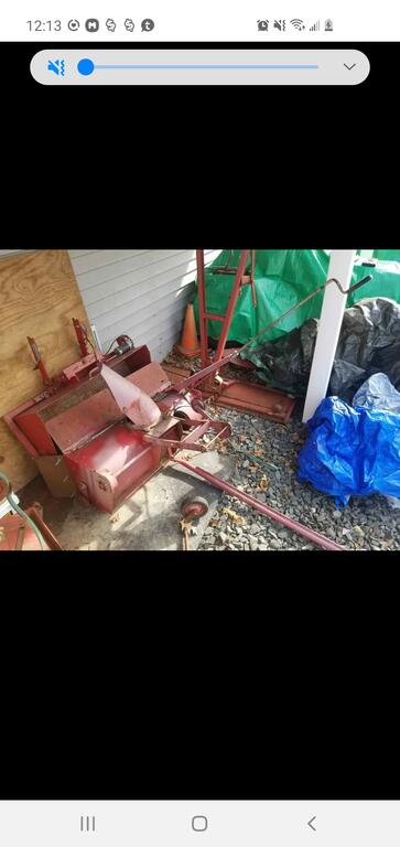

Jhook 849 #6126 Posted August 16, 2020 I could be wrong, but in this picture which is a listing for a gt14 with a snowblower, looks like a johnny bucket leaning against the wall. Not postive but i messaged him and if its for sale and its cheap enough like 3 or 4 hundred ill grab that as well! 1 Share this post Link to post Share on other sites

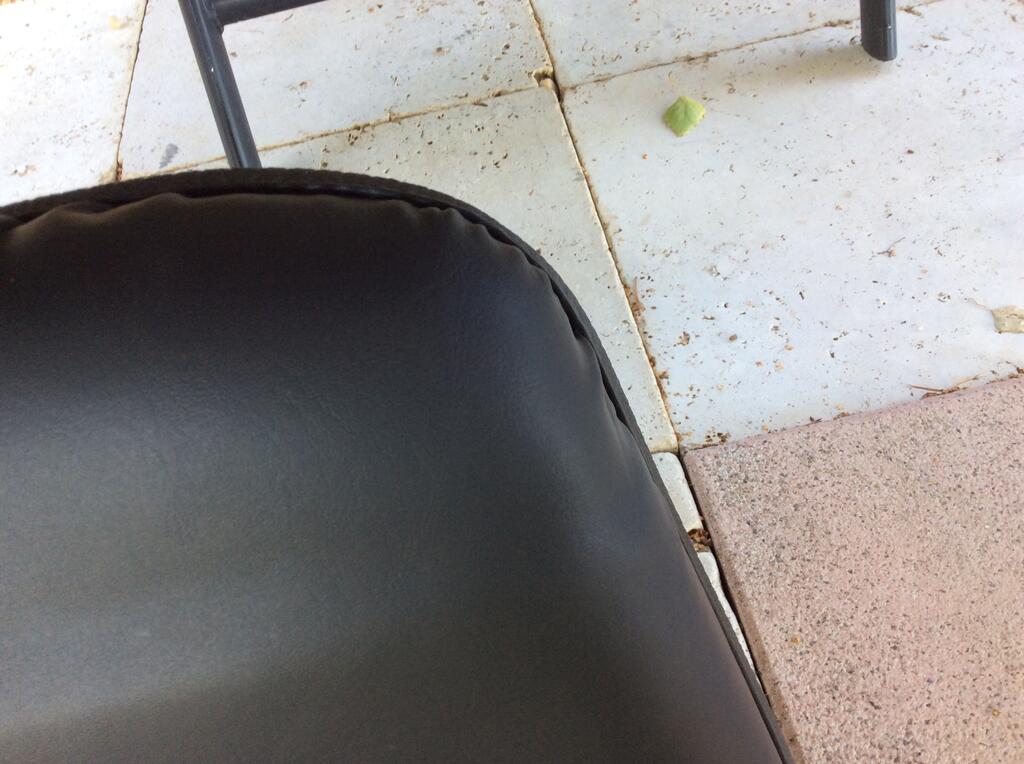

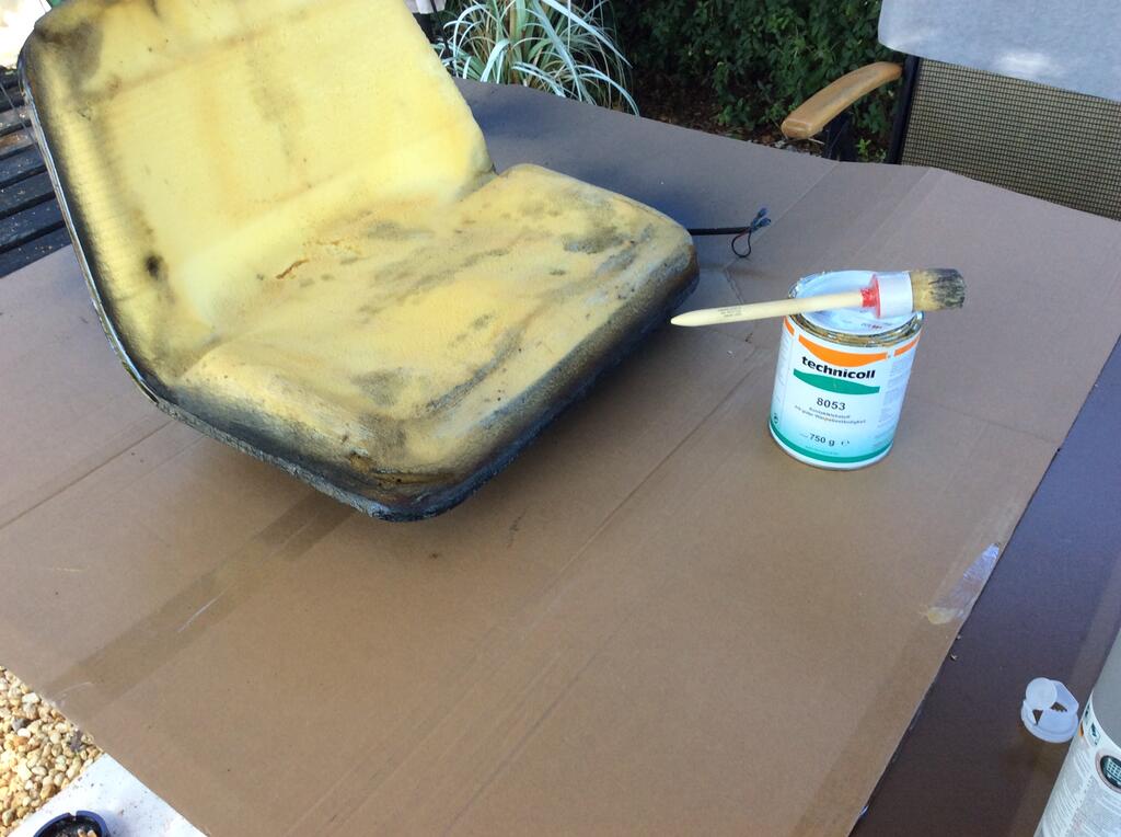

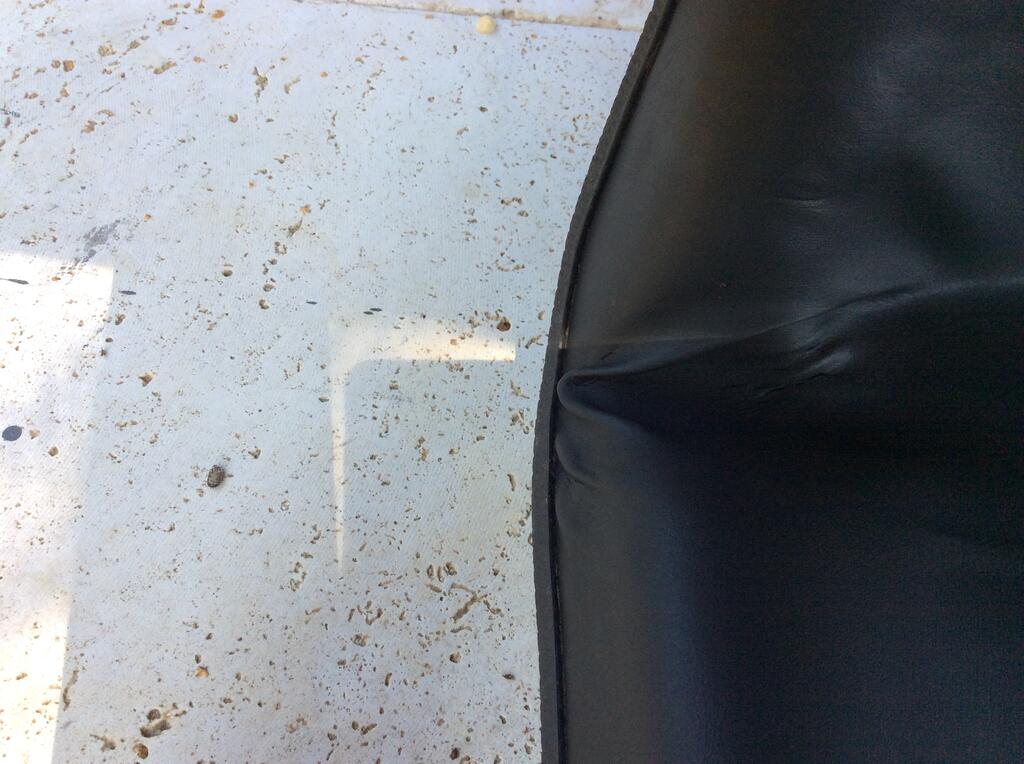

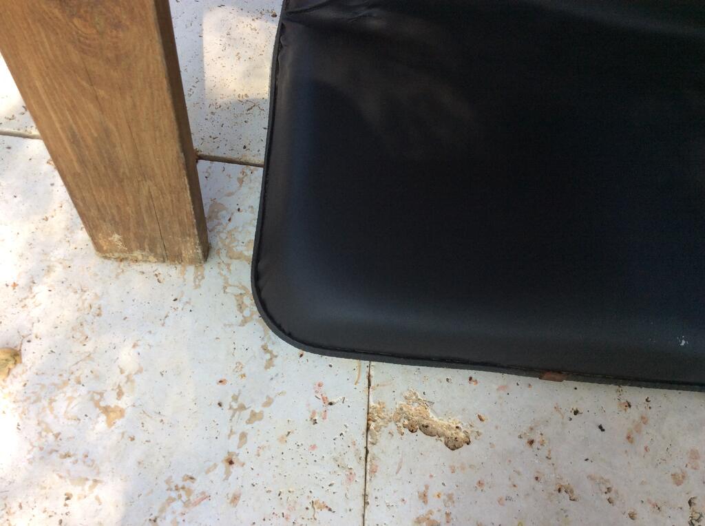

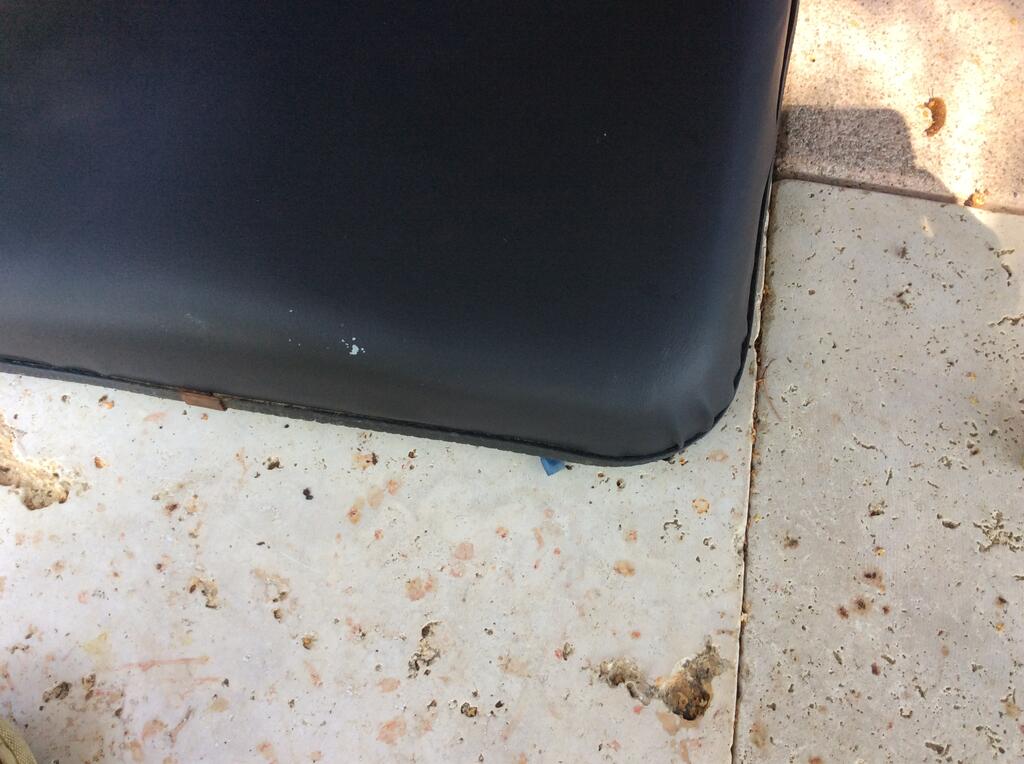

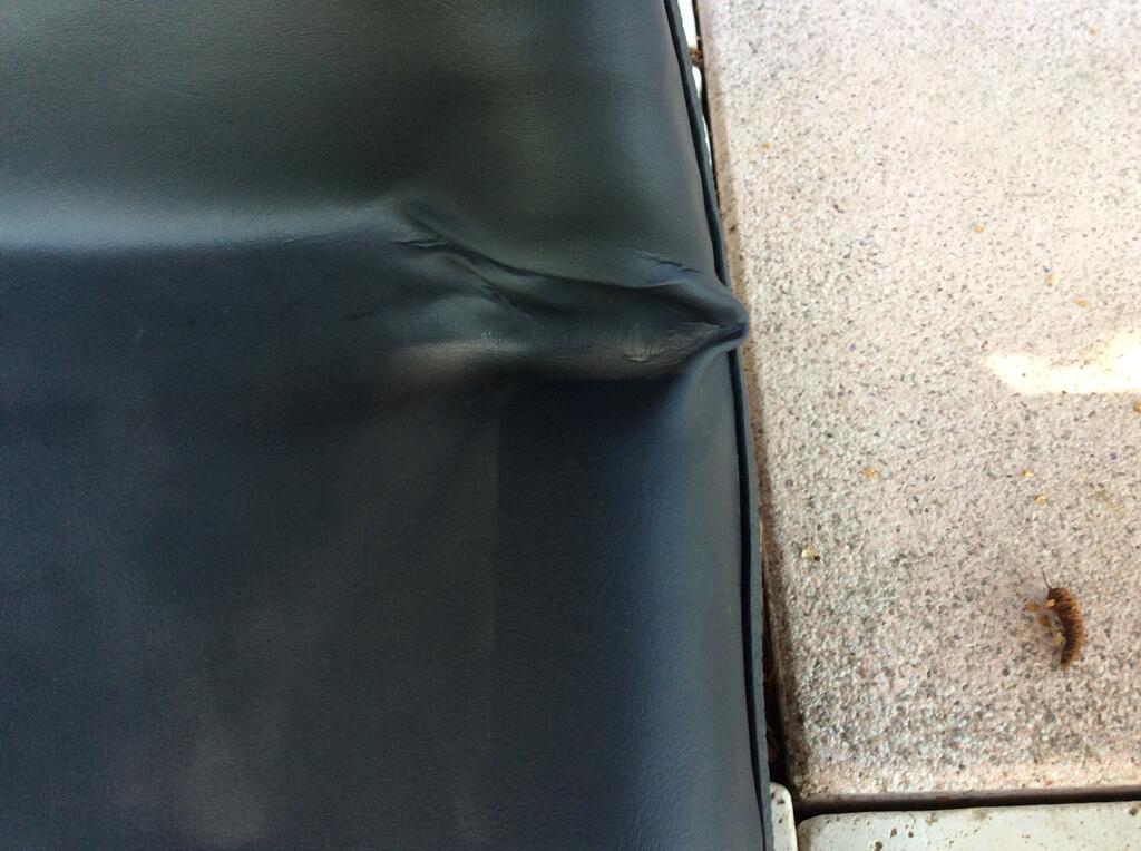

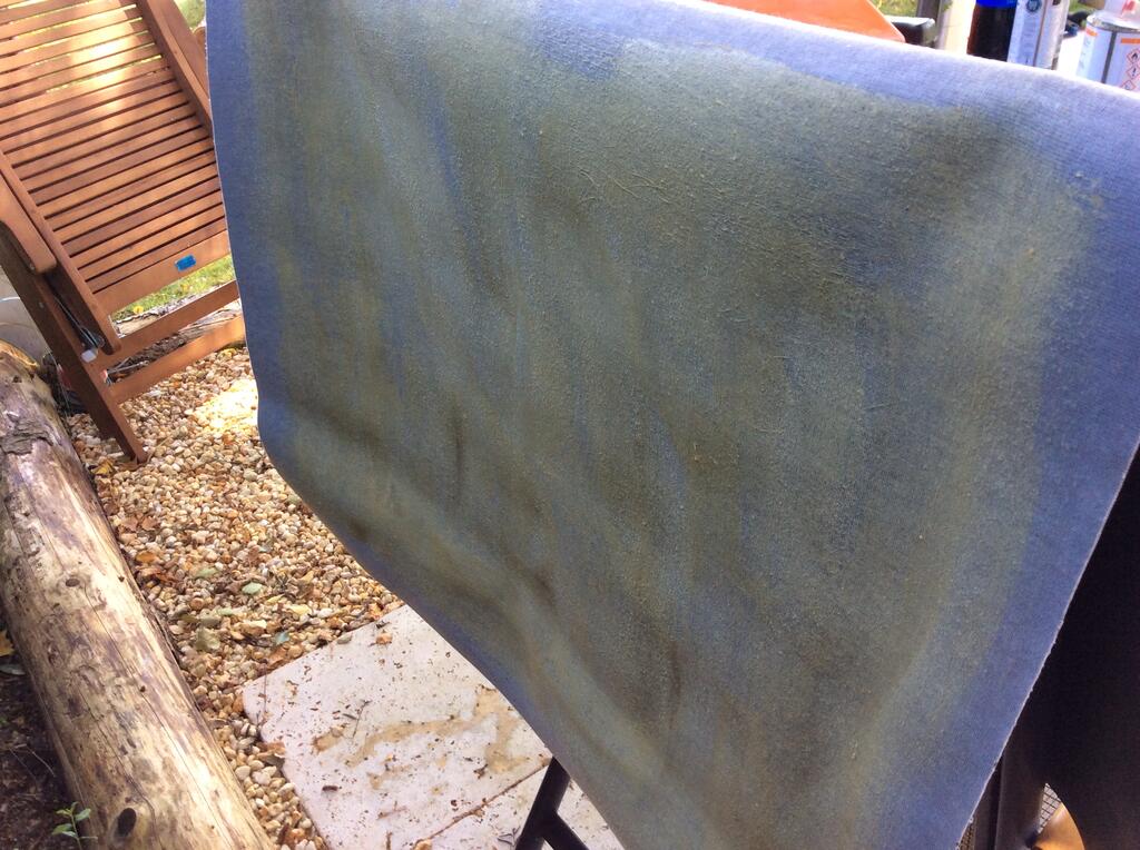

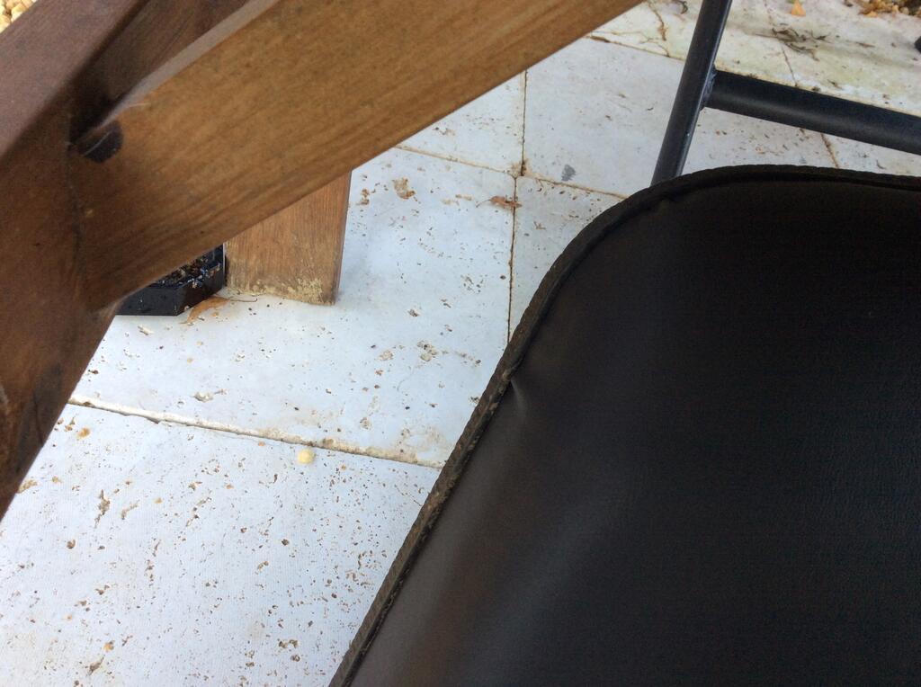

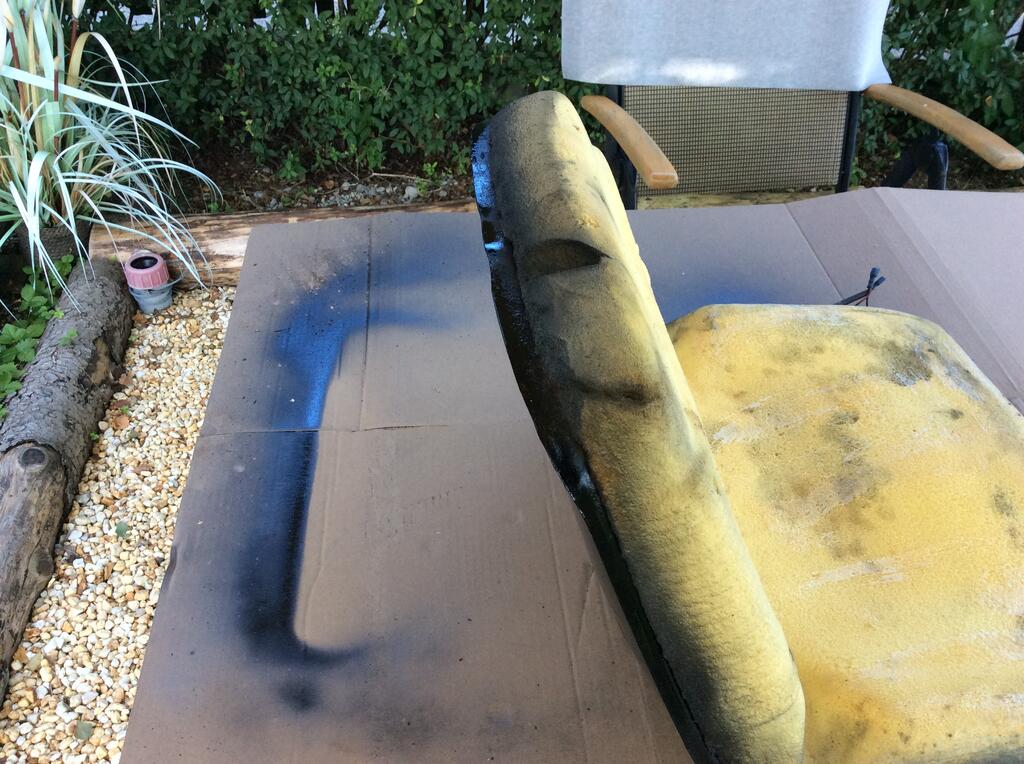

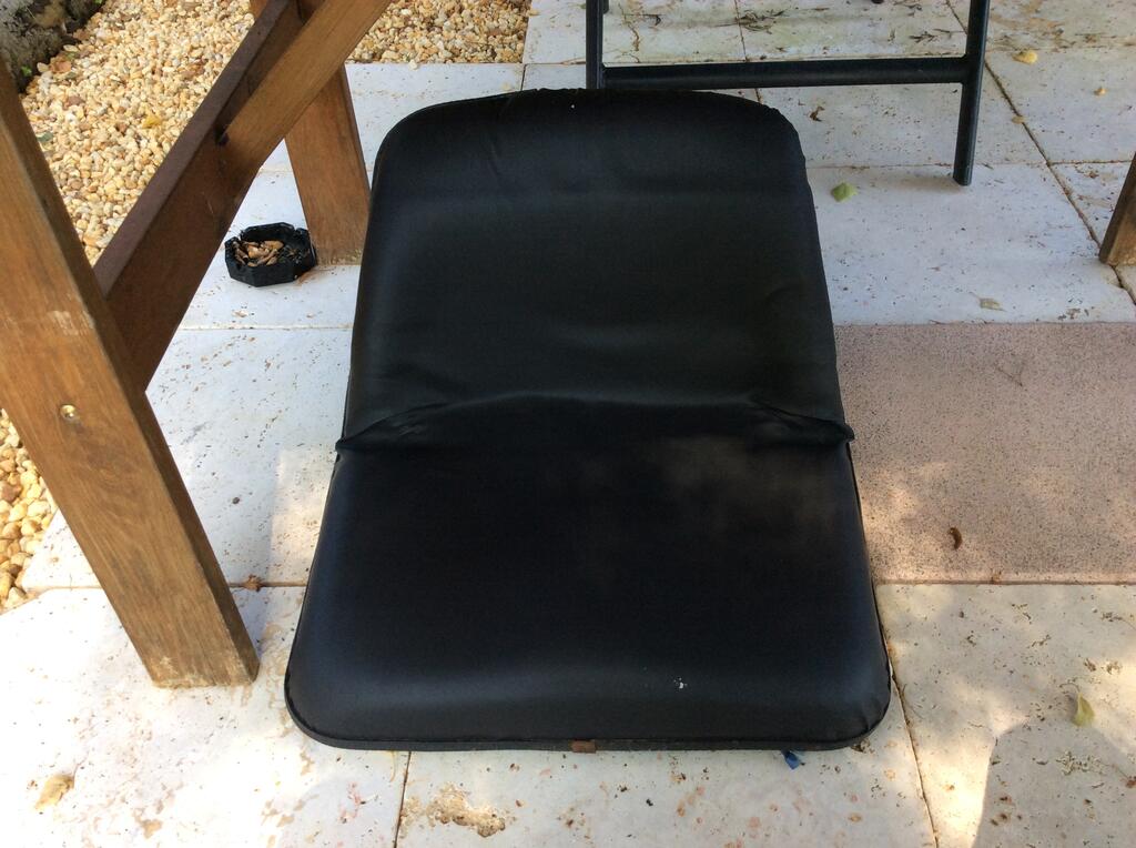

Tractorhead 9,218 #6128 Posted August 16, 2020 Fail 🤬 next time i ask a upholstery company to get a new surface on a Seat. I do as suggested, but it be not easy to get a clean Surface. firstly i derusted the contact Areas with grinding fleece and repaint it with a rusprevention paint in black. Than i let it dry over night. Next Day i take a look at the Paint and it seems ready for the next Step. I glued the foam arround and on the contact surface and even also the Skin. i let it dry for 15 min as suggested and than i try to stick it on the Seat. firstly begun in the middle of the Seatpan what seems so far not Bad at all. i pressed the skin onto the middle section on the seatpan and roll it out to the sides. than i pulled it with pliers on the sidesections, with maximum force i can handle to get it wrinklefree. but it failed. I can not pull with that force it shall needed. when a wrikle gets solved, another comes up.. Aaaaaaaarrrrgggghhhhh. that‘s definitely not my Job. I just can produce wrinkles like an old man. But ok, the Seat itself is again sealed with a closed skin, so i can deal with it. and it is comfy as before. 7 1 1 Share this post Link to post Share on other sites
lynnmor 9,073 #6129 Posted August 16, 2020 I don’t know of an upholstery company that would do that kind of work. The factory skin was put on using some kind method using heat. 1 Share this post Link to post Share on other sites
Tractorhead 9,218 #6130 Posted August 16, 2020 I know this day‘s it‘s hard to find smaller Companies, they be willing to rework older things. Most look for a quick money or the just specialized to convertible Top‘s or on sofa‘s. I had in the past where i grow friends ( 2 Brothers) they start an upholster Company after their Training, I remembered them last week while i drove home that Way about 50 km far and decide do a stop to see, if they still Active until now and how they do, but they sadly wasn‘t at home. Juergen was a passionate restorer of old Zuendapp‘s, that was his reason to learn handle also a rework of that saddles. He did my Motocycle saddle in the past for my old Zuendapp KS50 in a real whow quality. He also fixed the foam and reworked it to seat more comfortable, also on longer Rides. Had this Zuendapp 6Years until i sold it. After he reworks it, it was better than new and looked even fantastic, but i sadly didn‘t have any Picts of it. ok that was 36 years ago... 😎 no Digicam‘s or mobilephones with Cam where available at this timeline. Will ask Juergen if he is willing to do that for me, or if he knew a saddler who‘s able to do that for a fair price. Share this post Link to post Share on other sites

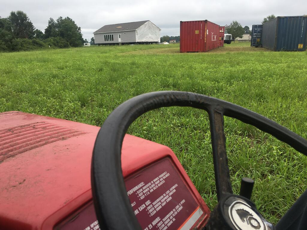

19richie66 17,950 #6133 Posted August 16, 2020 Using it. Getting closer on the house. 5 3 Share this post Link to post Share on other sites

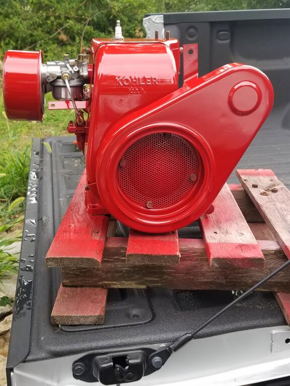

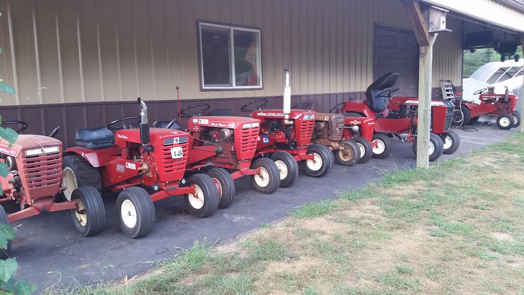

AMC RULES 37,260 #6134 Posted August 16, 2020 What do you think... good hobby to have? 4 9 4 Share this post Link to post Share on other sites
Jennifer 1,878 #6135 Posted August 16, 2020 (edited) 6 minutes ago, AMC RULES said: What do you think... good hobby to have? Looks great! Will you paint Kohler/USA in white? Edited August 16, 2020 by Jennifer 2 Share this post Link to post Share on other sites
AMC RULES 37,260 #6136 Posted August 16, 2020 From the factory, was originally silver on my blower housing... maybe, will revisit that later on. Share this post Link to post Share on other sites
The Tuul Crib 7,354 #6137 Posted August 16, 2020 47 minutes ago, AMC RULES said: What do you think... good hobby to have? Mmmmmmm Beautiful!!! 1 Share this post Link to post Share on other sites

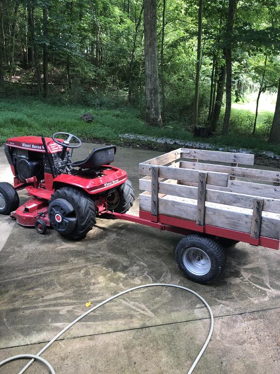

The Tuul Crib 7,354 #6138 Posted August 16, 2020 Hooked up my trailer and decided to give it a good pressure wash. Looks a whole lot better now!! 5 1 1 Share this post Link to post Share on other sites

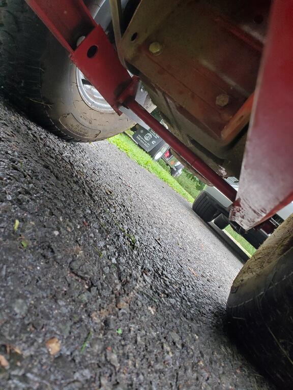

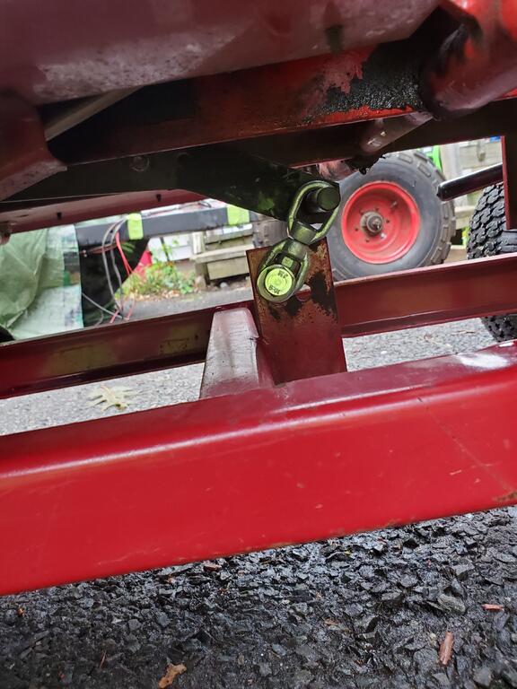

Jhook 849 #6139 Posted August 16, 2020 Well i got the 1980 c-series plow. Picked it up 1.5 hours away this morning. Paid the 160 we agreed on and was on my way. I got it mounted to the tractor. Looks and works great. Let me know if i have it mounted correctly please. Also have a bad gas leak to look into. Need to fix it asap as i use this mower to do other weekly mowing besides my own yard 1 Share this post Link to post Share on other sites
Jhook 849 #6140 Posted August 16, 2020 Hoping its on right 1 Share this post Link to post Share on other sites
rjg854 13,423 #6141 Posted August 16, 2020 Put a new locking throttle cable on the 1076. Headlight bucket fell off the C160 while mowing, luckily I didn't run over the lens cover. That's how I knew something was wrong because I saw it laying on the ground with my next pass. The rivets gave out and the screws must have rattled out. It won't happen again, this time I nut and bolted it on. And use a tad larger screws for the cover. 2 Share this post Link to post Share on other sites
Ed Kennell 47,828 #6142 Posted August 16, 2020 1 hour ago, Jhook said: Hoping its on right Does it lift OK ? Does the angle lever clear everything a work OK? That's what matters. I use the deck lift bar to lift one of my plows. I made a slotted bar like the one on the decks, but if yours lifts w/o binding, it should work. My other plow I don't use the deck lift bar. It is connected directly to the rock shaft lift lever via a chain. If you ever need or want down pressure, you would need a solid link bar from the plow to the rock shaft lever. This is the factory design. 3 Share this post Link to post Share on other sites
Jhook 849 #6143 Posted August 16, 2020 (edited) 22 minutes ago, Ed Kennell said: Does it lift OK ? Does the angle lever clear everything a work OK? That's what matters. I use the deck lift bar to lift one of my plows. I made a slotted bar like the one on the decks, but if yours lifts w/o binding, it should work. My other plow I don't use the deck lift bar. It is connected directly to the rock shaft lift lever via a chain. If you ever need or want down pressure, you would need a solid link bar from the plow to the rock shaft lever. This is the factory design. Lifts fine, a bit heavy but thats a given. Nothing binds but at full lift it just barely touches the axle. Is the deck lift bar strong enough to lift a plow or is it gonna break on me? I have that little universal type joint from the deck lift to the plow and it's the perfect length. Angle lever only works 1 direction as the pto is in the way. Im fine with that for the mean time Edited August 16, 2020 by Jhook Share this post Link to post Share on other sites

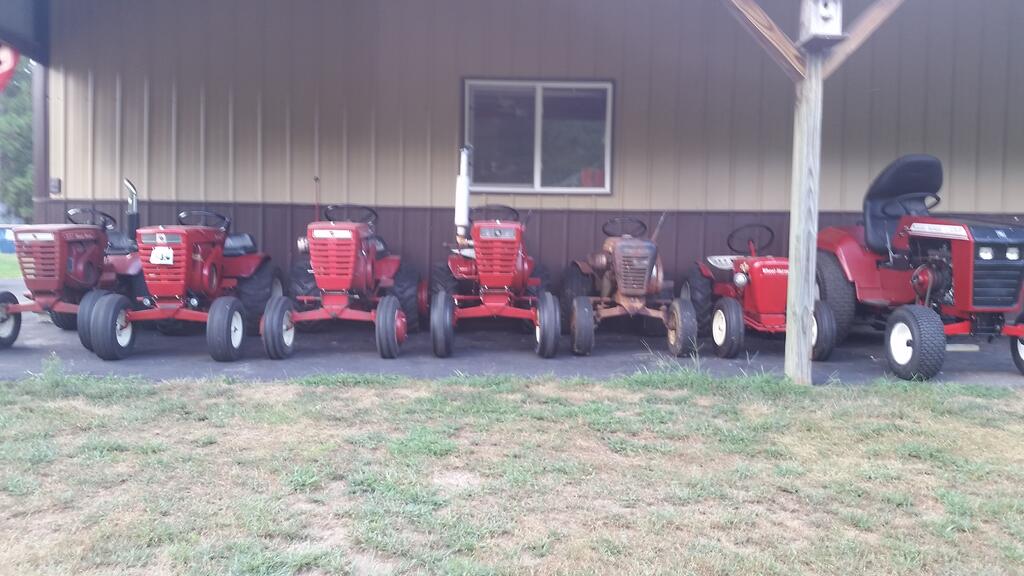

WHX?? 58,347 #6144 Posted August 16, 2020 Cleaned the stalls.... 6 4 2 Share this post Link to post Share on other sites

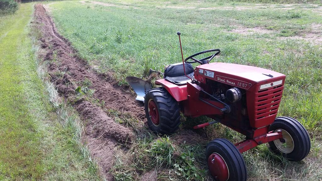

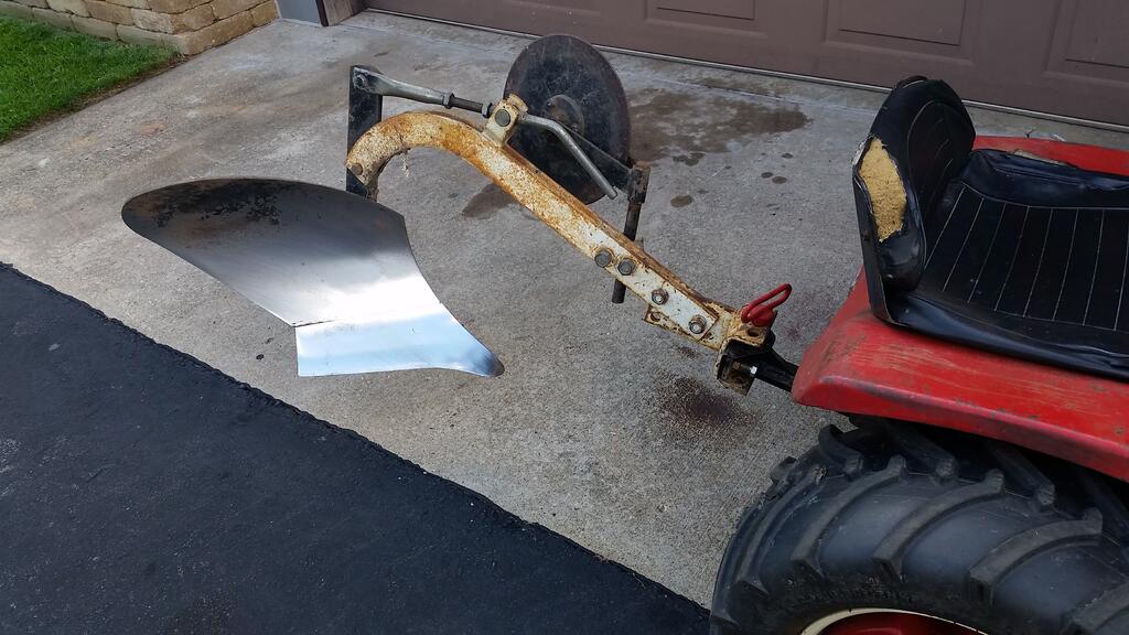

WHX?? 58,347 #6145 Posted August 16, 2020 Also replaced the broken lift cable on the plow mule.. had to take it out for a test run....put a mirror finish on the share... may have to shave in it in the morning 6 6 Share this post Link to post Share on other sites
Ed Kennell 47,828 #6146 Posted August 16, 2020 27 minutes ago, Jhook said: Lifts fine, a bit heavy but thats a given. Nothing binds but at full lift it just barely touches the axle. Is the deck lift bar strong enough to lift a plow or is it gonna break on me? I have that little universal type joint from the deck lift to the plow and it's the perfect length. Angle lever only works 1 direction as the pto is in the way. Im fine with that for the mean time The deck lift bar handles my 48" plow OK. I have all hydro lifts, so I don't have a feel for the force required. Some plow frames have an extension bar to the rear with a hole that is directly under the hole in the rock shaft lever. Thus not using the deck lift bar. I am sure this direct vertical lift would require less force than using the deck lift bar. Sometimes the angle lever can be flipped over to improve clearance with the PTO, or it can be notched, bent and rewelded to clear the PTO. 1 Share this post Link to post Share on other sites

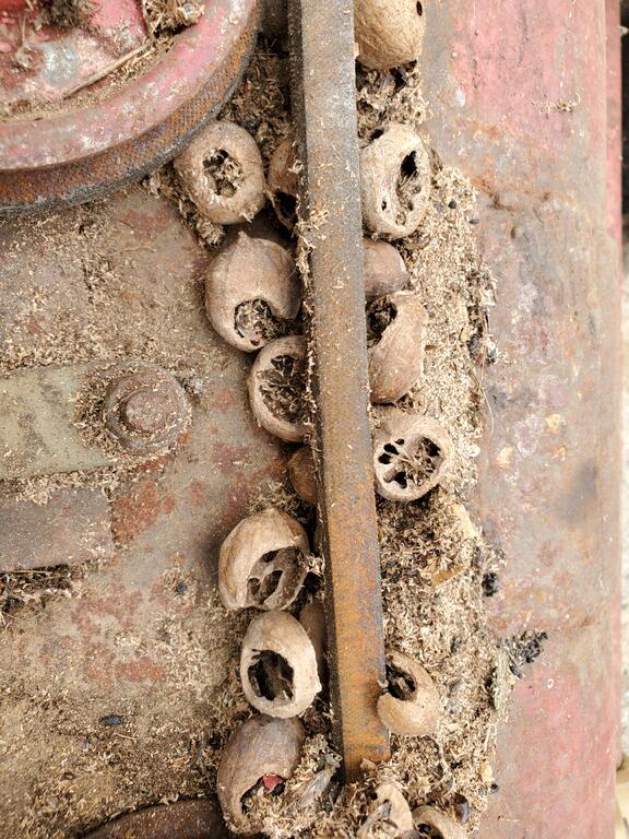

ArturHawk 195 #6147 Posted August 17, 2020 Bought a spare deck to use on the c-120 yesterday. Only cost $35, so I couldn't get it loaded fast enough. When I got out today I tried spinning the blades by hand to get an idea id the PO ever bothered greasing it. It felt...crunchy. Then I spun it the other direction...not crunchy. I had to do a little investigation so off came the belt cover. Guess someone thought I might get hungry working and packed me a lunch! After clearing the meal, I removed and greased the tension bar/pulley, greased the spindles, and hooked it up. Works great, but the leveling foot on the top side wants to pinch the belt when the deck is raised. This deck supposedly came from a raider 12 and is supposed to use the side pulley. I'm trying to use the mule drive. Maybe i'm missing something. 1 6 Share this post Link to post Share on other sites
Stormin 9,988 #6148 Posted August 17, 2020 8 hours ago, WHX24 said: Looks like you've had one to many, Jim. 1 2 Share this post Link to post Share on other sites
953 nut 70,383 #6149 Posted August 17, 2020 12 hours ago, Jhook said: Lifts fine, a bit heavy but thats a given. Nothing binds but at full lift it just barely touches the axle. Is the deck lift bar strong enough to lift a plow or is it gonna break on me? I have that little universal type joint from the deck lift to the plow and it's the perfect length. Angle lever only works 1 direction as the pto is in the way. Im fine with that for the mean time Item 19 in this drawing is the rock-shaft. You will see that there are holes just for the snow blade 1 Share this post Link to post Share on other sites
WHX?? 58,347 #6150 Posted August 17, 2020 3 hours ago, Stormin said: Looks like you've had one to many, Jim. LOL... Line of pine trees just to the left Norm ... kept hooking on roots and messin me up! Share this post Link to post Share on other sites
