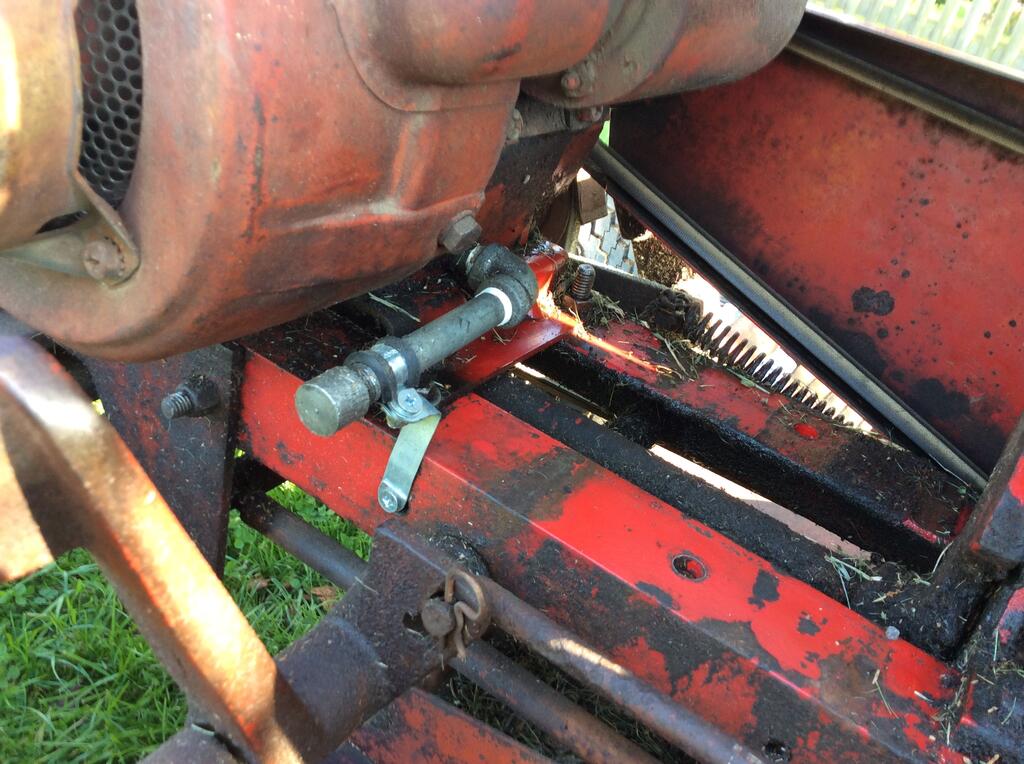

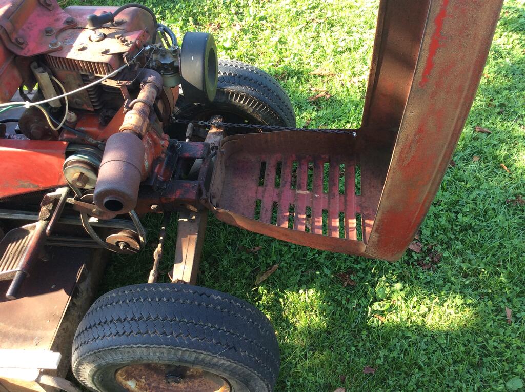

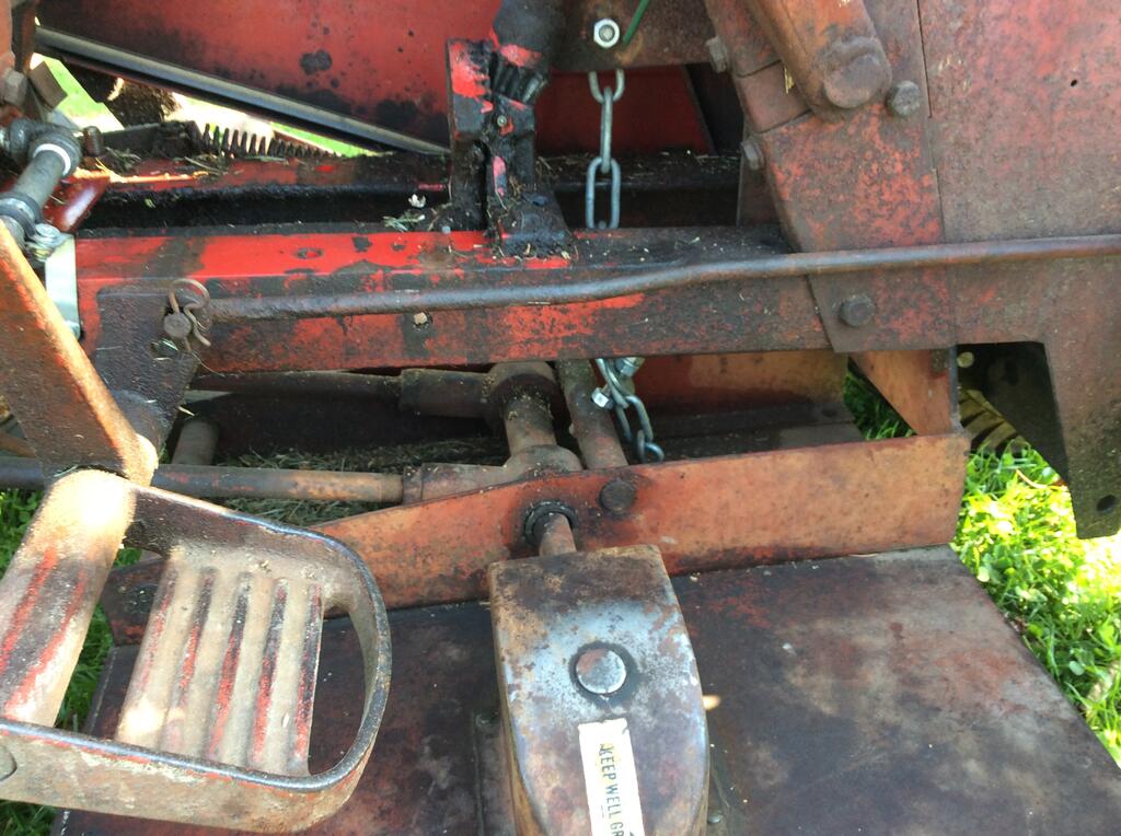

Tractorhead 9,218 #6026 Posted August 9, 2020 Today i just do few orders and a bit of Reworking. Firstly i changed the Lift pin of the Mowerdeck with a chain. the reason i did this is an i like to have it more accurate in the Swing while mowing on slopes. the pendle will give it more possibillity to act, even it don‘t scratches on the Beltcover anymore. Than i searched for a better suited Spring for the Governor. Found in my spares a little smaller but stiffer one, that acts dimensios better. A much smoother throttle response was the result without oscillating rpm‘s. After that i fixed the Hoodchain again. stiffned the Oildrain pipe with an mount, that holds the Clip to keep it save even on shaking or vibrations. 7 7 Share this post Link to post Share on other sites

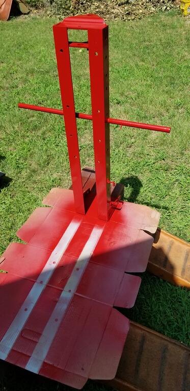

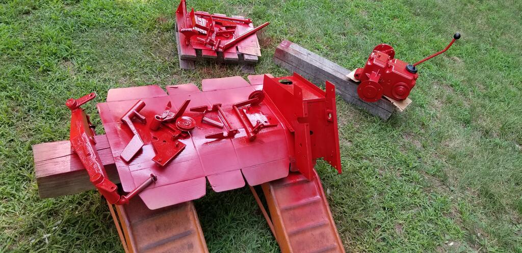

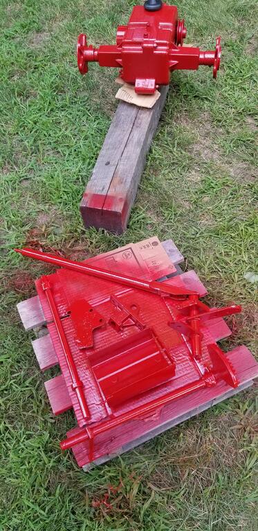

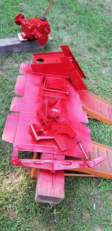

AMC RULES 37,260 #6027 Posted August 9, 2020 And now......the rest of the story! 7 5 Share this post Link to post Share on other sites

squonk 48,348 #6031 Posted August 9, 2020 2 hours ago, AMC RULES said: And now......the rest of the story! You're supposed to paint the grass too. I had a red toned yard and garage floor for almost a year. 1 1 6 Share this post Link to post Share on other sites

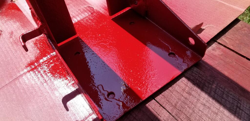

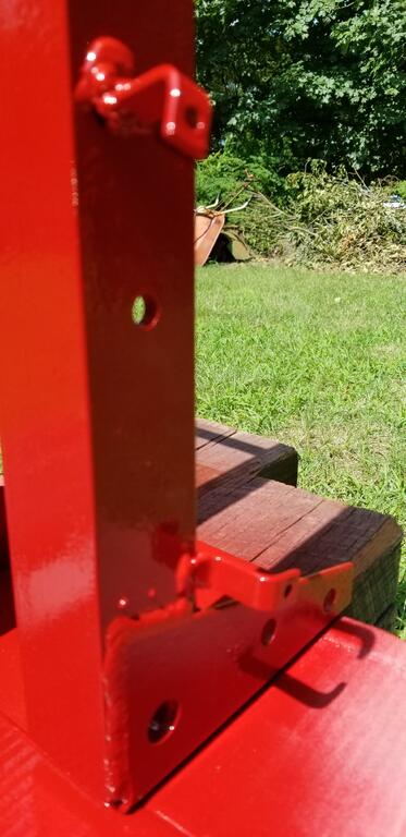

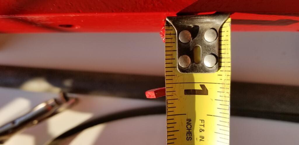

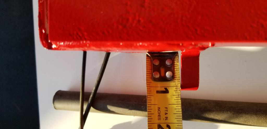

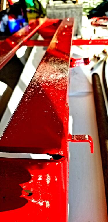

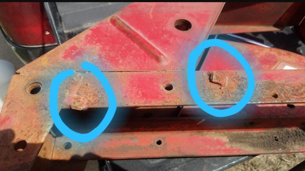

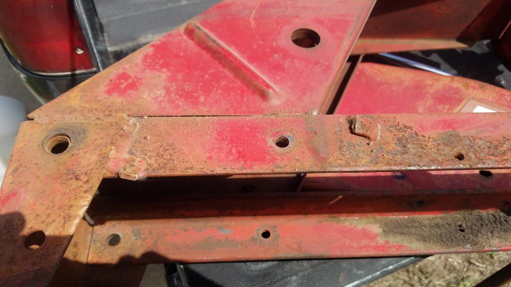

DBlackston 333 #6032 Posted August 10, 2020 8 hours ago, AMC RULES said: Early morning rise to beat the heat and make some more good progress netted me this little accomplishment today. Complete with both it's belt guard... and trans mounts repaired before 8am. Sure the neighbors weren't happy listening to the grinder that early, but I sure am! AMC do you know if those belt gaurd mounts would be the same as the ones on my 704? Mine are missing and I want to make some more. 2 Share this post Link to post Share on other sites
AMC RULES 37,260 #6033 Posted August 10, 2020 I'm sure they are... you can see here where they've broken off your frame. 1 Share this post Link to post Share on other sites
DBlackston 333 #6034 Posted August 10, 2020 32 minutes ago, AMC RULES said: I'm sure they are... you can see here where they've broken off your frame. Yeah the only thing I don't know is if how tall they are. 1 Share this post Link to post Share on other sites

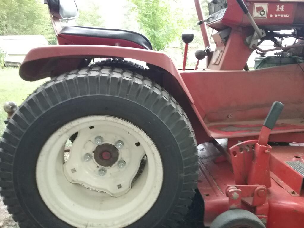

8ntruck 9,395 #6035 Posted August 10, 2020 (edited) I started out today by removing the right rear wheel to look for the slow leak I've got. Gave the wheel a bath with Gunk then did a soap bubble test on both bead seats - no leak. Tread inspection - nothing obvious there, either. I'm going to go on the theory that the leak will eventually collect enough crud to get plugged - it does seem to be slower now than it was earlier this year. As long as the wheel was off, I thought it would be an ideal time to convert to lug nuts and studs. While I was doing that, I discovered that the hub had angular play on the axle. Well, the set screw needed to be removed to install one of the studs, so that got corrected when the set screw was re-installed. Of course, the left rear needed the same treatment. While I was in there, I noticed that both axles had about 1/8" end play. Is this normal for a 14-8 no name? With everything back together, it was down to the lake house to mow that lawn, then a little bit of cart work moving some boxes around. Got to add a picture of the interesting toy the guy on the other end of the lake has. It is a Piper Super Cub. Edited August 10, 2020 by 8ntruck 4 2 1 Share this post Link to post Share on other sites

AMC RULES 37,260 #6038 Posted August 10, 2020 10 hours ago, DBlackston said: Yeah the only thing I don't know is if how tall they are. 1 1 1 Share this post Link to post Share on other sites

peter lena 10,112 #6041 Posted August 10, 2020 tractor head , on that governor spring issue, regularly use some PENETRATING OIL SPRAY on each end of the governor swing points on the engine , that will probably help in establishing a regular movement , letting it work easier , been there done that , pete 1 Share this post Link to post Share on other sites

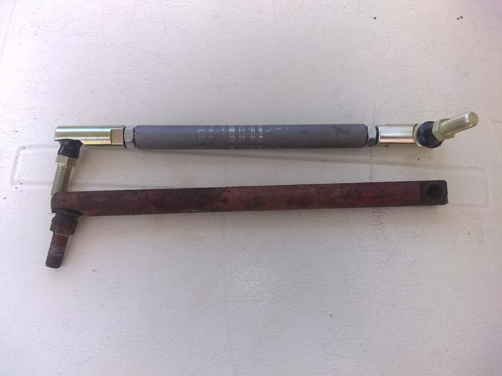

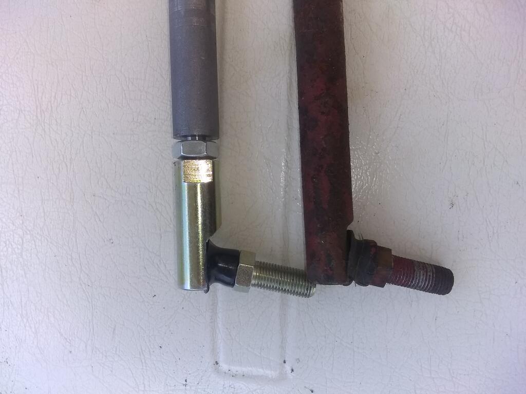

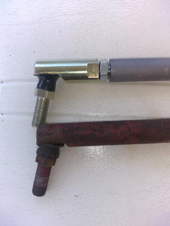

bottjernat1 2,197 #6042 Posted August 10, 2020 Got my daughters tierods done finally! Got a guy to mill them for me and I bought 4 new ends off ebay for $14. They work perfect. I had my daughter put a coat of primer and 1 coat so far of Rust-Oleom international red. 3 2 Share this post Link to post Share on other sites
Tractorhead 9,218 #6043 Posted August 10, 2020 Thanks Peter, it worked gently and smooth, but i was not sure about the Springrate wich is basicly required for that, so i have to find it out. My first decision was not bad at all, but the second spring fits much better and was a Success in a gently governor Engine. 1 1 Share this post Link to post Share on other sites
peter lena 10,112 #6044 Posted August 10, 2020 bottjernat1, nice job on that , just keep after it and replace as needed , pete 2 Share this post Link to post Share on other sites
bottjernat1 2,197 #6045 Posted August 10, 2020 7 minutes ago, peter lena said: bottjernat1, nice job on that , just keep after it and replace as needed , pete Im definitely going to do this from now on. If I dont baja with them these should last a super long time! 1 1 Share this post Link to post Share on other sites
cleat 9,405 #6046 Posted August 10, 2020 7 hours ago, bottjernat1 said: Got my daughters tierods done finally! Got a guy to mill them for me and I bought 4 new ends off ebay for $14. They work perfect. I had my daughter put a coat of primer and 1 coat so far of Rust-Oleom international red. Nice. Now you can do a proper front end alignment as well. Some people laugh at that but they really do steer nicer with just a bit of toe in. 6 Share this post Link to post Share on other sites

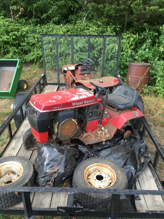

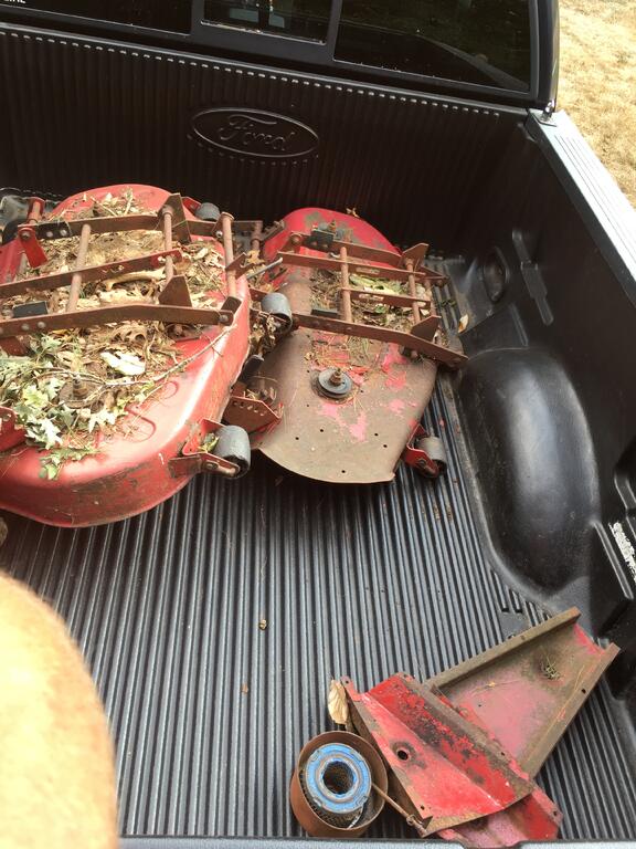

TonyToro 1,199 #6048 Posted August 11, 2020 Well....my son made me get more tractors today! Lol These were put to rest in the woods and were a royal pain to get them to our trailer. They are pretty rough but the decks seem good. They may turn out to be donor tractors. At very least we saved them from the crusher. 6 4 1 Share this post Link to post Share on other sites
