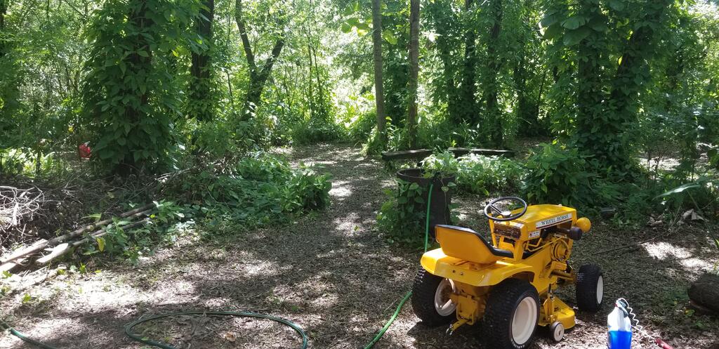

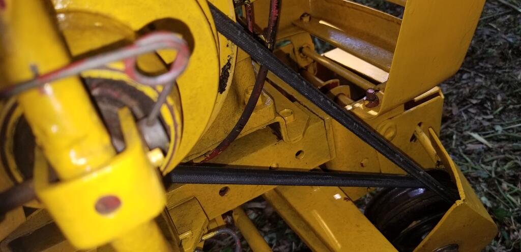

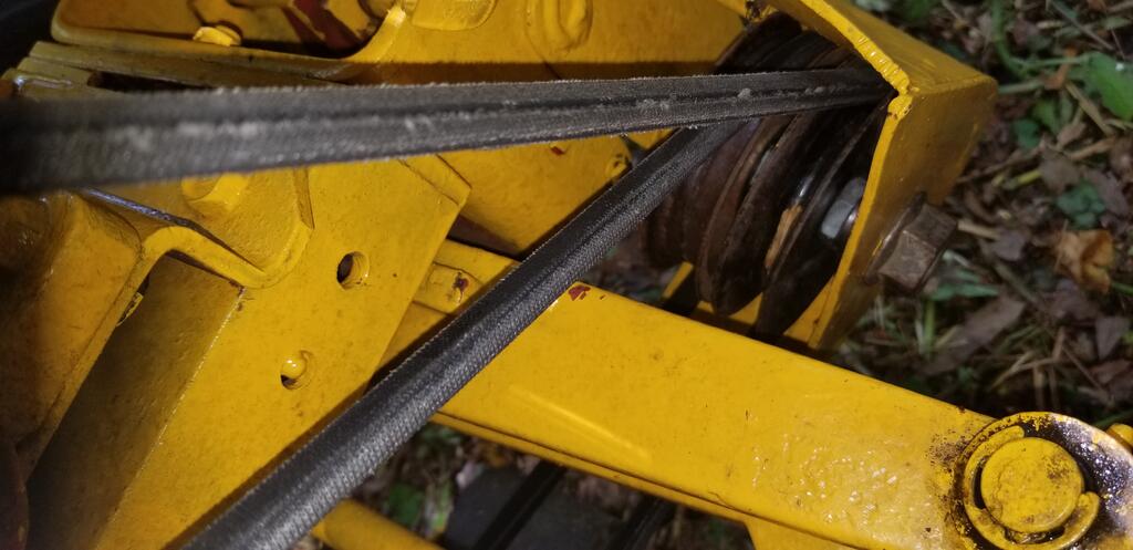

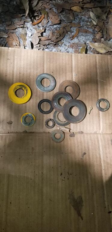

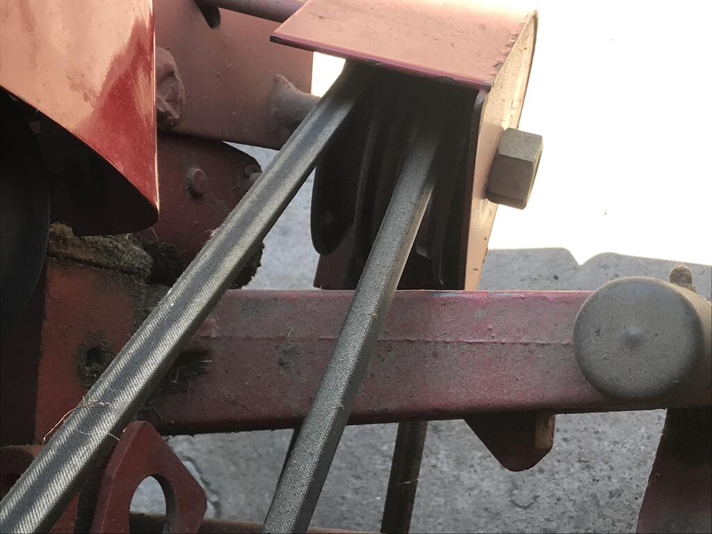

Boat guy 40 #5401 Posted June 22, 2020 What did I do to the wheelhorse today, well I beat the heck out of him! I mowed a whole bunch of overgrown trees and brush..extremely deep waist high . threw a couple pictures in their for all to see. P. O. had pullys on backwards or running backwards or something, ..It would not cut. He had been using it with the dull side of the blade ( the lift side) as the main direction for cutting... I don't know what way they are supposed to turn but I rearrange the pullys so that all Blades are cutting properly and turning the right way. But it does not look right to me. I included some pictures of the pulleys upfront don't know if I've got them set up the right way all of this was buggered up and as the pictures show a whole bunch of extra washers were in there instead of taking the time to make bushings to keep the pulleys apart as I did.. Was also wondering where those headlights on mine stock or were they added on. Halfway through mowing the front main pulley came off The mower deck and I ran it over while the blades were still turning, put a little Dent in it but nothing my wizz wheel with a thin blade couldn't smooth out and make OK. The bolt was not there, found a hardened bolt proper size in my shop and put back together works great ..finished the rest of the job. Nice little machine wish it was 4 wheel drive! I estimated on the space between the front pulleys as he had a load of washer's in there instead of a bushing .. still haven't messed With the charging system other than replacing the burnt plug.... G. 8 Share this post Link to post Share on other sites
echris 1,426 #5402 Posted June 22, 2020 The flat idler pulley should be on the outside, and the v pulley should be on the inside. They're reversed in the photos above. 6 1 Share this post Link to post Share on other sites

Boat guy 40 #5408 Posted June 22, 2020 7 hours ago, echris said: The flat idler pulley should be on the outside, and the v pulley should be on the inside. They're reversed in the photos above. Thanks Guys .. So as I'm sitting on the tractor looking at the left side of the mower deck should the blades be spinning clockwise or counter clockwise? Do I have the belt correct around the PTO pulley? Just seems not right to me.. All the blades seem to be new as the sharp edge was never used, And they are all the same length which I don't think is correct either. Anybody have part numbers for the correct blades and I will order them. I ordered maintenance manuals and owner's manuals allready, just not here yet. G. 1 Share this post Link to post Share on other sites

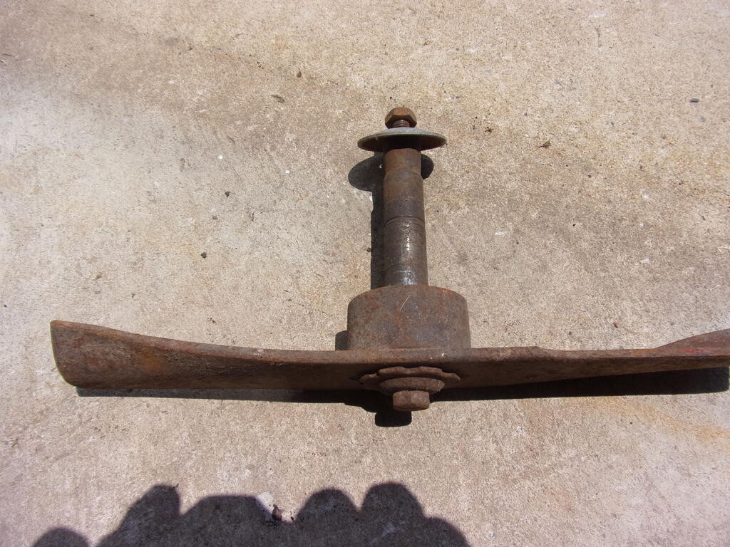

Stormin 9,988 #5410 Posted June 22, 2020 All blades should be the same length. Rotating clockwise looking down on the top of the deck. I know it may sound daft, but are they the right way up? 2 Share this post Link to post Share on other sites

Boat guy 40 #5412 Posted June 22, 2020 2 hours ago, Stormin said: All blades should be the same length. Rotating clockwise looking down on the top of the deck. I know it may sound daft, but are they the right way up? When I got it, the p.o Was using it with the lift side of the blade as the cutting edge with the sharp edge behind it, I can't remember what way they were turning but if I flipped the blade to the correct position to cut .. the lift portion was faceing down. So I put the blades back the other way and changed the Mule pulleys around and flipped the belt on the p.t.o So i didn't tear up the belt and that's where I used it, but I can see that it's not right. Is there such thing as a left handed blade? Or whatever? And thanks for the help and input. I really appreciate it. 1 Share this post Link to post Share on other sites
squonk 47,477 #5413 Posted June 22, 2020 10 hours ago, echris said: The flat idler pulley should be on the outside, and the v pulley should be on the inside. They're reversed in the photos above. You want it to look like this: 5 1 Share this post Link to post Share on other sites

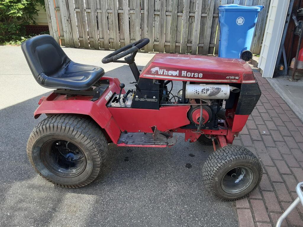

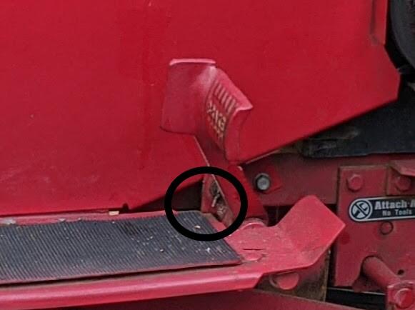

D_Mac 9,337 #5420 Posted June 22, 2020 I changed the oil, put a new air filter in. Took off the blower housing and blew out the mouse nest that was up under there. He chewed up a wire a little bit. I didnt have any heat shrink tubing for the wire so I just taped it up. Should be ok. It ran really good before hand. Tried looking at the clutch but since it isnt at my house I had to leave before I figured it out. When I press down on the clutch pedal I have to let off some or press harder to find the sweet spot before it will let me put it in or out of gear. The brake pedal leans to far forward too and the parking brake wont engage.. Need more time with it to see whats going on, See the position of the brake pedal in the photo? Suggestions? 1 Share this post Link to post Share on other sites
johnnymag3 2,647 #5421 Posted June 22, 2020 D-Mac......did something become disconnected on the brake pedal assembly? Share this post Link to post Share on other sites
D_Mac 9,337 #5422 Posted June 22, 2020 2 minutes ago, johnnymag3 said: D-Mac......did something become disconnected on the brake pedal assembly? Thats the way I picked it up. Brakes work when you press the pedal. Just the position of the pedal and the parking brake dosnt engage. The brakes do work though. Share this post Link to post Share on other sites
johnnymag3 2,647 #5423 Posted June 22, 2020 Ive never seen a pedal that far back to the drivers foot. It a very unorthodox position to try to use.... did you look to see if something broke on the pedal ? Share this post Link to post Share on other sites
Boat guy 40 #5424 Posted June 22, 2020 4 hours ago, Ed Kennell said: Boat guy, you should start a new thread in the implements section to get results on your deck question. This thread is a general thread that does not address specific questions or problems. The questions and replies get lost among all the non related chatter. To summarize what has been stated above in several posts; your mule drive pulleys are not correct there should not be a twist in the belt the blades should turn CW viewed from above all blades should be the same length...they will not hit due to the center blade being forward of the side blades If you have the blades on the spindle right side up and you have to twist the belt and make the blades turn CCW to cut, you have a left hand set of blades. Left hand blades turning CCW may cut, but they will not discharge the cuttings across the front of the deck properly and the deck belt tensioner will not work properly. Here is a pic of what your blade should look like. You can see the blade must turn CW viewed from above. Previous owner put a left hand set of blades on it.... now I understand why everything was backwards. Thank you guys I will place any questions in a different area. 1 1 Share this post Link to post Share on other sites
echris 1,426 #5425 Posted June 22, 2020 45 minutes ago, D_Mac said: I changed the oil, put a new air filter in. Took off the blower housing and blew out the mouse nest that was up under there. He chewed up a wire a little bit. I didnt have any heat shrink tubing for the wire so I just taped it up. Should be ok. It ran really good before hand. Tried looking at the clutch but since it isnt at my house I had to leave before I figured it out. When I press down on the clutch pedal I have to let off some or press harder to find the sweet spot before it will let me put it in or out of gear. The brake pedal leans to far forward too and the parking brake wont engage.. Need more time with it to see whats going on, See the position of the brake pedal in the photo? Suggestions? The brake pedal might just be a bent or misaligned footrest. Those models have a boss on the lower brake pedal that contacts the footrest as a stop. With the clutch, the belt guide on the drive belt idler pulley should lock the belt tight when depressed, preventing the tractor from creeping when in gear. I would think most likely that's the problem, the drive belt is creeping when you have it partway depressed so the trans can't shift. Share this post Link to post Share on other sites
