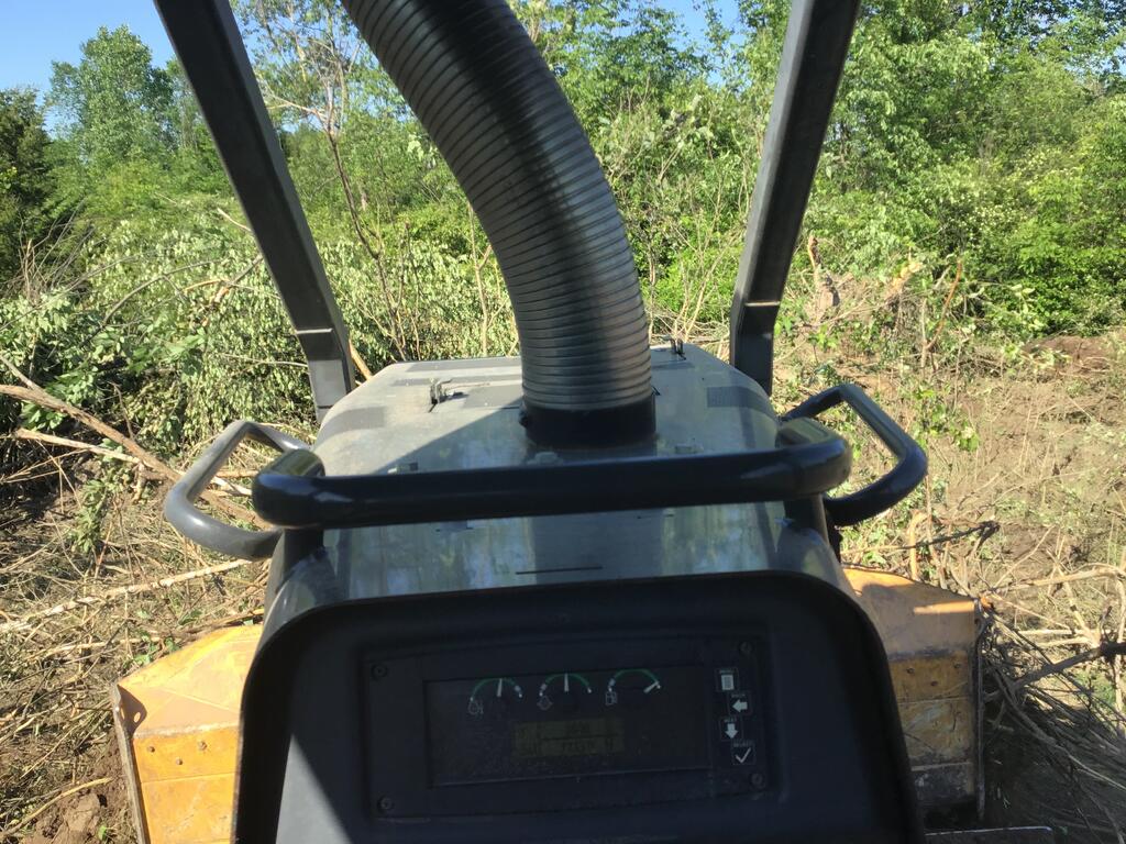

Pullstart 71,527 #5258 Posted June 16, 2020 Far from a WH... but there’s a familiarity with that of a 300 series hood.... 1 1 Share this post Link to post Share on other sites

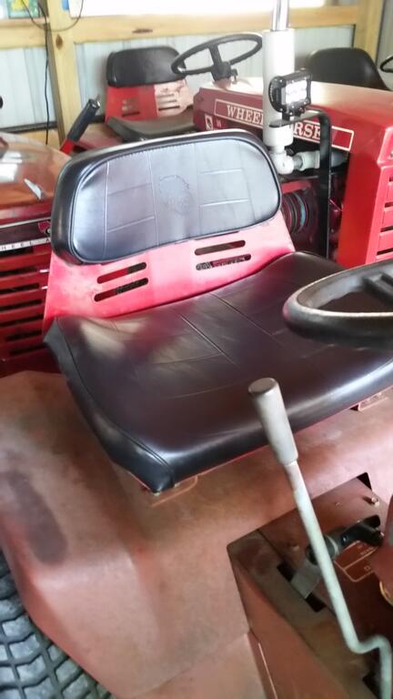

rjg854 13,423 #5270 Posted June 17, 2020 Just put on a @BOB ELLISON C-160 seat. His seats are the absolute best! 6 2 3 Share this post Link to post Share on other sites

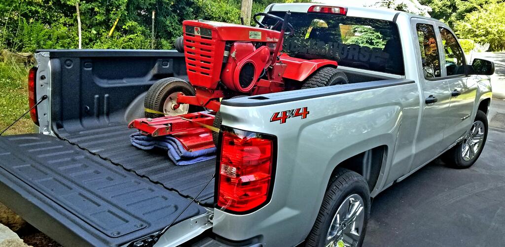

AMC RULES 37,260 #5274 Posted June 18, 2020 Loaded up the 1075 for an oh bright thirty trip up to Waterloo in the morning 2 4 Share this post Link to post Share on other sites
