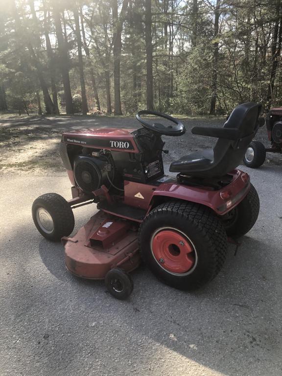

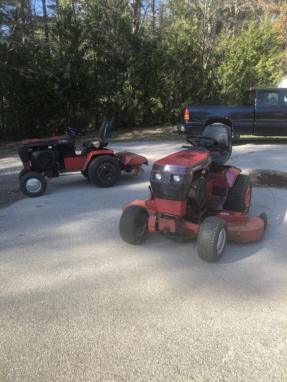

muz123 1,193 #4333 Posted April 4, 2020 Got the 36” Tiller on one 520, and the 60” on the other today. Also did some maintenance on the deck too. 6 1 1 Share this post Link to post Share on other sites

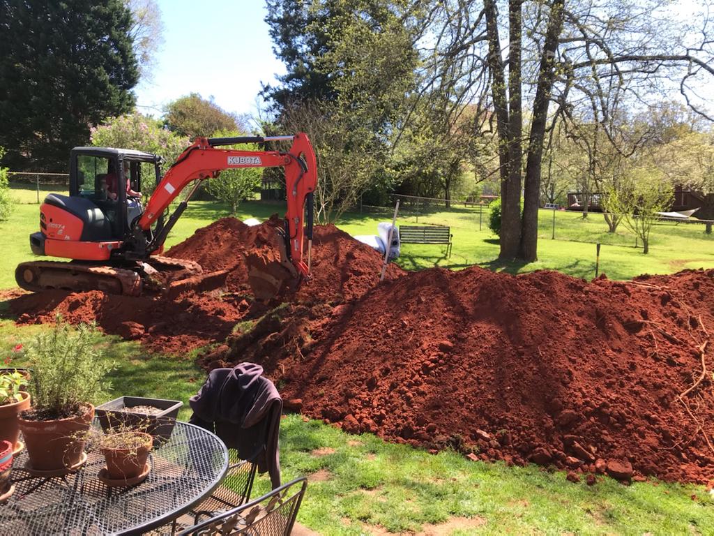

McGrew 461 #4334 Posted April 4, 2020 I had to have new septic tank drain lines installed..Oh joy! The contractor started yesterday morning, and my once relatively nice backyard is now a real mess. With 3 dogs, no grass, and lots of rain, it will be a mess for a while. I got the Raider 10/14 out and put the wheel weights and blade on it to smooth out some of the dirt after the contractor left. Pics tell the story: Danny 2 11 Share this post Link to post Share on other sites

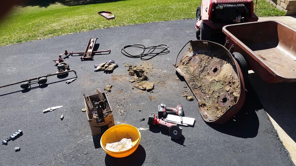

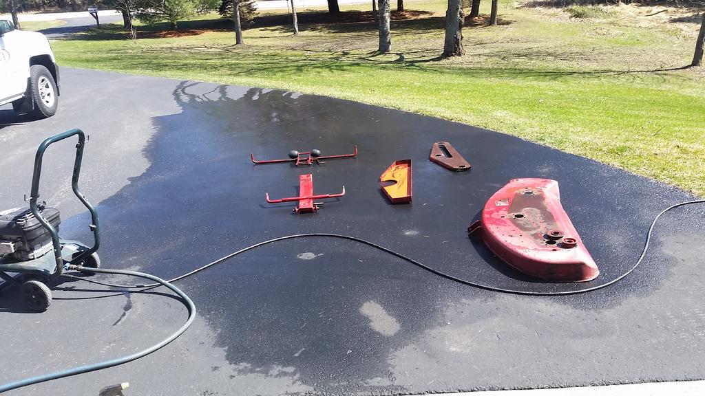

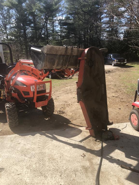

WHX?? 57,501 #4335 Posted April 4, 2020 You always run around with gals on topless tractors Kev or the other way around!?! Looks like today I and a few others worked on our tractors instead of out joyriding .. I was with Muz on deck work for a special project tractor....shut up EB ....how one can operate without a POWER WASHER not mentioning names....ahemm.. is beyond me. 1 1 8 Share this post Link to post Share on other sites

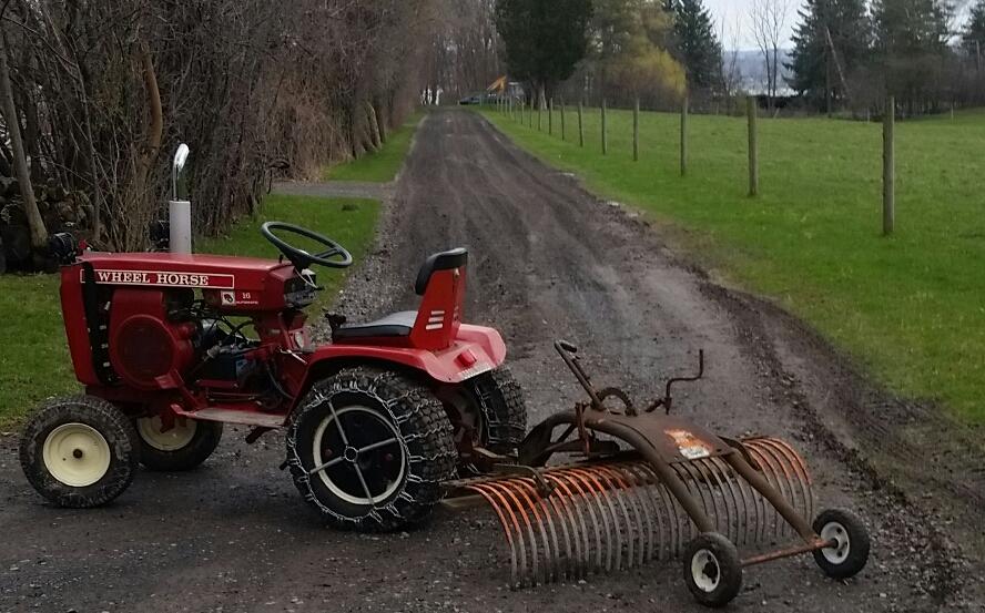

rjg854 13,214 #4336 Posted April 4, 2020 So this morning I took the snow thrower off the 16 Automatic and hooked up the york rake and regraded the driveway. Tomorrow after it has a chance to dry out a bit I plan on using the grader blade and smooth it out a bit more. 6 10 Share this post Link to post Share on other sites

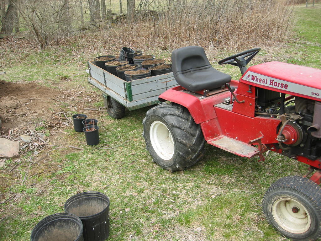

pfrederi 20,924 #4339 Posted April 5, 2020 Put the 310-8 to work hauling repotted maples out to the field. I have an area protected with an electric fence to get small trees started with out being eaten..... These were seeds I planted last spring. Now I need the smaller pots for the 50 or so Acorns I got from my red oak last fall and kept in the refrigerator all winter. Thye are just about all sprouting. 9 4 2 2 Share this post Link to post Share on other sites
