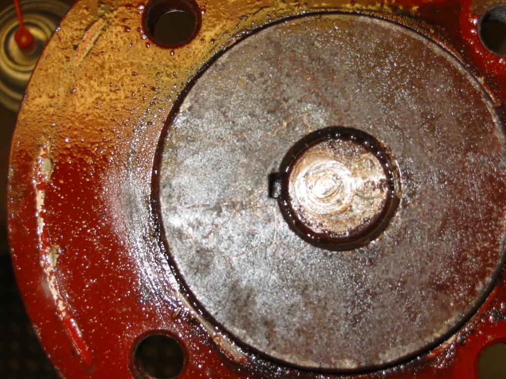

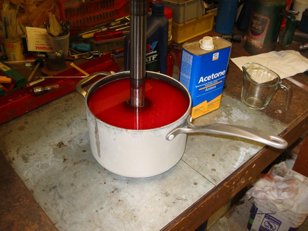

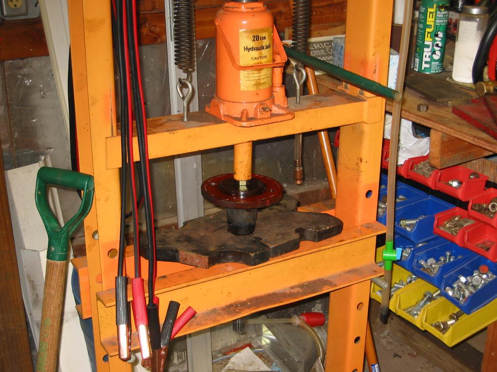

pfrederi 21,246 #3901 Posted January 17, 2020 (edited) Soaking time. I do not want to chance something getting broken in the 20 ton press..the hub, the axle, the press or me.... I did try pounding some to push the hub in...nada.... Somebody left a couple qts of Mercon here a long time ago. no Fords in my future so that some acetone and we shall see what happens Edited January 17, 2020 by pfrederi 4 3 Share this post Link to post Share on other sites

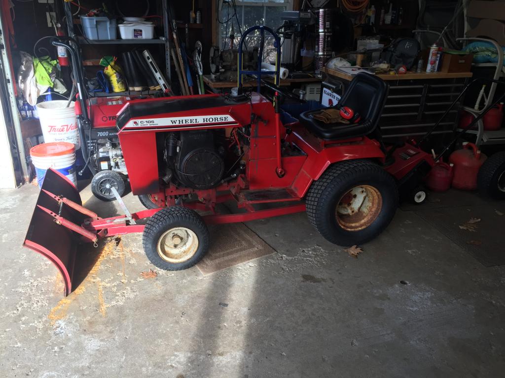

8ntruck 9,356 #3906 Posted January 18, 2020 Turned out that we got done at the Secretary of State's office a little sooner than we expected today. We got our paperwork filed to make our 'alternate location' our 'primary location'. We are Michigan residents now and the Missouri property is now in project status instead of residence status. I had a little shop time for the Wheel Horse today. Got the rear Tach-a-Matic off and more accurately measured for my receiver hitch project. We still need to go back to our Missouri property to keep that project moving along. While I am there, I'll get the receiver hitch CADDed up and, eventually, fabbed. If everything works out, I'll post a PDF file of my drawings. 1 2 Share this post Link to post Share on other sites

Ed Kennell 47,688 #3909 Posted January 18, 2020 21 hours ago, pfrederi said: Soaking time. I do not want to chance something getting broken in the 20 ton press..the hub, the axle, the press or me.... I did try pounding some to push the hub in...nada.... Somebody left a couple qts of Mercon here a long time ago. no Fords in my future so that some acetone and we shall see what happens Reminds me of a soup I had in Graz, Austria a few years ago. Swines Axle Soup ….It was basically a bowl of warm lard with an entire pigs foot (axle) sitting in the middle. I did my best to consume it so as not to upset my host. May be you should put your soup on simmer for a ew days Paul. 2 1 3 Share this post Link to post Share on other sites

pfrederi 21,246 #3912 Posted January 18, 2020 24 hours of soaking = Nada Glad this isn't a rush project 2 1 Share this post Link to post Share on other sites

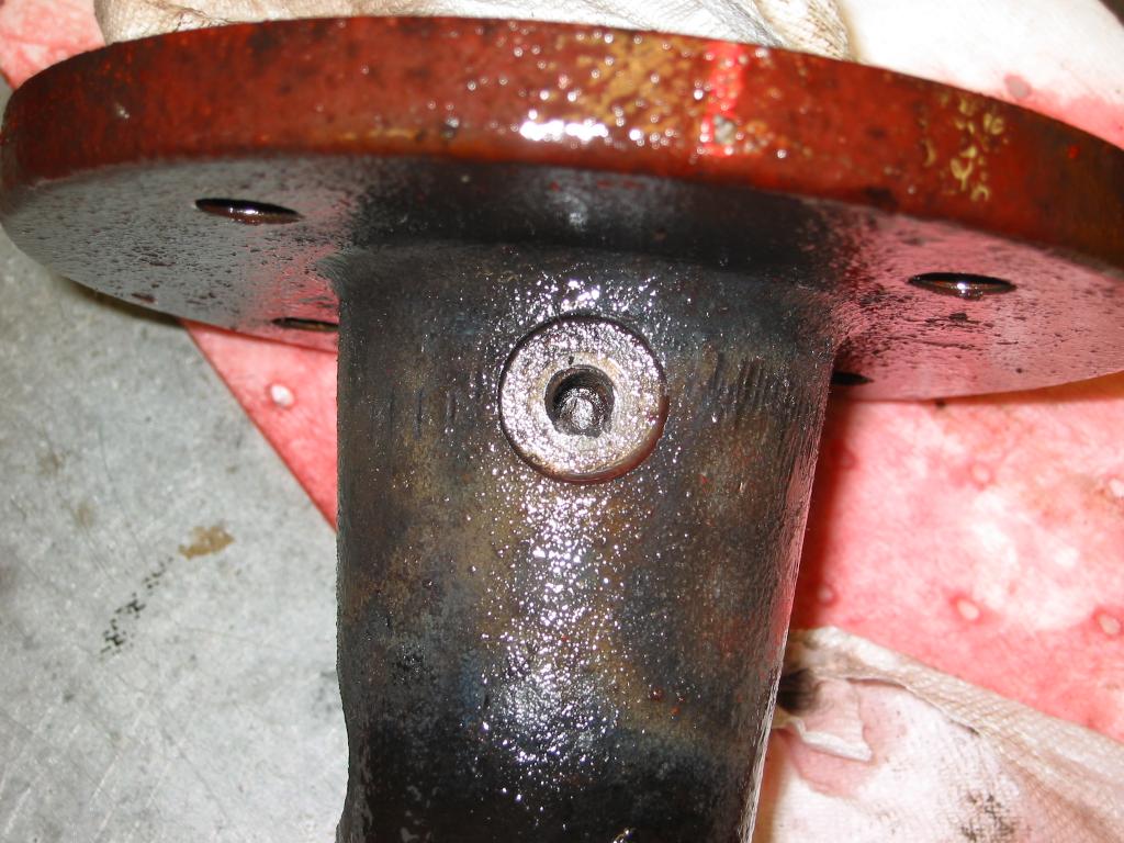

lynnmor 9,054 #3913 Posted January 18, 2020 39 minutes ago, pfrederi said: 24 hours of soaking = Nada Glad this isn't a rush project Can you see if the key lines up with the set screw looking in the tapped hole? If the key has wore to the side of the hole, the press would need to broach the groove all the way out. If you can see that is the case, then the hub will need to be rotated to the correct alignment before pressing. 1 Share this post Link to post Share on other sites
pfrederi 21,246 #3914 Posted January 18, 2020 12 minutes ago, lynnmor said: Can you see if the key lines up with the set screw looking in the tapped hole? If the key has wore to the side of the hole, the press would need to broach the groove all the way out. If you can see that is the case, then the hub will need to be rotated to the correct alignment before pressing. Looking in the keyway setscrew hole you can see the clean circle cut in the key by the setscrew...Looks undisturbed. Looking from the end of the hub the key looks centered in the keyway slot of the hub. 2 Share this post Link to post Share on other sites

pfrederi 21,246 #3916 Posted January 18, 2020 4 minutes ago, lynnmor said: Did you try pressing in the opposite direction to see if it will move a bit? While I had it standing up in the vice to look in the hub key way I wapped a few time with a sledge. No super hard but sharply. no movement.I had a bit of padding under the spline end of the axle. I am a bit hesitant ot press on the splined end of the axle. do not want to mess up the splines. I actually have a spare NOS hub but no spare axle so if something has to get damaged.... 1 Share this post Link to post Share on other sites
lynnmor 9,054 #3917 Posted January 18, 2020 Just now, pfrederi said: While I had it standing up in the vice to look in the hub key way I wapped a few time with a sledge. No super hard but sharply. no movement.I had a bit of padding under the spline end of the axle. I am a bit hesitant ot press on the splined end of the axle. do not want to mess up the splines. I actually have a spare NOS hub but no spare axle so if something has to get damaged.... I agree with protecting the axle, perhaps you could use a piece of copper or aluminum and put in the press. Share this post Link to post Share on other sites
pfrederi 21,246 #3918 Posted January 18, 2020 1 minute ago, lynnmor said: I agree with protecting the axle, perhaps you could use a piece of copper or aluminum and put in the press. Good suggestion thank you Back into soak. I have to look through my junk somewhere i have a chunk of brass to use a cushion... Share this post Link to post Share on other sites

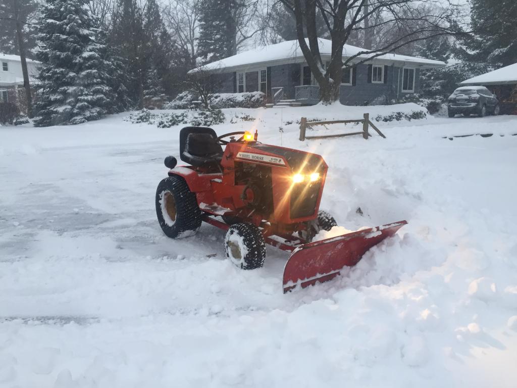

SylvanLakeWH 32,732 #3923 Posted January 18, 2020 Tank of gas and a wee bit of oil after plowing 4 driveways worth of Michigan sunshine!!! 2 5 1 Share this post Link to post Share on other sites
