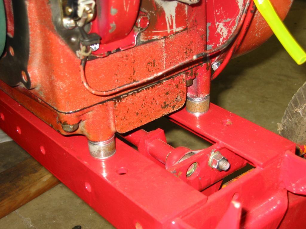

pfrederi 21,246 #3652 Posted December 6, 2019 1 hour ago, MikMacMike said: Most definately, the left side will have one also for adjusting clutch brake. Hmmmm reminds me, down the road I have to ask you about what you said pertaining to separate peddles for clutch n brake. Also on the right side to access the drive belt. How I wanted to ask, I have the Kseries 301, Im sure it has the deep oil pan and I think they came with a shallow and a deep??? Why Im asking is Ive seen pics of a flat motor mount that has the sides raised to which the rubber motor mounts bolt to. I need to know how much higher this puts the engine, or does everyone just mount there motors to the frame like mine is? If you want to use a shallow pan engine, the type used in isolation mount (rubber pads) you will need some spacers if you want to bolt directly to the frame. 3/4" lift is needed. I used the spacers from a C81 (1/2") plus 3 SAE washers. 2 2 Share this post Link to post Share on other sites

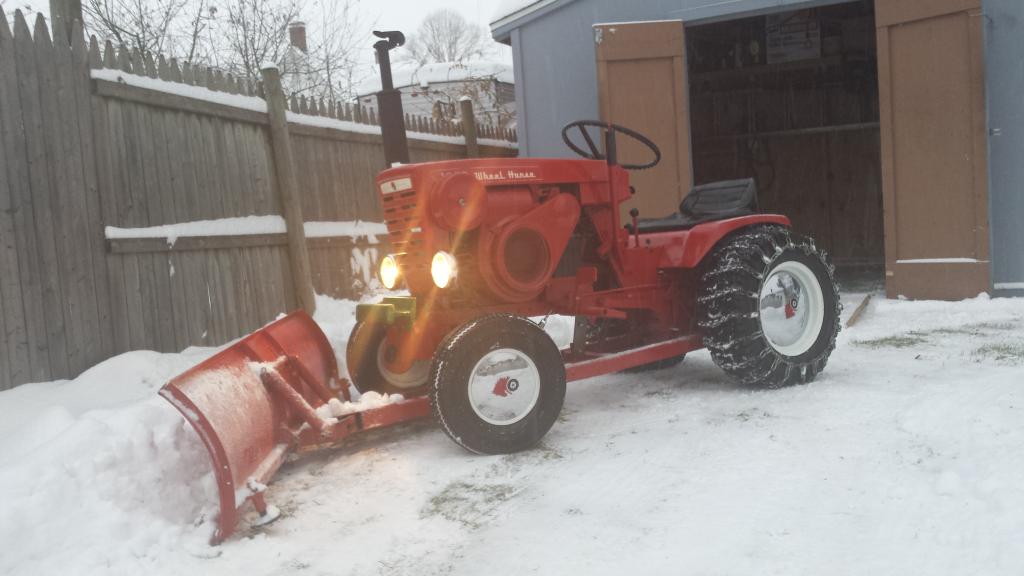

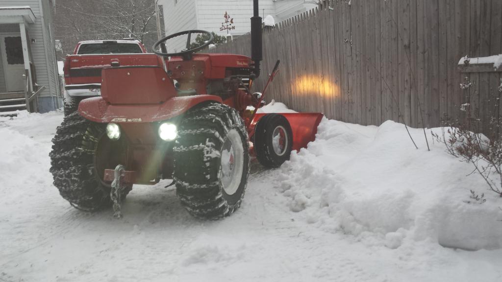

Thegearhead0324 1,859 #3654 Posted December 6, 2019 Used my ol 1257 to plow my driveway and yard third time this season. Makes it real enjoyable ridin the ol girl, definitely faster than my little snowblower. 2 8 1 Share this post Link to post Share on other sites

pfrederi 21,246 #3657 Posted December 6, 2019 1 hour ago, Thegearhead0324 said: Used my ol 1257 to plow my driveway and yard third time this season. Makes it real enjoyable ridin the ol girl, definitely faster than my little snowblower. Like the back up lights... cool 3 Share this post Link to post Share on other sites

Thegearhead0324 1,859 #3659 Posted December 6, 2019 18 minutes ago, pfrederi said: Like the back up lights... cool Thanks, yea they light up the whole back end at night, easier to see backing up. Still got original WH tires, next year they'll need replacing. Share this post Link to post Share on other sites

MikMacMike 494 #3662 Posted December 7, 2019 10 hours ago, pfrederi said: If you want to use a shallow pan engine, the type used in isolation mount (rubber pads) you will need some spacers if you want to bolt directly to the frame. 3/4" lift is needed. I used the spacers from a C81 (1/2") plus 3 SAE washers. 1 Share this post Link to post Share on other sites
MikMacMike 494 #3663 Posted December 7, 2019 Hmmmmm definately a nice clean setup....I took a screen shot of your setup and filed it under Engine mounts thanks pfrederi. Share this post Link to post Share on other sites

MikMacMike 494 #3667 Posted December 7, 2019 Thanks boys and duely noted, I did see one WH on you tube and yes I see what you mean....at the top of the engine ( the head area) I saw how much the shacking was. Wow like 1/4" each way. Yes I think Ill just use a 3/8" or more then likely a 1/2" plate and mount it solid.....then I can stay with the larger size oil pan too. Share this post Link to post Share on other sites
