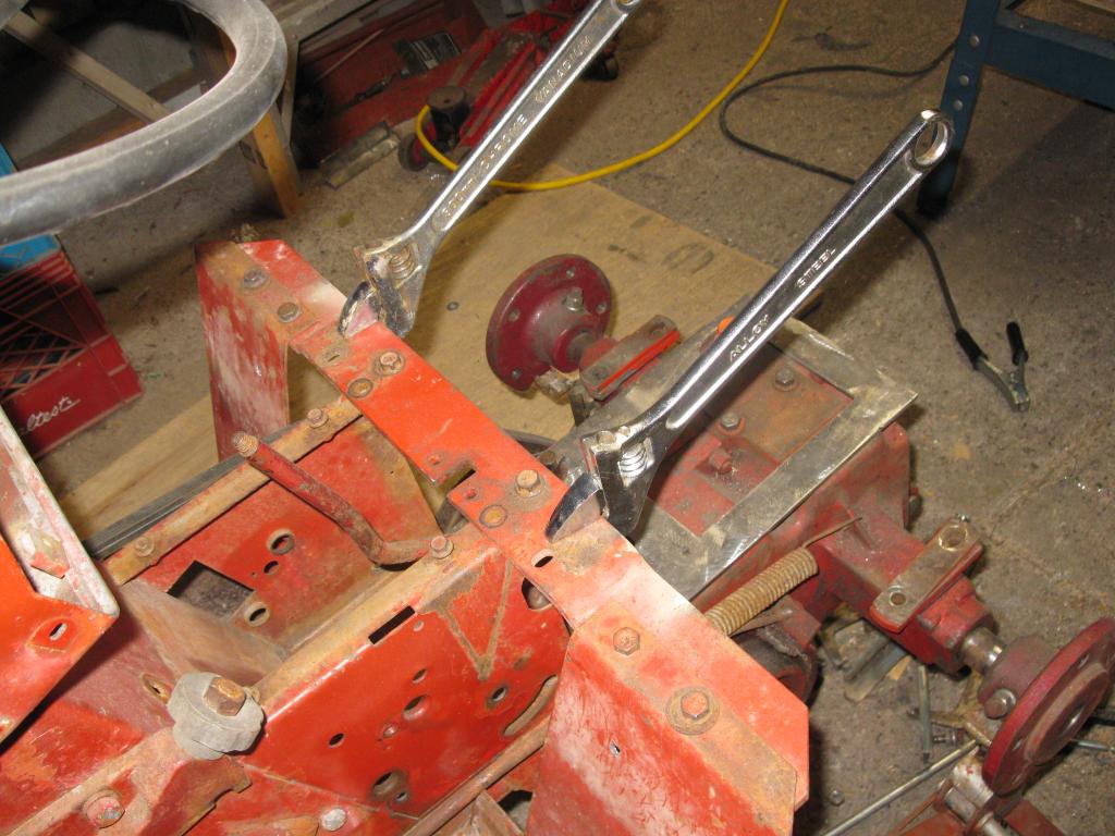

balconio 606 #3626 Posted December 4, 2019 2 hours ago, MikMacMike said: Hello baconio, Sure no problem, at the moment ive got (lets call it the spacer cage) it apart because everything was just tacked together. Today Ill be welding it proper. But what Ill do is once its together I can show you in more detail. I havnt raised the steering wheel as of yet but I will say the steering wheel will be much easier. I too was far too close with the foot rests. I dont know if your machin has the same cross bar that attaches the foot rests and if it does I noticed that the foot restsmounted under that cross bar. So I unbolted the top and left the bottoms bolted in place for alignment. I carefully bent the foot rests upwards so as to mount on top of the cross bar. So the bolt holes to match back up I only bolted the cross bar to the foot rest NOT the center consle. this puts the cross bar on an angle toward the front of the tractor. Using 2 very large adjustable wrenches I pulled the cross bar back to a straight position (horizontal). Now youll notice the bolt holes where the crossbar mounts to the center consle doesnt align. But alas it only moves it about 1". I marked the holes from underneath, drilled them and voila it all came together. As for making a latch to keep the seat body and fenders closed, I havnt gotten to that point yet. 1st pic is the origonal position, as you can see I gain a sheesh load of room to where I am locating the gas tank by switching to 8 speed from hydro. If I run hydrolics Id rather run a proper pump right off the engine instead of tapping into the sunstrand. Pic 2 you can see the foot rest is now mounted above the cross bar. I just made sure when I was bending that the both footrests were still atached so as to make sure of alignment. pic 3 you can see in the upper right corner. The bolts are 1 " back on the cross bar. In fact its the cross bar that moves 1" forward. This gives me a ton of room. I hope this helps. These tires Im using as soon as you put anything around 10 to 18 lbs of air pressure the expand tremendously, plus in that state they dont have the wide look I wanted, an undersight on my part. But at 5 psi they settle down in size and look great. I just hope it all works or its back to the drawing board, LOL. I'll be honest I'm only at the "thinking thru stuff" stage at this point and haven't unbolted any of the bodywork or started modding yet. Now that i think of it- it'd be a shame to cut up the original tins if there's a better way. Thx for sharing your ideas and pics! Share this post Link to post Share on other sites

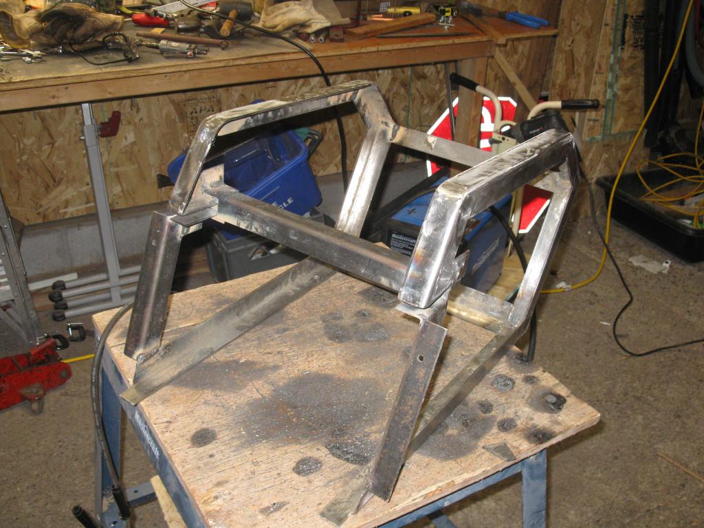

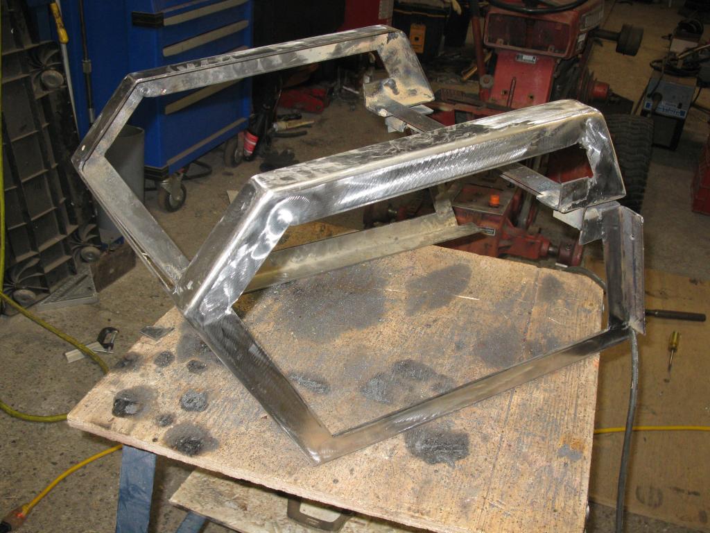

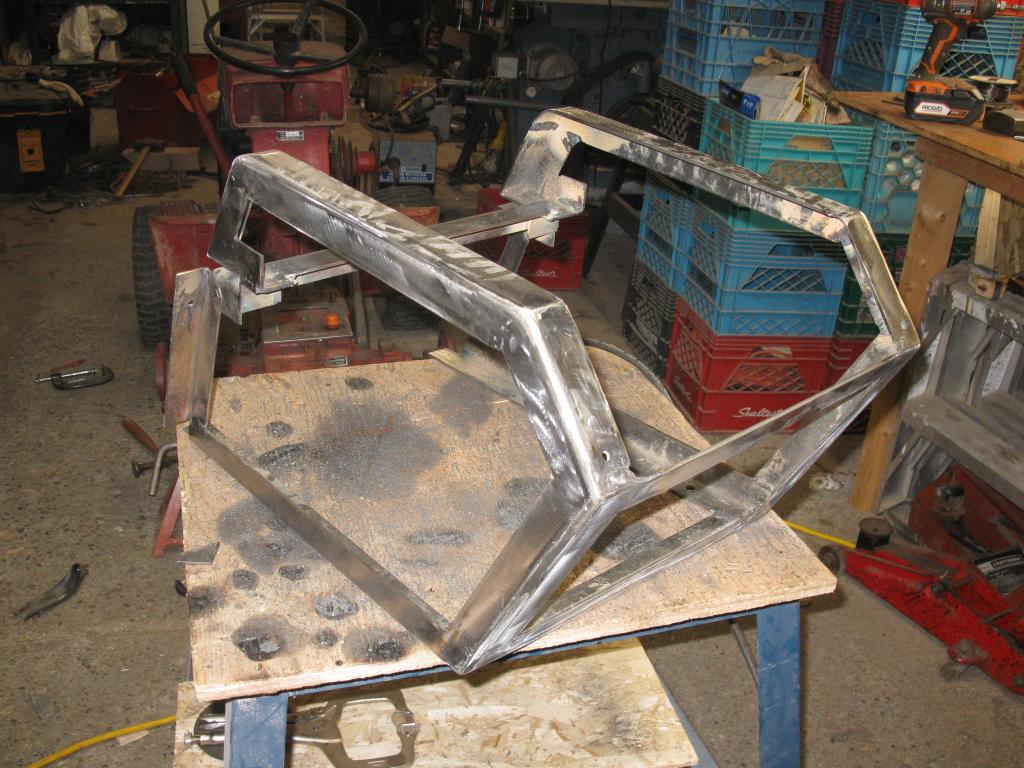

MikMacMike 494 #3627 Posted December 5, 2019 yuppers exactly what I thought too. Thats why I just tweeked everything instead. Just in case I decided to bring it back to a hydrostat. I didnt have to cut one peice the way I did it too. Heres a pic of how I put the feet rests on top of the cross bar. When I get the wheels back on Ill show you the clearance. 1st pic is how I massaged it to fit....with 2 adjustable wrenches. I can always put it back to origonal that way. 2nd pic...I just finished welding it up 2 minutes ago, welded my own filler structure to raise the sheet metal roughly 2.5 to 3 inches. I can always just remove this peice and reinstall the origonal sheet metal under the seat. Took me all day to weld it nice and accurate. wew havnt eaten all day, time for dinner 1 Share this post Link to post Share on other sites
MikMacMike 494 #3628 Posted December 5, 2019 Well I got the filler structure all welded up....took me from 7:30 am till now. Its all nice in accurate too whahhh so glad. Sheet metal work I hope tomorrow, covering the structure to keep the dirt out. 4 1 Share this post Link to post Share on other sites
ebinmaine 80,438 #3629 Posted December 5, 2019 @MikMacMike. Wicked nice work.... Share this post Link to post Share on other sites
MikMacMike 494 #3630 Posted December 5, 2019 Well Thankyou Ebinmaine. I tacked it well but the real test will be tomorrow, will see if it pulled in any direction when I welded it heheheh, should be pritty good fit. 1 Share this post Link to post Share on other sites
balconio 606 #3631 Posted December 5, 2019 4 hours ago, MikMacMike said: yuppers exactly what I thought too. Thats why I just tweeked everything instead. Just in case I decided to bring it back to a hydrostat. I didnt have to cut one peice the way I did it too. Heres a pic of how I put the feet rests on top of the cross bar. When I get the wheels back on Ill show you the clearance. 1st pic is how I massaged it to fit....with 2 adjustable wrenches. I can always put it back to origonal that way. 2nd pic...I just finished welding it up 2 minutes ago, welded my own filler structure to raise the sheet metal roughly 2.5 to 3 inches. I can always just remove this peice and reinstall the origonal sheet metal under the seat. Took me all day to weld it nice and accurate. wew havnt eaten all day, time for dinner Aren't those the best work days though? The ones where you're so amped about what you have going on in the shop that you forget about silly things like time, and eating. Nice work, I can't wait to see how it all fits together 3 Share this post Link to post Share on other sites

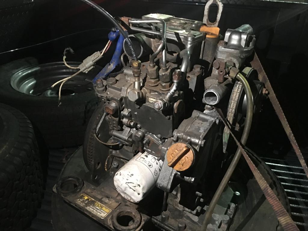

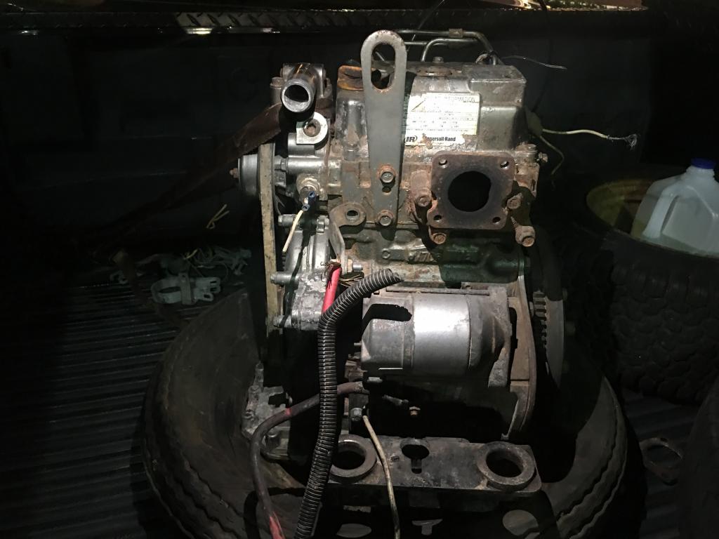

19richie66 17,932 #3642 Posted December 6, 2019 Well It ain’t a wheel horse but it’s going in one.......somehow. 2 5 Share this post Link to post Share on other sites
ebinmaine 80,438 #3643 Posted December 6, 2019 Whatcha got there Richie???? 1 Share this post Link to post Share on other sites
balconio 606 #3644 Posted December 6, 2019 Looks like a 2cyl deesil of some sort? I see an Ingersoll Rand sticker- must be industrial strength! 1 Share this post Link to post Share on other sites
19richie66 17,932 #3645 Posted December 6, 2019 Ingersall Rand Yanmar diesel from a Semi APU. Should power a tractor pretty good. Accidental craigslist find. 2 1 2 Share this post Link to post Share on other sites
