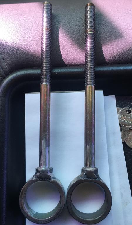

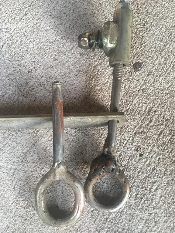

19richie66 17,937 #3379 Posted October 23, 2019 (edited) Made some new lift links today for the Xi. The crap that was in there had to go. Hopefully these will hold up another 10-15 years. Edited October 24, 2019 by 19richie66 4 4 Share this post Link to post Share on other sites

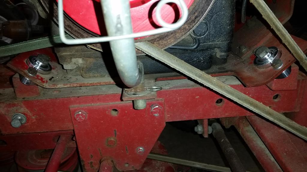

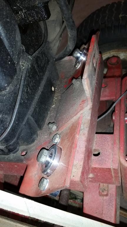

WHX?? 58,308 #3380 Posted October 24, 2019 (edited) Nice Ritchie ... that work makes me look small potatoes. Bolted up a set of Zach Kerber solid mounts on a new to me C-145. Not as easy as it looks tho. Tip... enlarge the 1/4 holes slightly on the shaker plate. Was a bear getting the bolts all lined up with the motor in frame. Sold as a rock now tho. Before when you engaged the PTO the motor would move back a 1/2 inch. No more. Edited October 24, 2019 by WHX24 5 2 1 Share this post Link to post Share on other sites
19richie66 17,937 #3381 Posted October 24, 2019 (edited) Them mounts should last a while Jim. Zac Kerber makes some nice stuff. I like potatoes Edited October 24, 2019 by 19richie66 1 4 Share this post Link to post Share on other sites

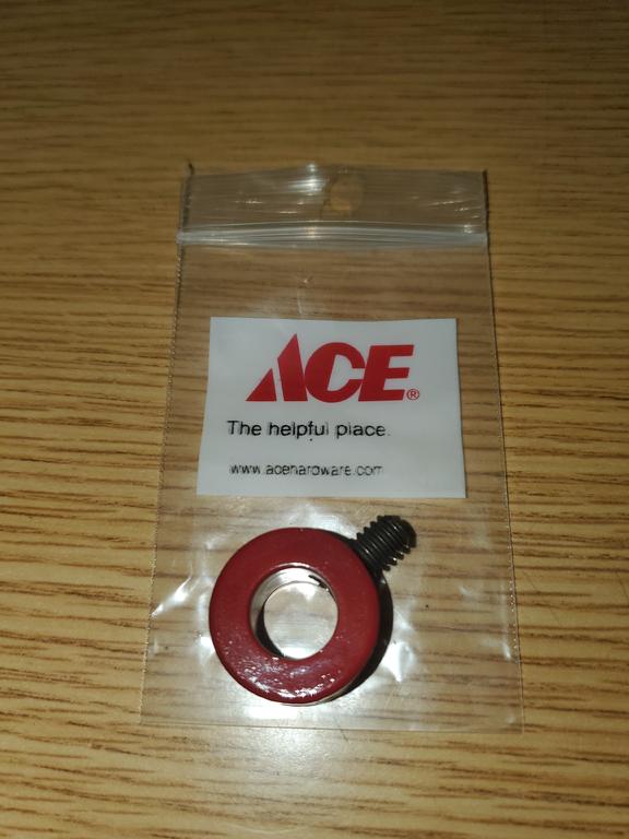

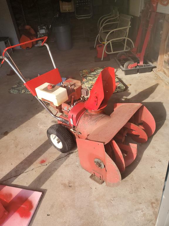

12Horse Paladin 1,038 #3382 Posted October 24, 2019 (edited) Well, it's as far as i got this year....she's been gone completely through, and partially painted. Hoping to get a decal set and complete repaint next year, depending how she works out this yr. A one pull starter, i'm bettin she'll throw the white stuff just fine😁...i am hoping🤔🤣 ...i included a pic of what is called the collar to ask for help. The parts/instruction manual isnt very clear. I kno it goes on the clutch rod...but where??? It was just riding at the bottom of it, loose, when i got it. Thats why the ACE baggie...had to buy the missing set screw.🤣 Edited October 24, 2019 by 12Horse Paladin Wording 4 Share this post Link to post Share on other sites

WHX?? 58,308 #3384 Posted October 25, 2019 9 hours ago, 12Horse Paladin said: Well, it's as far as i got this year....she's been gone completely through, and partially painted. Hoping to get a decal set and complete repaint next year, depending how she works out this yr. A one pull starter, i'm bettin she'll throw the white stuff just fine😁...i am hoping🤔🤣 ...i included a pic of what is called the collar to ask for help. The parts/instruction manual isnt very clear. I kno it goes on the clutch rod...but where??? It was just riding at the bottom of it, loose, when i got it. Thats why the ACE baggie...had to buy the missing set screw.🤣 Looks like just a 3/4 bearing collar guy. Would think it more belongs on a axle or auger shaft or something?? Some of those older Tecumsehs on blowers just ran forever and always started good. Got one on an old inherited old POS MTD. And always starts first or second. 1 Share this post Link to post Share on other sites
12Horse Paladin 1,038 #3385 Posted October 25, 2019 (edited) 9 minutes ago, WHX24 said: Looks like just a 3/4 bearing collar guy. Would think it more belongs on a axle or auger shaft or something?? Some of those older Tecumsehs on blowers just ran forever and always started good. Got one on an old inherited old POS MTD. And always starts first or second. Sorry, but although i cant down load the page of my manual, it is shown as part #110 on the schematic, on the clutch rod...and that is also where i found it, loose, when i got it, originally... You are very right about the older Tecumsehs. This is a HM70; my Ariens an HM80. Both made in 1973 i've found out. Must have been a good year...👍 And i came along in '74🤣 Edited October 25, 2019 by 12Horse Paladin 1 Share this post Link to post Share on other sites
gwest_ca-(File Mod) 12,511 #3386 Posted October 25, 2019 10 hours ago, 12Horse Paladin said: Sorry, but although i cant down load the page of my manual, it is shown as part #110 on the schematic, on the clutch rod...and that is also where i found it, loose, when i got it, originally... You are very right about the older Tecumsehs. This is a HM70; my Ariens an HM80. Both made in 1973 i've found out. Must have been a good year...👍 And i came along in '74🤣 Posted a reply on your original post Garry 1 Share this post Link to post Share on other sites

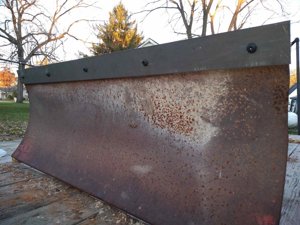

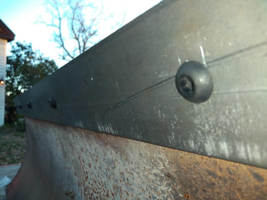

Achto 32,857 #3392 Posted October 25, 2019 Winter is on it's way!! I have a gravel driveway so I have my blower set to leave about an inch or so of snow behind. Now that I have a new side walk to maintain I wanted an easy way to keep it scrapped clean after I run over it with the blower. Today I made a new wear bar for my recently acquired push plow. I did a lot of research, and would you believe that they don't make a drill bit that will drill a square hole so a guy can use carriage bolts?!?!? Given this fact and the fact that I don't have a broach to cut the square holes, I decided to make things easy on myself and bolt the wear bar on with button head bolts. Now I have to get the blade sandblasted & painted so that snow will not stick to it. Also need to decide if I want to paint the plow frame right away or if I'm going to just leave it the way it is. 9 Share this post Link to post Share on other sites
ebinmaine 81,000 #3393 Posted October 26, 2019 2 hours ago, Achto said: cut the square holes Dan they have these things called files. They file stuff. Like if ya wanted to make a round hole say.... Squared off? 1 3 Share this post Link to post Share on other sites
Tractorhead 9,217 #3394 Posted October 26, 2019 Or maybe a cnc mill.. 1 Share this post Link to post Share on other sites
Stormin 9,988 #3395 Posted October 26, 2019 44 minutes ago, Tractorhead said: Or maybe a cnc mill. I'll stick to a square file. A bit cheaper. 6 Share this post Link to post Share on other sites
Tractorhead 9,217 #3396 Posted October 26, 2019 1 hour ago, Stormin said: I'll stick to a square file. A bit cheaper. You‘re right, but not that comfortable 😂😂😂😂 1 Share this post Link to post Share on other sites
Achto 32,857 #3397 Posted October 26, 2019 All the above is true. The button heads don't stick out any more than carriage bolts. Plus I just couldn't see putting the extra work into a consumable item. 3 1 Share this post Link to post Share on other sites
