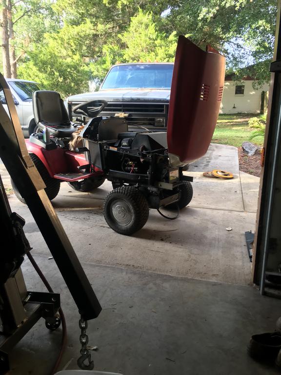

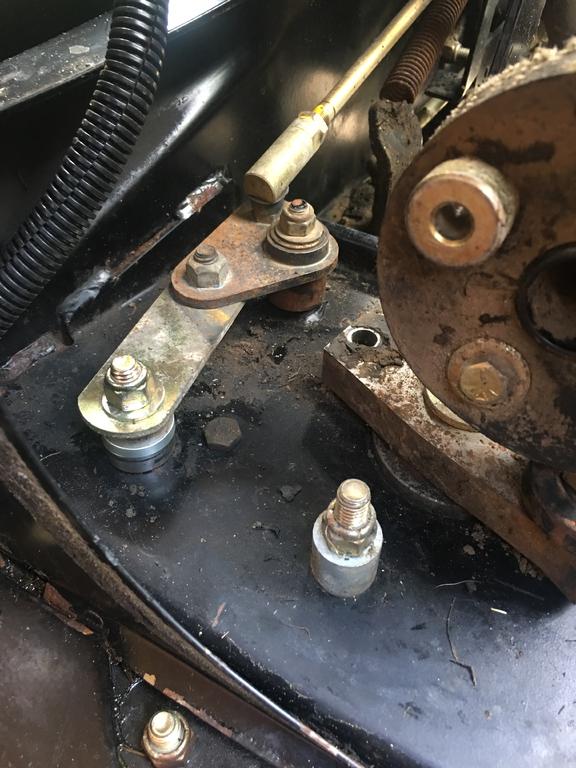

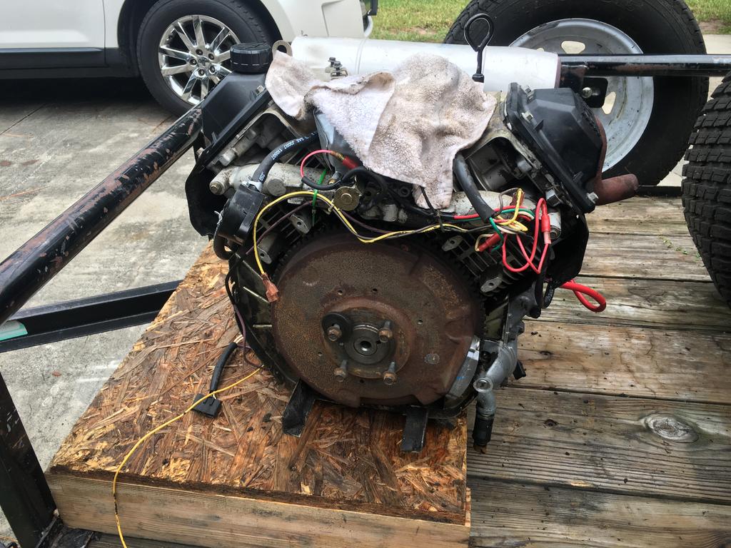

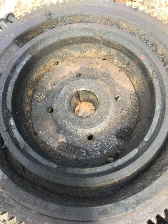

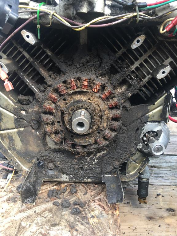

19richie66 17,937 #3354 Posted October 22, 2019 Pulled the engine from the 522xi and replaced both coils. Popped the flywheel off to check it and glad I did. Cleaned all the mud/grass out of it, blew out the fins, checked the magnets. Replaced the front steering cylinder bolt, put a missing lock nut on the rear of the steering cylinder and deleted the “smart steer” function while I was in there. Everything got a good cleaning. Found a couple other things to fix but haven’t got that far yet. 3 10 Share this post Link to post Share on other sites
PeacemakerJack 11,080 #3355 Posted October 22, 2019 Looks good Richie...those Xi’s are pretty beastly aren’t they? You took care of a lot of important little items that can and would affect the reliability/functionality of the tractor. How does the wiring look on that particular machine. I know that Kelli’s D has a harness similar to a small car. As long as it is good shape though, it should keep functioning fine. 2 Share this post Link to post Share on other sites
WHX?? 58,308 #3356 Posted October 22, 2019 That's usually my dilemma Ritchie... to pop the fly wheel and clean behind it or not. Usually do and usually glad I did. Crazy not to on a beast like that. 3 Share this post Link to post Share on other sites
lynnmor 9,053 #3357 Posted October 22, 2019 5 hours ago, 19richie66 said: Pulled the engine from the 522xi and replaced both coils. Popped the flywheel off to check it and glad I did. Cleaned all the mud/grass out of it, blew out the fins, checked the magnets. Replaced the front steering cylinder bolt, put a missing lock nut on the rear of the steering cylinder and deleted the “smart steer” function while I was in there. Everything got a good cleaning. Found a couple other things to fix but haven’t got that far yet. Is that oil coming from the crankshaft seal? It would be great if that were stopped so that the dirt doesn't accumulate. 1 Share this post Link to post Share on other sites
19richie66 17,937 #3358 Posted October 22, 2019 18 minutes ago, lynnmor said: Is that oil coming from the crankshaft seal? It would be great if that were stopped so that the dirt doesn't accumulate. Actually the seal was dry with just dirt and grass there. Does look suspiciously oily. The breather tube up top was split and oil running down the front of the engine. Yeah I know I’ll probably regret not changing it but kinda in a predicament to get it going and not having it sit too long. Didn’t have my seal here and no mower shops had any. Oh well. It should be good for a while. Give me something else to do once I get moved. 1 Share this post Link to post Share on other sites

19richie66 17,937 #3361 Posted October 23, 2019 5 hours ago, ZXT said: Find yourself an aluminum 5.3 and it might be able to handle it! How do you like the XI? I've never paid them much attention, but I came across a 522XI for $350 the other day and regretfully someone saw it before I did.. Now I'm starting to wonder what I missed out on! It seems to be a beast. Power steering, hi/low transmission. I put wider back wheels and tires on mine. Still finding loose bolts here and there. The deck lift links seem to be a weak item. Both of mine are broken. I will be making some stronger ones. A lot of little items from use over the years. I think I’m going to love it once it is all spiffed up. If you can find a nicer version someone has taken care of and get it, I think you would be happy with it. 4 Share this post Link to post Share on other sites

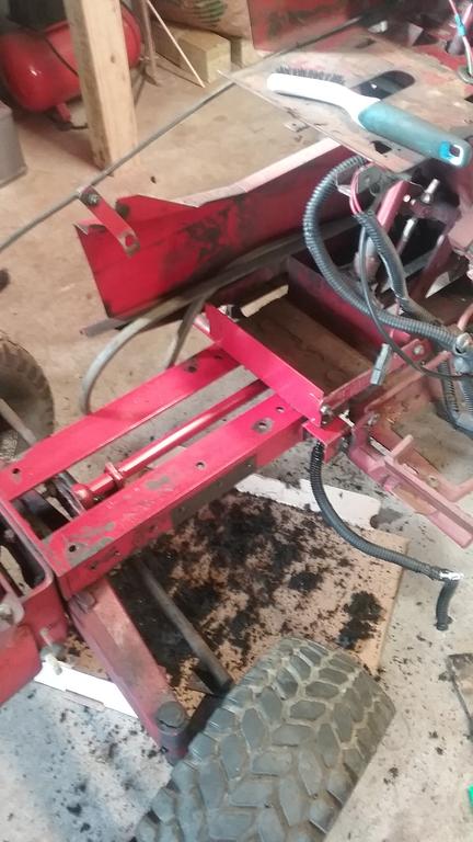

RetroMower 350 #3375 Posted October 23, 2019 Call me weird but I love a hidden, greasy, gooey area that hasn't seen the light of day in many moons. Bolts aren't rusted and i finally get a glimpse at original wheelhorse red. And yes, this creative "wiring" needs replacing 2 Share this post Link to post Share on other sites
