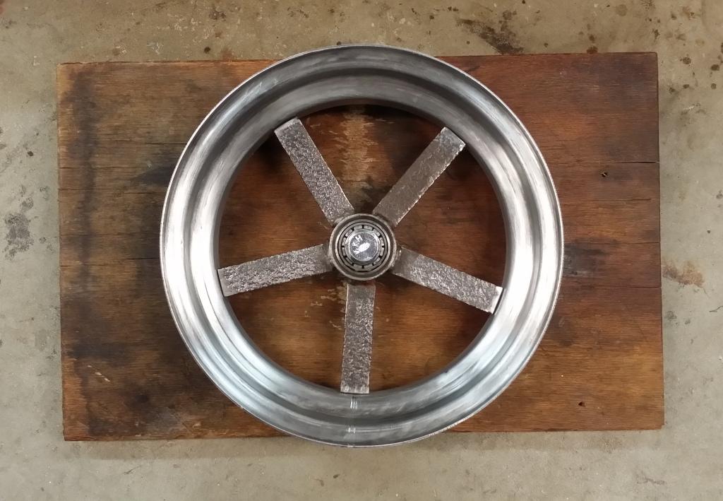

VinsRJ 724 #3231 Posted October 9, 2019 Just about ready to weld up the new hoops for my Senior's front rims... 5 7 Share this post Link to post Share on other sites
19richie66 17,937 #3232 Posted October 9, 2019 1 minute ago, VinsRJ said: Just about ready to weld up the new hoops for my Senior's front rims... Looks fantastic! 2 Share this post Link to post Share on other sites
WHX?? 58,308 #3233 Posted October 9, 2019 Those the orginal pitted spokes Vin? Share this post Link to post Share on other sites
oliver2-44 11,787 #3234 Posted October 9, 2019 (edited) Speedy recovery 953. Ive had both hand done and it was a great improvement for my hands Edited October 9, 2019 by oliver2-44 2 1 Share this post Link to post Share on other sites
VinsRJ 724 #3235 Posted October 9, 2019 (edited) 1 hour ago, WHX24 said: Those the orginal pitted spokes Vin? Yes... I'm going to tack the centers in place, spin the rims to make sure they spin true and then burn them in permanently, I'l sand blast the whole wheel, etch prime and the fill the pits with some body filler... I'll have the vids up shortly of the whole process and restore/refurb of the tractor on YouTube Edited October 9, 2019 by VinsRJ 2 4 Share this post Link to post Share on other sites
WHX?? 58,308 #3236 Posted October 9, 2019 (edited) 59 minutes ago, VinsRJ said: Yes... I'm going to tack the centers in place, spin the rims to make sure they spin true and then burn them in permanently, I'l sand blast the whole wheel, etch prime and the fill the pits with some body filler... I'll have the vids up shortly of the whole process and restore/refurb of the tractor on YouTube I guess I ain't been following your work on the tube as I should Vin my bad .... fact is last ime I followed you was on the fence to resto or orginal on this one. Sounds like you are going the resto route on this gem. For what it's worth i would consider it sacriledge to fill in those pits with BF but these clowns here have me washed on original these days. I would think of a way to pit those rims to match. Even with new paint those pits have a way of shining through and saying I am old stuff. I have chewed Dan's @ss @Achto about not not filling in spot weld dimples on his restos but he likes them so be it . But I get your dilemma. Good luck on whatever trail you go down. Please do keep us posted. Edited October 9, 2019 by WHX24 10 Share this post Link to post Share on other sites

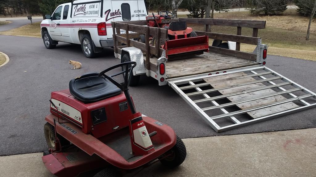

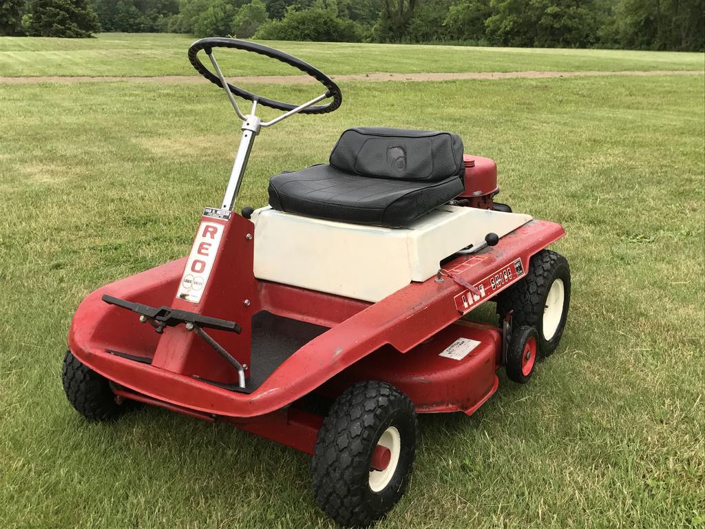

LittleRed 51 #3237 Posted October 10, 2019 On 10/7/2019 at 7:31 PM, D_Mac said: Well its been a long road for this little REO but its finally running, moving, and mowing as it should. I bought it almost two years ago. Running and driving before I loaded it onto my truck. Stopped at a friends house to show him. I had to talk him into unloading it to drive it around his yard. Well we unloaded it, he got on and drove it like 25 yard where the transmission locked up. So after my cancer treatment we finally got around to cracking the transmission open to find out what the problem was. Bad bearings and a broken shift fork. Found the parts and never having seen the inside of a transmission before was able to get everything installed and back together. When that was done took the carb off and soaked it and got a rebuild kit. Well its all back together again and to my surprise working as it should ! Did a quick clean up on it but for being all original and 55 years old it looks pretty good. Im glad it is running and driving again. Saved from being a parts machine or hauled to the junk. I said earlier that I think I am the only one interested in these rear engine little horses. Can anyone put a value on them? I never see any around. At some point I will have to part with them. I am also big fan of the “Little Reo’s”... brings back memories of cutting the family lawn when I was young 2 1 Share this post Link to post Share on other sites
WHX?? 58,308 #3238 Posted October 10, 2019 I'm a huge fan of them and wished I could find early ones like yours. Although I went through the deck and all new bearings I seldom use it for mowing. I work it pulling tubs around and yard work due to the easy on easy off seating. As for worth not much I fear. I paid a Franklin and a quarter for mine but would think older ones worth more. Worth definitely hinges on shape. I would go as high as 350 for a great shape REO like yours little red. 3 1 Share this post Link to post Share on other sites

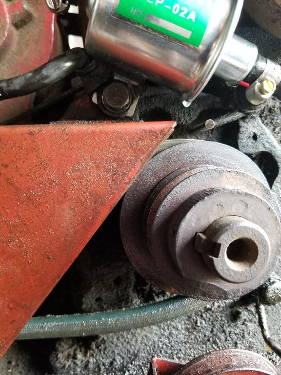

adsm08 5,214 #3243 Posted October 10, 2019 I found out that an RM-327 will attach to an 800 Special, but it won't work because the deck's shaft pulley and the engine's PTO pulley don't line up even a little bit. If I welded another triple pulley to the end of the first one it might work. Also, I fixed the PTO clutch on the 800. Share this post Link to post Share on other sites
D_Mac 9,339 #3244 Posted October 10, 2019 8 hours ago, LittleRed said: I am also big fan of the “Little Reo’s”... brings back memories of cutting the family lawn when I was young Hey I see you have the electric start. What is the model number ? RE??. Mine is a RR-65. Also I see the double pedals up front.. brake/clutch? Even though these REOs are much older I find more information on them then the RR 832 Work Horse. I like how low to the ground the REOs sit. The seat on the REO is about 6 inches lower then on the Work Horse. Your photo makes me laugh at the huge yard you have and then the little mower. Please tell me you never had to use that mower to cut all that grass! I like both of mine but like I said I dont have much of a yard. I would be interested in letting them go and moving on to next project. My memories of cutting the lawn as a kid was on an old Ariens RER. Its the memories of shoveling the snow with a shovel I want to forget !! 2 Share this post Link to post Share on other sites
