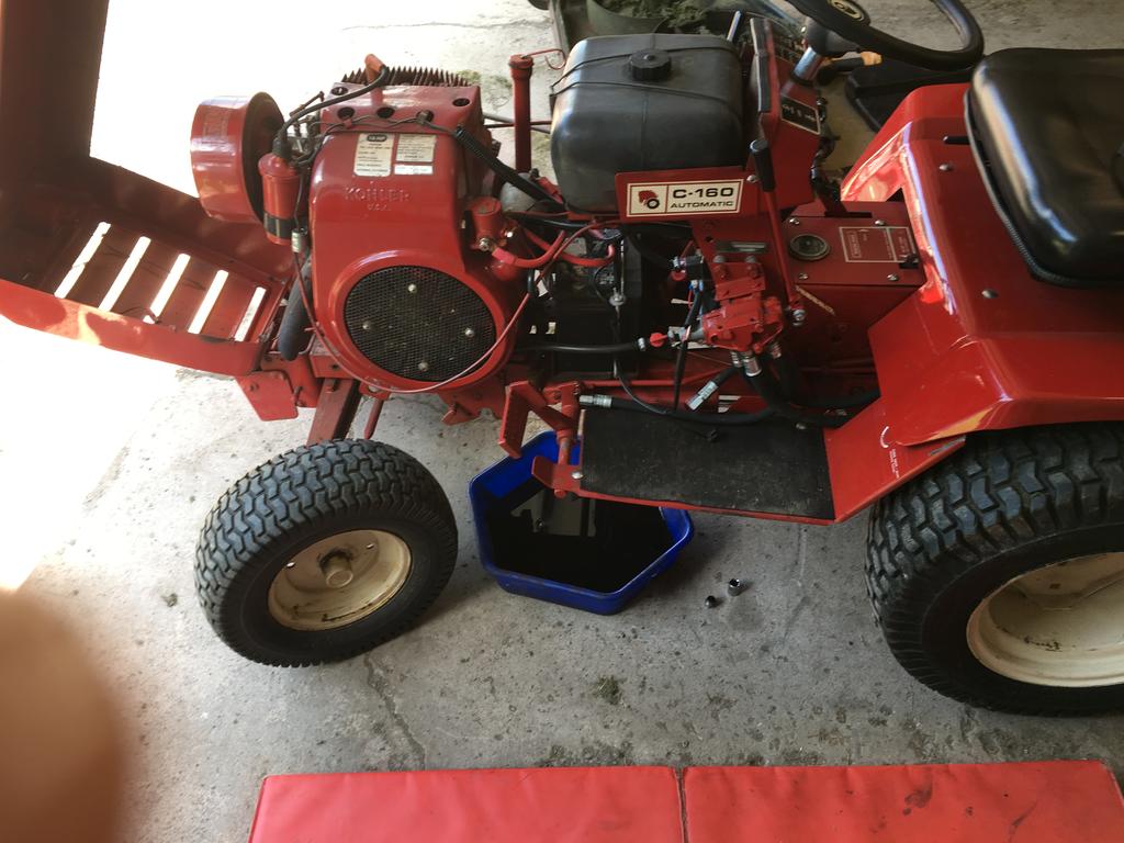

squonk 48,212 #2708 Posted July 13, 2019 Finally finish up the C-160 summer service. Cleaned deck,new plug wire, changed engine and hydro oil. Then replaced the lift cyl on Big Oly. 3 Share this post Link to post Share on other sites

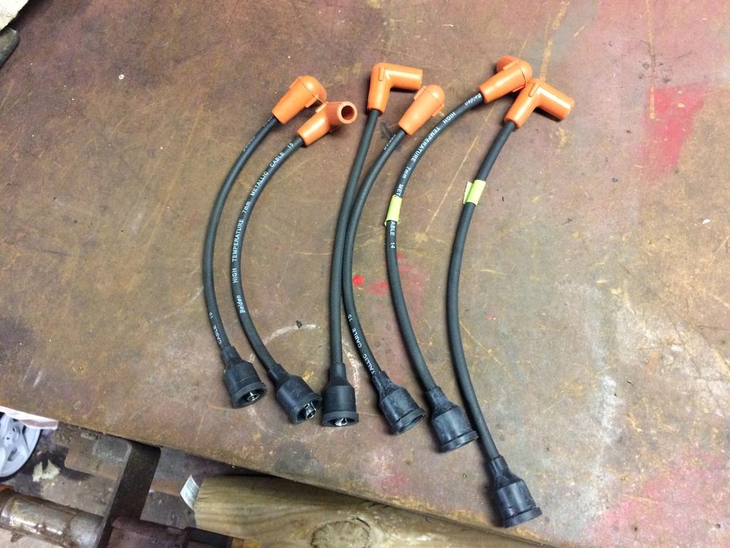

squonk 48,212 #2709 Posted July 13, 2019 I had nice wires for sale at the show. 1 Share this post Link to post Share on other sites
adsm08 5,194 #2710 Posted July 13, 2019 29 minutes ago, squonk said: I had nice wires for sale at the show. If I'd know mine was going to give out a few weeks later I'd have bought one. I got one from my neighbor who does mower service, it's way too long, but it works. It ran much better, reset the carb that I had been randomly fiddling with, runs much nicer now. Now I just have to get my PTO belt replaced because the one I put on earlier this summer is coming apart. Monday I'll run out to the Napa warehouse and get a new plug wire. Guy at the local store got me a number from the book, warehouse store has them on hand. 1 Share this post Link to post Share on other sites

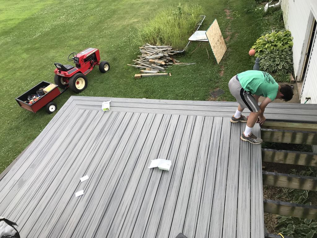

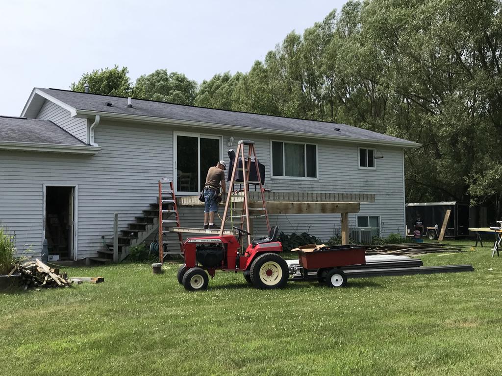

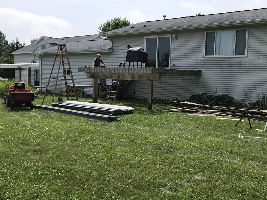

PeacemakerJack 11,068 #2720 Posted July 17, 2019 Today—“Vader”(the super-C) is my jobsite tool caddy today as we are redecking the deck on our house. When Kelli and I built it in 2002, it was just the two of us. Now I have three helpers and I’m thankful for them... Caleb is helping with the reconstruction and the littles are removing the nails from the old boards... 2 4 Share this post Link to post Share on other sites

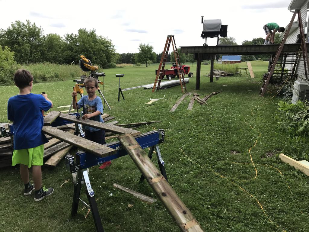

PeacemakerJack 11,068 #2724 Posted July 18, 2019 The “crew” continues to make headway... Judge and Zach are removing nails from the old wood... @Coulter Caleb is installing the new hidden fastener Trex decking! What’s dad doing???? 🤔 Good question! 8 1 4 Share this post Link to post Share on other sites
