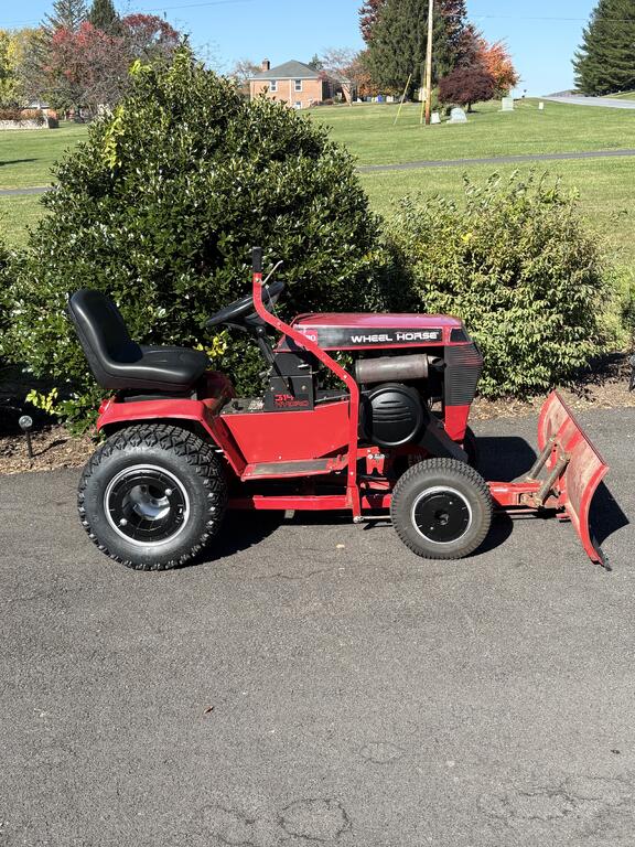

peter lena 10,088 #26876 Posted 4 hours ago @Sodaking27 looks clean , is that a reflexion on that hood ? stay after my paint with lubrication , maintenance , use a graphite or lubrication on my plow blade ? very easy slide off , makes that first plow off , wide and easy . do any mods to the PLOW QUADRANT / SWING SET UP ? did this years ago , unthreaded shoulder bolts , with flat washers and elastic Lok nut, lets you dial in lubricated swing / movement area , also did threaded rod , and heim joints to replace sloppy swing rods. quadrant slide pin , works like a rifle bolt , detail / improve , every stage , nothing sarcastic , implied , only a suggestion , pete Share this post Link to post Share on other sites
